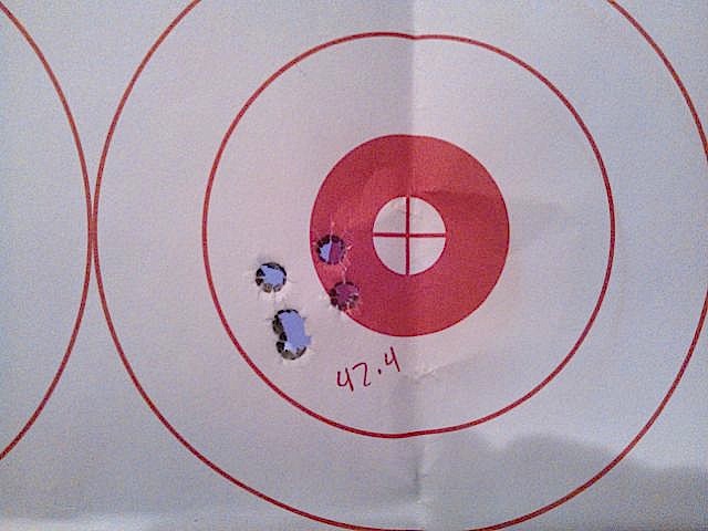

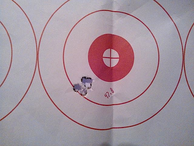

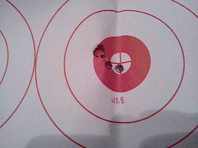

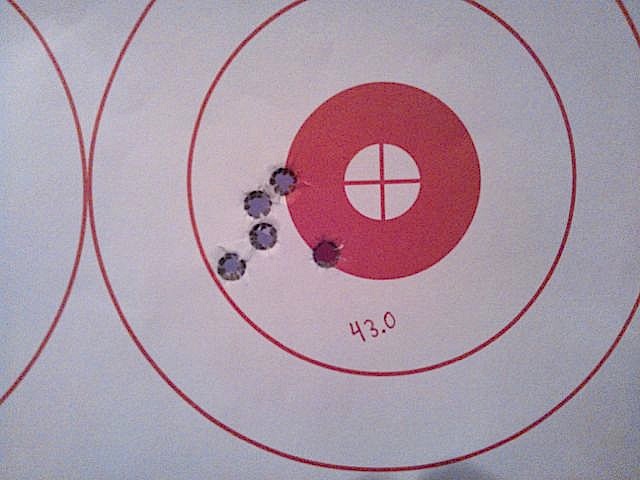

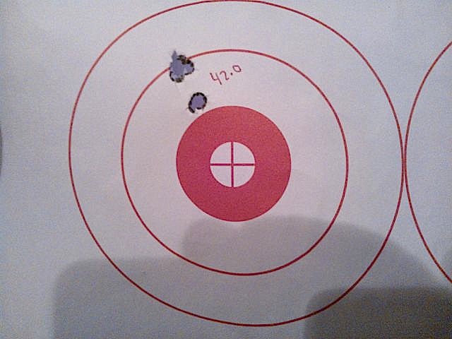

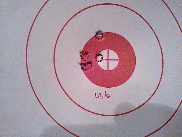

Here are my measurements. I am pretty sure a few groups had a single flyer, but I counted them anyway. Whatever.
42.0 - 0.75"
42.2 - 1.19"
42.4 - 0.88"
42.6 - 0.81"
42.8 - 0.50"
43.0 - 1.00"
43.2 - 0.88"
43.4 - 0.88"
43.6 - 1.25"
43.8 - 0.88"
A few caveats that I am aware of: Rifle is new and not fully broken in. I am new to the rifle and still mastering it. Pressure (and hence groups) may change once I switch brand of cases. And I should be shooting groups at 300, too.
It's obvious that the 42.8, or thereabouts, was a good low node. But a lot of the other groups seemed pretty good, and my instincts told me that my groups were starting to tighten up again at the top of the ladder range (43.8). I only loaded to 43.8 grains today because it's my first time reloading and I didn't want to push it. I am interested in shooting out to 1000 eventually, so I am not interested in low-velocity, bunny-fart loads. So, as much as I loved that 0.5" group at 42.8 grains, the velocity probably sucks, probably somewhere in the 2550-2600 range. I would like to push a 168 grain pill to about 2700-2750 fps, which shouldn't be an issue with a 24" barrel. So I am looking for a high node, hopefully in the 43.5-44.5 range of powder. I don't want to push max loads at 45+ grains. I am not interested in wearing out my brass or rifle prematurely ... or my shoulder.
At 43.8 grains, I saw zero pressure signs on my cases. There was a noticeable increase in recoil and pressure starting at 43.6 grains. It was a like a light switch. 43.4 grains was nothing. 43.6 grains started to kick a bit. But still, zero pressure signs on the cases. So I think I am safe to carefully push up to the mid-44 grain range.
But the problem I see is that, with the exception of a few 1.0"+ groups, a lot of these groups were decent, in the 0.8" range. My next time out I would like to explore the 43.5 range up to about 44.3 or so in 0.1 grain increments and really get this narrowed down to a good load. I have a friend who can chrono it for me when I find a load, to confirm that velocity is up to par for what I want to do.
But am I missing something with regards to analyzing these groups? Should I be paying more attention to vertical dispersion or both vertical and horizontal?
Thanks for any help.
