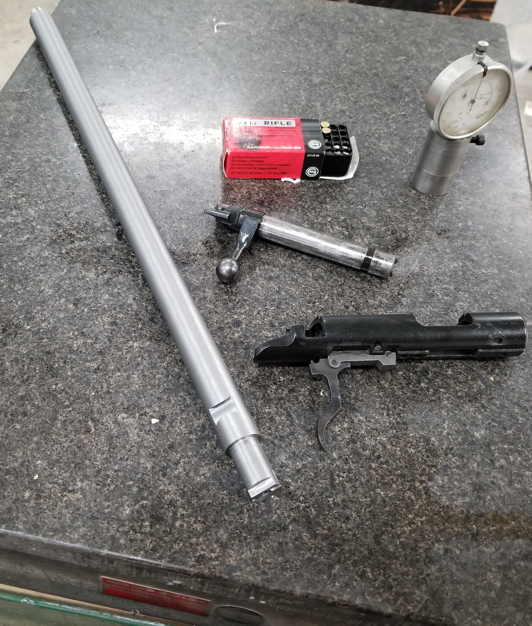

My son expressed some intrest in shooting some positional 22 matches with me so I decided to take the norinco jw-15 I had bought as a beater kid gun into something better.
For those that don't know jw-15's are a copy of a Brno #2 and use the same mags as a cz 452 and 455 but have a different footprint and action screw setup.

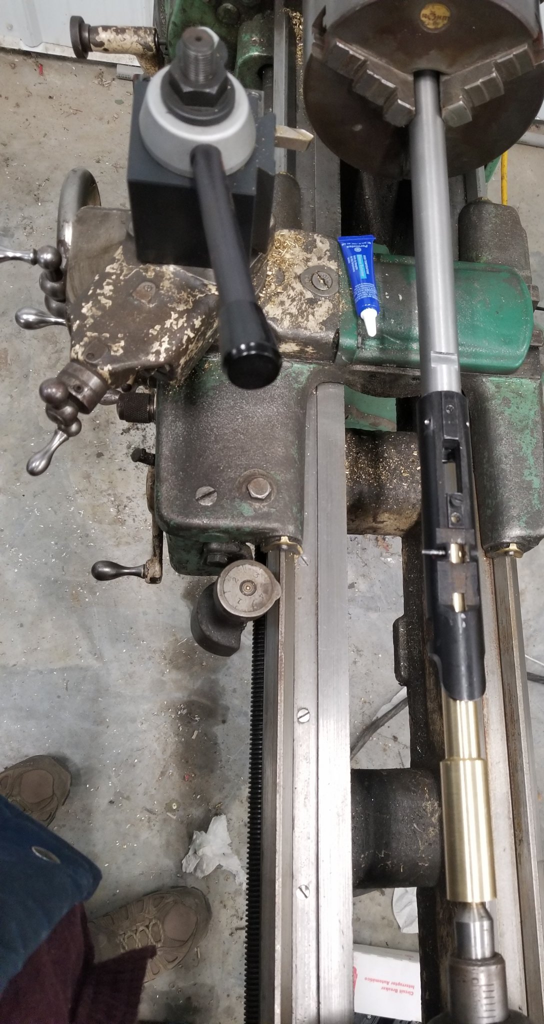

First I had to press out the old barrel, no pictures but it it took some motivation with the shop press to budge the barrel. No pictures here.
Then I spun up a new GM rimfire blank to fit and milled the bolt guide and extractor slots and front action screw dovetail.
I prefer glue up barrels to threading the actions on rebarreling a rimfire so I used a lathe as the jig / clamp as I glued the barrel to the reciever with cylinder retainer compound.

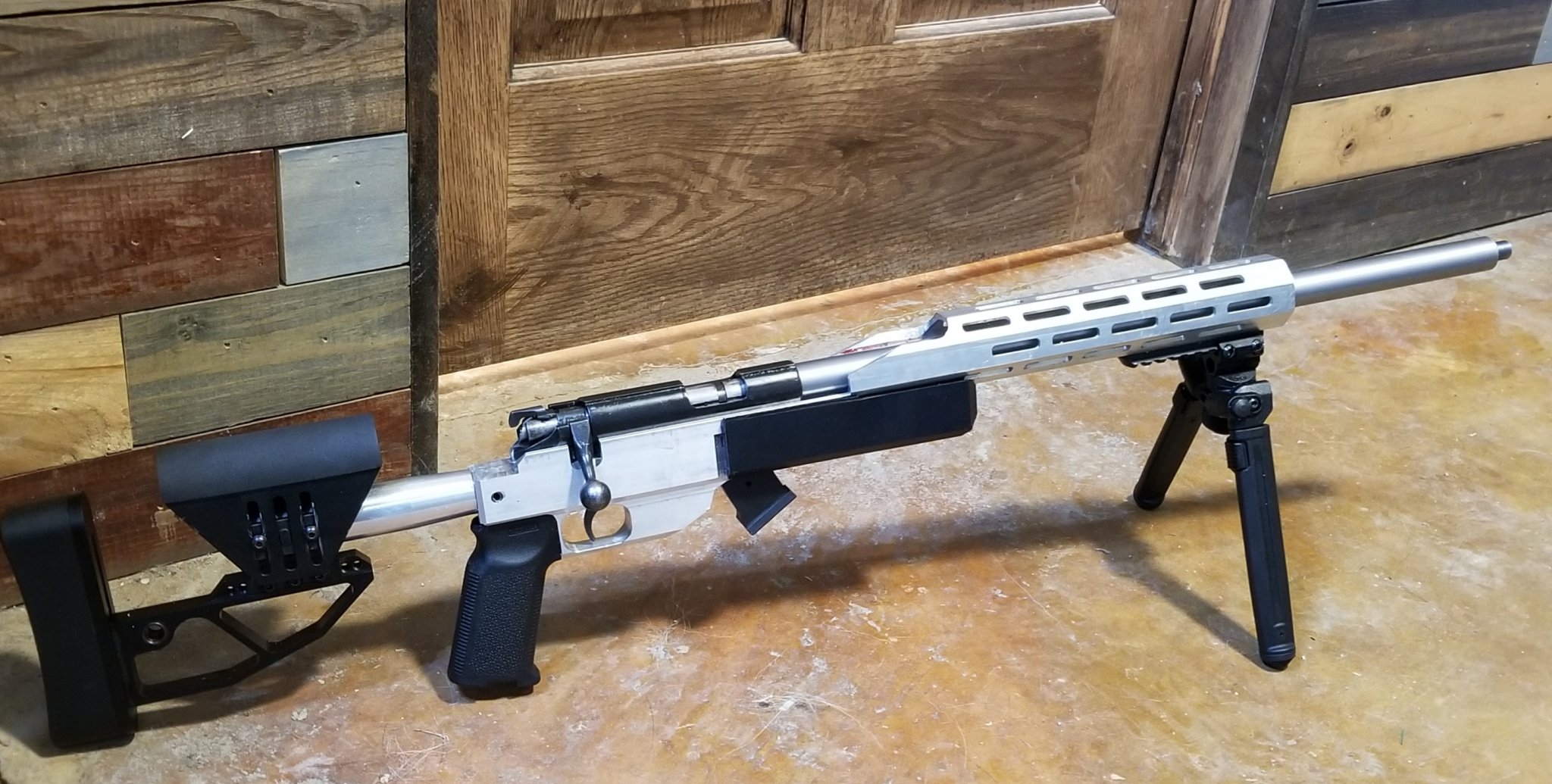

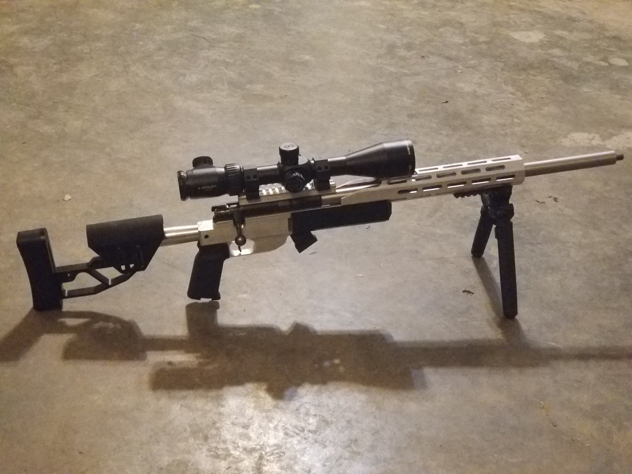

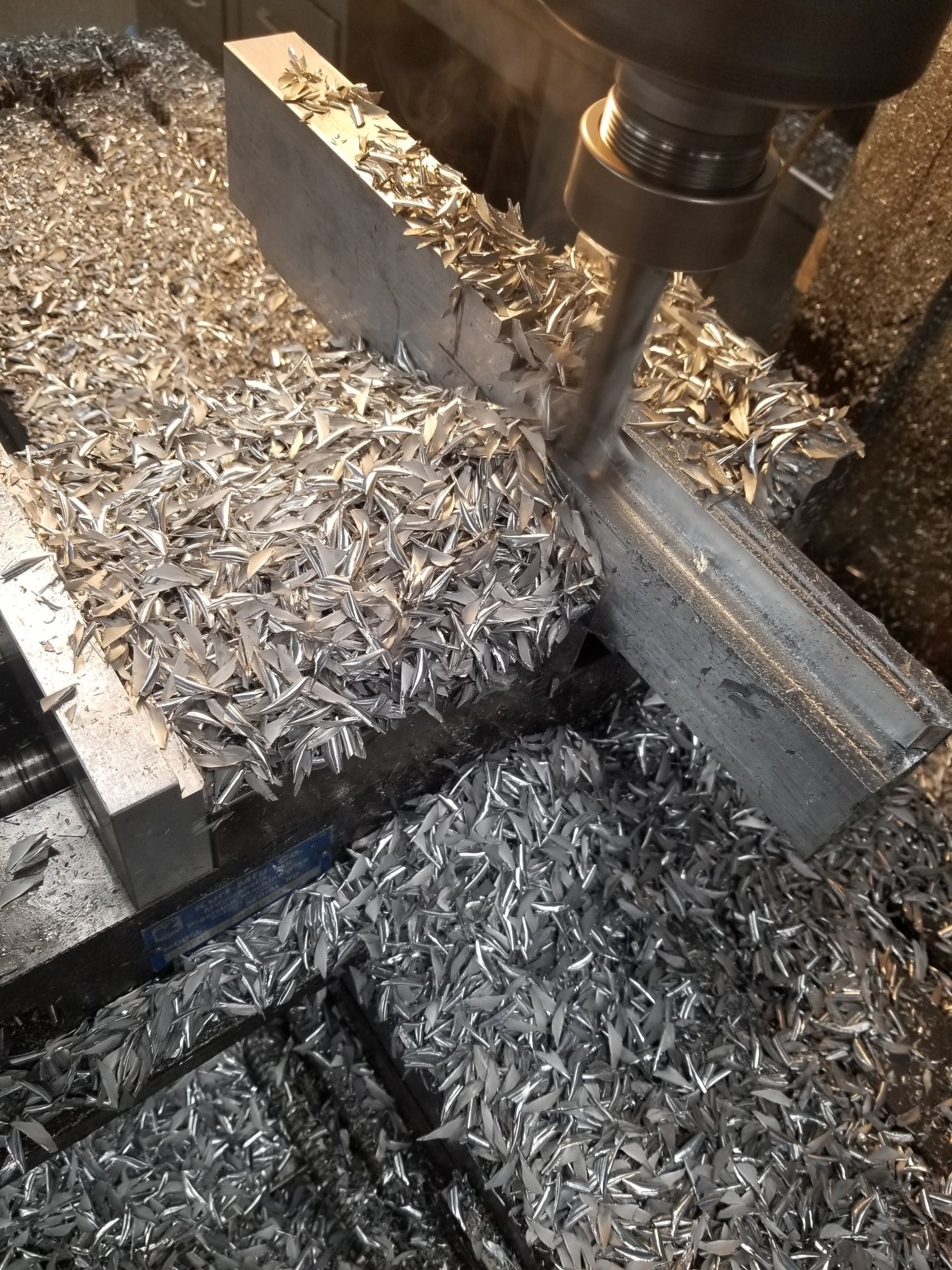

Next I needed a stock so I raided the aluminum stash. Here I am burying the Kurt vise in chips as I turn a 5.5 lb block of metal into over 4 lbs of chips, mainly with a 2 flute high helix 3/4 endmill
Then I milled out the M-lok compatible handgaurd and turned a kid length buffer tube and fit some assorted magpul bits and pieces and bipod
My son is excited with how it finished up tonight. Only things left that I know of we need to do is make a 30 MOA rail for tomorrow and sight it in as there is a match Saturday so painting or anodizing it will have to wait

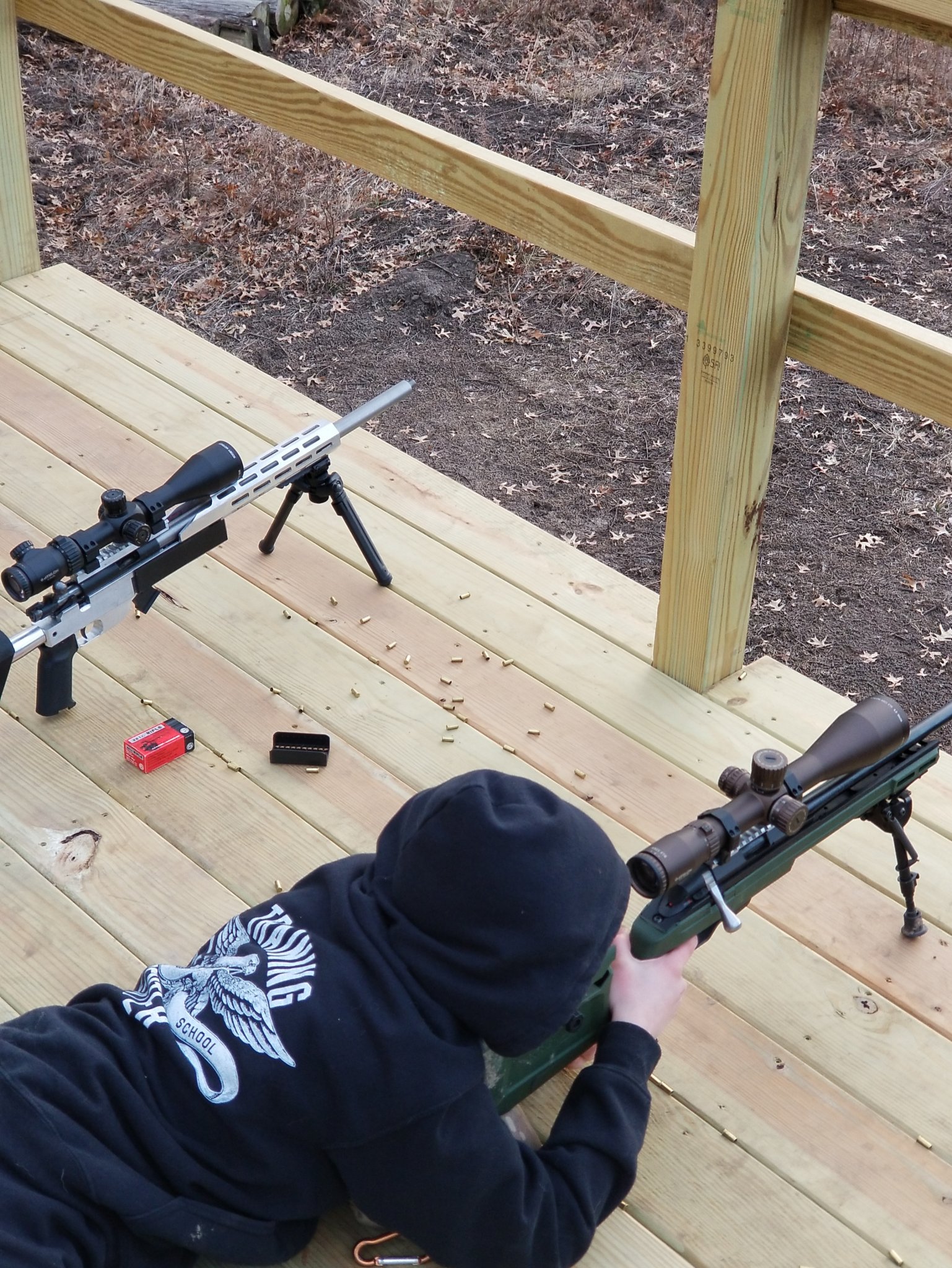

Here is my son and his friend sighting in their new rifles after a safety briefing and discription of what to expect at the match. I know their form is poor in picture but we didn't have a lot of time to work with them like I should have. We were losing light and a front was moving in as the air temp plummeted and it is my goal to keep youth shooting fun, not uncomfortable hard work -until they are ready for it to become so:

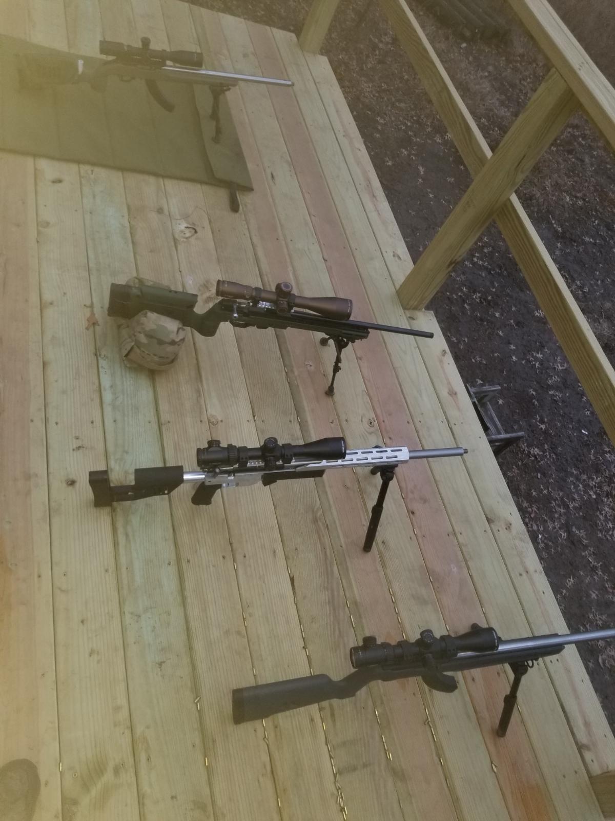

Here is the 100 yd tower as we get ready to confirm our dope as fast as possible. Son's rifle could hit the 2" steel as long as I timed the .2 1to 1 mil+ wind corrections as the wind went from straight into us then left to right and right to left. My prrformance with my tikka was similar and I know it shoots. If I was by myself I would have stayed till all light was gone as the conditions were "interesting" and I could have learned something but the group was cold, wet and muddy and fun meter for them was lowering.

So you did not pin the barrel back to the receiver, it is just bonded??
I have a old jw-15, always thought about putting a better barrel on it, it is just that the trigger is really crappy with a mile of overtravel.

Glue-ins are pretty common in the rimfire world , I use cylinder sleeve retaining compound whatever Permatex's # for loctite 609, you cant get the 601 border barrels reccomend in their instructions in the us
http://njshooting.tripod.com/FITTING A .22 RIMFIRE BARREL.htm
You also will not be bfh'ing it out like you can with a annie as it is a much tighter interference fit, I machined a fixture and was using a brass mandrel as the pusher and the bolt diameter mandrel bent before the initial "pop" in the 30 ton shop press. Norinco JW15's can be tricky to find the vertical pin as they blend those into the reciever surface and it is one of the few surfaces they actually finished right sometumes.

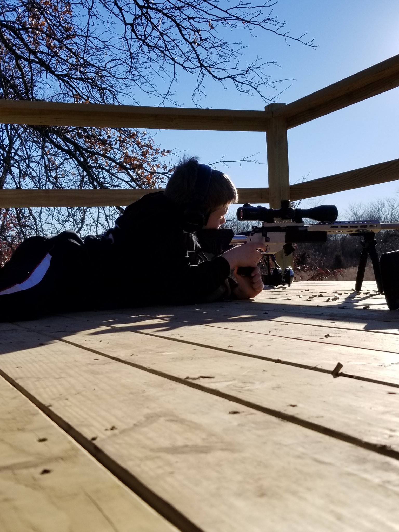

Weather turned awesome today so after work, I hit the range with son and his friend from school.Did some 50 yard barricade work and 100 prone. Today he was hitting the 1" nrl22 spinner @100 yes prone
