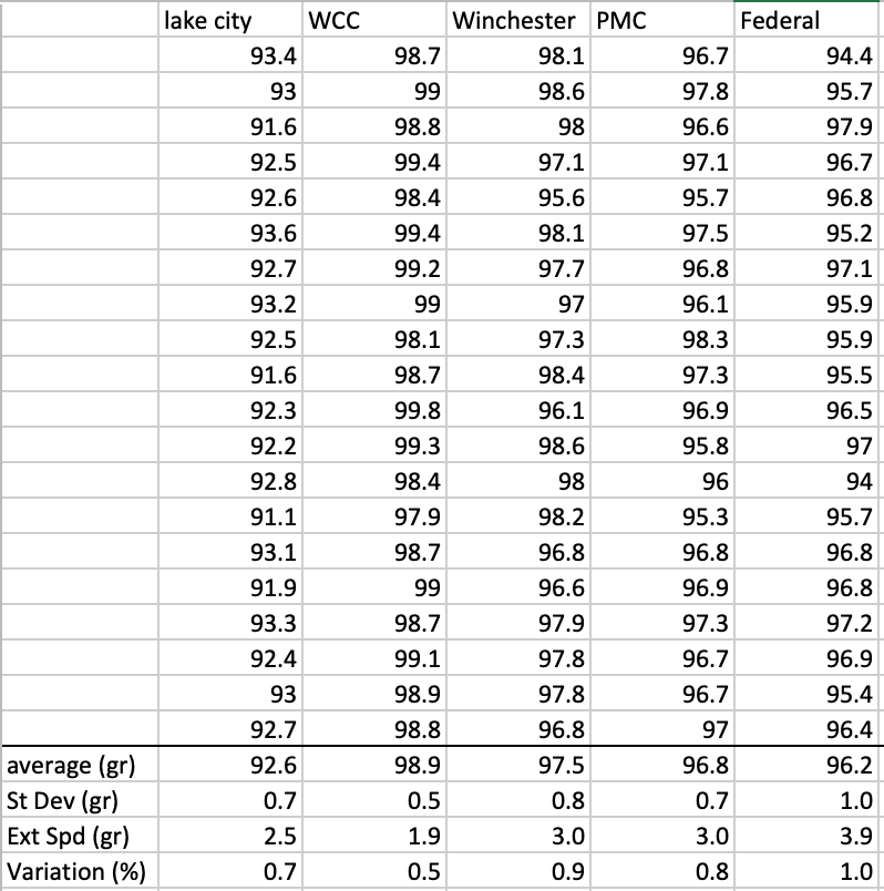

Run the rest of the reloads across a digital reloading scale. Fast and easy to find any un(der)charged cartridge(s).

There's way too much variation in case weight for this to provide an accurate picture of which rounds are under- or un-charged.
I guess that depends on what you’re looking for. “Uncharged“ is easy to find with this method. My 6.5 creedmoor brass varies by only a few grains- and this is unsorted brass. A 223 that gets a 1/2 charge should also be east to find. Looking for 0.1s of grain differences will be fruitless, but a few 0.1s under/over in charge weight will not create a safety issue, which I what I would be looking for when weighing loaded cartridges. As someone already posted, using the correct powders, it is essentially impossible to double charge a 223 case. The real issue is running the progressive press with a faulty safety indicator (low batteries) and then not heeding the warnings that the gun was giving before it failed.

So, its a slow day and I have a bunch of range pick up brass under my loading bench, and a digital scale sitting on top of it. When I say "range pick up brass," it was shoveled from a police practice range and gifted to me- mud, shotgun hulls, disintegrating belt links, and whatever else as well. Much of it was pistol brass and I hosed it all down to remove the worst of the mud and then picked through it for the 223/5.56, which went into my vibratory tumbler (all told I had 25 full 5 gal buckets of "range brass" to sort through, and what I did not keep went to the local metal recycler). This is all to say that I'm not convinced that the brass is all spotless on the inside- and I found a few while doing this little experiment that were packed with tumbling media- so the weights may not be totally reflective of brass alone. I did not shine a light into them to see if they were totally free of dirt and media before weighing them. And, none of this is sorted by year of manufacture, just sorted by head-stamp. Additionally, only the lake city brass was deprimed- as I use this for my 223 reloads, so the others include the primer weight. I grabbed 20 pieces from each of the head-stamps in the bin. With a +/- 1 grain for the worst offender, I stand by running loaded cartridges across a digital scale to find gross reloading errors.

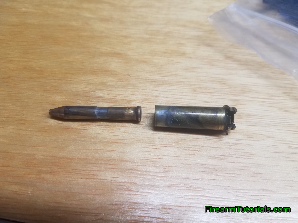

Yes, he reloads for pistols, 308, 556 and 300 Blackout. Loaded thousands of rds with no issues at all, but here we are. He's sending me pics tomorrow, Ill get em up. Starting to think from what Ive read that something similar to some other powder in the bottom of the hopper. He's not a noob who just started, he's loaded for years, and is pretty OCD about anything concerning weapons and safety practices. Probably the safest guy I shoot with, and we've shot together for several years.
