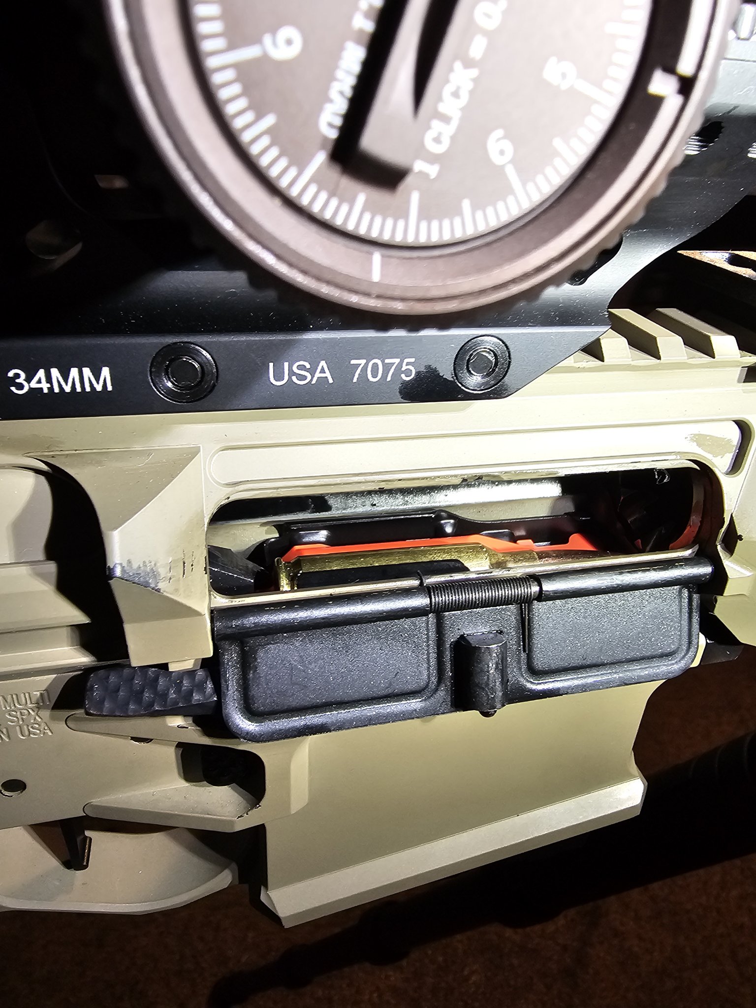

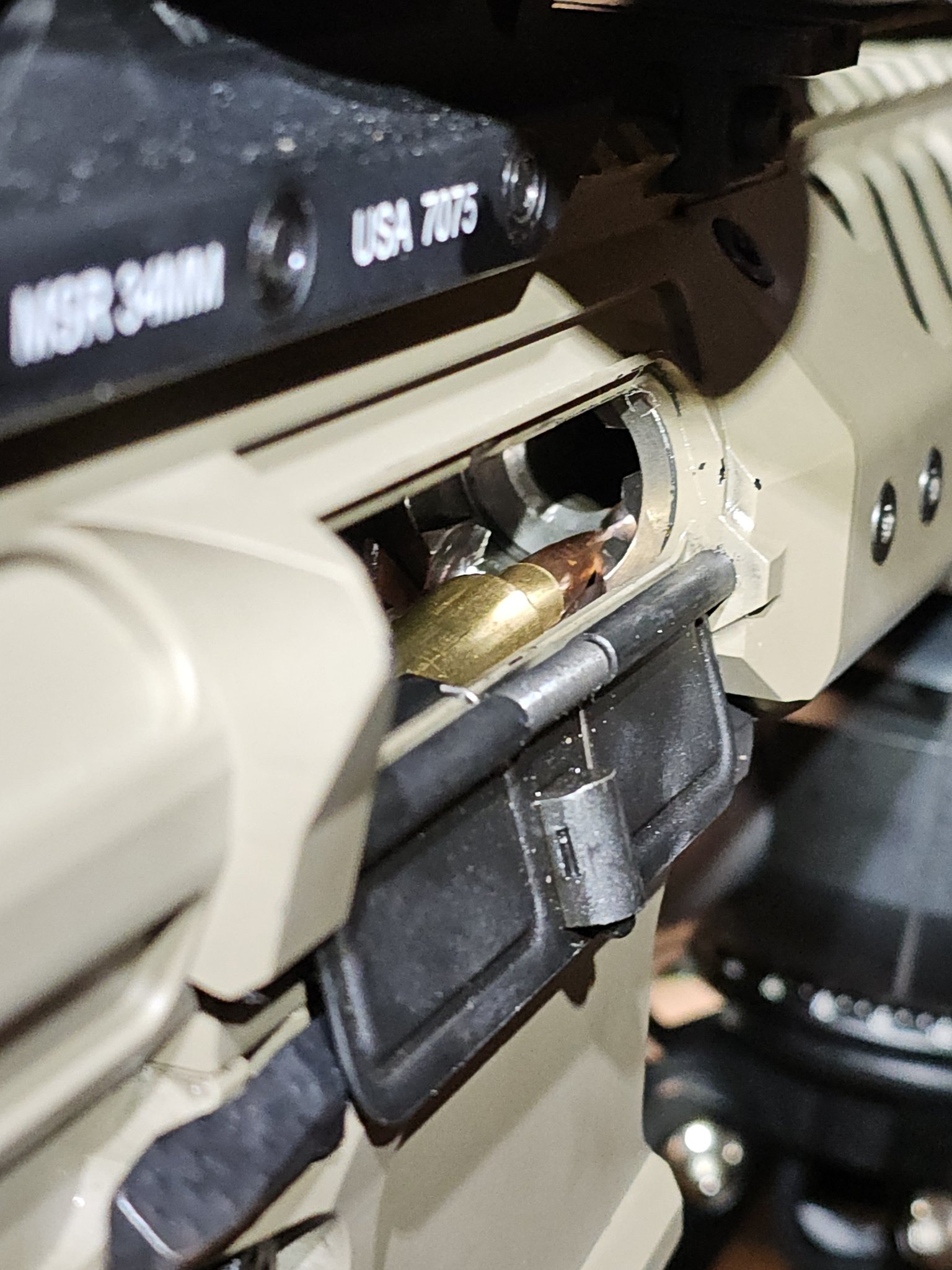

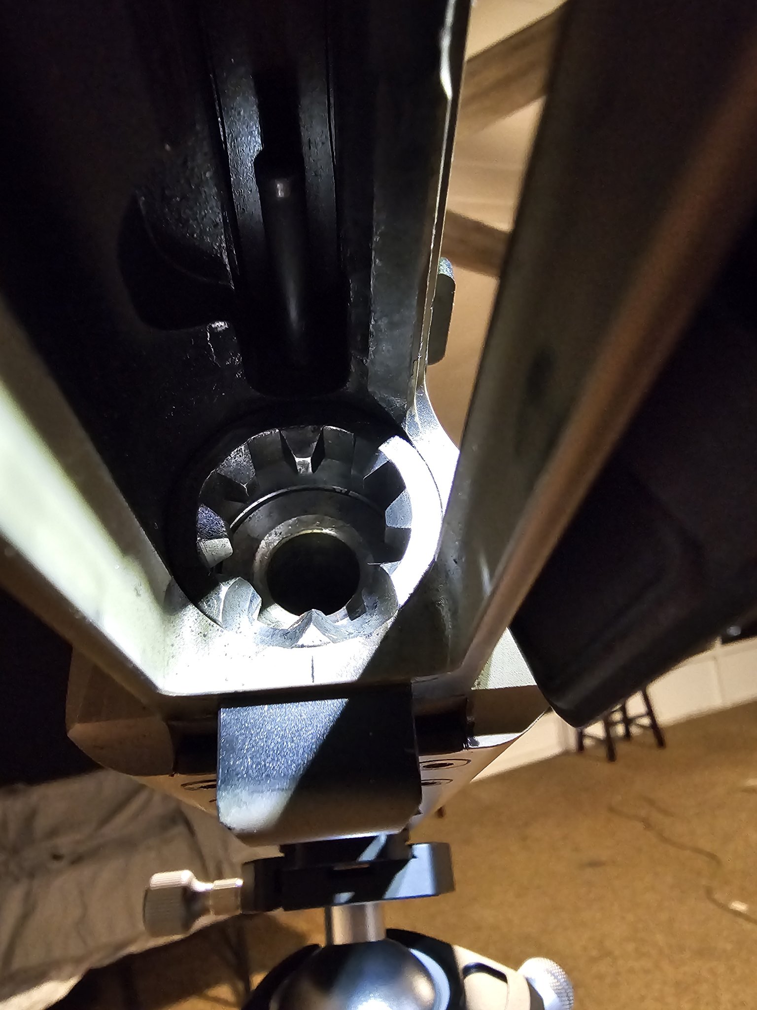

Seekins SP10 6 Creedmoor has troubles feeding the next round on specific ammo. Federal gold Berger, Nosler RDF match, Barnes Precision Match have all got stopped right at the wall of the barrel. The only ammo that feeds normal are the hornady's Match ELD and Black BTHP. While at the range I tried just using one round and charging it but it would get stuck at the same spot of the barrel and the force of the bcg actually push the bullets further into the casing. See picture below. I went home and pulled the bcg out and try to replicate the rounds being fed by using my finger to push the back of the rounds and rightfully so it happens only on those ammos at the same part of the barrel. I might have an older SP10 because the gas system didn't stick out past the hand rail like those with +2 systems. I have a select-adjustable seekins gas block and adjusted it to cycle just fine with Hornady rounds. So it's not the gas system. Something is definitely not right here.

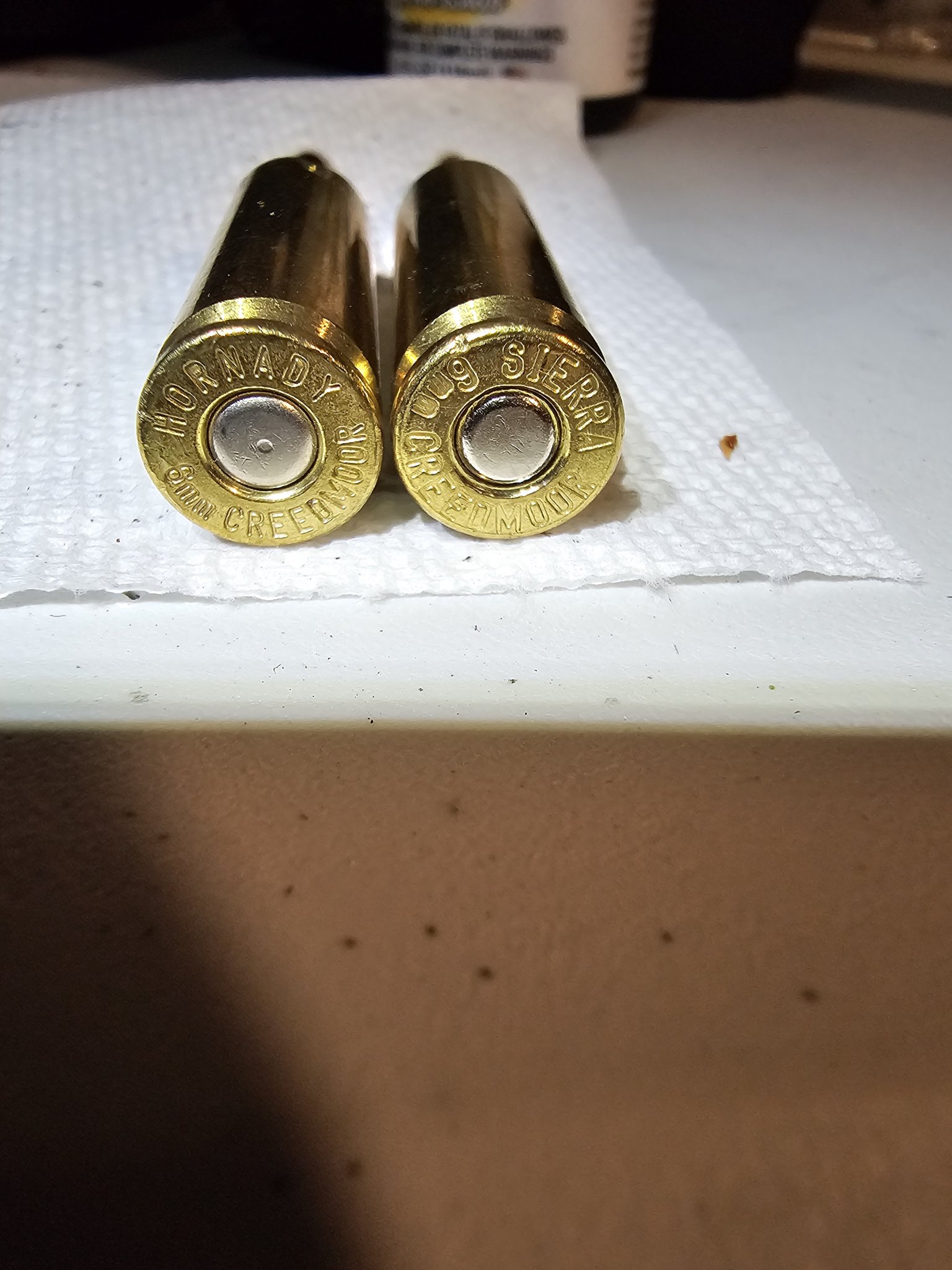

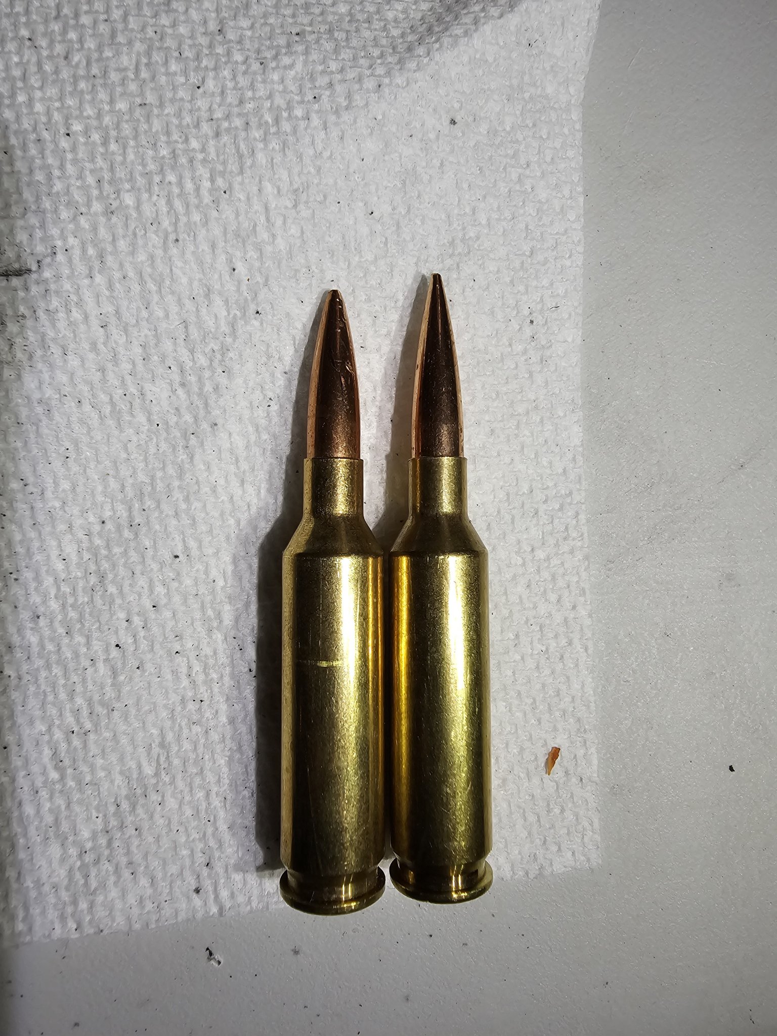

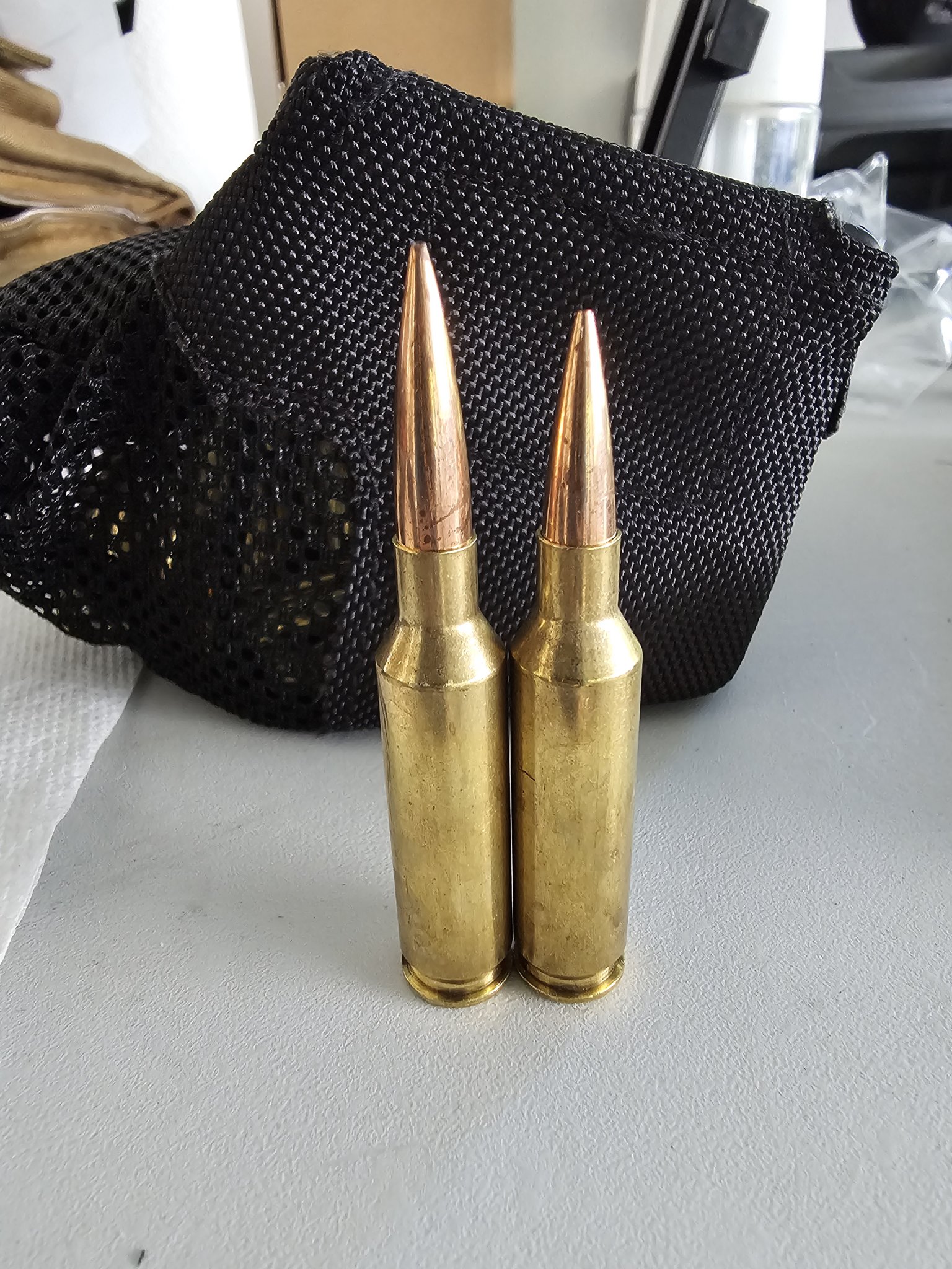

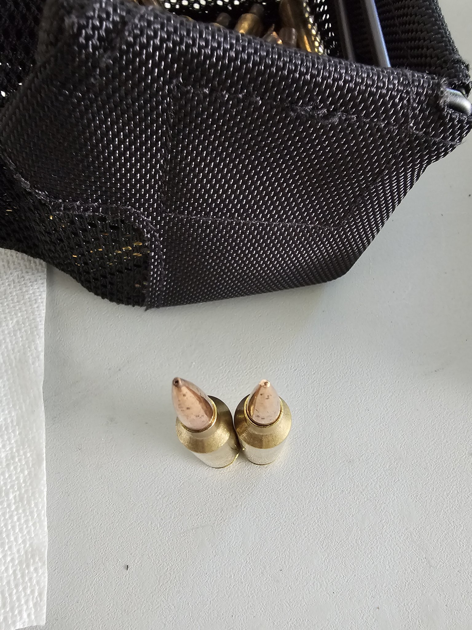

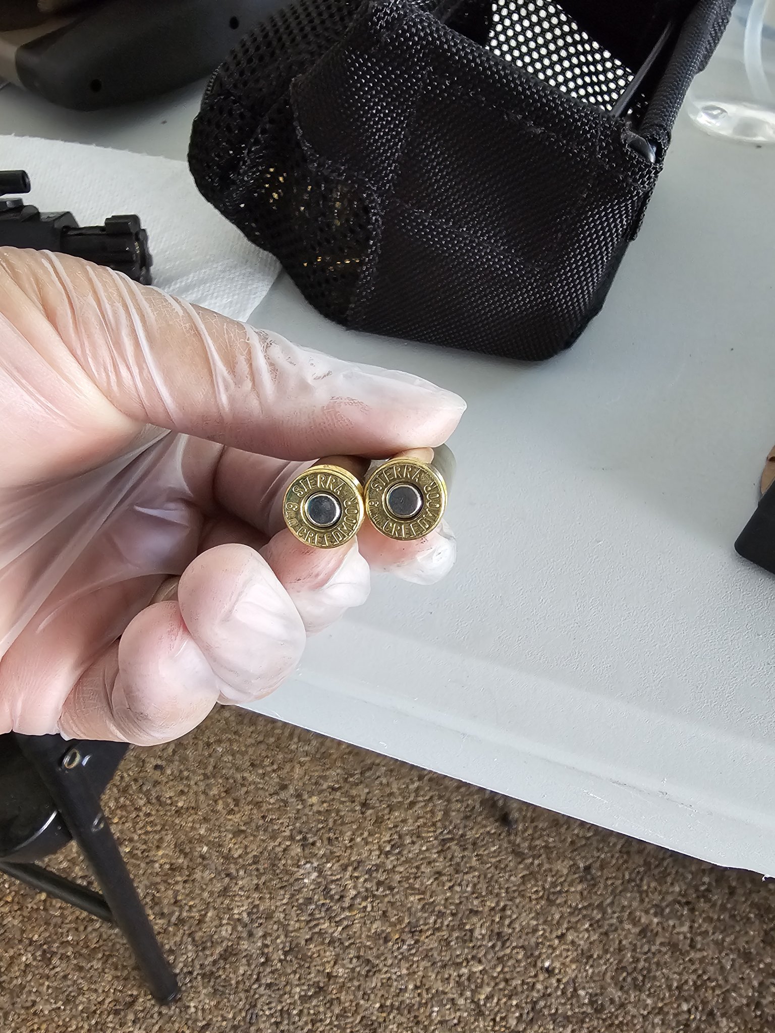

I put the one of the hornady's alongside the barnes and the hornady's are a little shorter and thicker which is why the hornady's feed normally.
Hornady(Left), Barnes(Right)

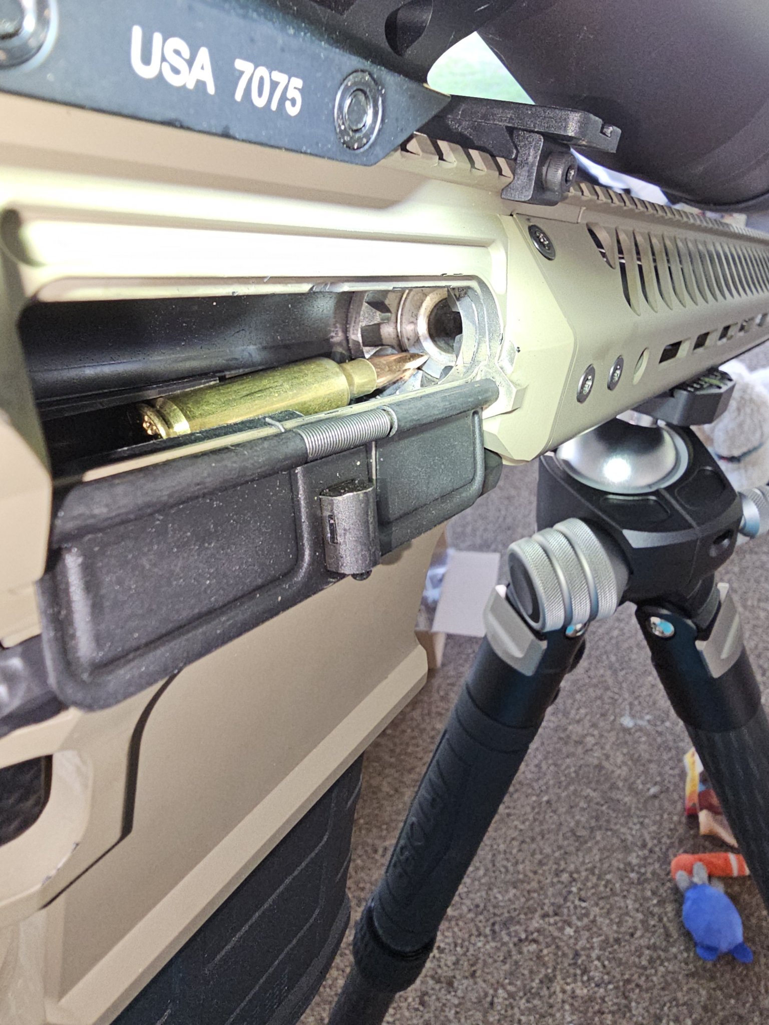

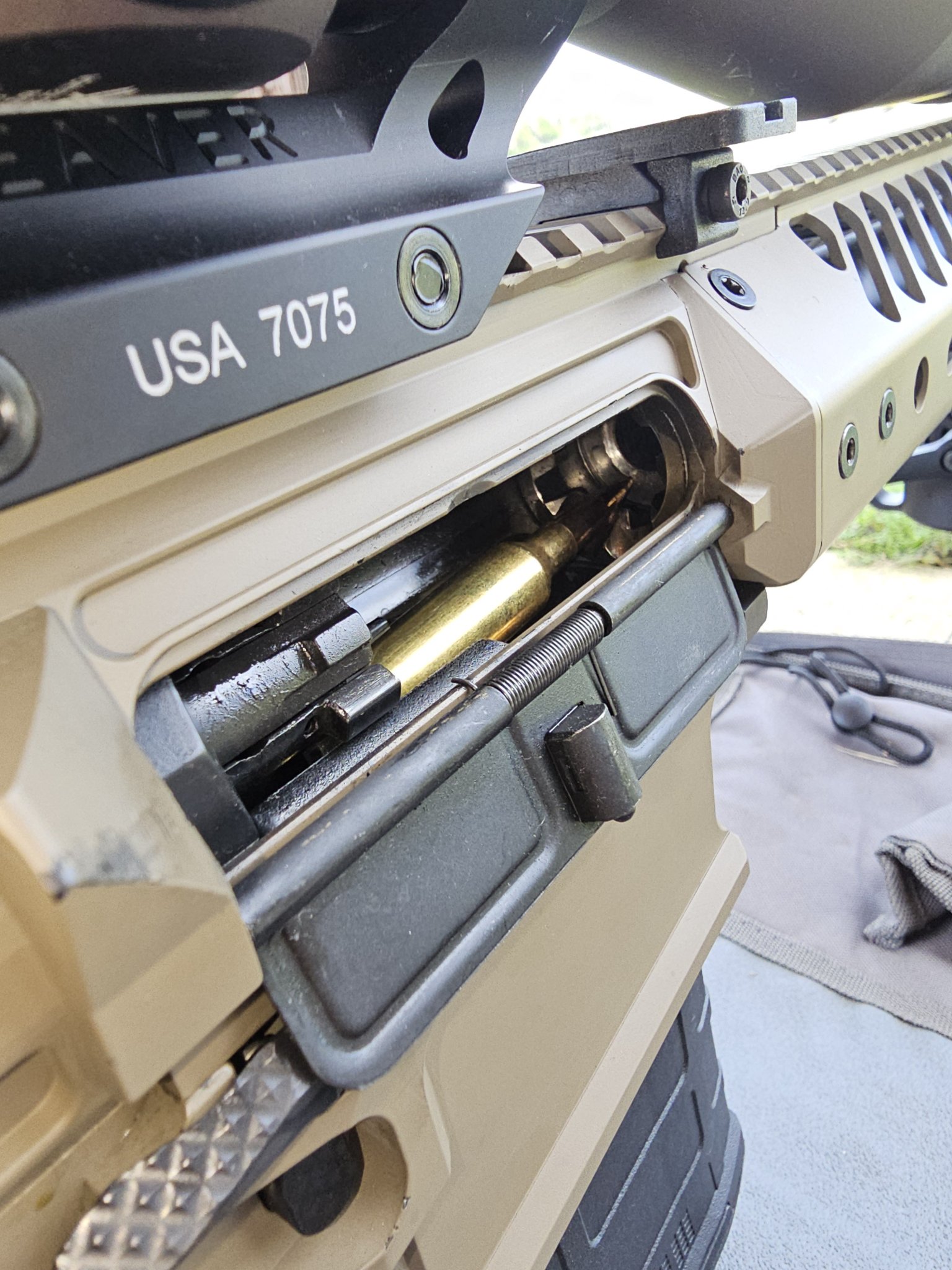

Is the bolt completely behind the round? Can't tell from the picture. Looks almost like it's short stroking a bit and riding the next round into the barrel too low.
Possibly the opposite as well, too much gas.
Yes the bolt picks it up. When I go to charge, the bullet tip gets stuck there at the same spot.

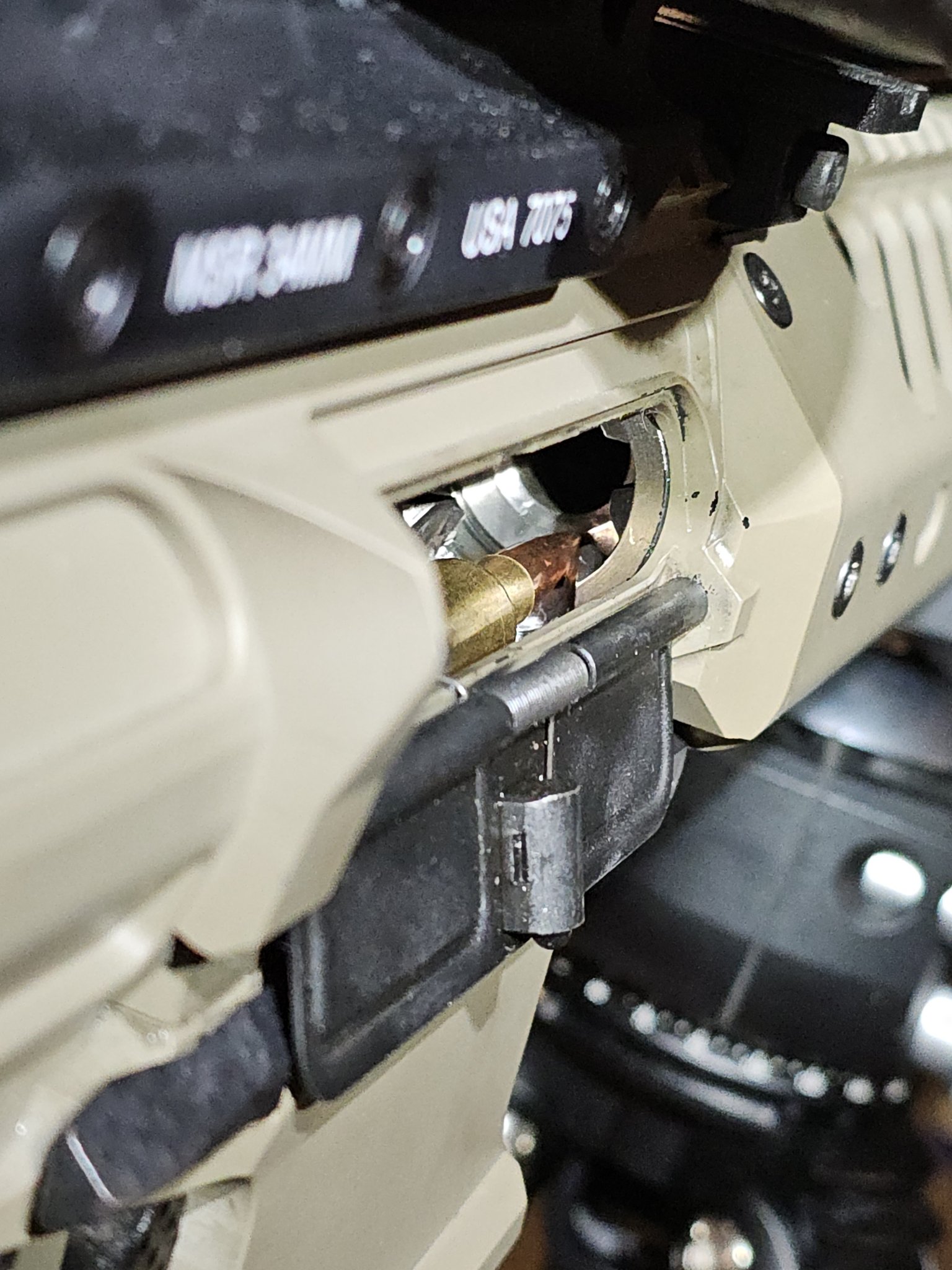

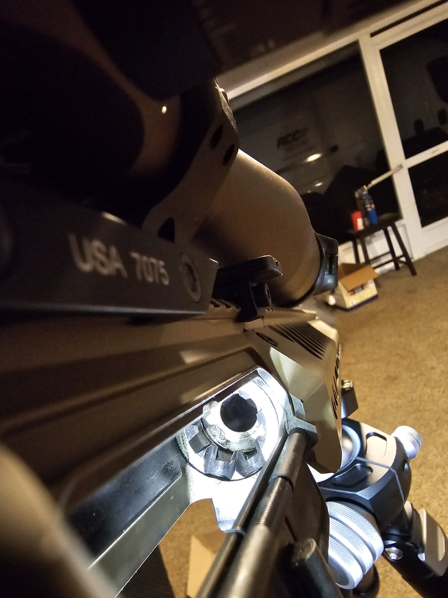

In your last photo... where it shows the bullet tip stopped against the breach.
I would suggest polishing that radius on the barrels receiver extension.
I have used a over sized shotgun bore mop ( over sized enough that it won't go into the chamber, but rides the area I am talking about ), attached to a piece of cleaning rod, spun via a cordless drill.
You WILL need a shotgun adapter for the mop... I tend to buy a cheap universal Hoppes cleaning kit that has the adapter.
IMPORTANT >>>>>MAKE SURE you blow out the fuzz from abusing / polishing with the bore mop, from the lug area.... that fuzz can lock up the bolt , into the RE lugs pretty danged tight if it isn't removed .... ( ask me how I know )

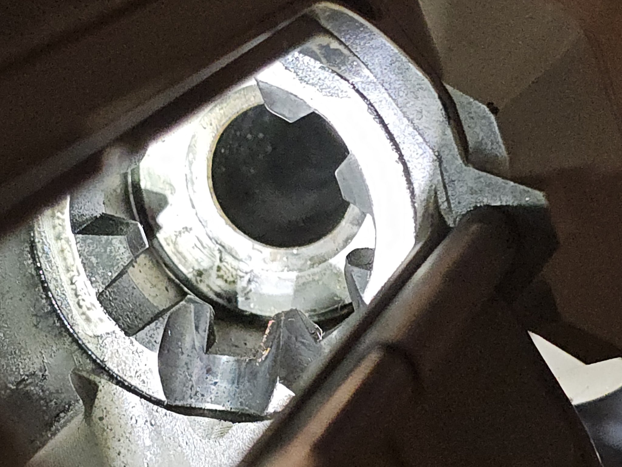

I believe the problem is the barrel extension. It appears that it was machined for a larger caliber like .308. The longer VLD style bullets aren't even contacting the barrel extension and simply running into the barrel. The shorter bullets actually make contact with the barrel extension before the tip hits the barrel and funnels them into the chamber. The manufacture needs to correct this.

The problem is 6mm, especially VLDs.
The AR-10 barrel extensions were never designed for 6mm bullet diameter and ogive, especially VLDs.
Because the 6mm is so narrow, it allows the meplat to smash into the breech without even hitting the feeding cone.
There are several geometries to take into consideration with a new cartridge design for feeding.

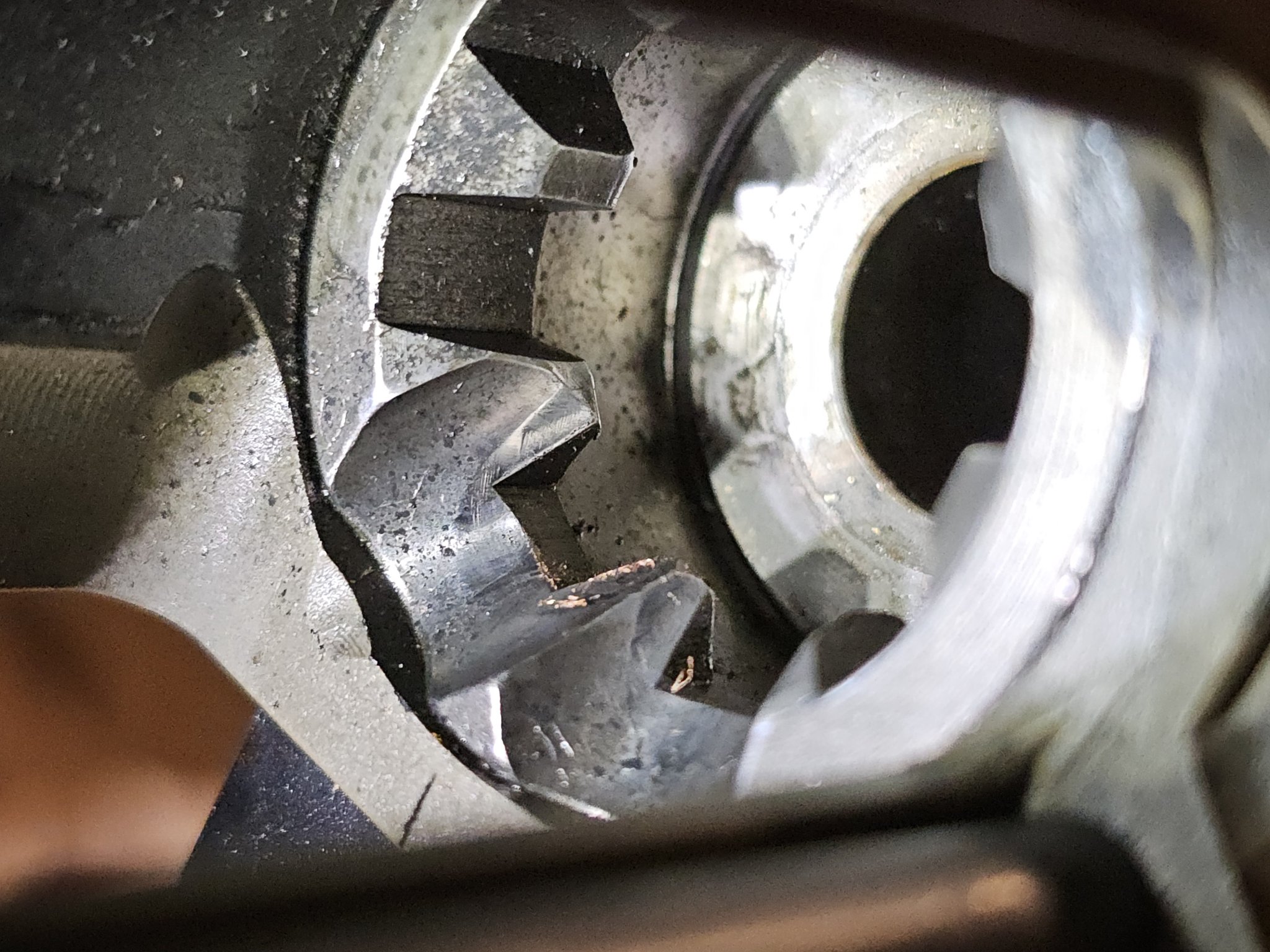

One thing I would consider is blending and polishing these surfaces:
20240316_213311-jpg.8374300
See how your upper receiver and barrel extension feed ramps don’t blend together? I think your case shoulder may be hitting the little feed ramp cut into the upper and nosing down a bit. I’m not saying blending and polishing your ramps will solve the 6mm problem but I don’t like to see disrupted surfaces like that.
In my .260 Rem that GAP built for me, those surfaces are blended. I have never had a feeding issue with the rifle. It has run like a raped ape and shoots bug holes right along with some of the best bolt guns I’ve shot.

This is a well know problem with 6mm AR10's. The barrel extension was designed for 308 and the small diameter 6mm doesn't always allow the tip of the bullet to present directly into the chamber. It is made worse with long skinny bullets. Varmint bullets are shorter with the ogive close to the tip so they tend to work better. Add in magazine and magazine location variation, and you get feedway stoppages.

Is your upper receiver cracked? Either debris or I see a hairline fracture. M4 feedramps would definitely help. I've transitioned to Lancer L7AWM mags. I've had problems with the magpuls properly presenting the round for feeding.

The ramps should blend and look like one seamless ramp between the upper receiver and barrel extension.
A slightly higher ramp might help feed the VLDs loaded to a long COL, but it’s a bit late for that.

Looks like the taper on the breech is not machined right. I had same issue with another brand. Look at pictures of others and compare. Yours looks too flat. I went round and round arguing and ended up sending it back... went with different brand, changed nothing else, and the gun cycles flawless now and no more locking up trying to chamber like yours is.

I would also de-edge, blend, and polish the feed ramps so that no large scratches and gouges happen during feeding.
The way I'm approaching this is that if I pay a premium for a gun I should be able to run any ammo with any mag obviously of the same caliber without any feeding issues. If a manufacturer sells guns they need to test it with different ammo and ensure it will work function with it otherwise state it when purchasing the gun that it would only work with xyz. It's not like I'm building a custom gun. This is a stock gun from Seekins.
Now that I see the issue better, that extension is the problem. No matter what you do it won't be reliable like that. Gonna have to send it to seekins for a new barrel or to replace the extension.
I feel you on that. Even with what I knew 15 years ago, when I had GAP build my .308 and .260 Rem, they asked me, “What bullet do you really want to shoot?” For the .308, it was 155gr Scenar, and for the .260 Rem, it was 139gr Scenar.
Both of them are hummers with those loads and some others. The .260 Rem shoots pretty much everything superbly. The “worst" bullet I tried in it was 140gr A-MAX, which shot .75” 5rd groups. At the time, my unrealistic expectations were that everything should shoot 1/2”, but even then, I knew that certain bullets might not feed correctly, especially the Berger VLDs.
To my pleasant surprise, 130gr VLDs run fine through my .260 Rem gasser and shoot bug holes at 100yds, group really tight at 1000yds. But I would not have complained if they didn’t feed because it was a known issue for many who had tried loading VLDs in AR-10s.
One thing you can do to help Seekins set the gun up for you is send them your long COL 6mm Creedmoor VLD loads, and they should be able to work the critical parts so that they will feed that load reliably.
You’re basically asking for a McLaren that will run on racing fuel, low-price unleaded, special, and premium fuels. It can be done with 3 of those, but it will take some tuning.
Reactions: Leo. D
Couldn't agree more about the McLaren and yes sir, I am sending them 4 rounds each of Federal Bergers 6CM and Barnes Precision Match 6CM (Total of 8 rounds) that have problems hitting the breach. Although, I'm not sure if thats too little or too much ammo to send to them? Do you think that amount would suffice for their testing and troubleshooting?
Dummy cartridges would work well for manual-feeding and troubleshooting, followed by live fire if they do all that.
