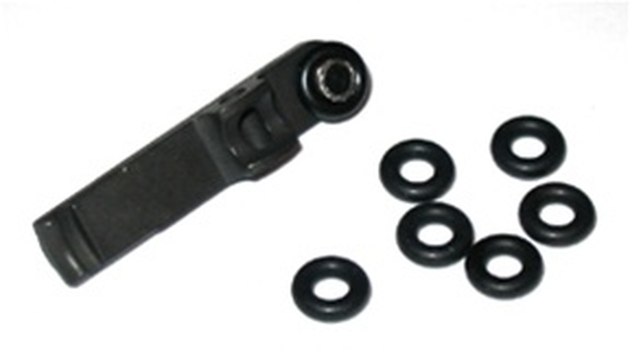

One of two like already mentioned. Weak ejector spring, or dull extractor claw. Also check to see if there is an O ring around the extractor spring.

I had a similar issue with my 556. In my case it ended up being the extractor. Weak spring and was dropping the cases before it had a chance to eject.
Dropped a rubber O-ring on the spring side of the extractor. Solved my problem
Get a Sprinco Reliability Enhancement kit for your bolt. 5 coil spring with true mil spec inserts.
I put them in the majority of my bolts and never have issues with extraction or ejection.
