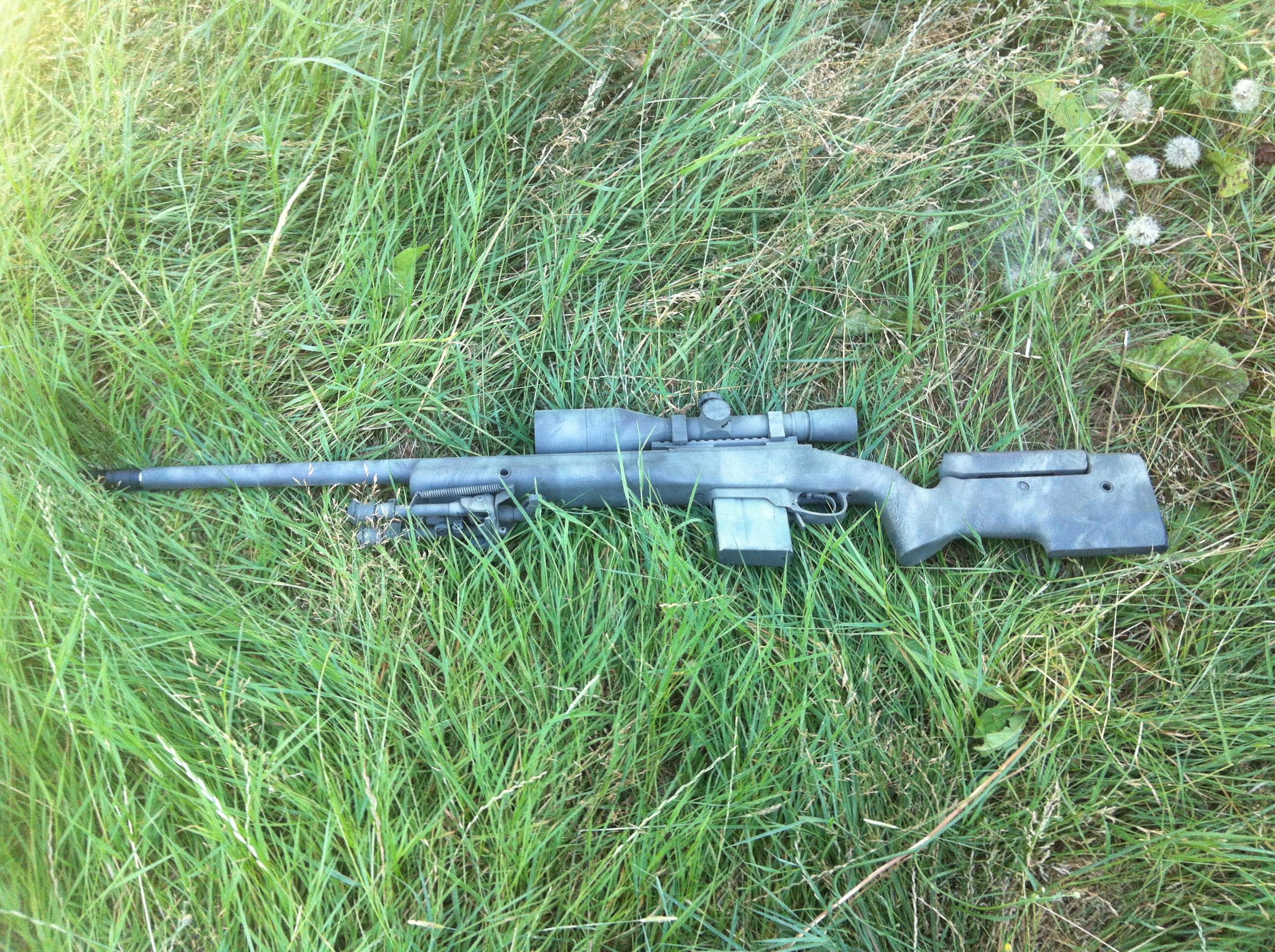

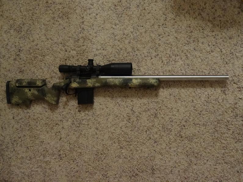

As promised rifle photo!
Once a couple things get dialed in I will be painting the barreled action and possibly the stock/ scope. Note the M40/ #14 profile barrels aren't much smaller than the MTU contour and are what I would call "Man" barrel lol. Currently chambered in 308 bisley match with 0.88. Might go longer to 0.114-0.116 to run heavier bullets for the F-TR class.
photo update. So took her out to the mountains on a ridiculous wind day and was humbled. But she did her job but 973 yards on a 12inch plate your wind call has to be right lol.
Looks purdy. I liked it the other way, too! I agree with you on needing a good wind call with a 308 at nearly 1K! ;-)
