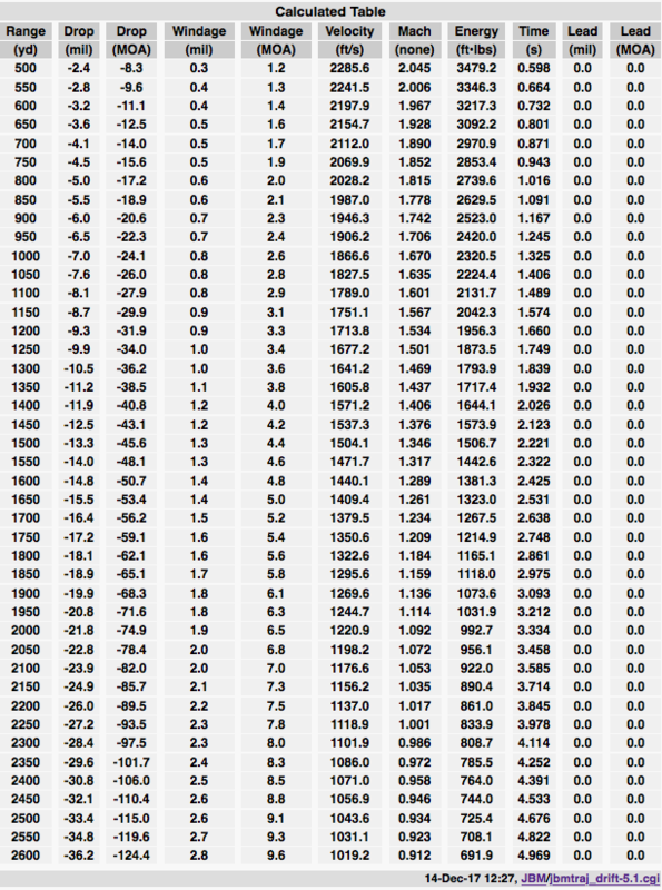

    JBM Trajectory Drift Calculations
    Nosler 300gr Custom Competition going 2750fps
    5MPH wind coming from the Right with SD turned ON
    Did you ever see Eddie Murphy Raw, 1/2 ! 1/2 your shit ... computer says 2.8, we used 1.2 go figure.
