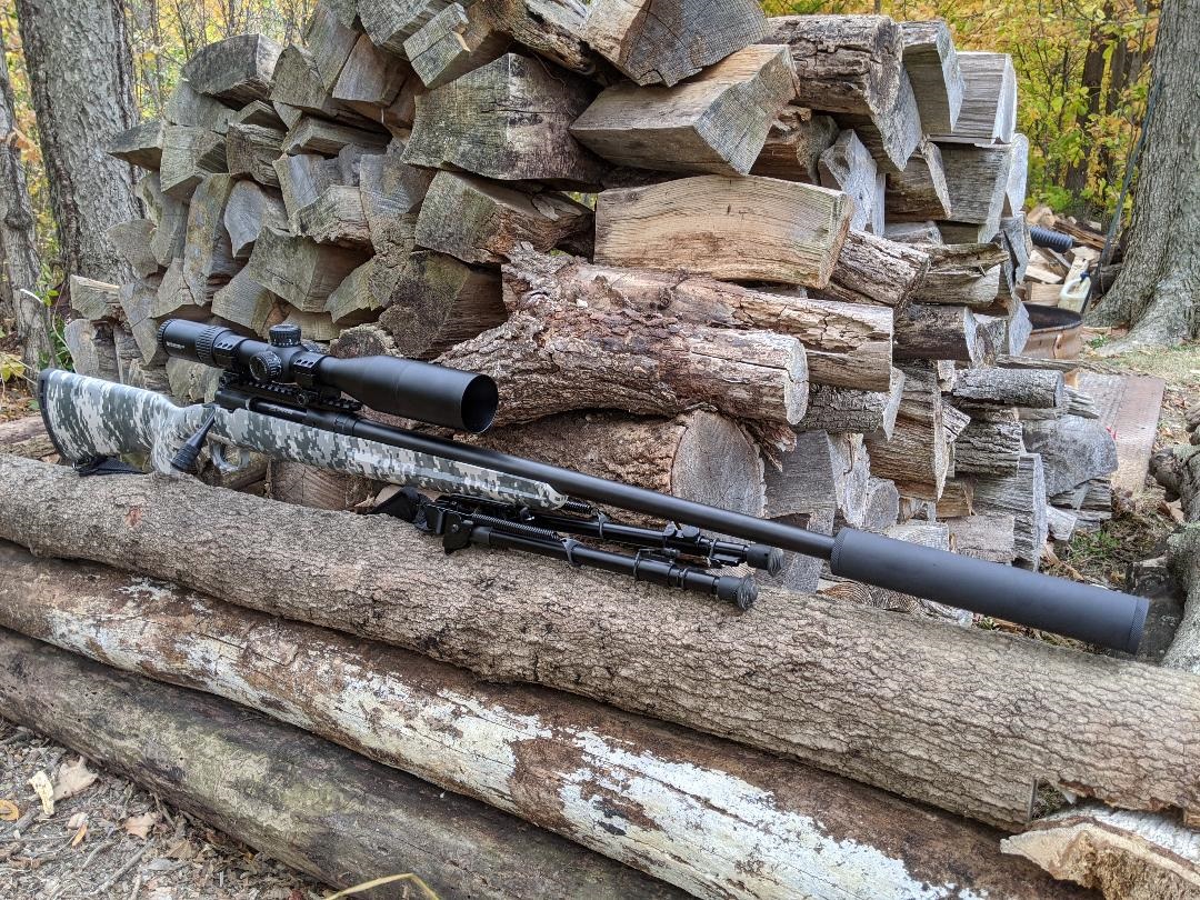

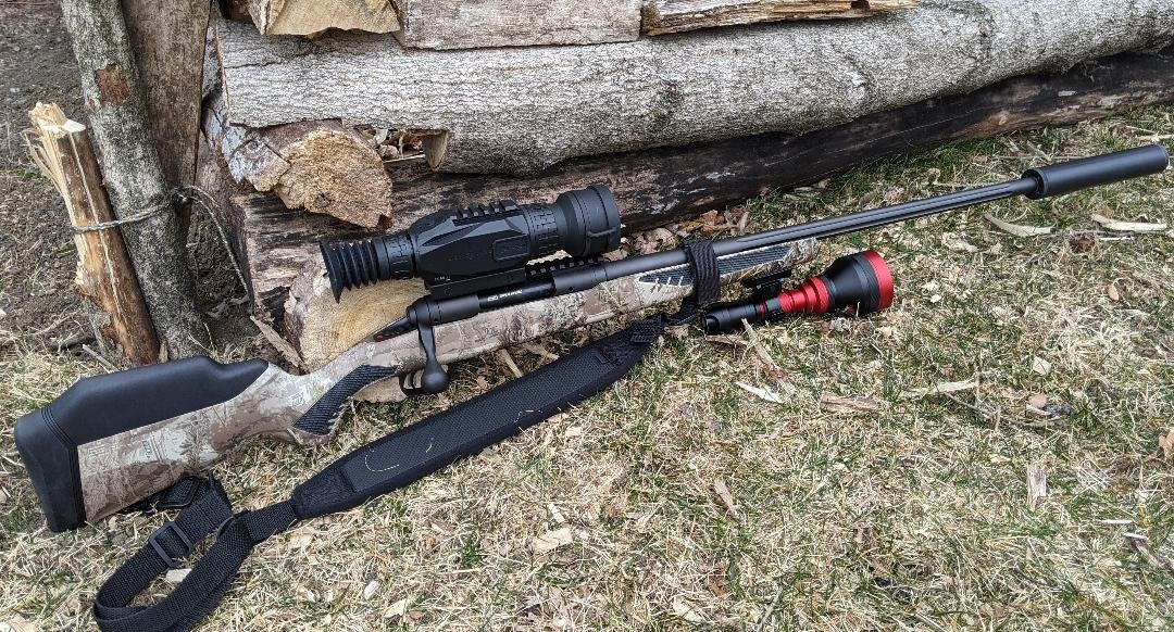

As it turns out, I went with 2 different rifles.
1. My daytime varmint rifle is a Savage Axis ll XP, in 22-250. I topped it off with a Vortex Diamondback Tactical 6-24x50 in a FFP version. This set up as proven to be a killer at long and short ranges for groundhogs and coyotes. My reloads of a 55 gr. Hornady V-Max bullet @ 3700 fps are producing sub-moa groups at 300 yards.
2. My nighttime rifle is a Savage Predator, in 243. I topped it off with a Sightmark Wraith and upgraded to a Sniper Hog 66 LRX IR light. I haven't had the time to get out to hunt with this rifle, yet. My reloads of a 75 gr. Hornady V-Max bullet @ 3400 fps are producing sub-moa groups at 200 yards. I have every confidence in this rifle's ability, as I've had similar Savage rifles in the same caliber and reloads that has killed coyotes out to 190 yards.
