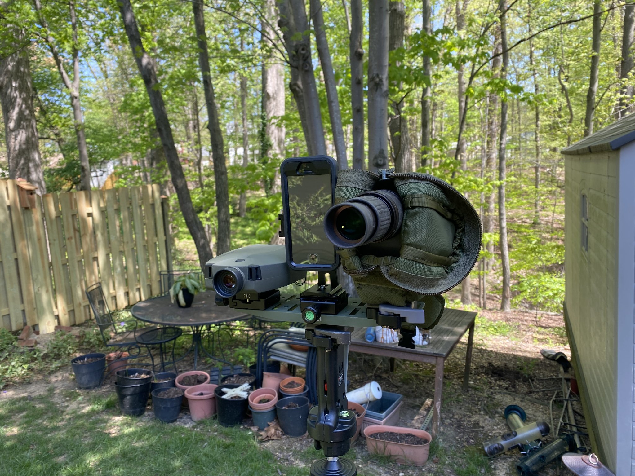

    So I just got my first tripod and I'm starting to think about putting a spotting scope system together. I've seen a few systems that have LRF/atmospheric and NVG / illuminator together. Would love to see what you guys are running for that (bonus points if it works at night)!
    Any discussion around use case for this type of stuff would be great too as I'm just starting down this rabbit hole. I've generally spotted for buddies while on my own rifle but want to learn more as I get into the 1,000+ range (starting a 300 NM build soon).
    If I've missed a thread where spotter setups are shown please point me in the right direction. Otherwise, here's a pic to get things started (pulled from another thread, sorry don't remember who to credit)

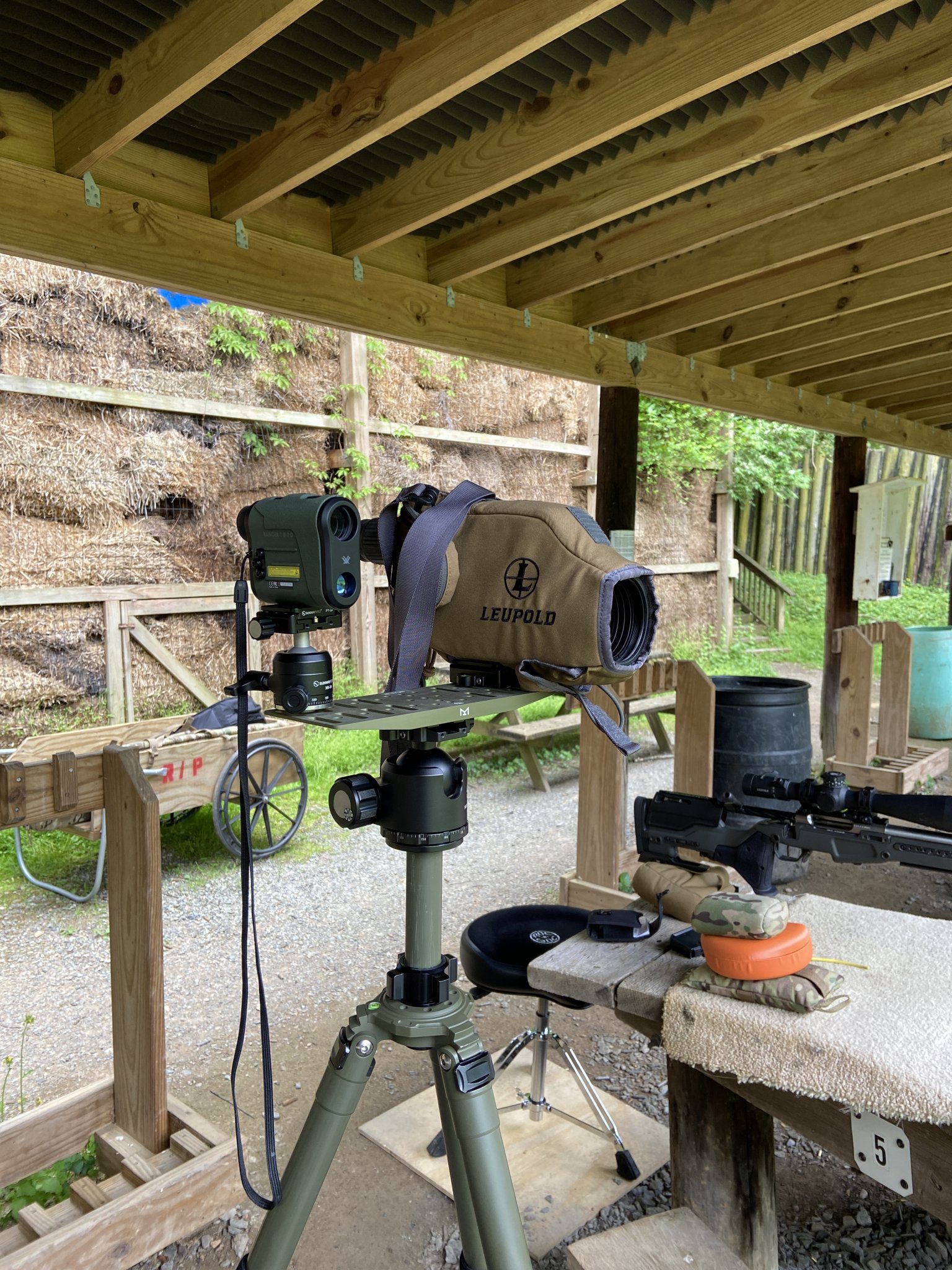

    My spotter doesn't have a good way to get on target quick, especially when I use the fixed 30x reticle eyepiece. It's not quite as bad with the 20-60 variable, but sometimes still a challenge to get it on a target.
    When I first set it up I like to use the rangefinders mini ballhead to align the rangefinder and spotter both onto the same distant point. Then the rest of the day I use the rangefinder as a rough sight, to get the spotter on target quicker. It's no prob finding targets using the 4x rangefinder as a rough coaxial aimer.

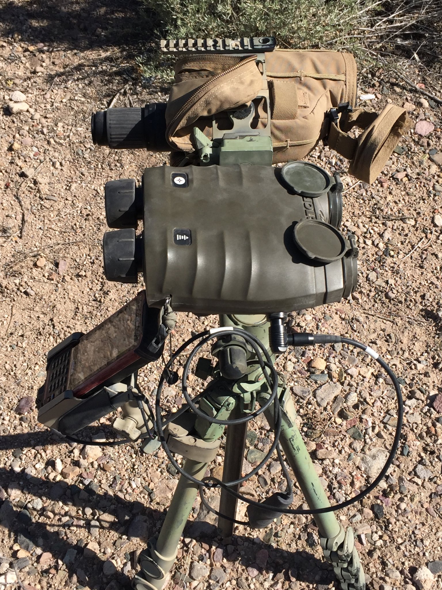

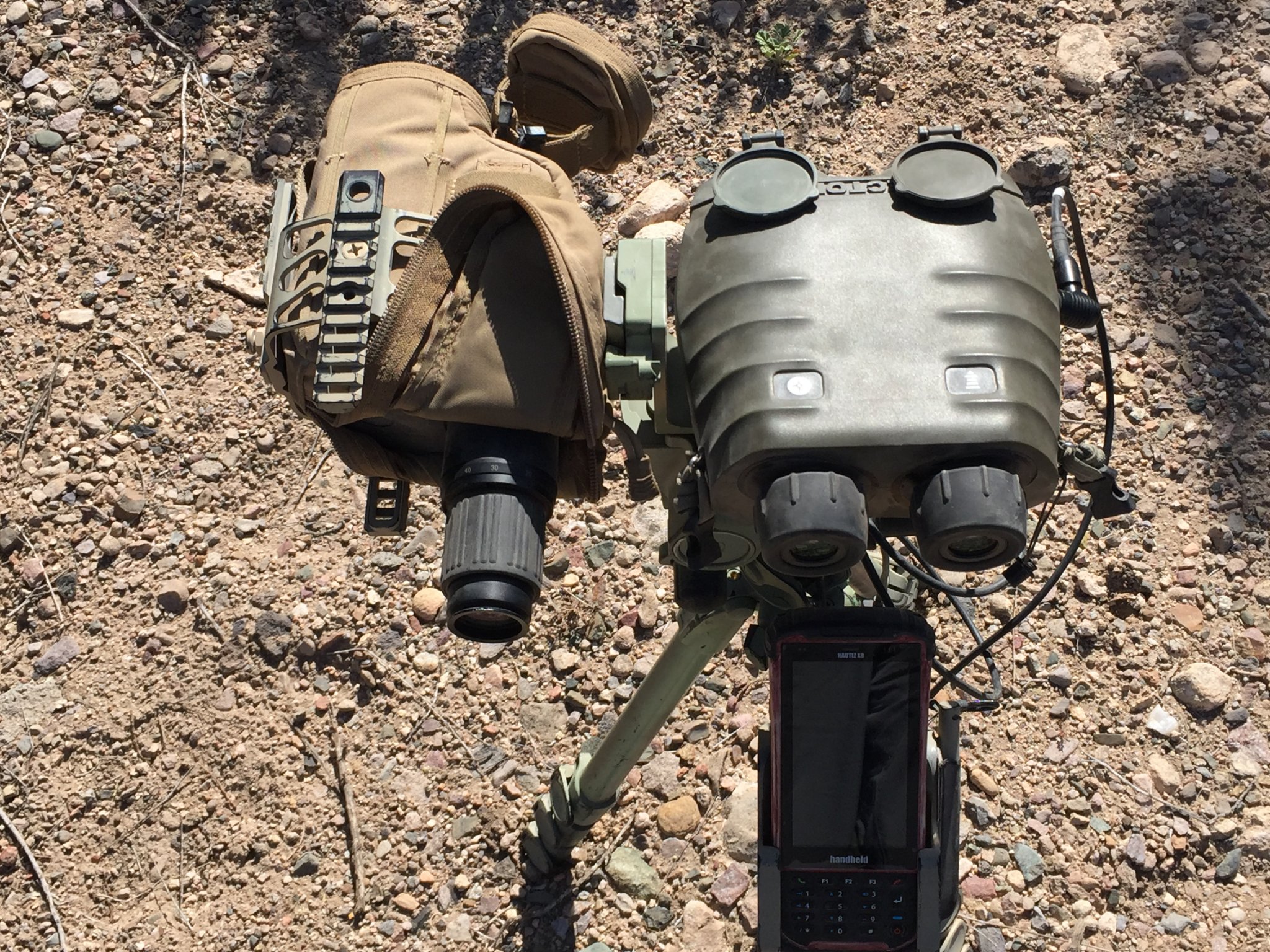

    This L3 RULR is insanity! 9000 meter rangefinder; Bluetooth remote and Bluetooth display HUD that straps to the side of the shooters scope, so he never has to take his eye off the target/ scope and knows the distance the spotter just ranged for him…
    EPIC!
    How much for this handy set up?

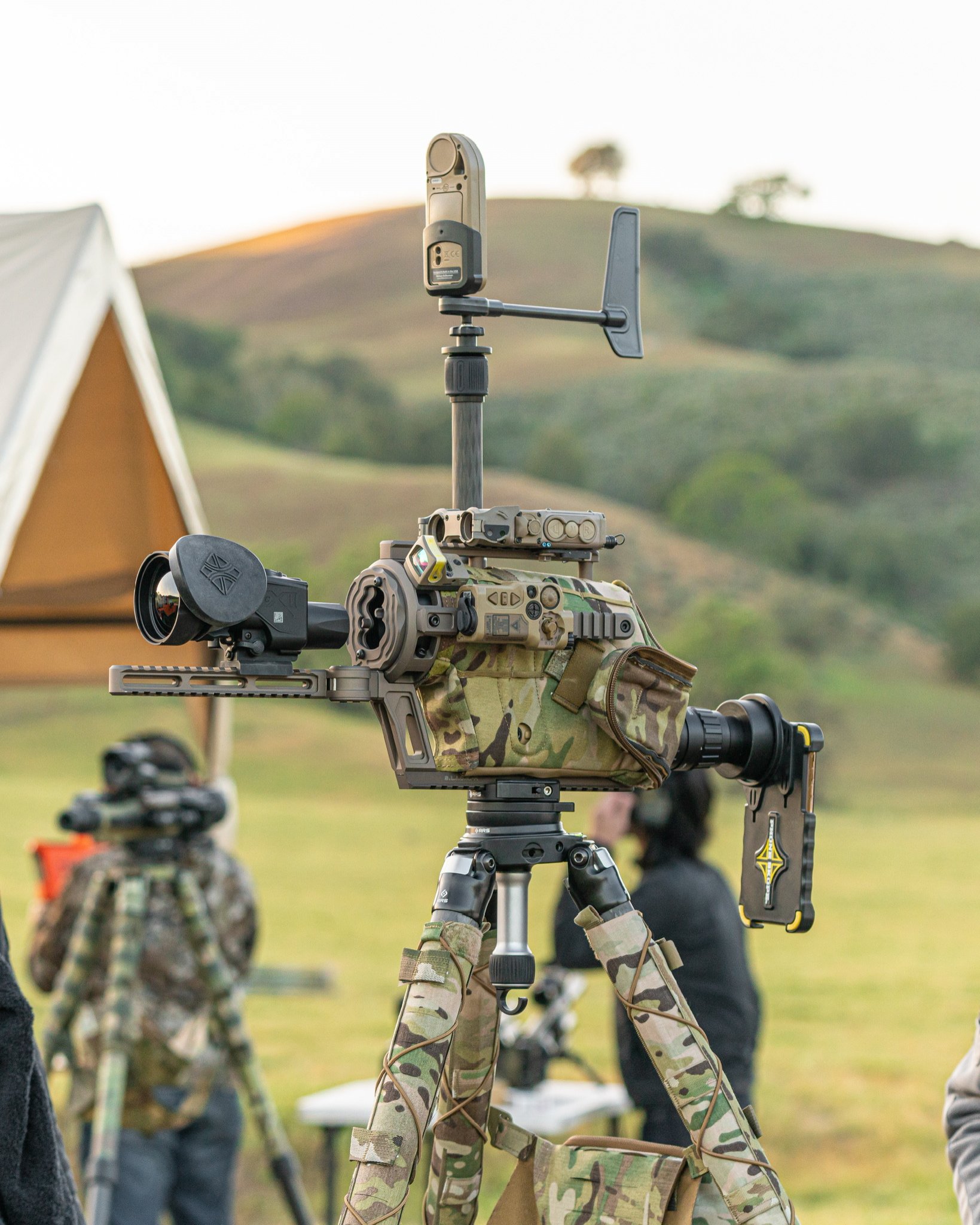

    Haven’t priced it out yet. The RULR was $24,000 when they were sold. I just picked this one up NEW with full kit for less than a quarter of that at $5000. Wanna know the coolest part, atleast to me…. I got serial number #3 off of production. My lucky number being three it was only right!View attachment 7838641
    $5k thought Cory had a bunch around $3000 for the last batch....

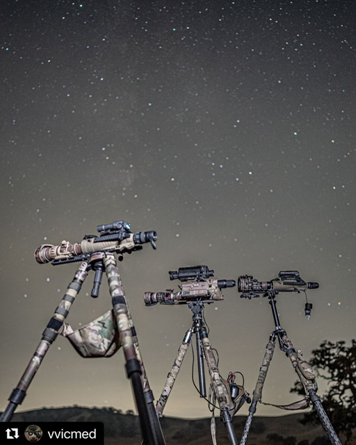

    Henny 60 with full Cadex surveillance rig, Tig, and Kestrel on a CF pole. I am working on getting one of Cory's RULRs for it. The Tig is on it just for grins but actually is surprisingly usable at 20x within a few hundred yards. When my xELR comes I will throw it on there and make a comparison video.

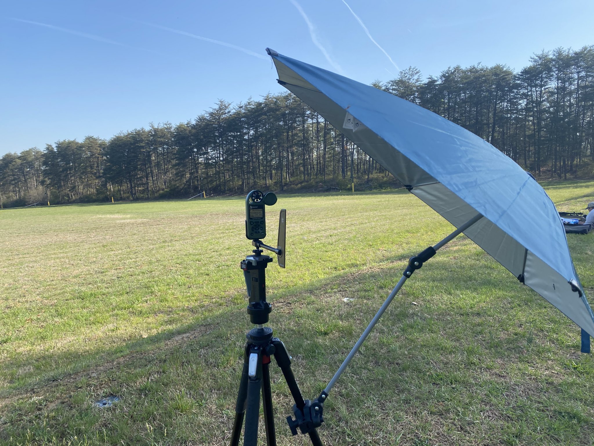

    That’s sweet. Are you tying your kestrel to anything or just doing manual readouts?
    Honestly I can’t say I’ve pushed the distance limit a lot, usually with this kind of set up I’m shooting on a fairly static range and I can put the Kestrel relatively close to my shooting position. Now I’m kind of curious though, I will have to see what kind of range it can do next time I’m out.

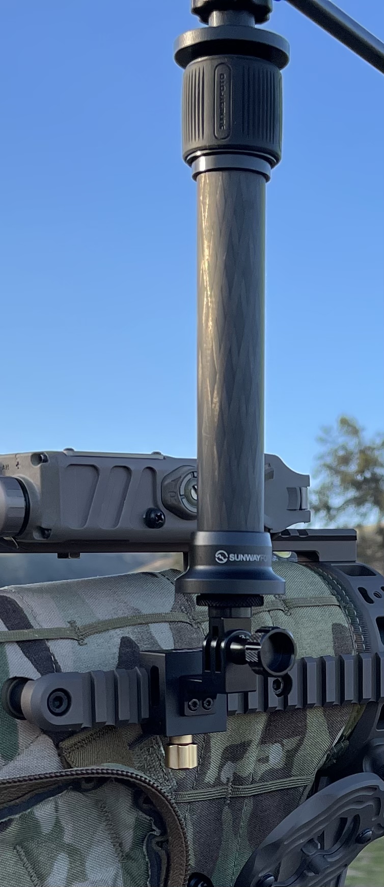

    Same query, any links to the kestrel riser pole and fittings?
    It’s a Sunwayfoto carbon tripod extender, a Leofoto 36mm leg collar, and a Smallrig 2903 swivel/tilt monitor mount. You will have to drill into the leg collar to accommodate the ARRI anti-rotation pins on the 2903 but it’s relatively straightforward.
    The other setup above is done with a picatinny rail grabber that mounts straight to the side of the spotter cage (there are more pics on Instagram). I didn’t want that exact setup because the Kestrel vane will lose its level every time you move the spotter, whereas mounting it to the leg allows you to move the spotter at will without adjusting the kestrel each time.
    Reactions: Keith E.
    champion thank you. Whose instagram page do you know?
    Check vvicmed, he’s got more pics of that setup with the Storm SLX (lucky mofo whoever got one of those). The Kestrel pole appears to be on some sort of right-angle GoPro picatinny mount.

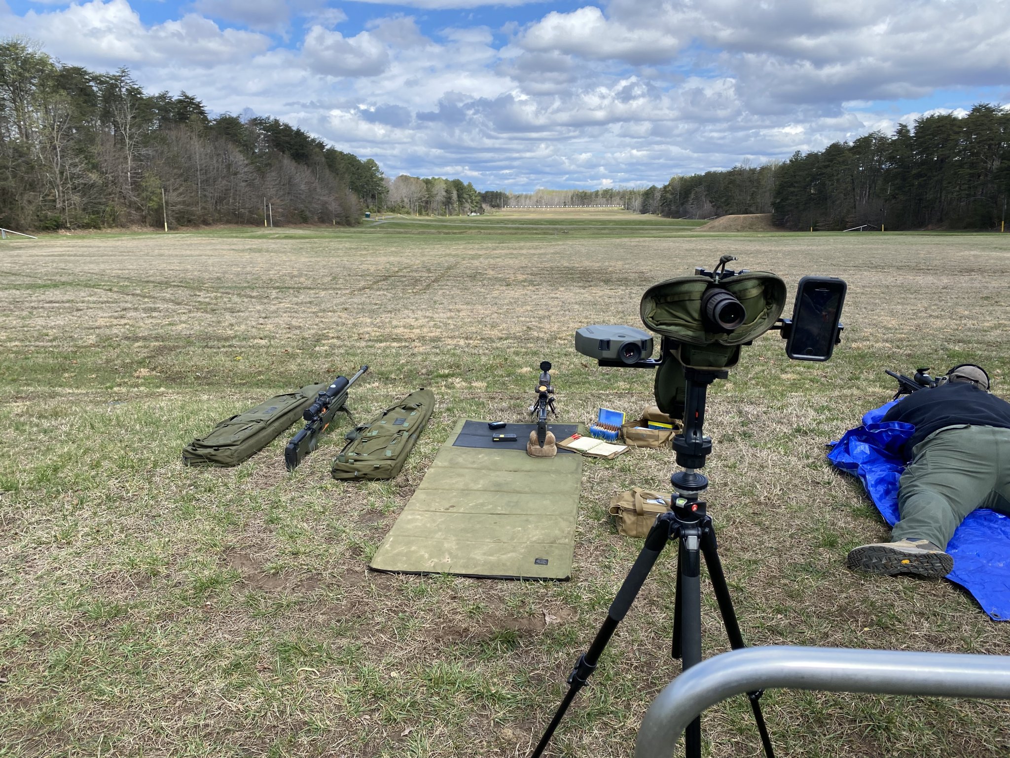

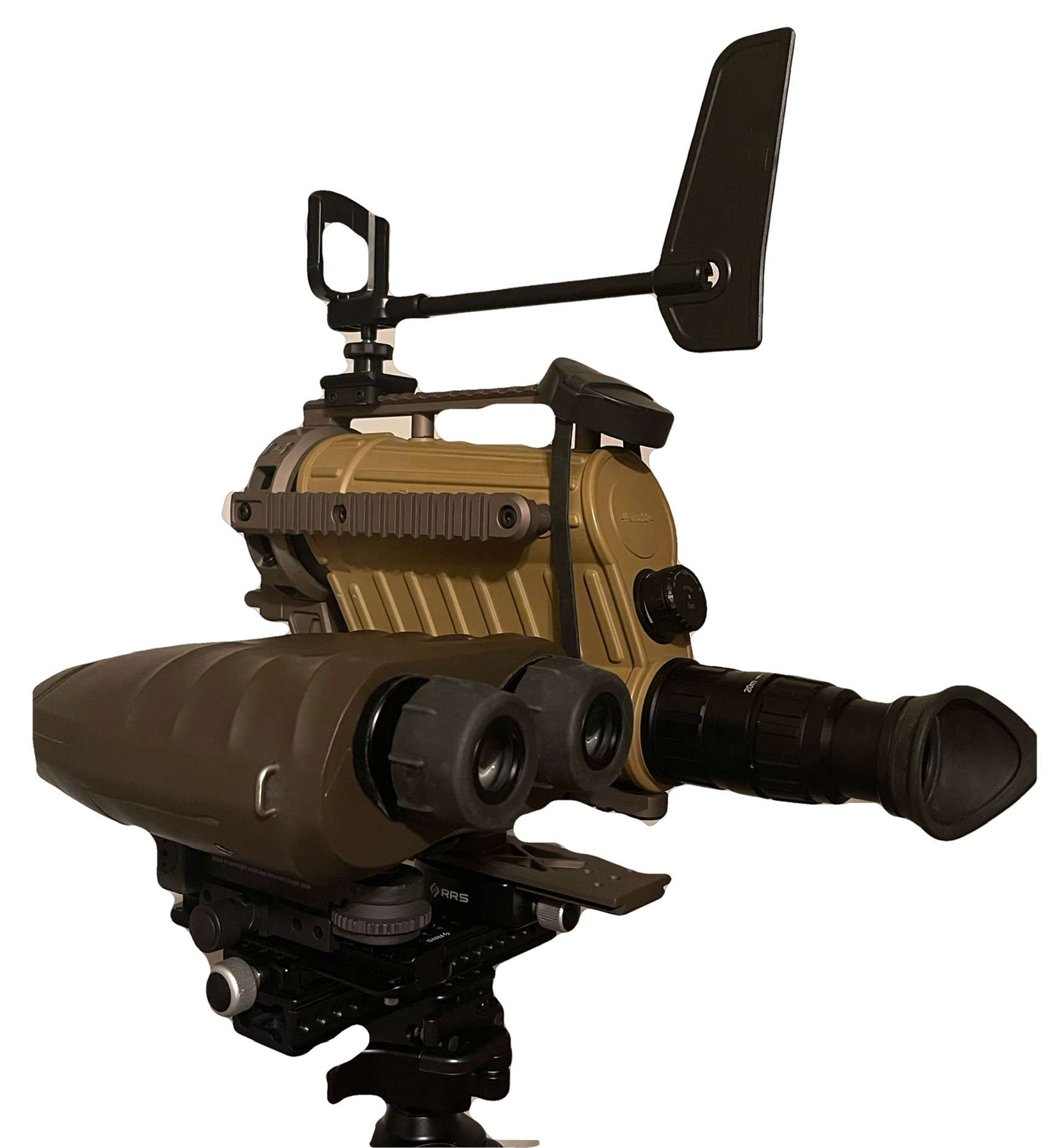

    That is my set-up, but conqueror pretty much called it correctly. Here is a closeup and all the parts can be found on Amazon. I prefer to mount everything to the spotter so I don’t have to worry about crashing into a pole or repositioning the tripod legs when I pan around. You do have to pay attention to level though.

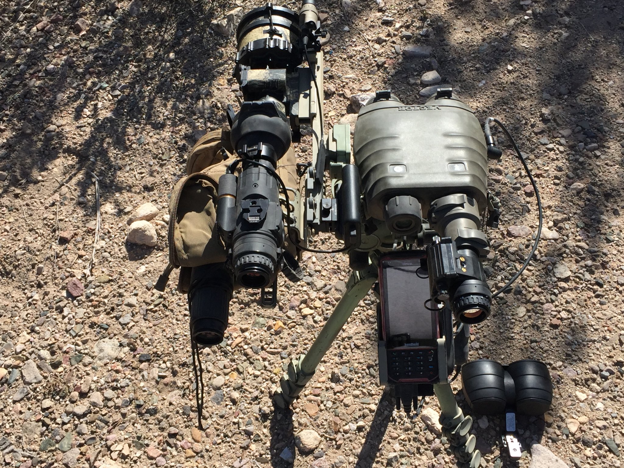

    Basic day configuration - Leupold 12-40 TMR in Cadex cage, Vector 21A slaved to Nautiz X8 running Field Firing Solutions. L bracket mount to get co-witness mounted to Manfrotto 410 gear head.

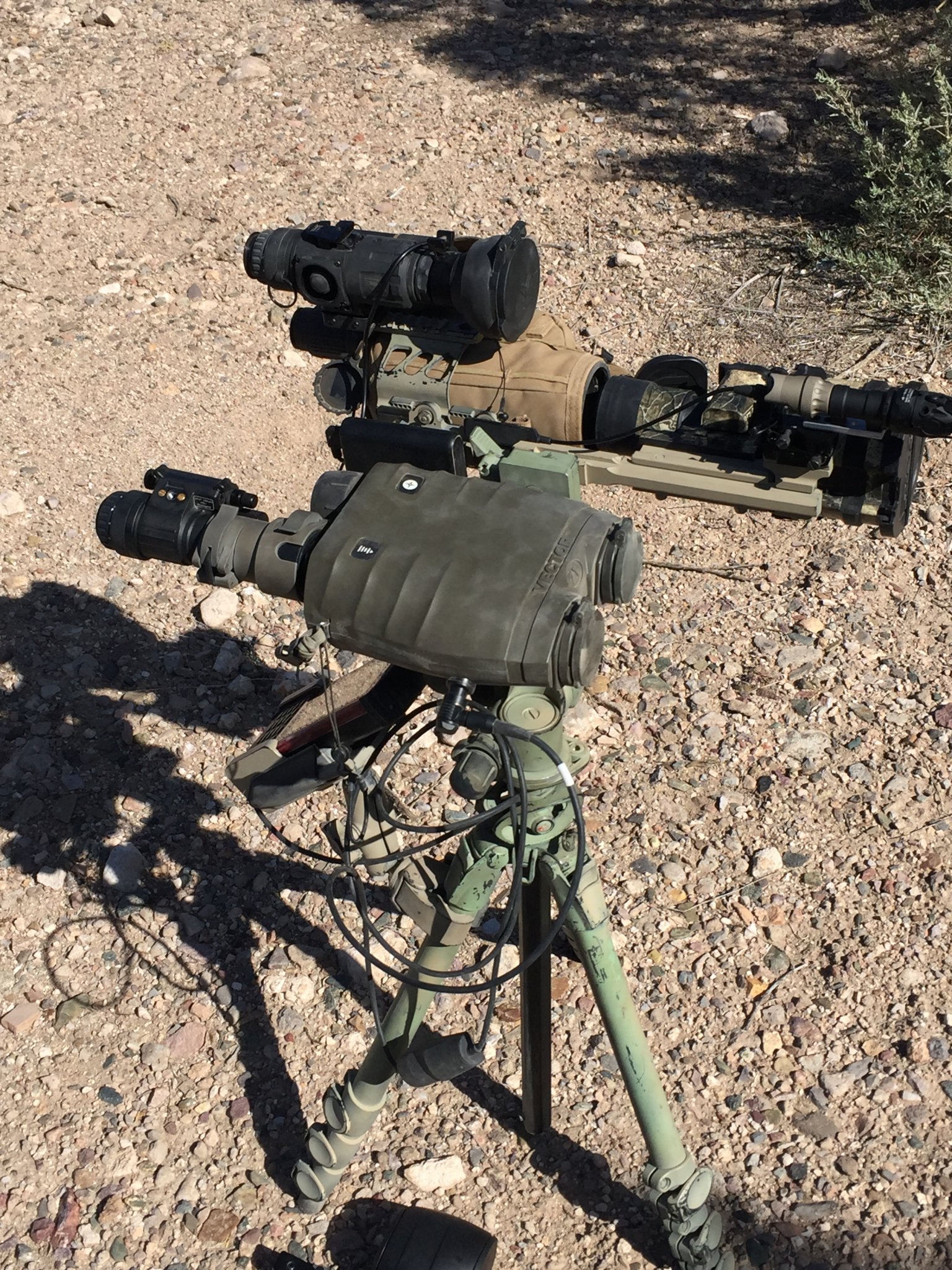

    In full night mode, PVS-14 on the Vector, PVS-27 ahead of the Leupold with KIJI for extra illumination, IR-Patrol M300W with 3x lens for thermal target detection. The 10x lens for the Vectors can be added to any configuration.
    In night mode, I normally add shuttered eye guards to everything. I still need to score a longer remote cable for the KIJI though.

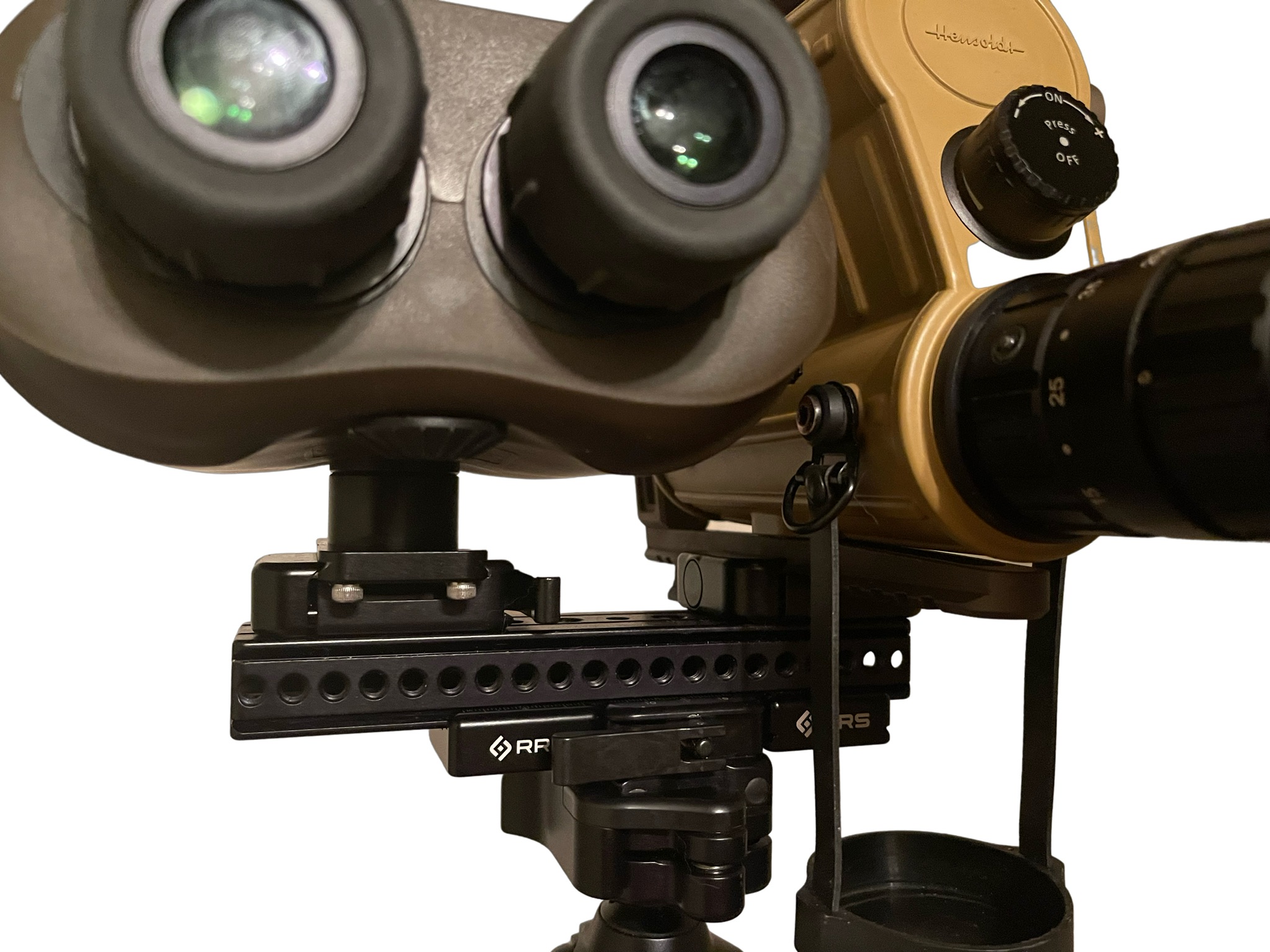

    For ELR work I often use a Pentax ED 80 with a modified Burris reticle eyepiece. That’s fantastic glass, but very large, and very hard to get NV suitably mounted.
    The Hendsolt scopes are great glass, but the reticles are pretty crappy. The 45 with the Tremor is usable, but I won’t pay the premium for what I view as a marginal reticle.
    The Vortex scopes seem usable, but the fixed power for the Mil eyepiece is a downer, it needs a FFP reticle installed.
    The Swarovski STR 80 is nice, though a bit large. The eye relief makes it a non-starter for eyeglass wearers.
    All the others I’ve seen have no better glass then the Leopold, with far worse reticles.
