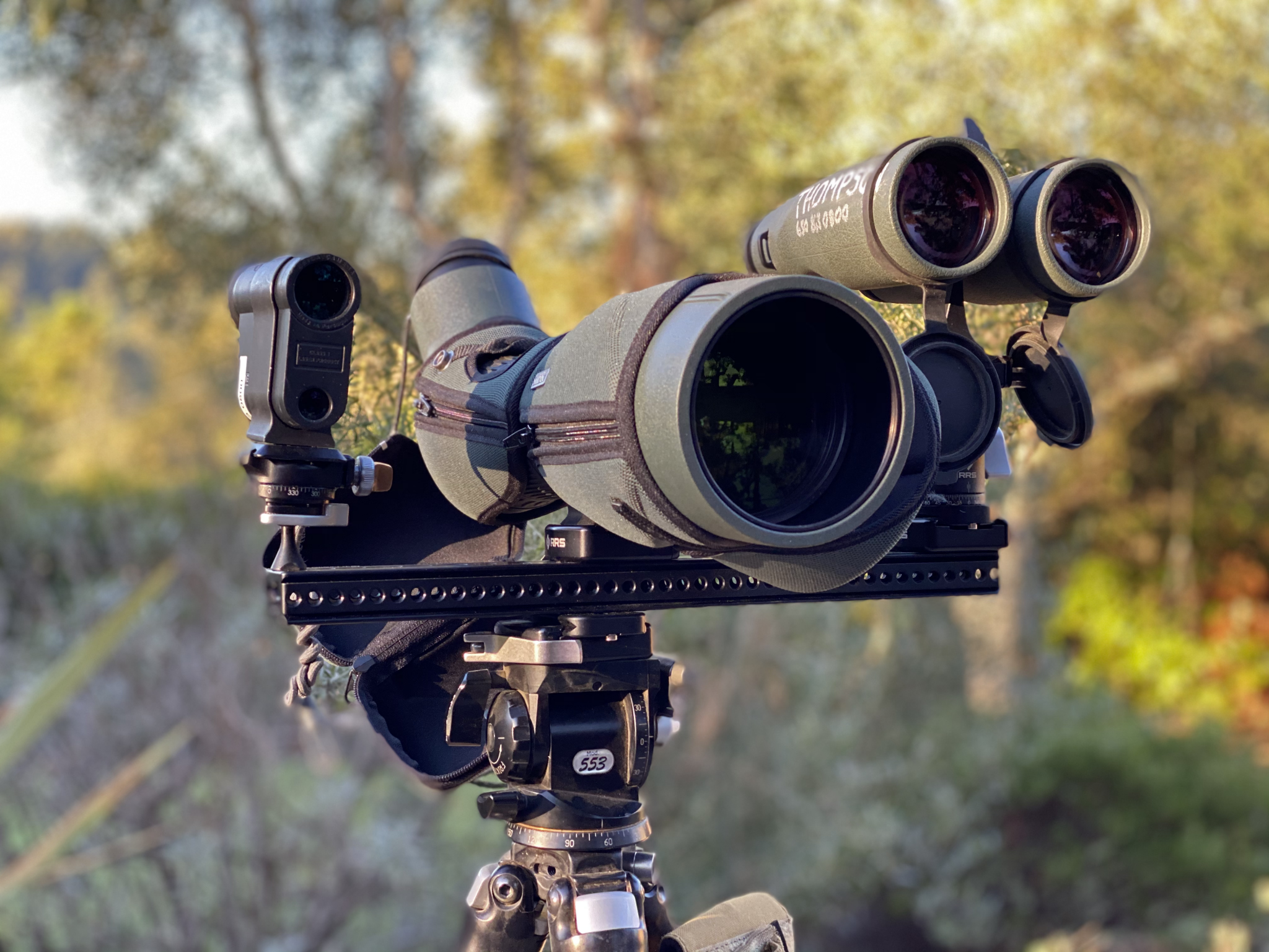

This is my road spotting setup. We’re looking for Elk generally 1,500 -2,500 yards away. Even then, 90% of the time we are on our Binos. The best part is these are co-witnessed and all about the same eye height, so if you see something on the binos as you grid glass and need clarification from the spotter, you simply peer into the spotter, with very little movement if any.
I have several Swaro ATX spotters, Several Swaro Binos (8~15x), and one of my favorites, a set of Mavens 11x. Side note, that’s just the stuff that has earned its spot in my heart. I bought and got rid of many thousands of dollars worth of glass, I wish I didn’t have to learn this through many years and dollars regarding what not to do.
In a nutshell, for matches I bring my Swaro Binos for PRS and PRS style matches, never a spotter anymore. We can see the trace, have a wide FOV, can be used without a tripod, and is comfortable.
The spotters during the day heat and bright light generally need to be dialed down. Today’s top-end scopes with 25x resolve hits on steel just about as well under these conditions as a top-end spotter and much better than almost all of the cheap ones. If you’re having trouble seeing the impacts, but can after switching to a spotter post shot, I’d consider upgrading your scope first.
In order of priority for what and how you suggesting you shoot, I’d still recommend a good set of Binos, then upgrade the glass for your scope if that’s an issue, and finally a good spotter.

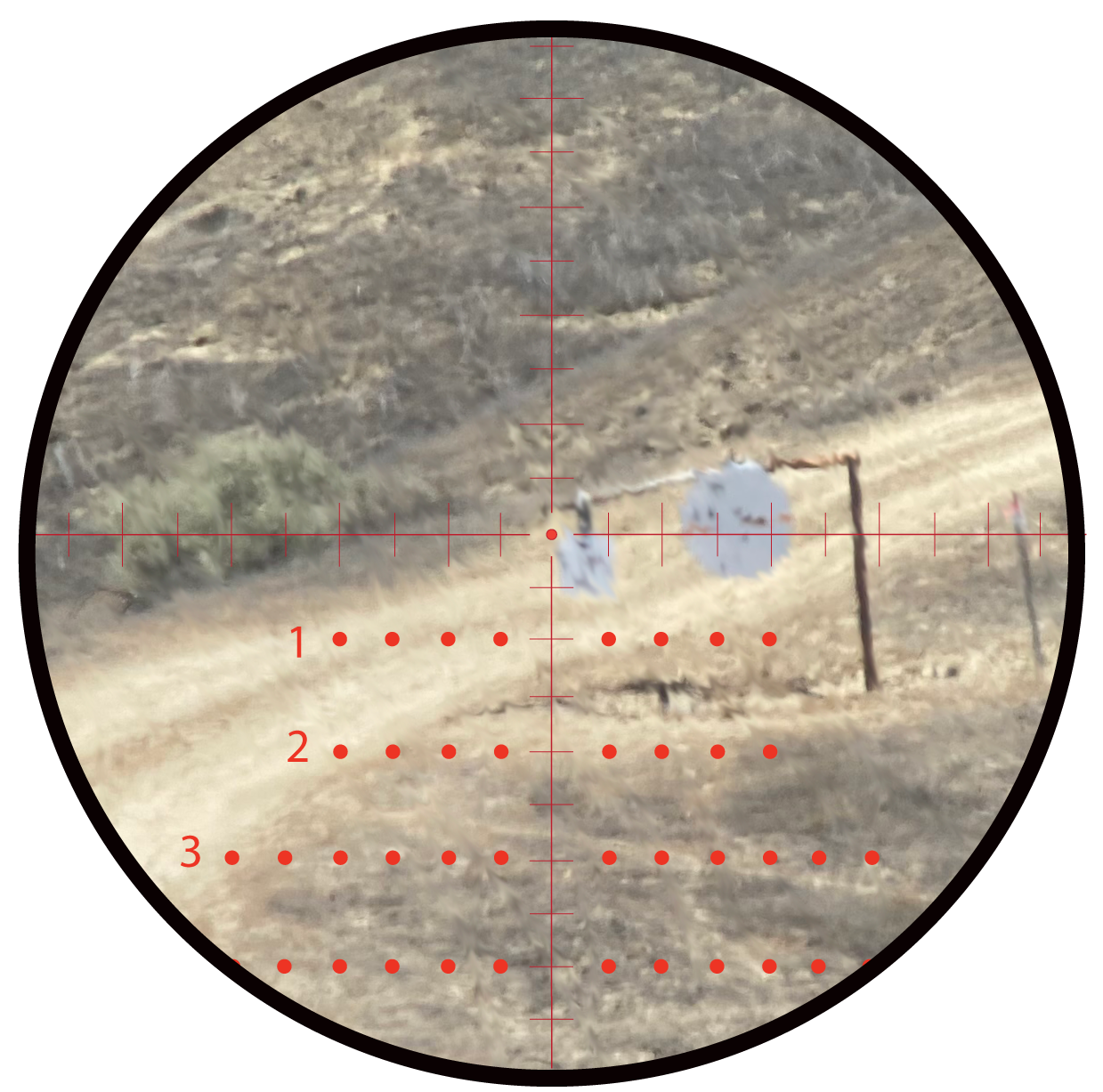

No rets in most of the good glass, the ones available lack the detail you’d want for accurate corrections; to be honest, 15x too much power except for PRS/range and hunting here out West. Swaro, Meopta, Maven, Zeiss and Lieca are at the top of my list for general quality.
FYI- mostly at the matches were trying to get wind info and impact location, but NOT calling corrections!

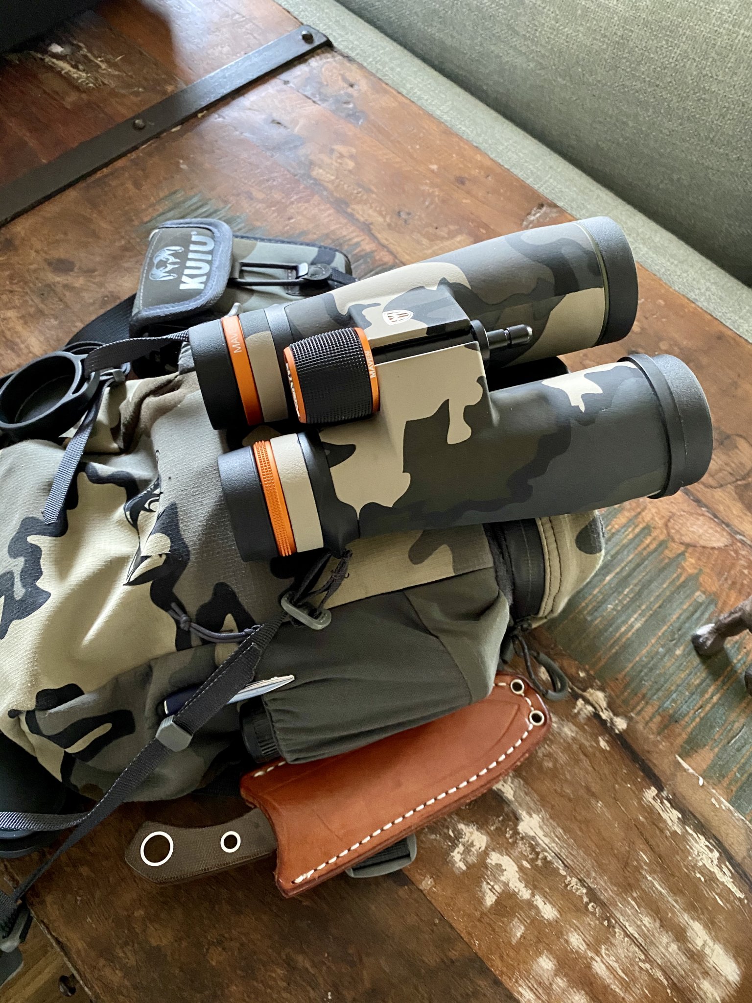

So far they are my favorite Binos just for how easy they are to get behind. I can’t attest to their lower cost line.
I wanted something somewhat compact and went for the B2 line 11x45s. As mentioned compared to my Swaros, they just are more comfortable and it "feels" like the image is more edge to edge in my eyes than my 10x42 Swaros. As someone who wears glasses, the ability for the spotter or binos to accommodate them is important, that said I usually spot without classes. Super high marks on both ends.
I think at the top level to see the resolution/clarity difference you need tripods and many side by side tests in various conditions. Even if the resolution is somewhat better on the Swaros, using the Mavens for me just feels better. They also have the B.5 line that feature pair of 15x56 at $1,500 on par with the $1,600 Meopta 15x56 MeoStar B1 and the $2,300 Swarovsiki SLC 15x56. In this case, the Swaro edges them both out ever so slightly if you work really hard to find the differences.
As far as the spotter is concerned, I'd get a Maven over my Razor and over the Swaro AT"S" I had. My Swaro AT"X" with the 85 is slightly bigger/ better but almost $1,500 more- I've run these side by side from bright sun, where you can hardly see a difference too to dark to shoot where it become obvious.
Maven uses a model like KIUI, direct to consumer to make the end cost more competitive.

I would personally spend more on the spotter. You can't pick up vapor trails, read mirage, read corrections, etc...without good glass on the spotter. Again the Leupold 12-40x60mm with the TMR (mil) reticle is just about perfect as it is in just the right zoom range for the field, has great glass and has a reticle. Leupold also has a good discount program for military, LE and certified NRA instructors.
That being said, you may get addicted to good glass and want to upgrade the binoculars later.
