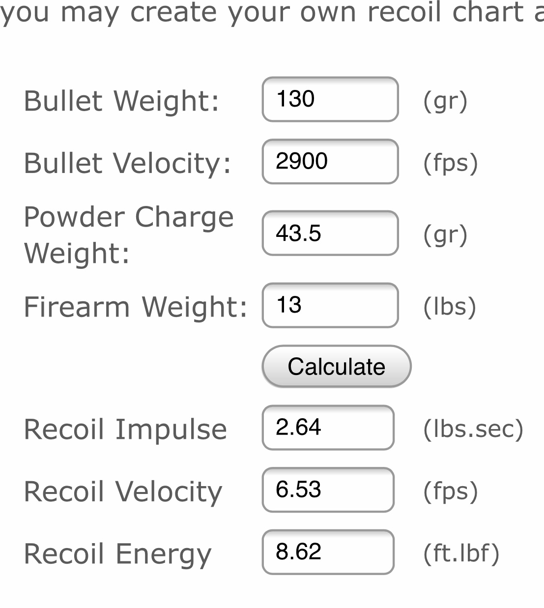

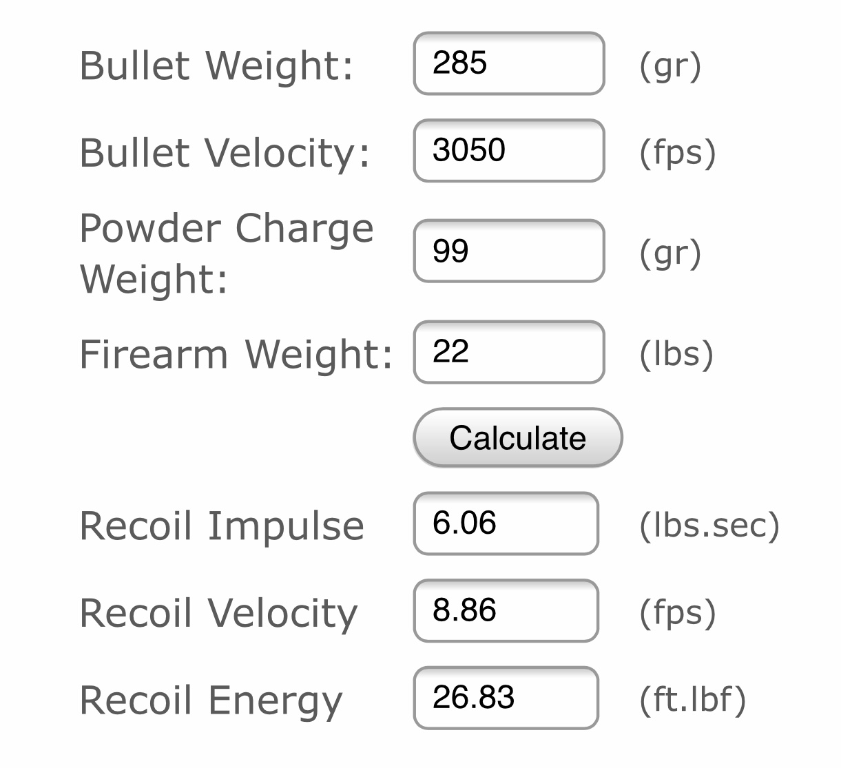

I can spot my shots with my 13# 260, my friends 15# 338 Norma, my 18# 7 saum and my 22# 338 edge.

My 260 and 338 edge
