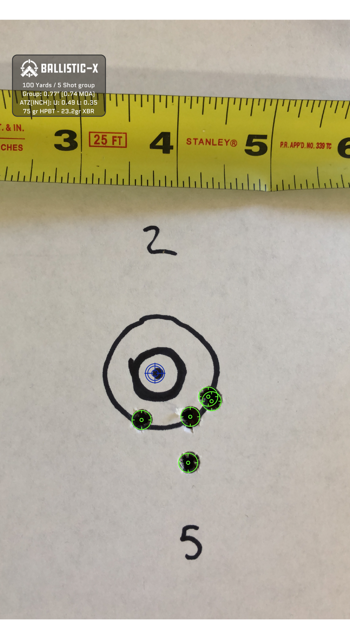

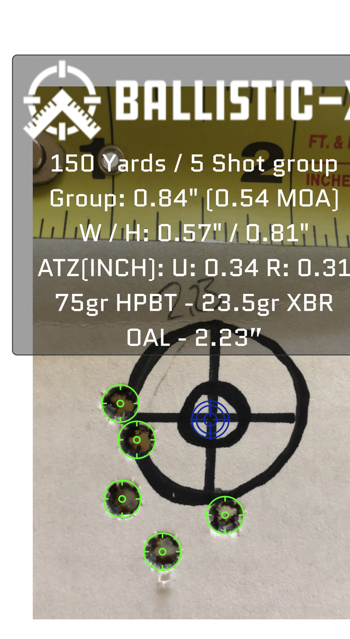

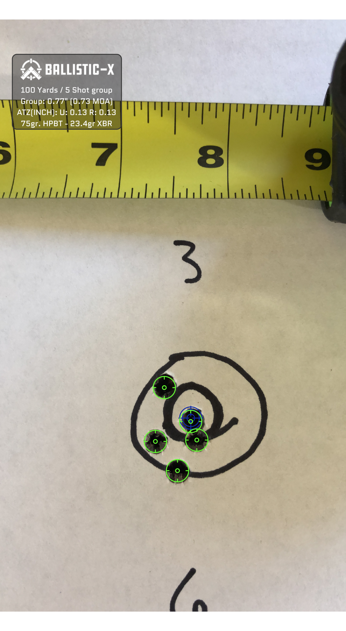

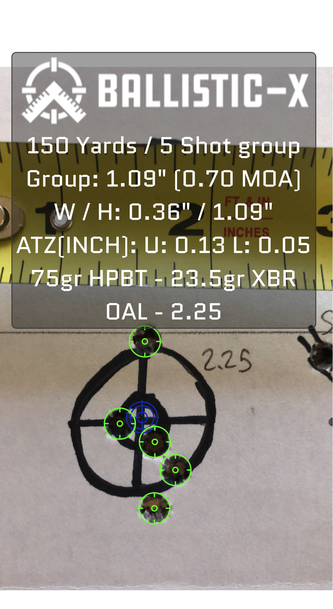

    That 4.5lb SSA trigger I had is what I learned on and used for load development. It is a great trigger and shooting prone can be shot well, just ask service rifle guys.....but damn does a 1.5-2lbs trigger make barricade shooting much better.
    All the following were done with my Vortex PST gen 1 2.5-10 and that 4.5lb SSA trigger... Needless to say, the upgrades have made it easier to be more consistent.

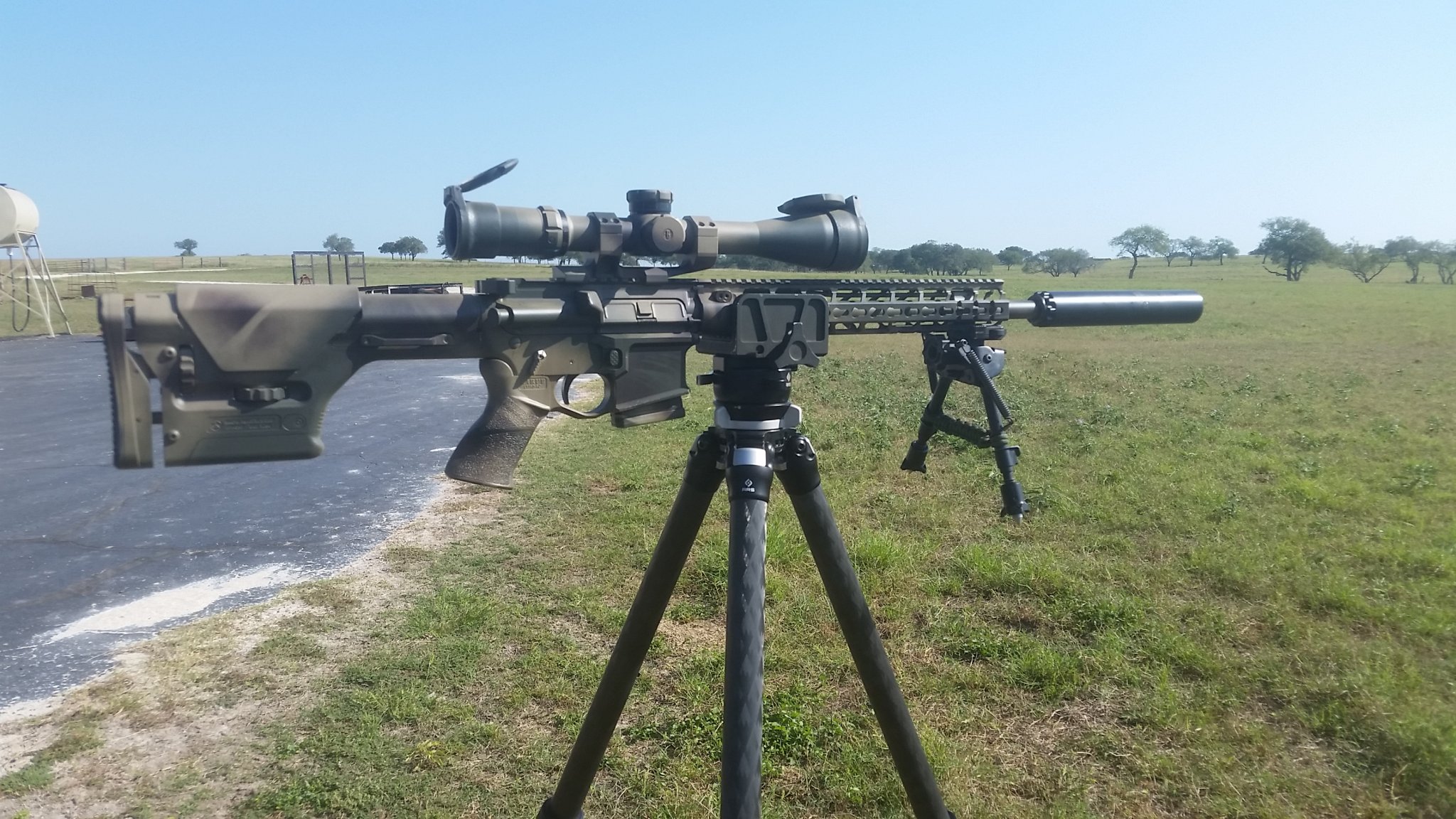

    I have a fair bit of experience at DMR-type matches and in my experience here are some things that I've noticed and/or taken away from them.
    1. Given the choice, I'd take a 5.56 gun with a good barrel, 16"-18" in length, over a large frame gas gun or one in 6.5G/6ARC/.224V/etc... On average, it will be far more reliable with lower recoil and a higher magazine capacity so while they're trying to recover from their first shot, spot their miss, make a correction, and/or unfuck their double feed, you're already on to the next target. I've seen it happen numerous times and I've been in no hurry to make a caliber change.
    2. Within DMR ranges, 600 yards and in, the above paired with good 77gr match ammo will hang with any of the above in so far as simply getting hits is concerned. Obviously the larger calibers will carry more energy to the target but that too carries some penalties in a match because if it's a small swinger, the guys with heavy hitters are going to have to wait longer for it to settle before they can engage it again.
    3. I like having more magnification than a LPVO like a 1-4 or 1-6 can provide, it's just not enough mag in most cases to spot my hits and misses because you can't always rely on the spotter. True story, I watched a shooter time out on an easy four or five target stage because he couldn't see that he was repeatedly hitting Target 2 and could move on to Target 3. The spotter was calling his hits but I guess with his ear pro on he couldn't hear it, anyway the guy ended up crying like a bitch about it, literally. To that end I think 10X is a good starting point but personally 3-15's and 4-16's with a FFP are the sweet spot for me. I can dial them down when I want to open up the FOV but can also dial them up for long range shots if I need it. That came in real handy when we had some really long shots, stretching things out to about 900 yards or so.
    4. I love a good trigger, I like a nice non-adjustable 2-stage 3.5-4.0 lb trigger. Simple, safe, and reliable. I prefer Geissele.
    5. I like a 13" handguard because it gets the bipod out front but still reachable so I can easily made adjustments but it's not so long that it interferes with my Magnetospeed Sporter. I run two pic rails on the bottom, one as far back as I can get it and one as far forward as I can get it. This gives me some options on where I can put the bipod to give me flexibility in dealing with different types of obstacles and barricades.
    6. Accuracy wise, I like my DMR and SPR rifles to be able to do about 1.0 MOA with match ammo. I could strive for sub-MOA and blow through loads of cash doing it but if I'm around MOA then I'll be fine on just about all of the targets that I encounter.
    Edited to add: 7. I wanted to touch on stocks a little bit. I like a collapsible stock with a clubfoot so that it integrates a little better with a rear bag. I've used Magpul CTR, SL, SL-S, and BCM Gunfighter stocks but none of them really did well with a bag. I much prefer the BCM SOPMOD Mod 1 with the clubfoot or Vltor E-Mod, they've been perfect for the precision carbine role. I don't get wrapped up in adjustable cheek pieces and what not, I generally don't need it since the sight height for irons is about what it is with my optic in a one piece mount.

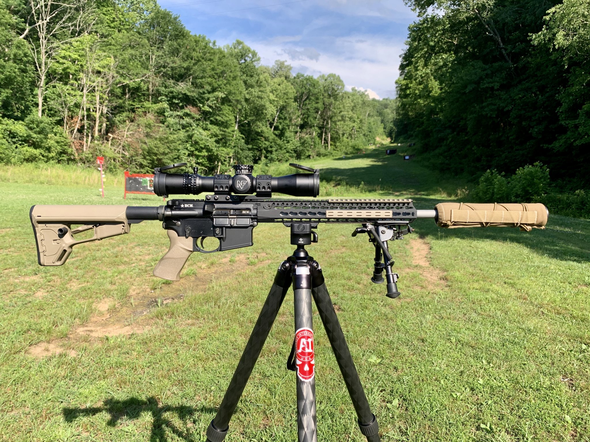

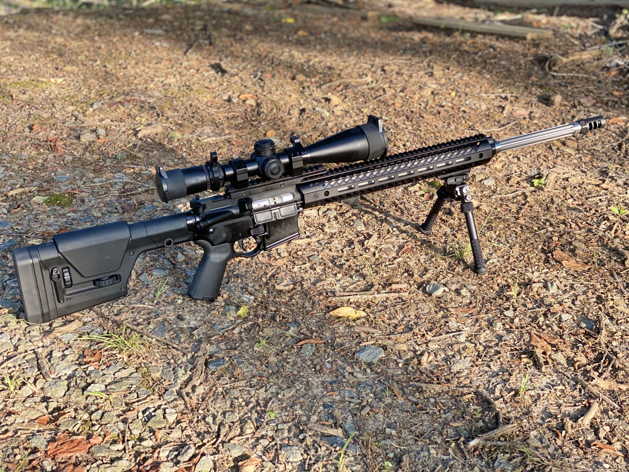

    To reinforce what @Trigger Monkey spoke of above, here is an example:
    16" BCM/CLE/Douglas upper with a 13" KMR handguard. NF 4-16x42 F1 in a Spuhr. Geissele SSA-E. Magpul ACS-L stock.
    The barrel is a Douglas spun up by CLE, with their chamber, which is a 16" recon mid-length 1:7" configuration. Only notable difference is 5/8-24 muzzle threads.
    It is a snug chamber. Factory new Hornady brass barely fits the chamber. New Lapua or Federal are fine. There was a 0.002" headspace difference with the Hornady being longer than the Lapua/Federal. It flat out shoots. I think the average of every group shot over the first 200 rounds is in the 0.6-0.75" range. Velocity isn't a concern as a 75/77 grain bullet is coming out at 2625-2650 fps. Plenty for 600 yards.
    Bipod stud up front. Rail section in the rear to clip into the tripod. I prefer the Harris over the Atlas on the SPR style rifle.
    Magpul ACS-L gives a solid area for cheek weld, locks up snug, and provides the club foot for a rear bag.
    Weight is favorable coming in at 9.5 pounds without the can and ammo. Say 11 pounds with the muffler and 20 rounds.
    On the optic: skip the 1-8. I had the NX8 on a different 16" upper, and it isn't conducive to precision. I originally went to the NF 2.5-10x42 on this rifle. It works, but the NF 4-16x42 is tits. I'm usually in the 12-14x range.

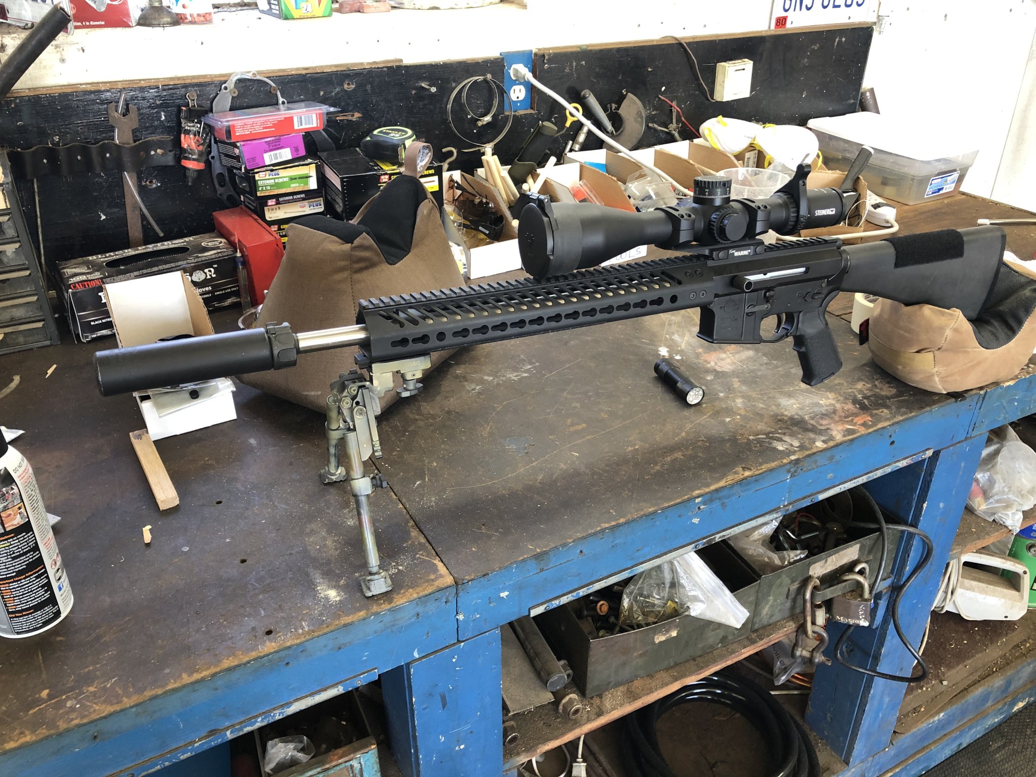

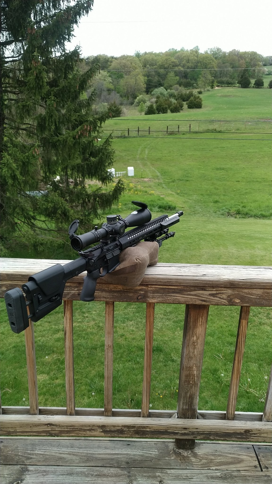

    This is the setup I prefer for dmr type matches.
    16” Ranier “match” grade barrel, 223 Wilde chamber (nothing fancy, but gets the job done). Produces 1 MOA 10 shot groups with unsorted LC brass, 23.2gr 8208xbr, 77gr smk loaded to mag length. Bushnell LRTSi 3–12x44. It’s maneuverable, accurate, and reliable.
    At these style of matches, reliability is key (both mechanical operating reliability, as well as accuracy reliability over rapid and/or long strings of fire). I’ve seen plenty of shooters get destroyed by reliability issues. 5-12x is a pretty good sweet spot, especially when paired with solid tracking and/or a good reticle.

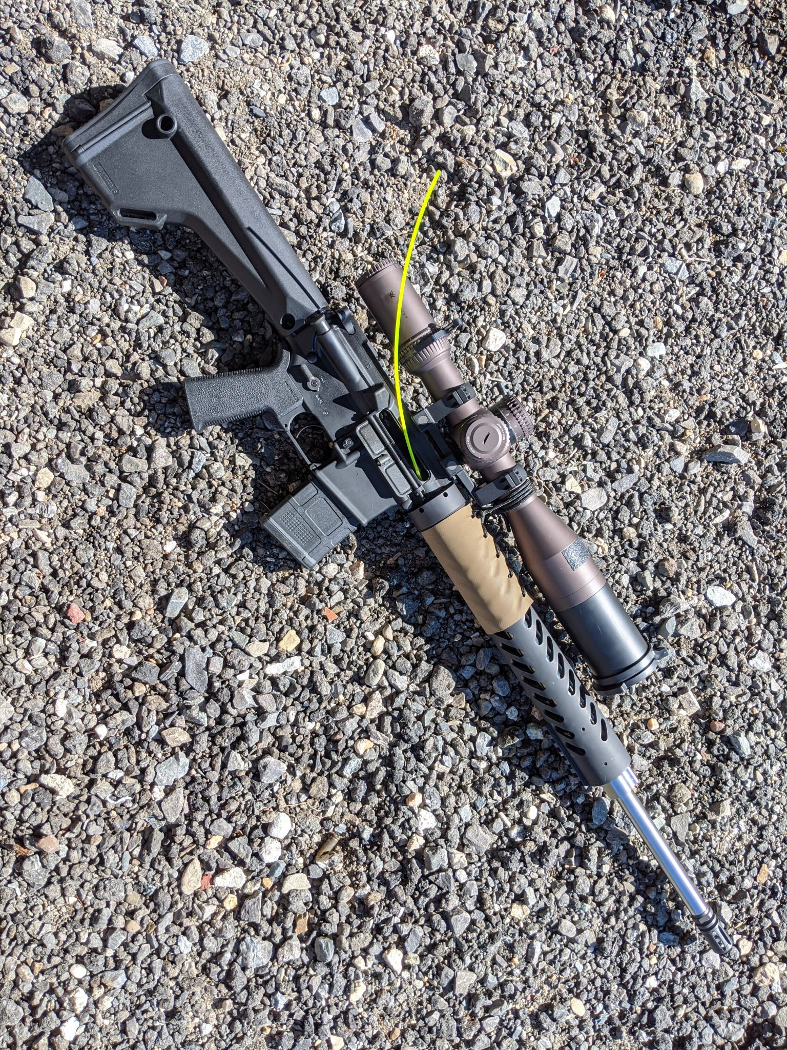

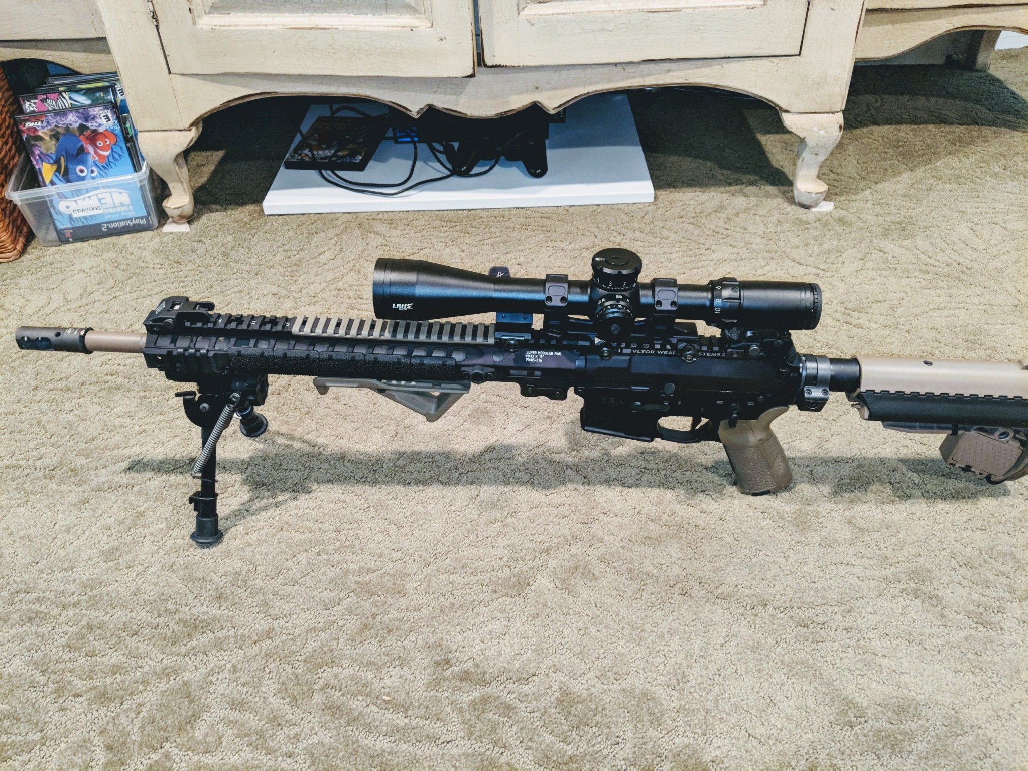

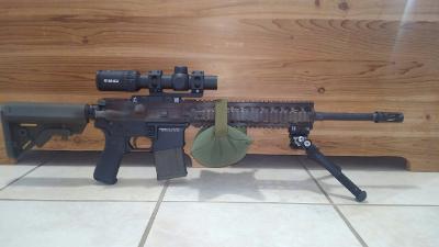

    Really been digging this rifle.
    FCD upper, proof barrel, giessele handguard, cmc trigger, LMT DMR buttstock, LMT BCG, currently on an aero m4elower but my LMT MARS lower gets here today. Gen 2 viper 3-5 and a YHM turbo, atlas CAL with the RRS arca clamp
    shooting imi razorcore 77gr it’s around a 3/4 minute gun.

    Late to the thread, but just ran this in a local precision rifle match. The barricades are very unstable and the range to targets is generally 450-650 and about 2moa in size with a 2 min time limit and no follow up shots; so first round hits are critical.
    Key features are factory 77gr Federal Gold Medal Match at ~2650fps through a Proof 20" carbon barrel thermal fitted to a forged BCM upper, Geissele handguard (with that insane barrel nut), Geissele high speed national match trigger with the lightest possible first stage (about 1.5lbs) and about 2.5lbs DMR second stage. Geissele gas block, Leupold mk 5 with a Tremor3 reticle, and full JP LMOS internals.
    Managed a 2nd place among gas guns, 11th over all. Had good luck with the wind thanks to the reticle and ability to follow up fast.
    Edit: on the discussion of triggers, I think it's more important to have a short as possible lock time with a crisp break rather than extremely light weight. Ultimately that's what sets high power rifle shooters apart at matches like Camp Perry. Even on a barricade the reticle "walks" around from where you're trying to aim. Being able to break the trigger and have the round ignite in the chamber within 3-4 milliseconds instead of 15+ milliseconds means less deviation off point of aim
