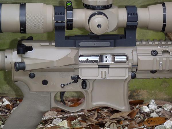

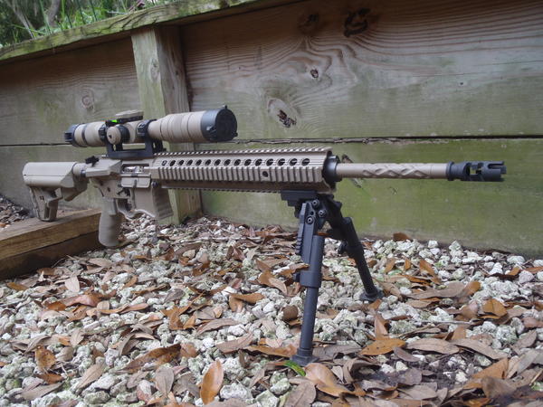

    I've had a hole in my safe for an SPR for some time but its one of those rifles that's been on the back burner, but I fell into this deal that I couldn't refuse...
    Seekins matched upper and lower
    Troy rails
    Magpul ACS
    Fluted DEZ 20" match barrel, 1-9 twist
    PWS flash hider
    Chrome plated BCG (don't know whose)
    USO 1.8-10X (had it lying around)
    12.5 lbs with optic (no mag)
    JP trigger (not a fan but it works)
    This is my 1st Seekins platform and I gotta say...really nice freakin' receivers.

    Nice Rig! Black Hills 77s are still hard to come by these days. But definitely cheaper than a 338 laupa.

    This should do fairly well with FGM 69's. Strangely enough I was told the twist was 1 in 8.5 but the barrel is stamped 1-9. Not sure what the logic behind that choice was or even if its true but DEZ barrels aren't exactly top tier to begin with so I can't complain. I'll find out how she shoots tomorrow. If I can hit a 12" plate at 600 I'll be happy and it will suit my purposes. Its mostly a positional trainer and I'll be happy with 1-1.2 MOA
    I got to take it out today and except for a bolt that was slightly "over-chromed" it's an impressive shooter. The bolt kept locking up so I had to break position and free it between shots so I simply adjusted to center punch one round @ 100 and just called it zeroed. Then moved directly to 600.
    In spite of the bolt lockup and unjamming between shots, the 1st 3 rounds printed at the left edge of the plate just under 1/2 MOA. Almost couldn't believe what I was seeing. After unjamming the bolt again the wind kicked up and the next was close to centerline and the last 2 printed at the right edge. I didn't correct for wind/elevation since I just wanted to get a feel for the barrel and I didn't trust the zero to be perfect, but I'd say it's a hammer running FGMM 69's. Vertical spread was @ 5.75". I'll take that any day from a 5.56 @ 600
    After bringing it home I discovered that the bolt cam was simply too tight so I lapped it out and it feels night and day different. Quite surprising for a Frankengun. Hopefully the jamming is cured and I can just drop in a better trigger
