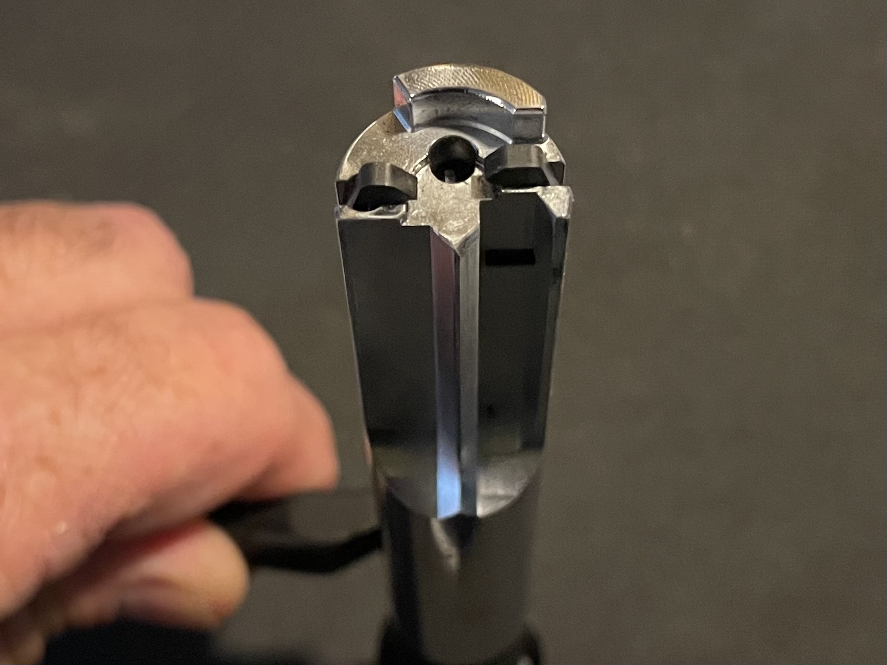

Couldn’t really resist the purchase after examining one. Very few tool marks, and the only polymer part is the bolt shroud, magazine body/rotor, and stock. The Picatinny rail is alloy, apparently with no tilt. The receiver is tubular, with the rear receiver ring the same size as the front so I don’t know right offhand if an existing scope rail will be compatible. Not a Rem.700 footprint, but does have a hanger for 700 clone triggers.
Ruger brand mags fit like a glove, but I haven’t tried feeding live rounds yet. Overall the build quality is definitely there, I just hope the barrel God’s have smiled on me and this example actually groups well. All factory goo has been removed, I’ve greased, oiled, and adjusted, so I’m just waiting to test. I’ve slapped a 1” tube 8-32x44 scope for break-in.

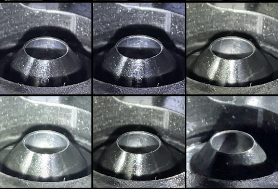

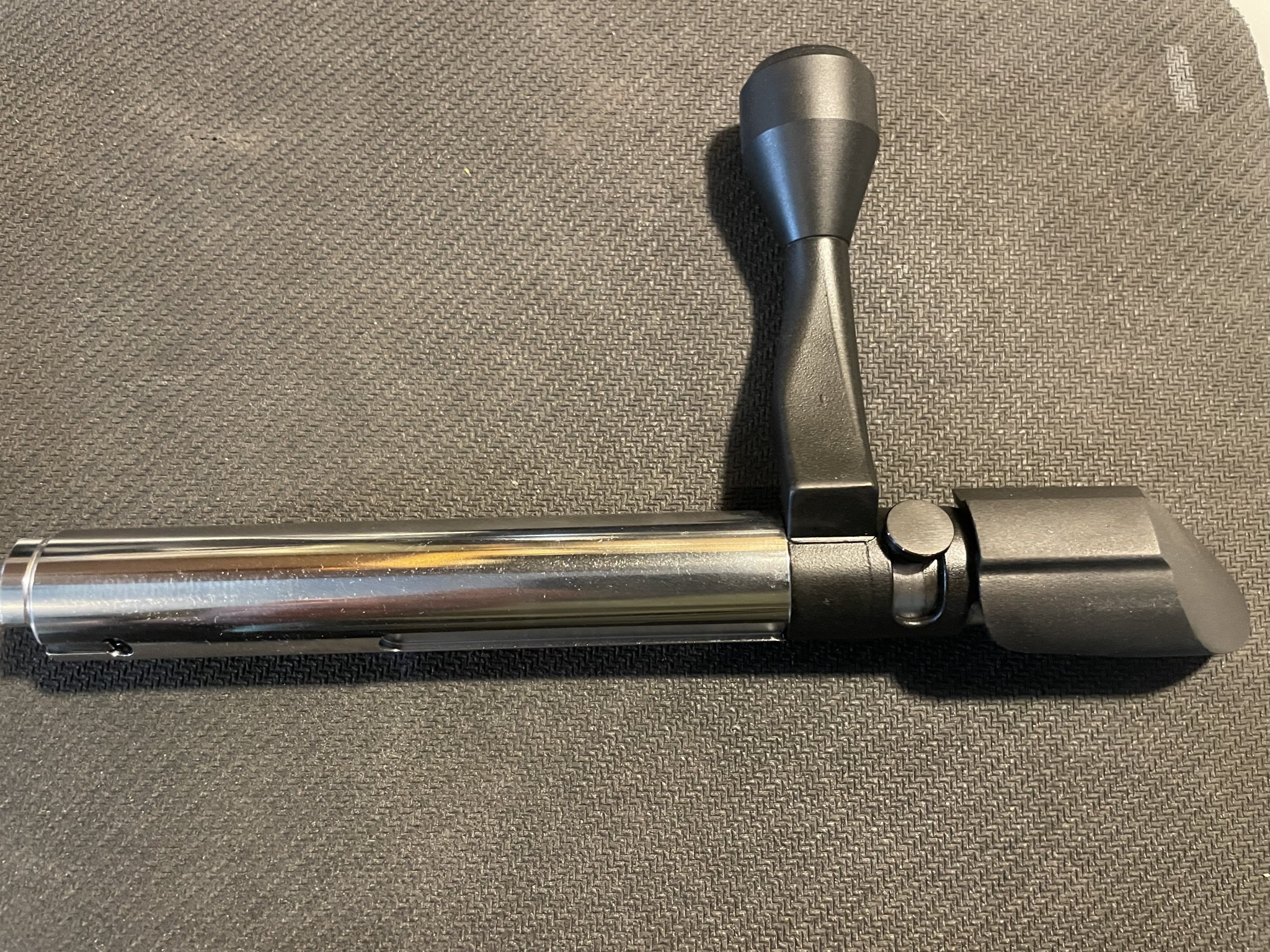

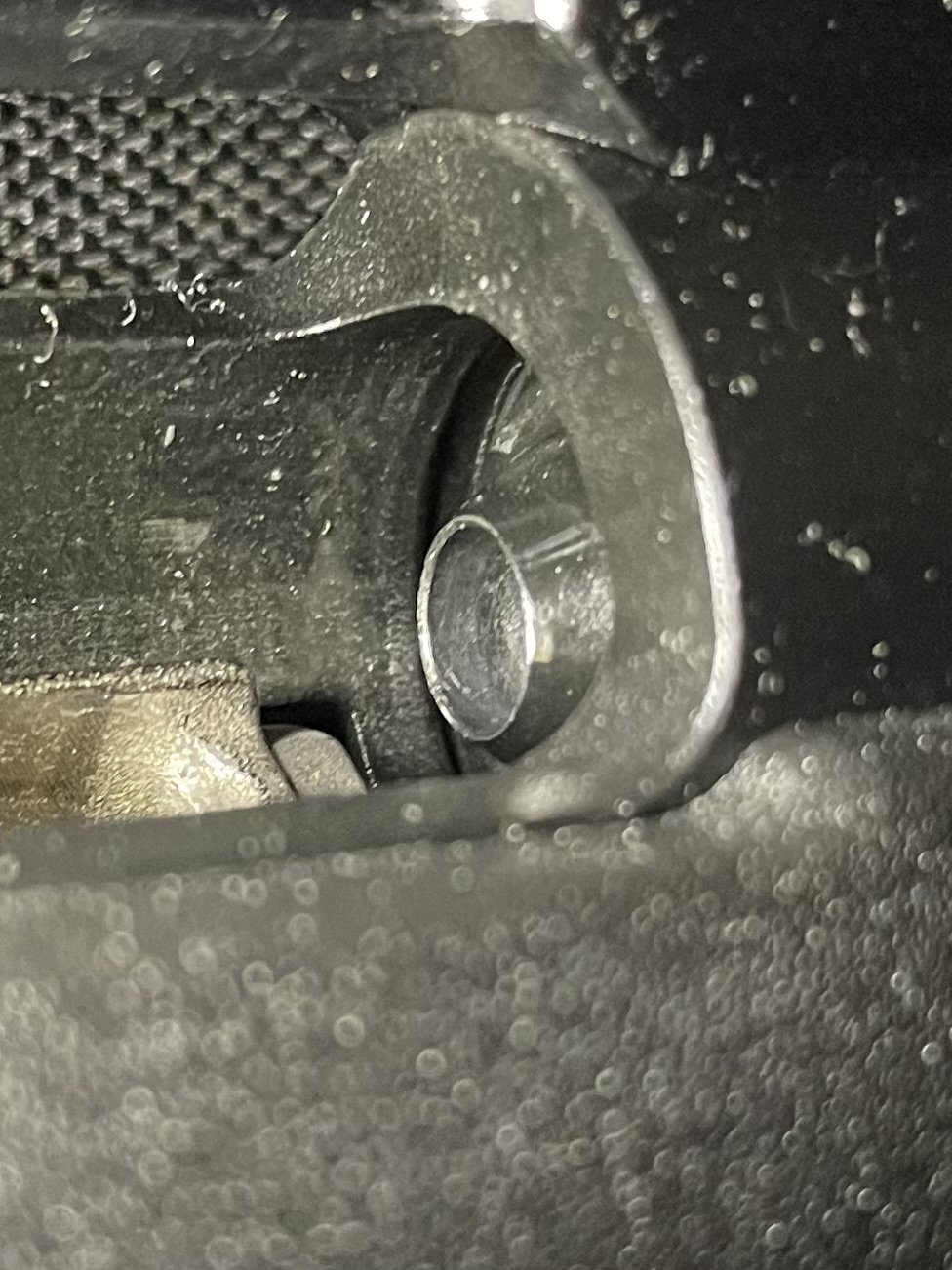

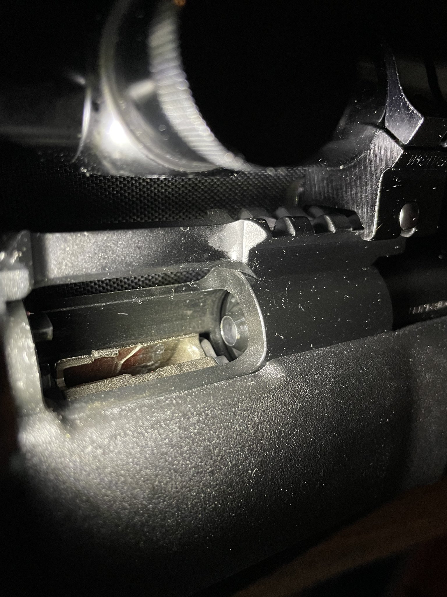

The coned breech is already showing damage.

I don’t see any damage yet, I think the earlier pic had a sluff of dust, plus I run things kinda wet during break-in. There is a rub in the bluing from the extractors.

There is a bit of material displaced into the chamber with what sounds to be a low round count. But hey, if it's working, it's working....
MB
Sir I’ll defer to your experience, I can only say I don’t see scoring on chambered but unfired rounds. Maybe it’s just a loose chamber, at least function is 100%. Just heard today that some venders are offering this model at sub $400, helluva deal for anyone wanting to experiment.

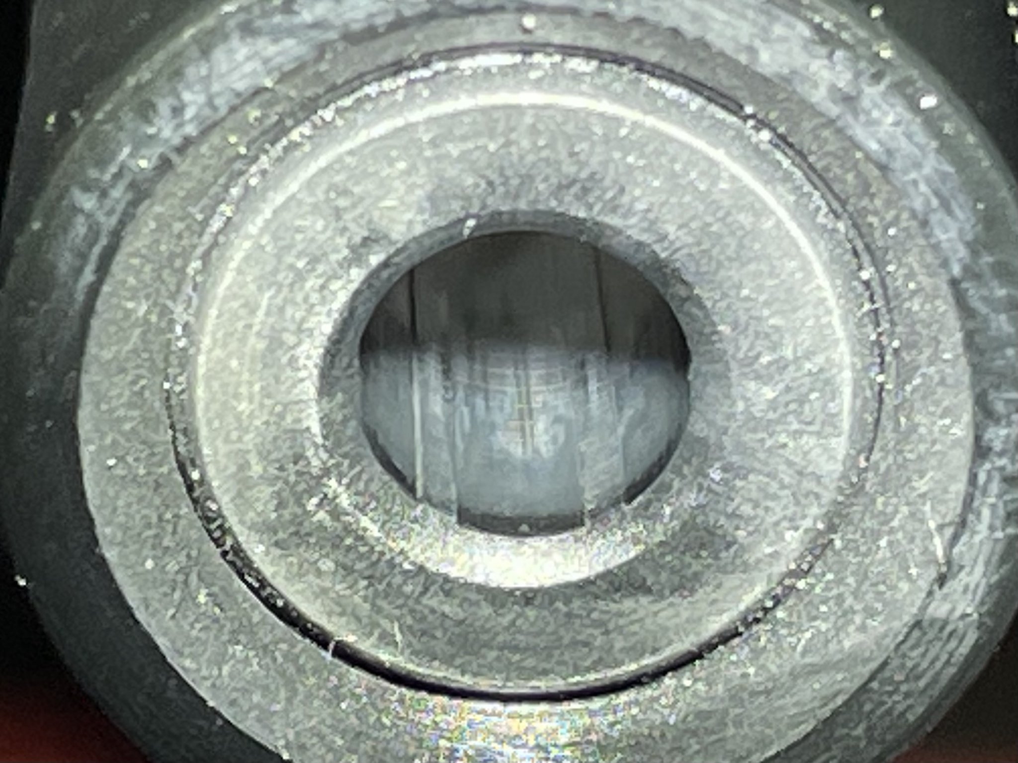

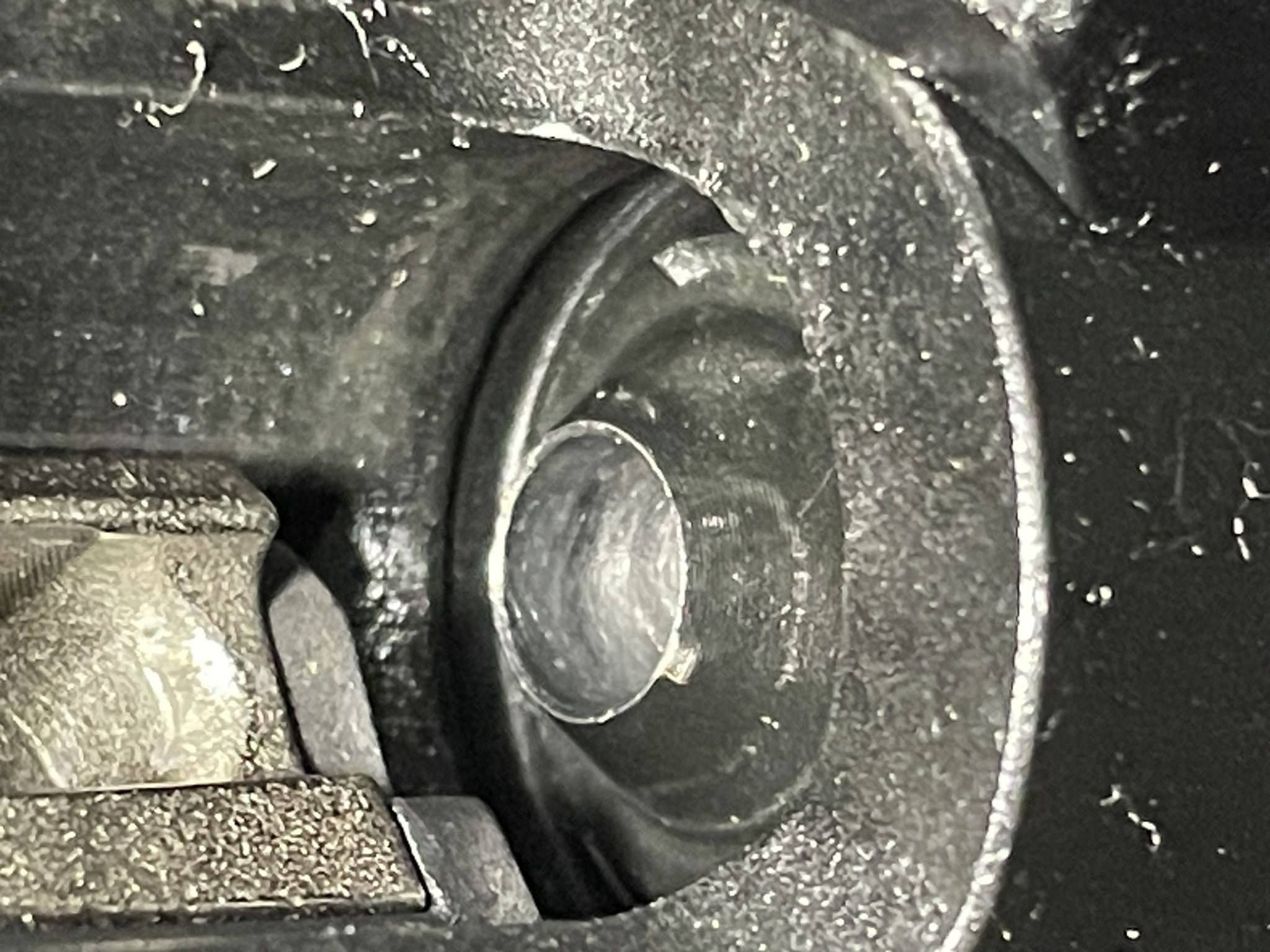

Took a few more pics this AM, if nothing more it teaches the futility of a cellphone camera.
Wide grooves!
A few more of the cone, be interesting to see how this holds up over time. 12:00 is at the top.
Reactions: JBoomhauer

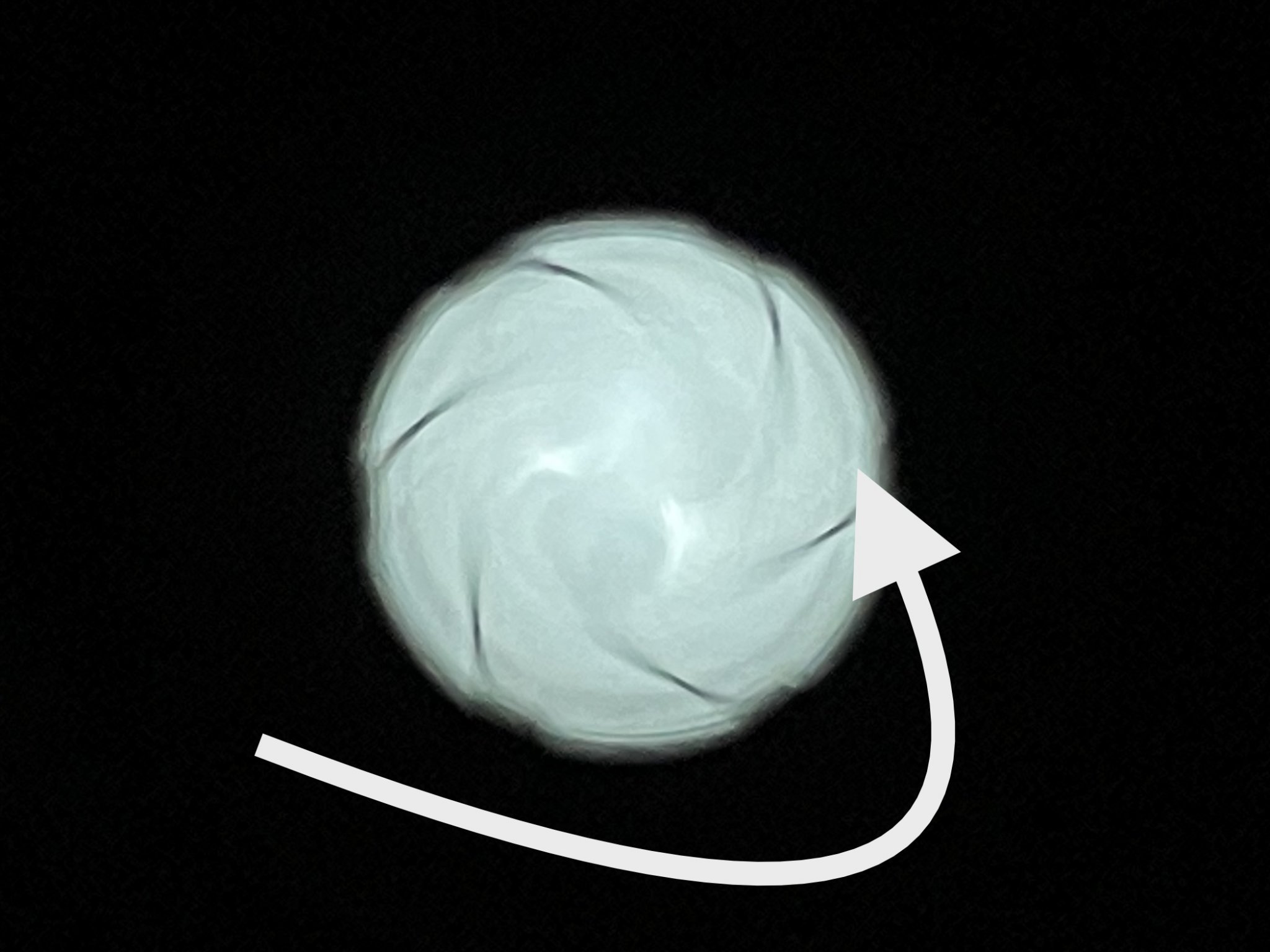

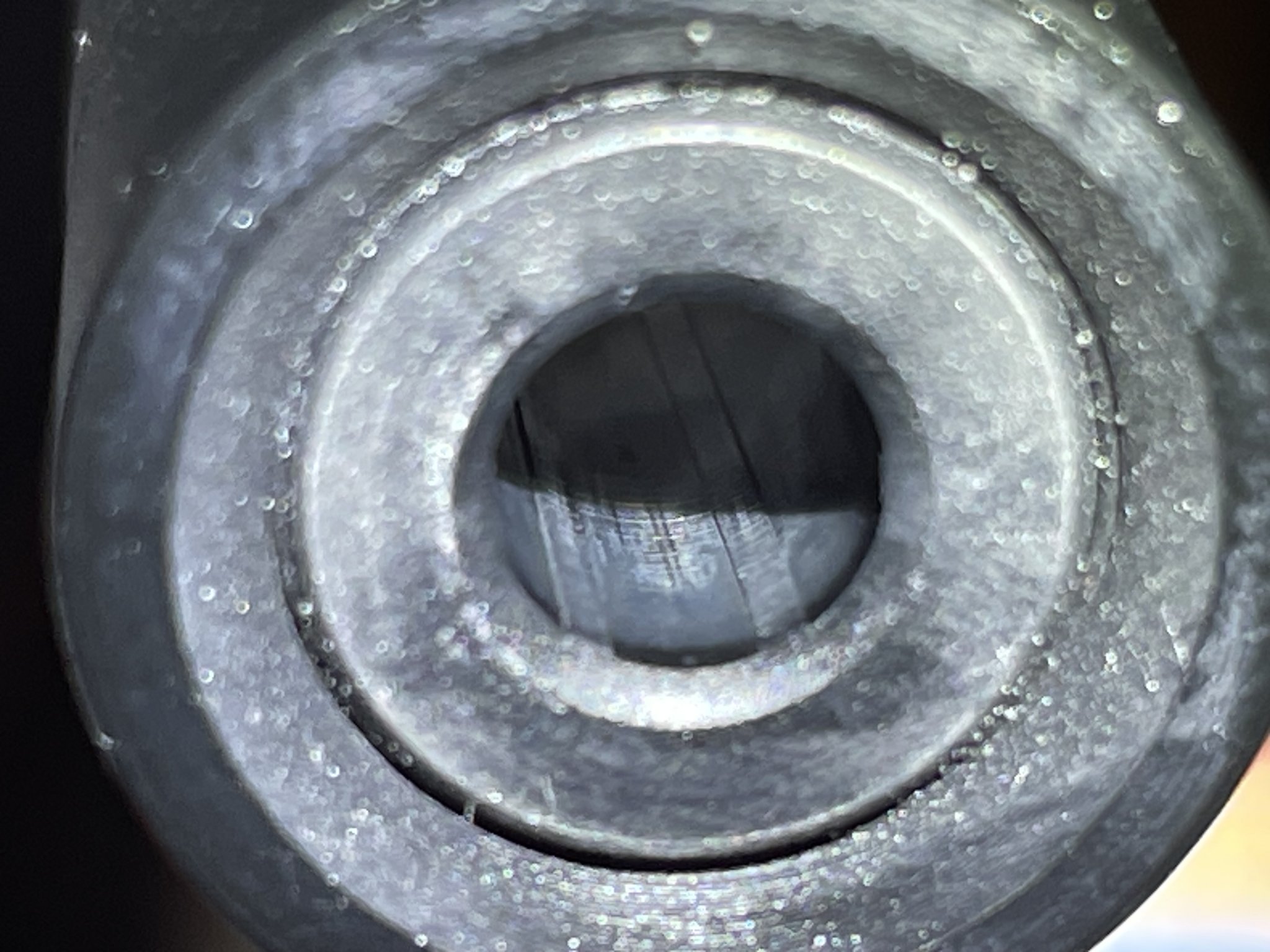

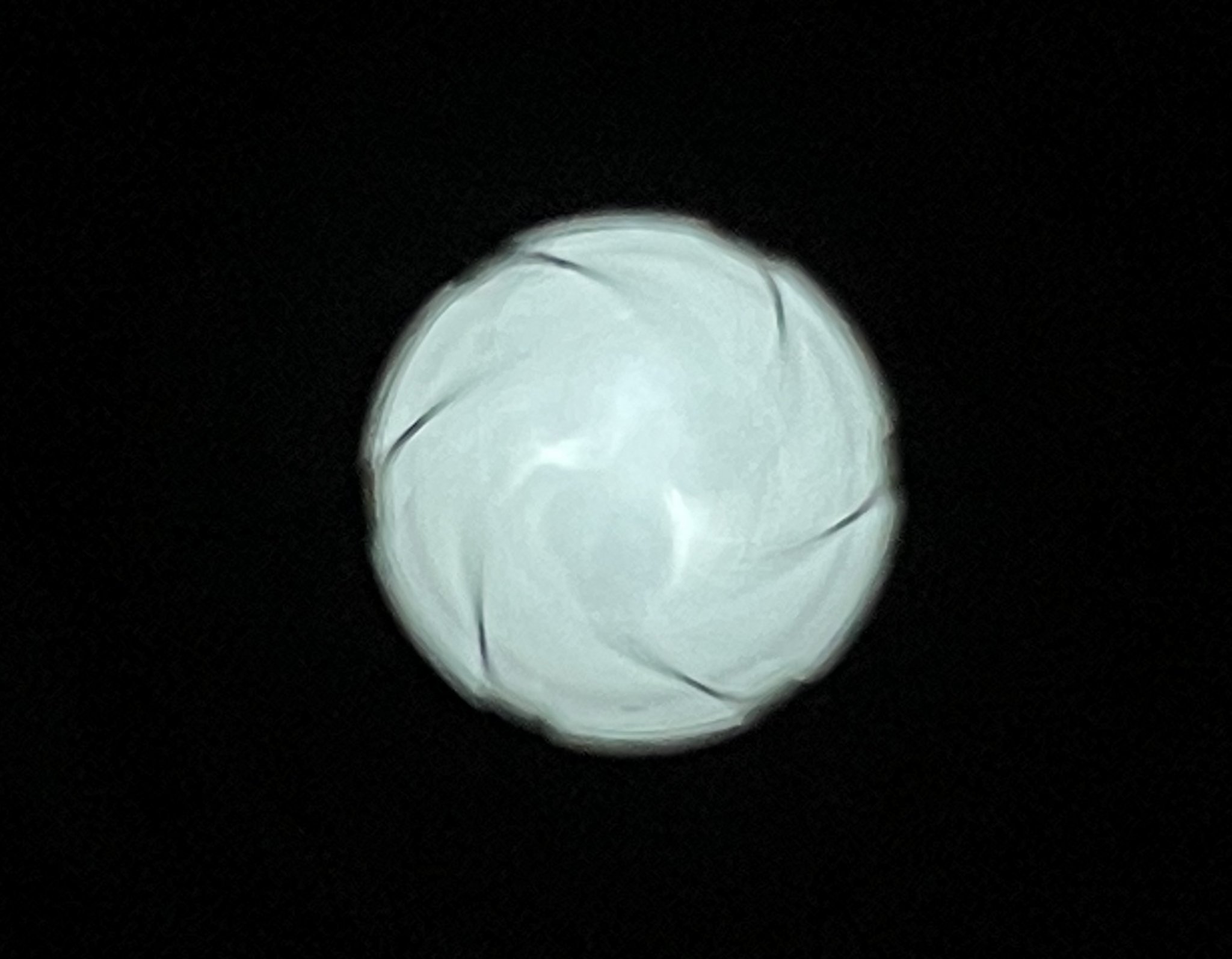

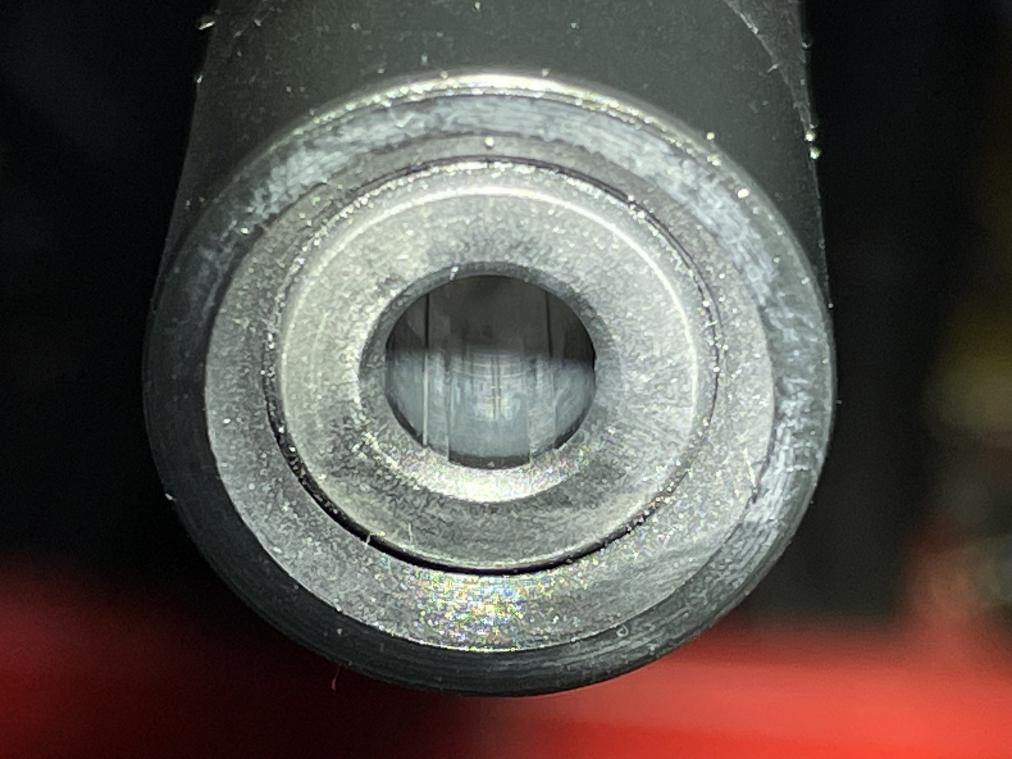

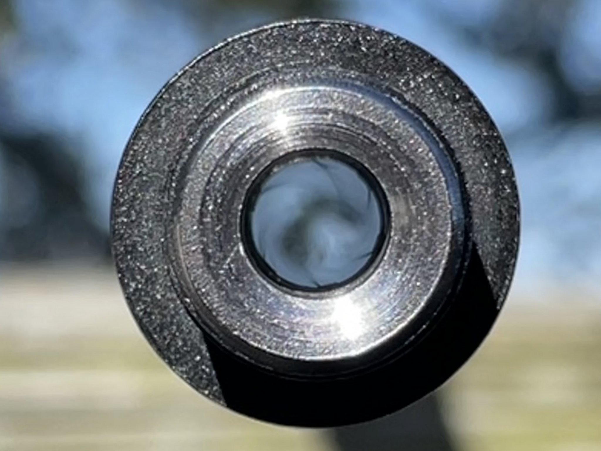

Did they bead blast the muzzle. It looks like .050 or so of the bore got it too.
Not really sure, there are still plenty of tooling marks from the barrel mfg. While I won’t get wrapped up with that because the proof is in the shooting, I will get dismayed at this pic from the muzzle:
That shadow ring is the step in the bore at the point they threaded the muzzle. This means the bore actually opens up at this last bit, loosening its control of the slug and allowing gas blow-by and bullet upset as the slug exits the crown. While mine easily beats their accuracy guarantee, there’s no denying it will be better if this portion is removed.
This expansion shadow is proving difficult to photo, but is viewable with the naked eye.
Reactions: 68hoyt
That answers one of my questions I’ve wondered about , if their threading was sub par and affecting performance .

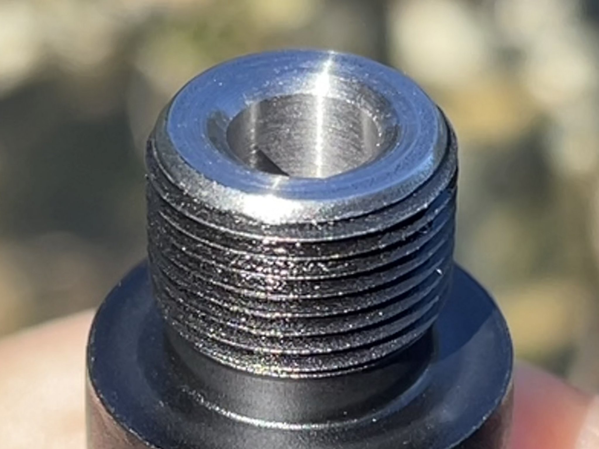

Are you considering having the threads cut off that barrel?
It would be interesting to see if it shoots any better.

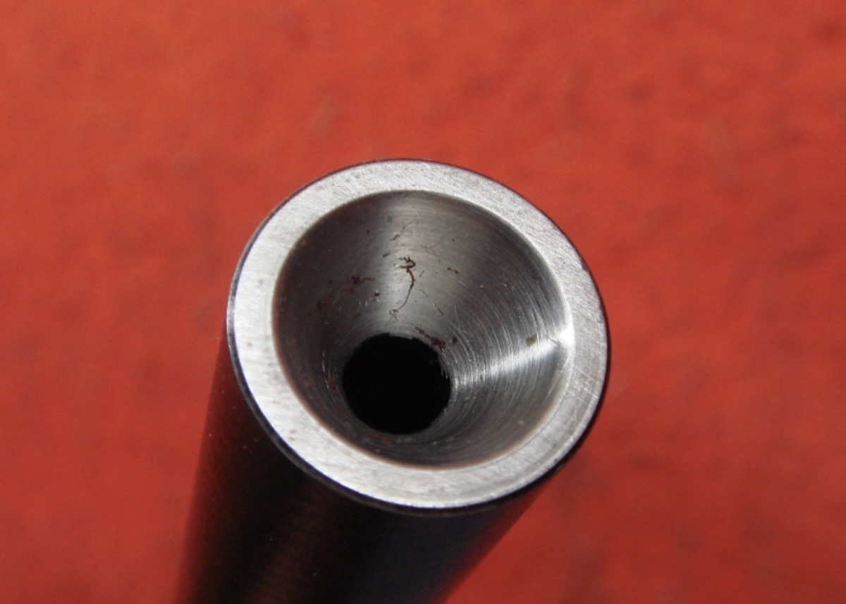

I believe this is a good opportunity to play around with different approaches. Prior to lopping the threads off, I'd try back boring with an internal crown (like Anschutz does) and keep the threads and compare groups before and after.
MB
MB
Yer in my head! I was actually pondering the funnel shape that Izhmash put on their Biathlon series. (Pic from the web)

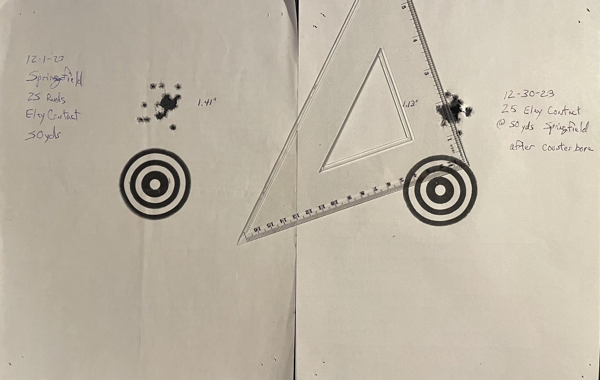

Had a fine time today running nearly a brick through this beast. It continues to be difficult to shoot well, as Beachrider99 and I agree the rifle stock is light, and also too short. If it gets picked up by a chassis manufacturer I think we will really see something, but the price hike may push it out of a niche “production” class. Running the 25rnd magazine almost exclusively, at least for me the first few shots were always wild till settling into a decent controlled rhythm of consistent pressure, tension, and follow through. I only had 1 ridiculous unexplained flyer that showed in the second mag of a 50 shot string, could have just been my fatigue.
Here’s the ugly but honest targets:

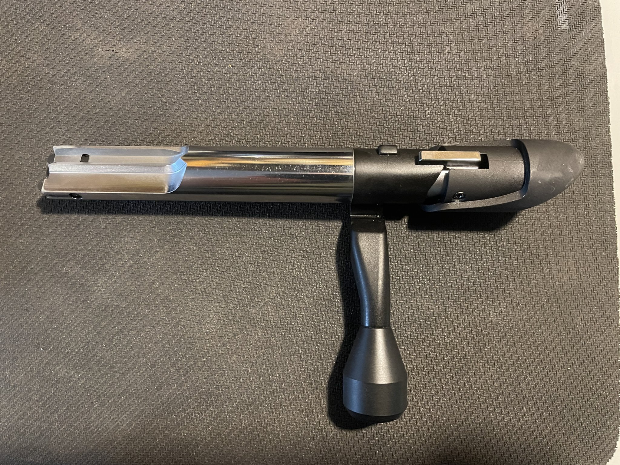

Came home and tore it apart now that I have my baseline, it’ll be time to tune.

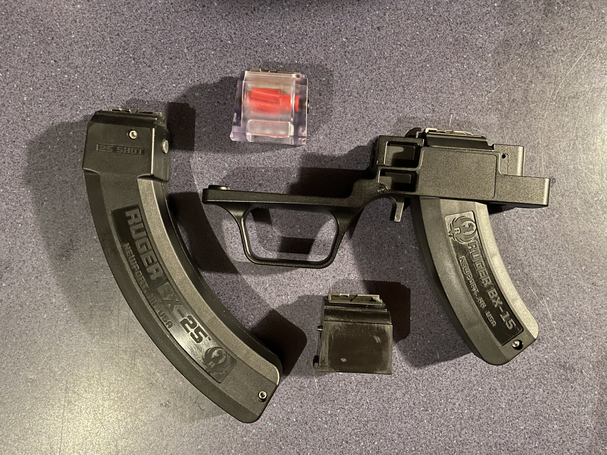

Stopped by the LGS and picked up a couple of 15rnd mags, oddly enough they are the first magazines to not latch properly. Front of the feed lips are shaped differently, perhaps there are other dimensional differences.
Well, today’s project of counterboring and recrowning is done for now. Time for a test fire, but I doubt I’ll beat the pending rain 🤬
If accuracy is better and this doesn’t result in carbon buildup over time wrecking accuracy, then I’ll touch up the bluing.

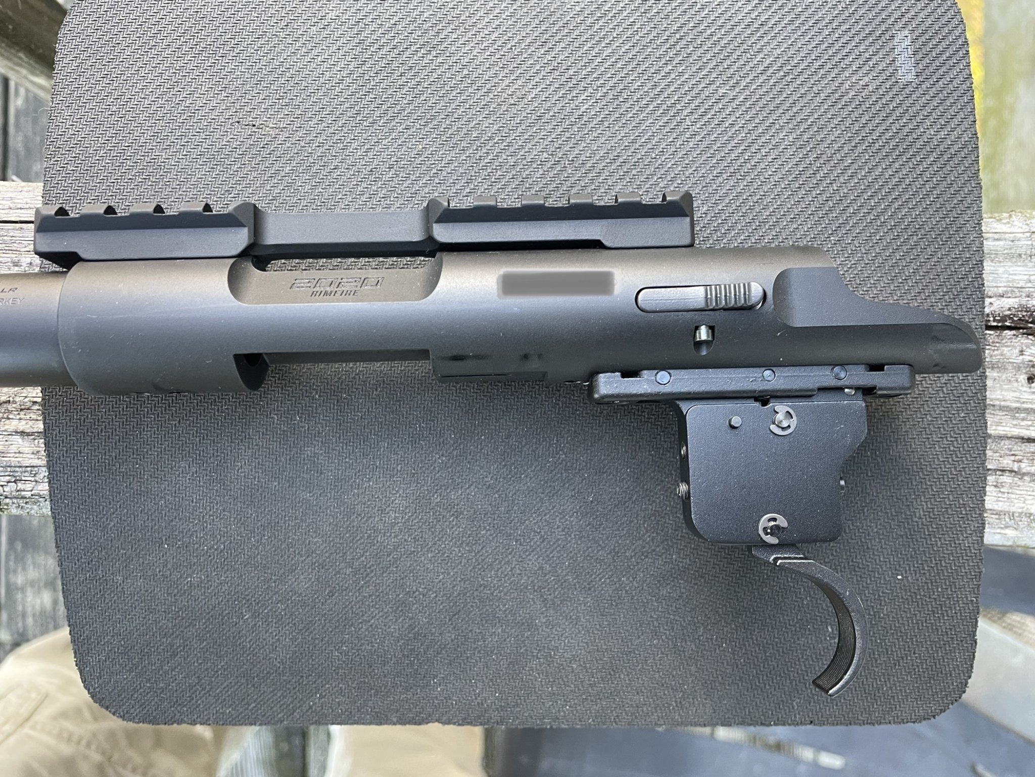

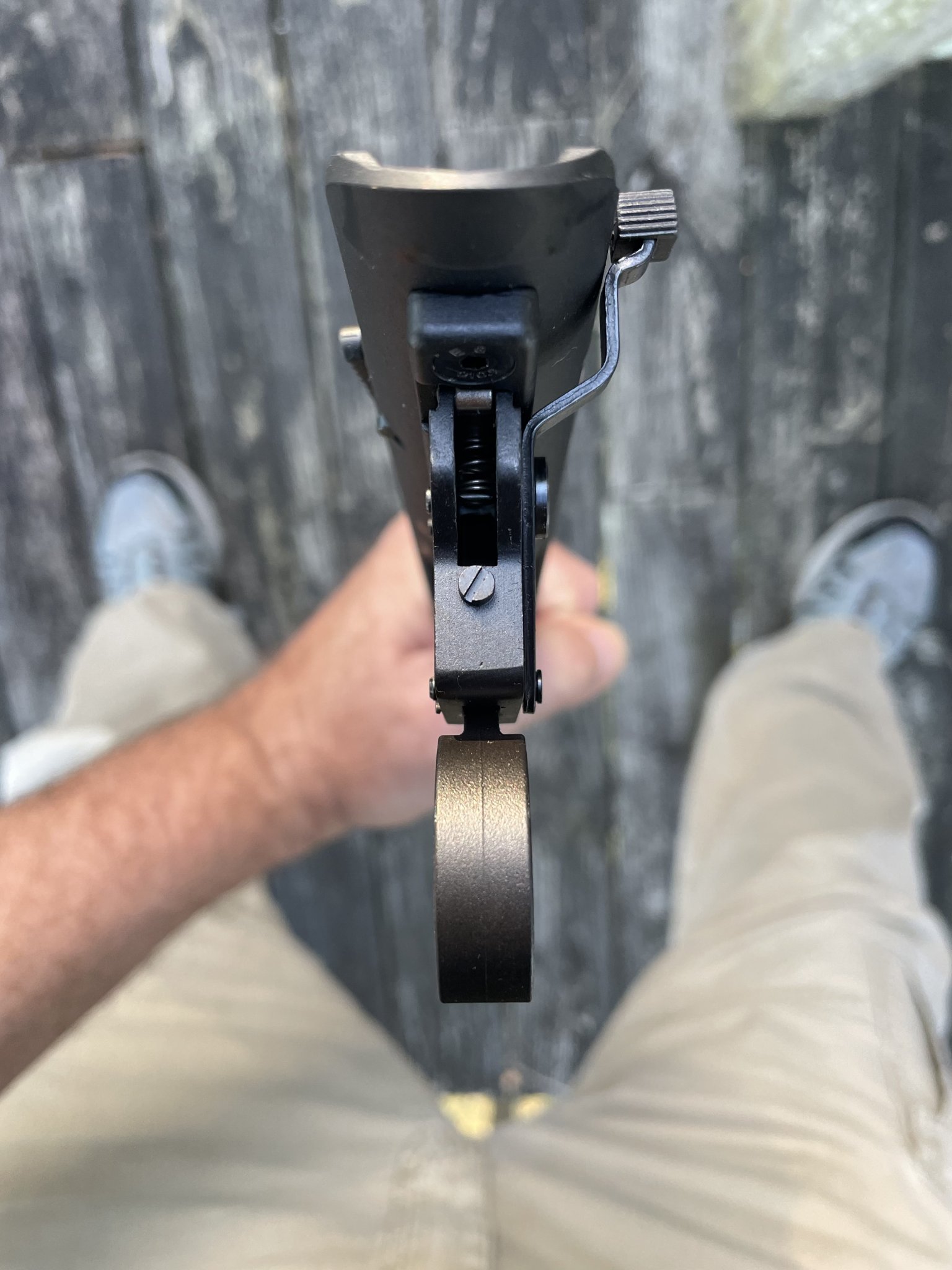

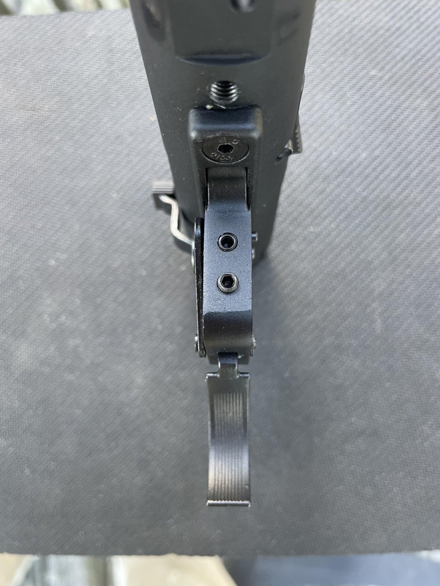

40+MOA one piece steel scope rail, trigger job, stock modifications, mag tuning…

So I finally felt well enough to hit the range, sadly the wind was gusting enough to push my body while I was shooting from the bench. Basically, don’t read too much into this, but I am pleased. Group size is definitely reduced with fewer fliers. Only change to the gun (other than the aforementioned counterbored muzzle) is a new Arken EP5, and preliminary adjustments to the trigger (still a ways to go).

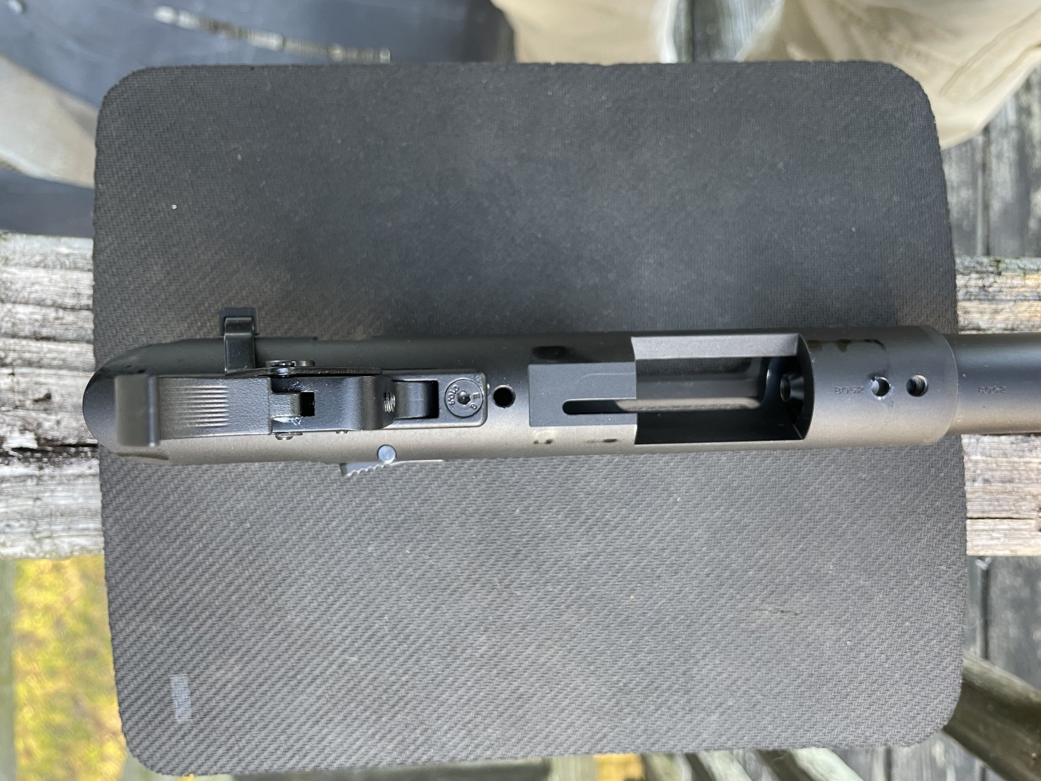

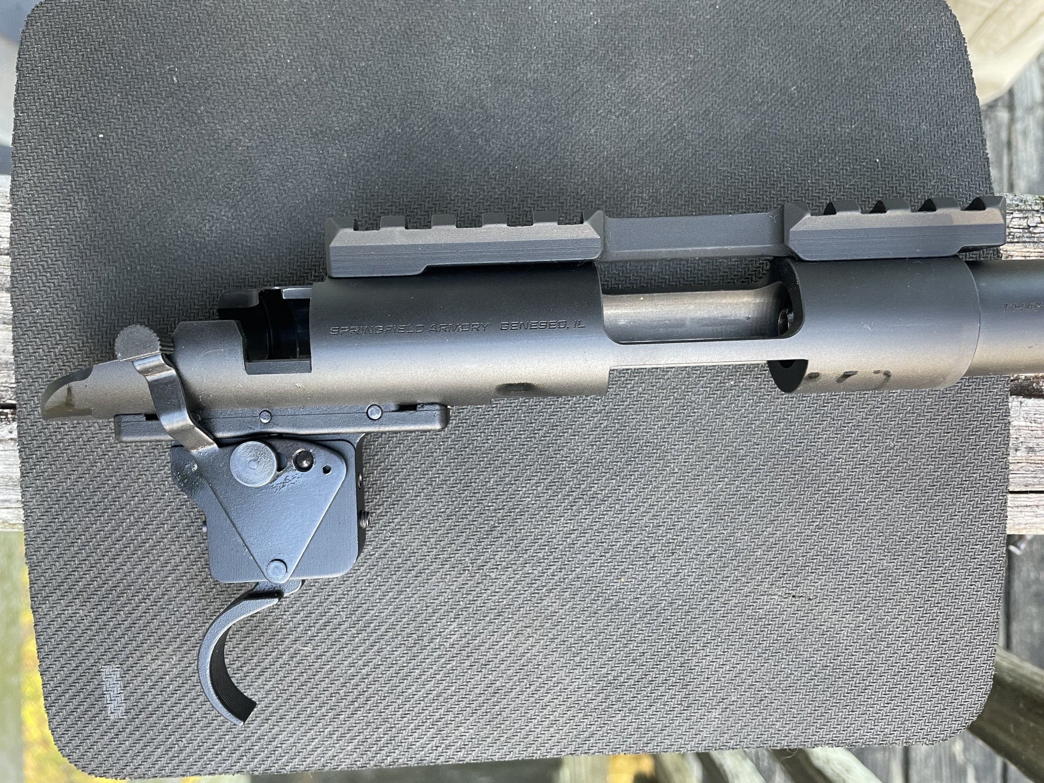

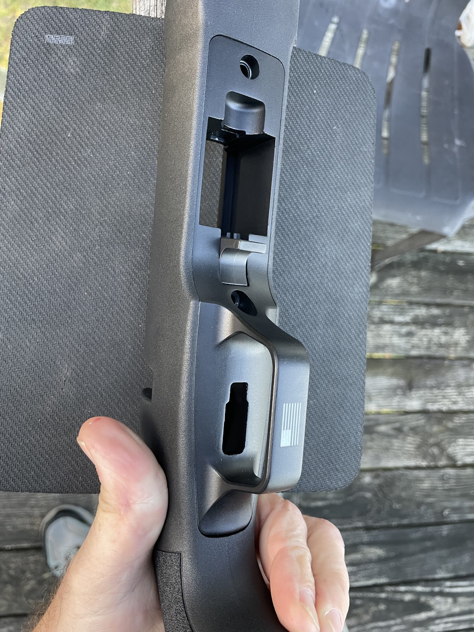

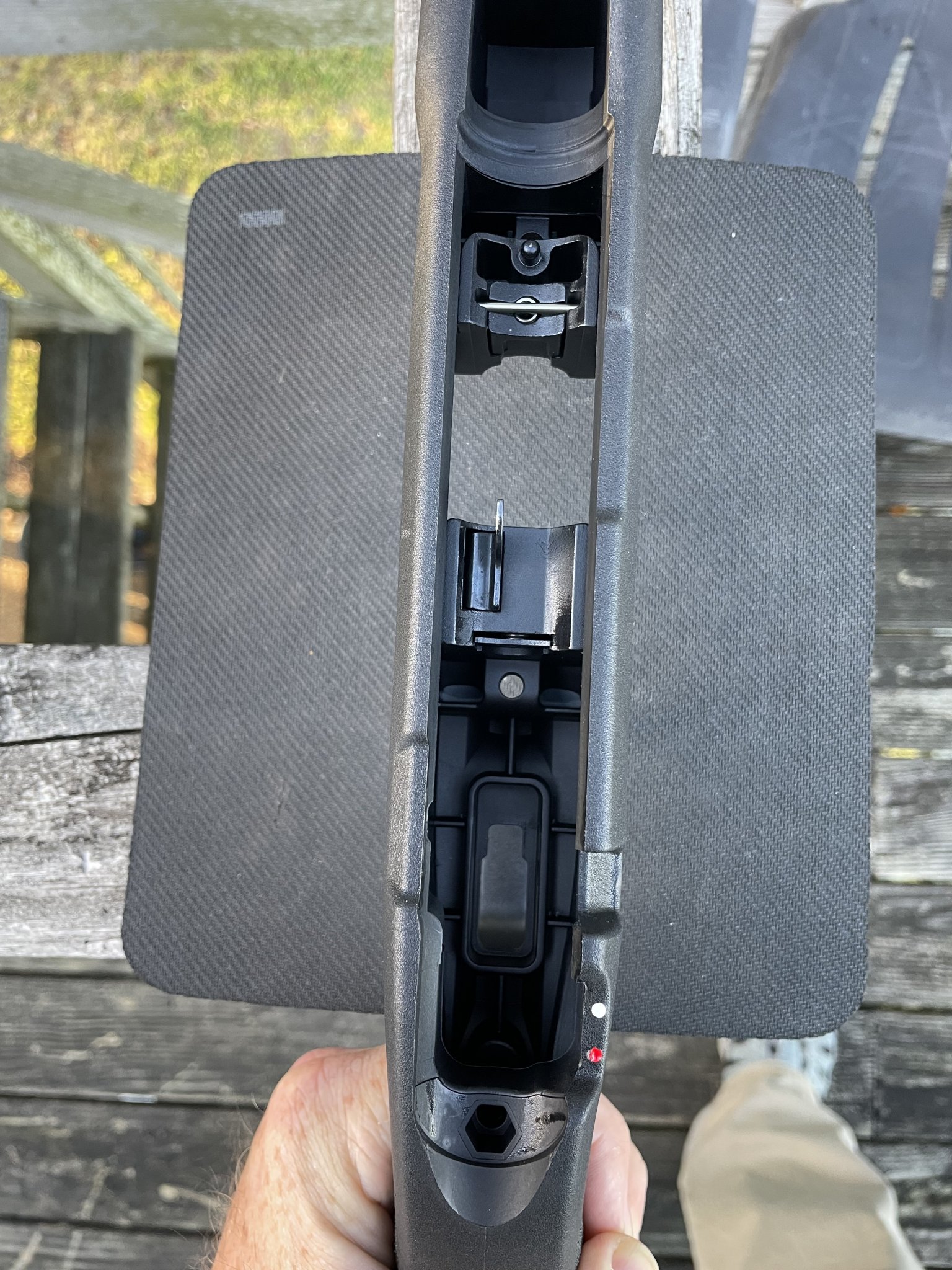

After seeing numerous photos of the bottom of the receiver, it looks so close to a CZ, has anyone tried dropping one of the into a CZ stock to see if they’re anywhere close? Maybe even on a RAR stock as it uses the same style mag system?
Any dimensions on the action screw distances on the 2020?

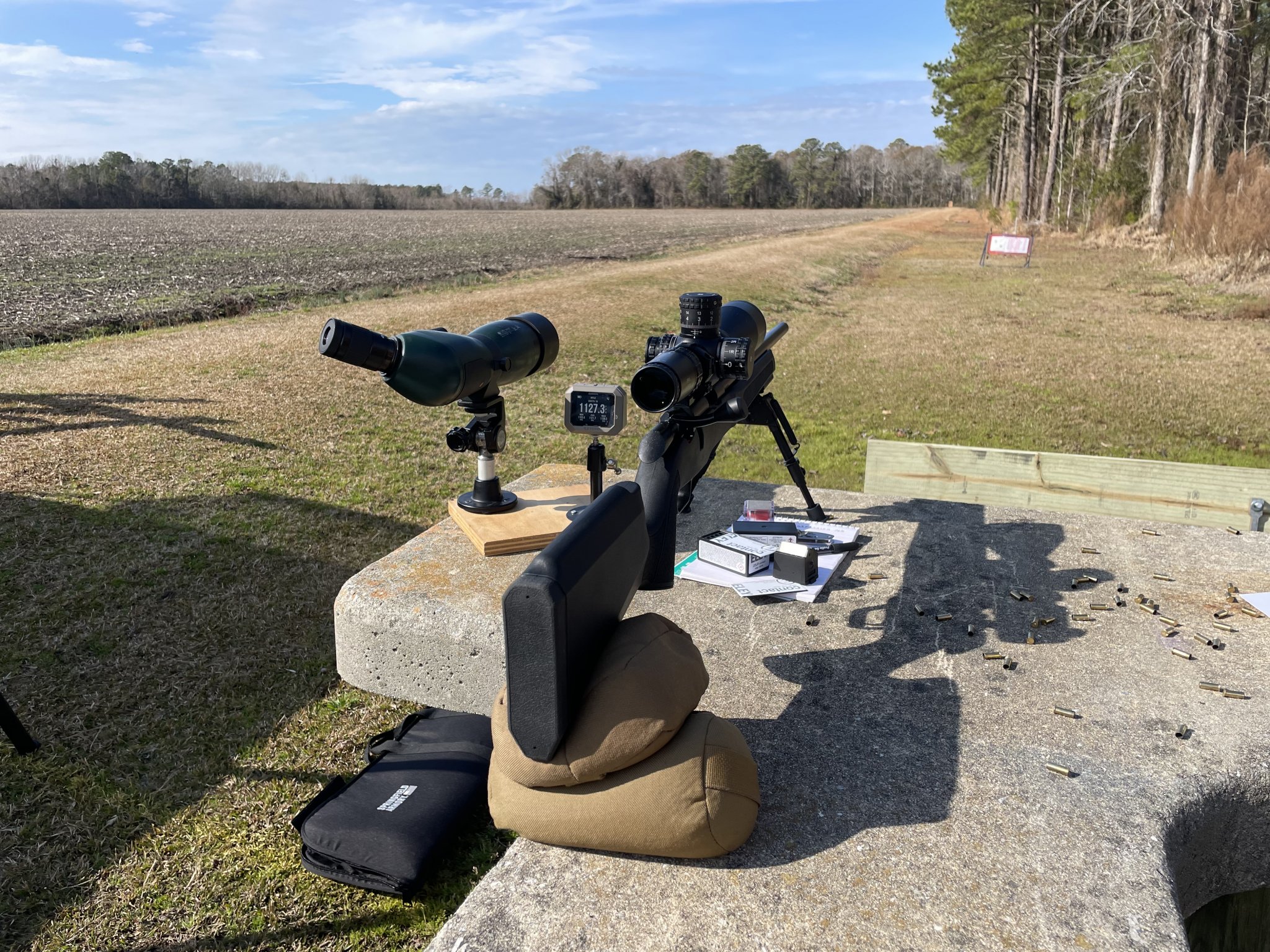

Playing in 15-31mph gusting winds kinda screwed my 100yd plans, so instead I confirmed my 50yd zeroes on paper, then switched to steel at 100.

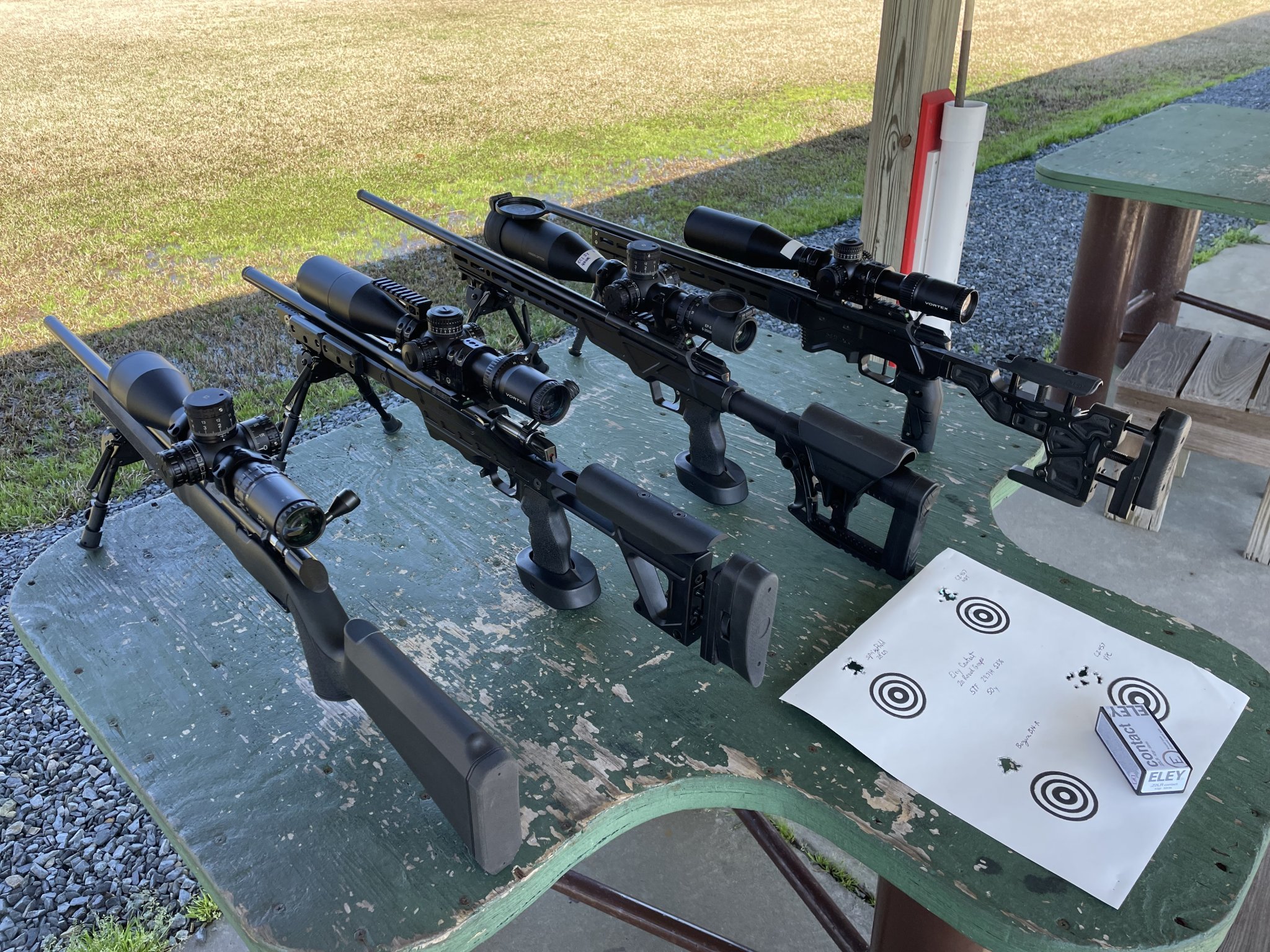

That Springfield 2020 has promise for a cheap competitive rifle.

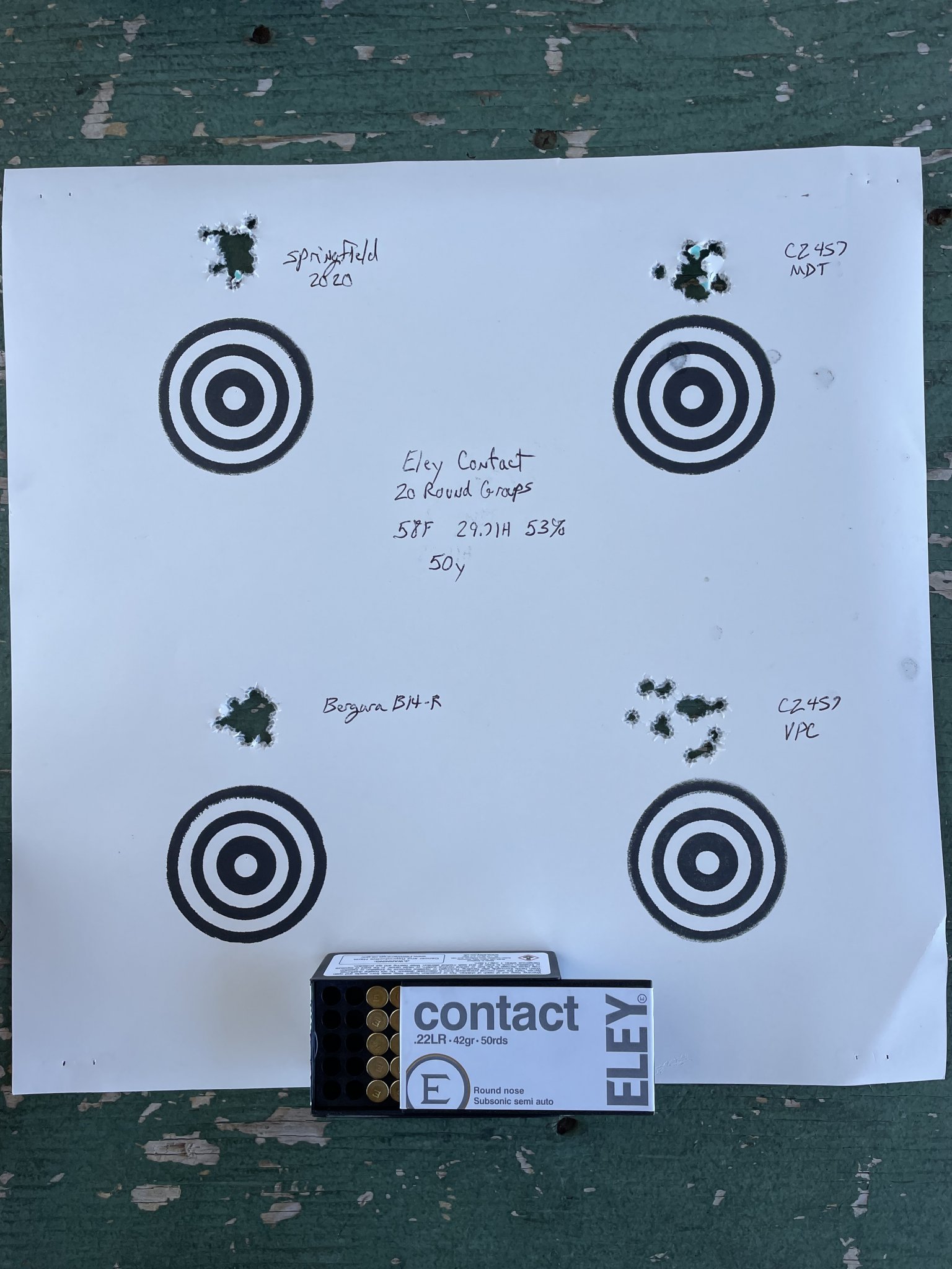

A note on the CZ VPC, first time running the Eley Contact after a direct switch from CCI SV. Came home and removed a bit of lead and carbon, so that one will be tested again. Point was to show what these rifles are capable of with this ammo and my own somewhat limited abilities.
I don’t feel I’m shortchanging anyone if I loan out the Springfield at one of our events.
