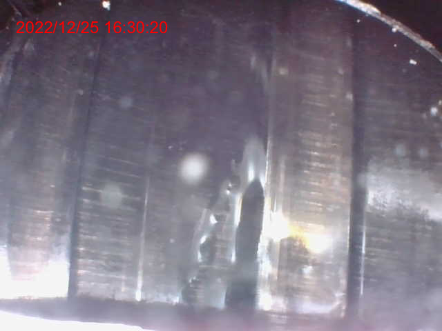

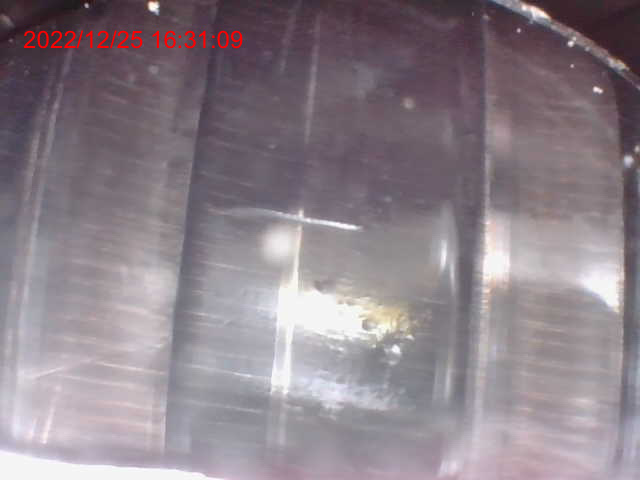

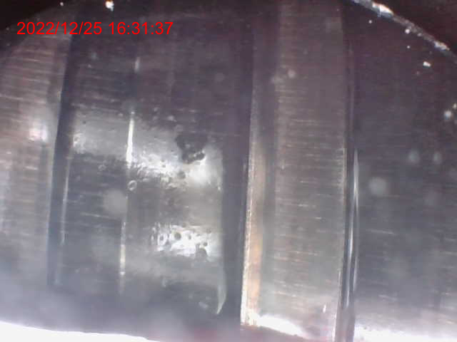

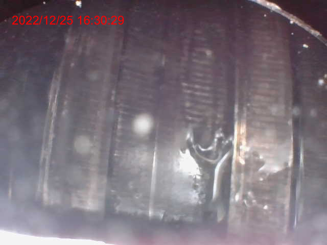

I shot 16 rounds during sight-in (no groups because the erector springs on my NIB Leupy VX-5HD went to crap, but that's another story). I busted out the Wipe-Out and the accelerator and gave the barrel a couple of treatments. I then bought a Lyman Bore Scope because I am tired of borrowing my friend's Hawkeye. Here's what appeared just ahead of the case mouth.

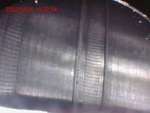

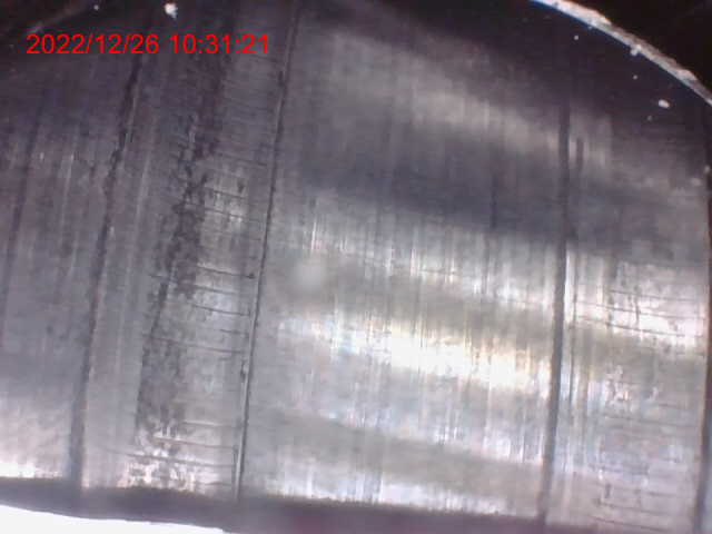

And so on and so forth. So I took my Witches' Brew (a mixture of JB bore paste and Kroil marketed by Dayrl Holland) and went to work.

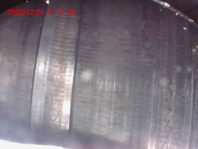

After the Witches' Brew the throat looked like this.

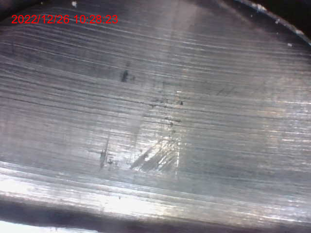

While I was at it I scoped the chamber and it is definitely rough enough to grab the case during expansion.

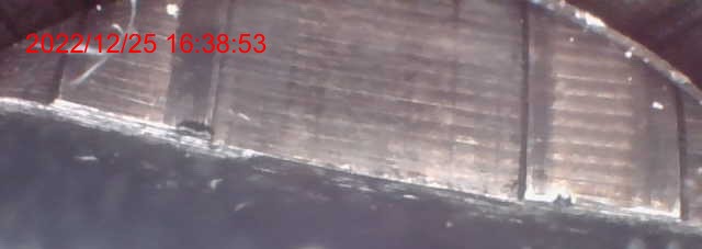

I then scoped the crown and there is a burr all away around the inside.

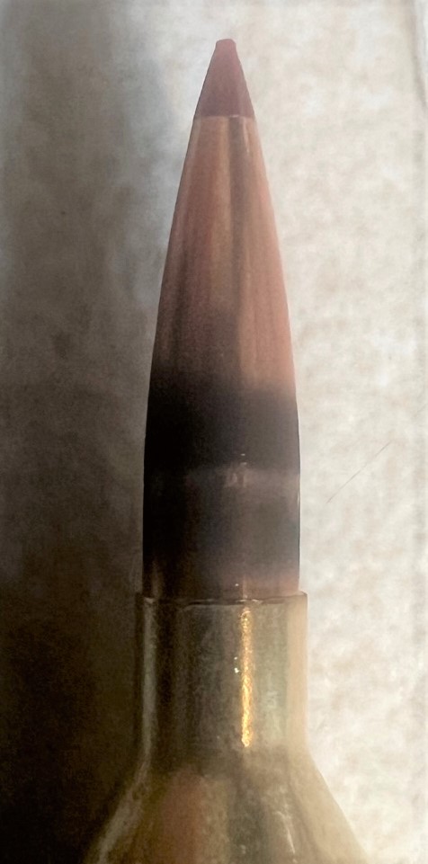

I smoked a factory round with a candle and chambered it to see if the bullet contacted the lands and I got this:

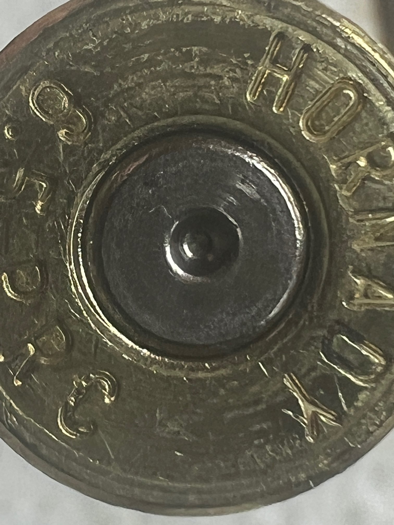

The fired primers are a bit flat and they are coming back into contact with the bolt face.
