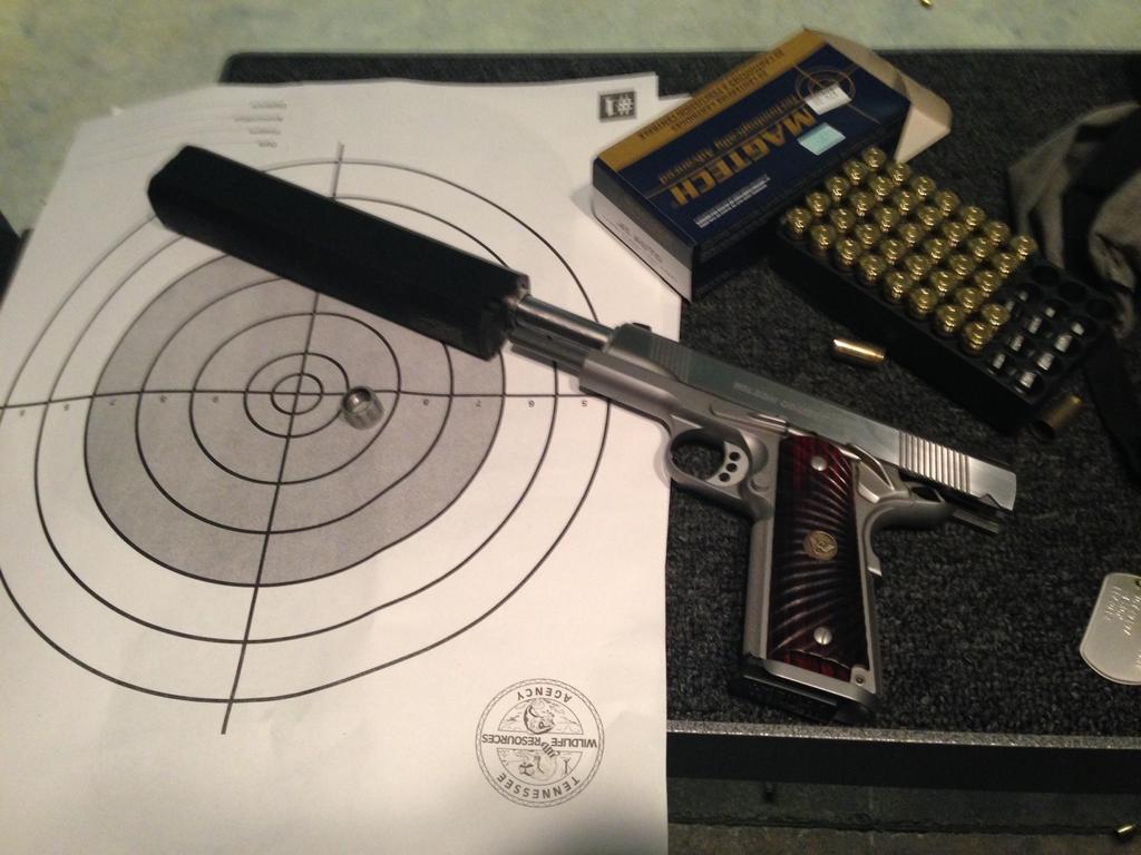

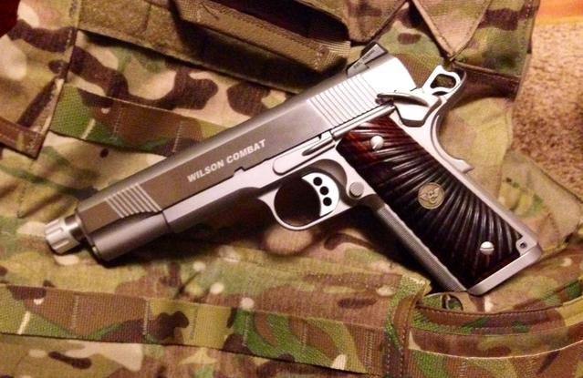

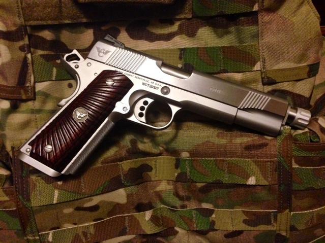

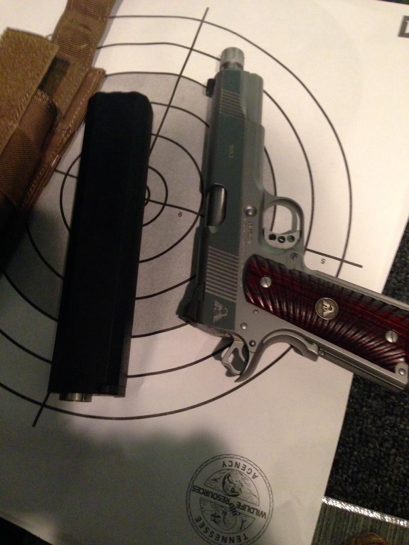

I have a Wilson Combat CQB and recently sent it back to wilson to have a threaded barrel fit to it. Best decision ever. It is incredibly fun to shoot and extremely quiet with an Osprey 45
