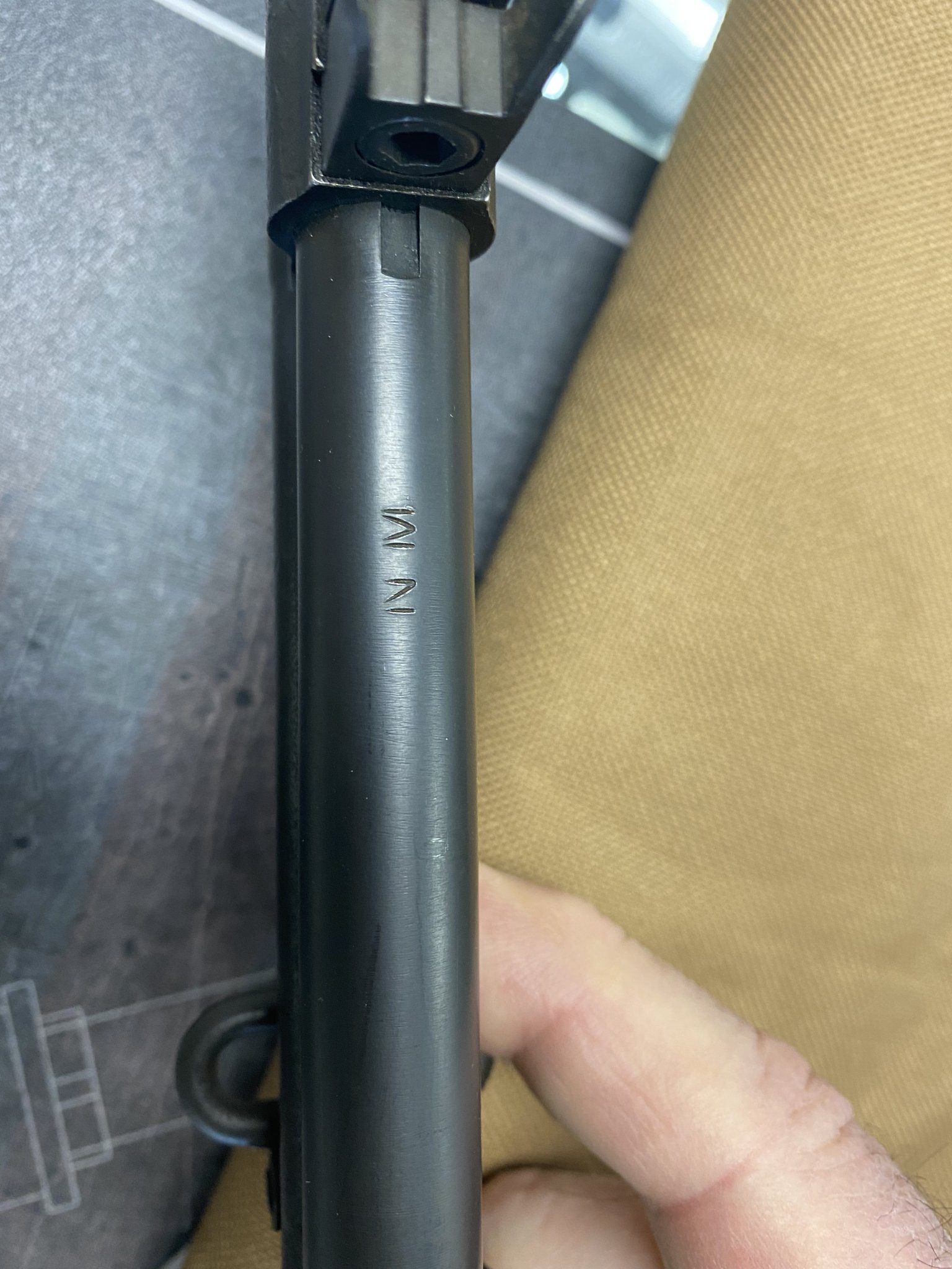

I need some education on this one -
A gentleman brought in a Springfield Armory M1 Garand in 308. Says it was a CMP rifle, but I can't find any CMP stamps. Serial number is in the 7 millions so I believe it was made in the 80's. No box or papers, any idea what it is worth?
Stamped NM on the barrel.

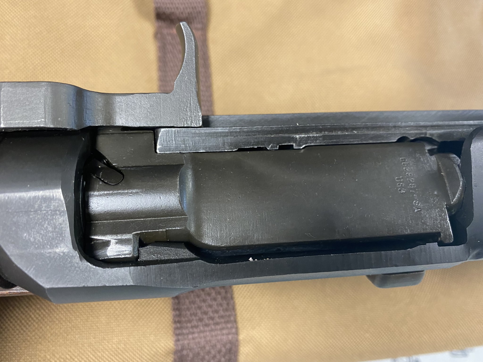

Looks like the CMP will sell you one for $1000 right now. That’s with a new production stock and barrel though. Could give them a call, they might be able to look up the serial number if it came from them. Never ran into 308 Garand in person. Throw up some more pictures, let’s see this thing.

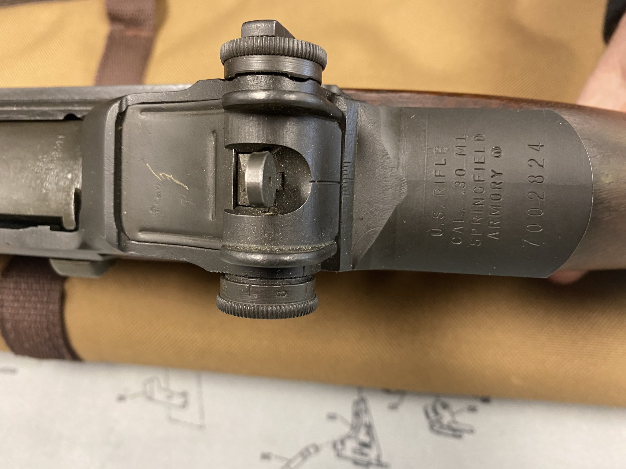

Your Garand is from SA Inc's first venture into making new Garands.
Some say those with the 7,00x,xxx s/n were made in the late 70's, others in the mid 80's.
They were supposedly assembled using new or exc condition GI parts,(both foreign and domestic) Fajen stocks, and investment cast recievers.
There were a lot of QC issues with the cast recievers.
The NM marked barrels, if medium or heavy contour, are said to be Douglas.
They are not legal for JCG matches and dont stack up to NM rifles built by the real Springfield Armory in the 50'/60's in build quality.
No idea as to current value.
E.T.A.: The cast reciever will be a big detractor in value, also I'm not aware of the CMP ever selling repro Garands.
IIRC the SPRINGFIELD Armory Inc Garand used a cast receiver as opposed to the U.S Garand using a forged receiver. I don't think can use the price they are getting for a U.S. Garands.
Take an inventory of parts. Looks a like a nice set of ww2 lock bar rear sights. Might be worth an offer. 1k is steep if it’s a cast receiver, but it might have some good parts in it.

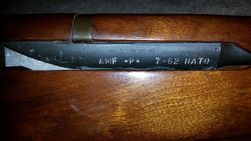

Apparently there were some 308 Garands in military service as i just sold a friend one. I dont remember the receiver manufacture but the barrel was Springfield armory not arsonel . It was stamped 7.62MM. THE gentelman i purchased it from years ago said he won it in a military match. I only shot it once as it was unfired when i got it. The barrel and receiver were defiantly military. Sorry i dont still have the rifle for pictures
Sounds like you may have had a U.S.N
Mk ll Mod l Garand SECNAV trophy rifle.
A rare bird.
True, the Navy had some 308 Garands later on.
Italy also had some 308 Garands. I happen to own one built on a Breda receiver.
All the services had 7.62 Garands at some point. CMP frequently auctions off Air Force match rifles.
The Navy had PLENTY of 7.62 Garands back in the day. I have a Mk2 Mod1 Grade B SECNAV Trophy rifle (SA# 820416) in my safe right now. I match conditioned it with the then-rifle match armorer the late Dobber Burdette, on the Navy van at the 91 Interservice Rifle Matches at Quantico, VA.
Get a hold of Jim Adell if you think you have one. He can look up the serial number and verify.

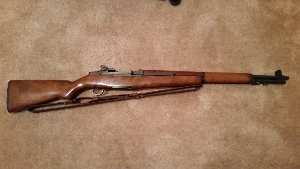

Mine:
