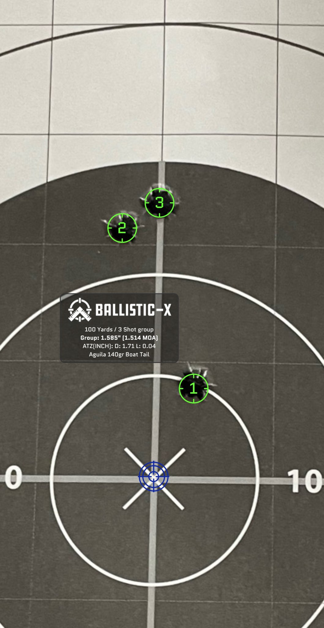

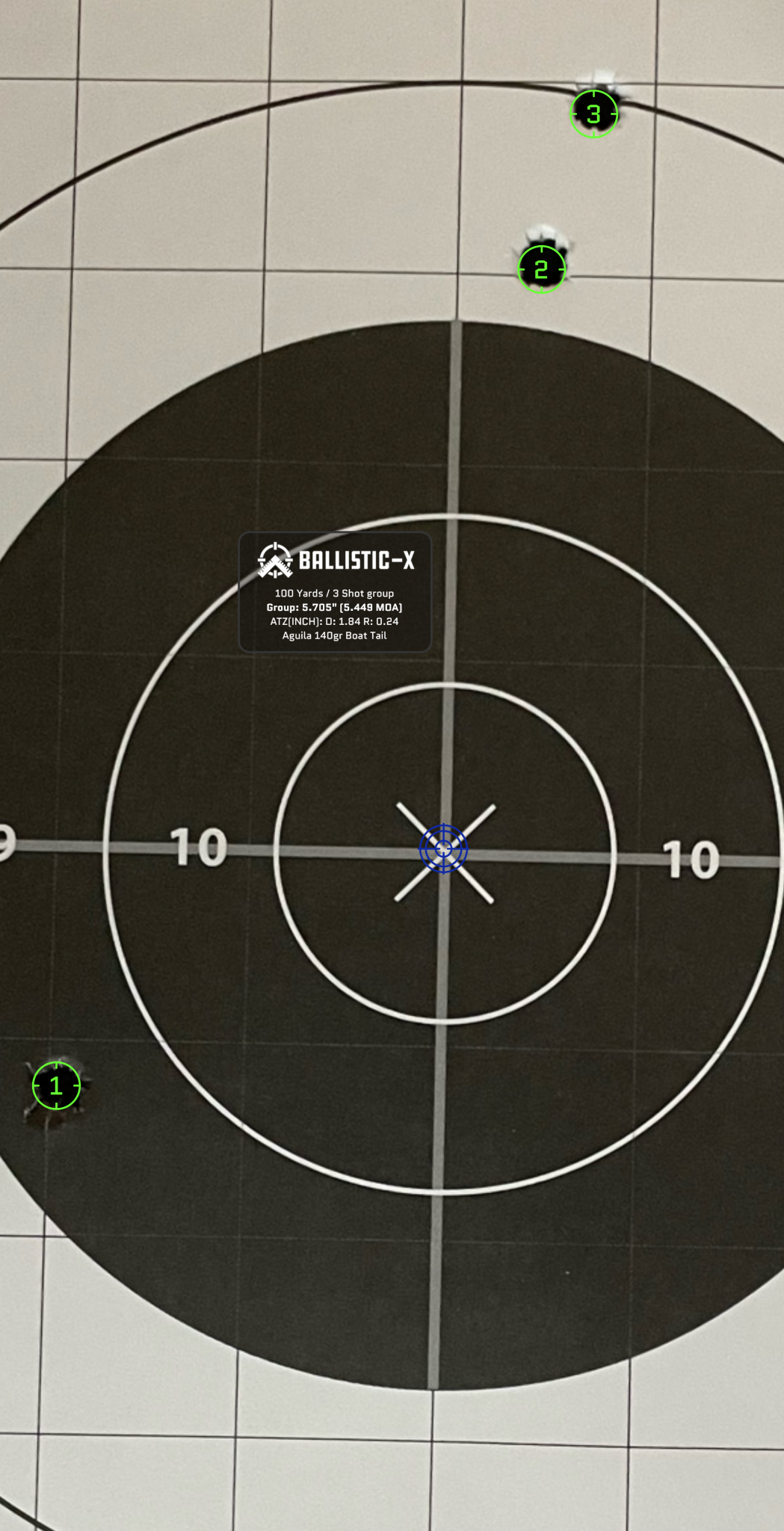

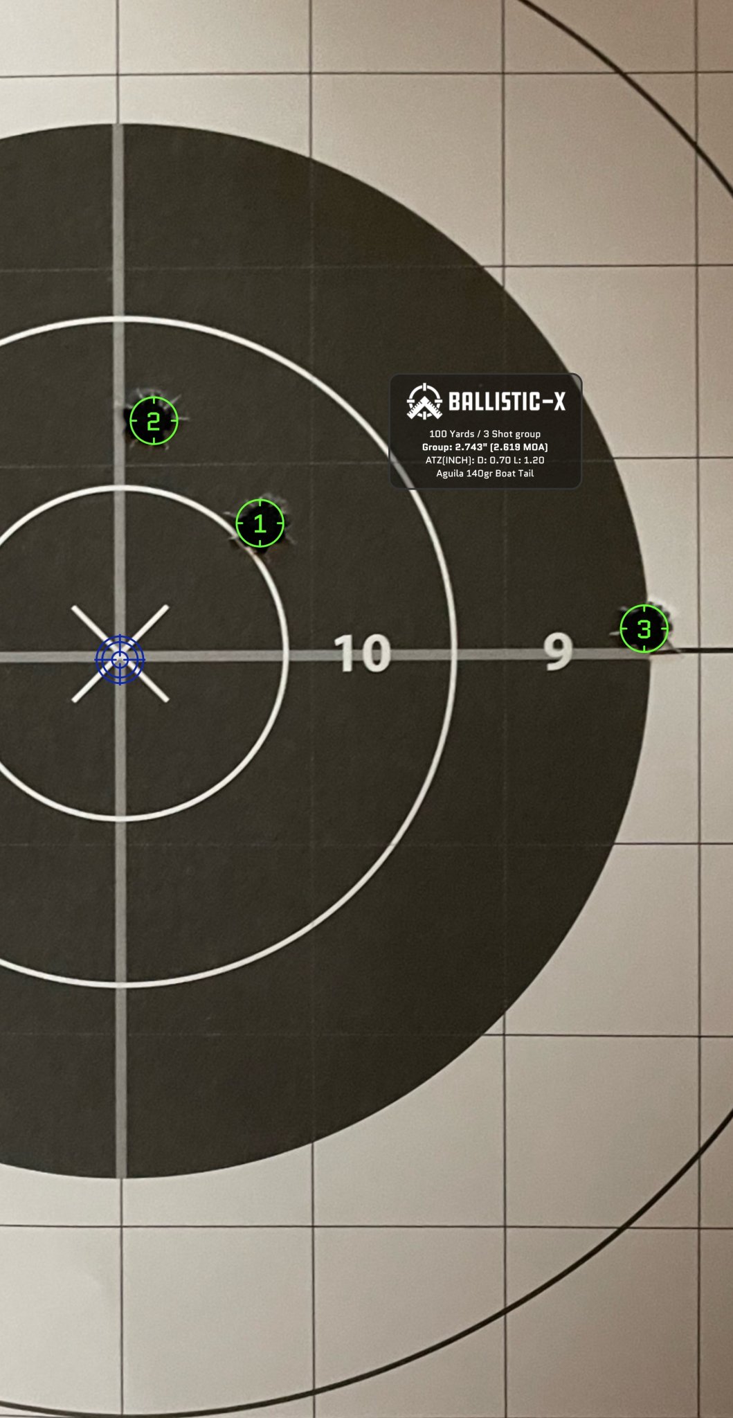

Quick update: it's not an ammo issue. I took it to an indoor 100-yard range and shot the only other ammo I could find. These god-awful groups were shot with Aguila 140gr. Not match ammo, but not bad ammo. I shot 3 groups between 1.5 to 5+ MOA. All shots were made using a lead sled to limit possible human error. On the 5+ MOA group, I'm inclined to think it was just a flyer, but the shot didn't feel like any issues on my end.
Ballistic-X-Export-2022-04-30 10:54:56.718636.PNG
Ballistic-X-Export-2022-04-30 10:52:48.488605.jpg
Ballistic-X-Export-2022-04-30 10:53:59.321583.jpg

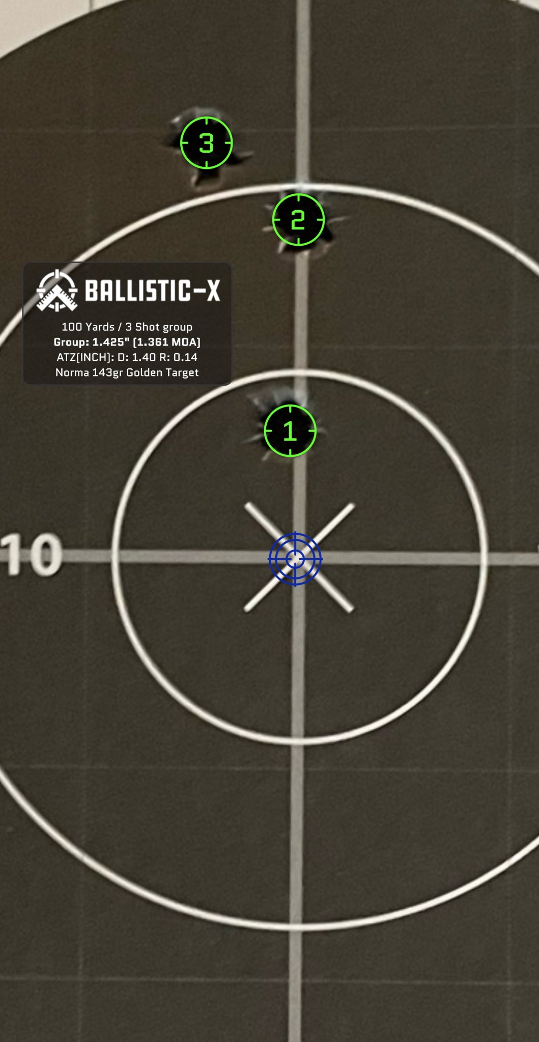

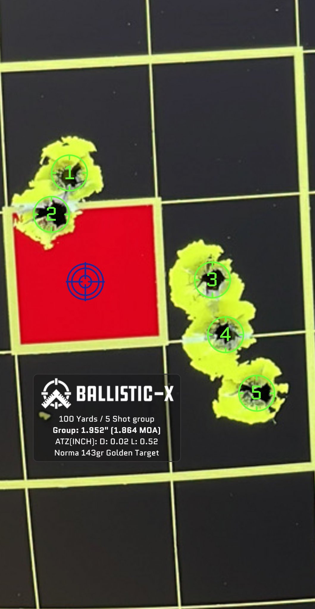

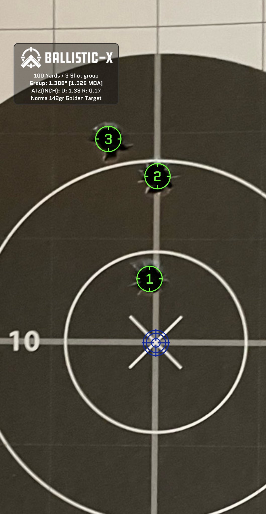

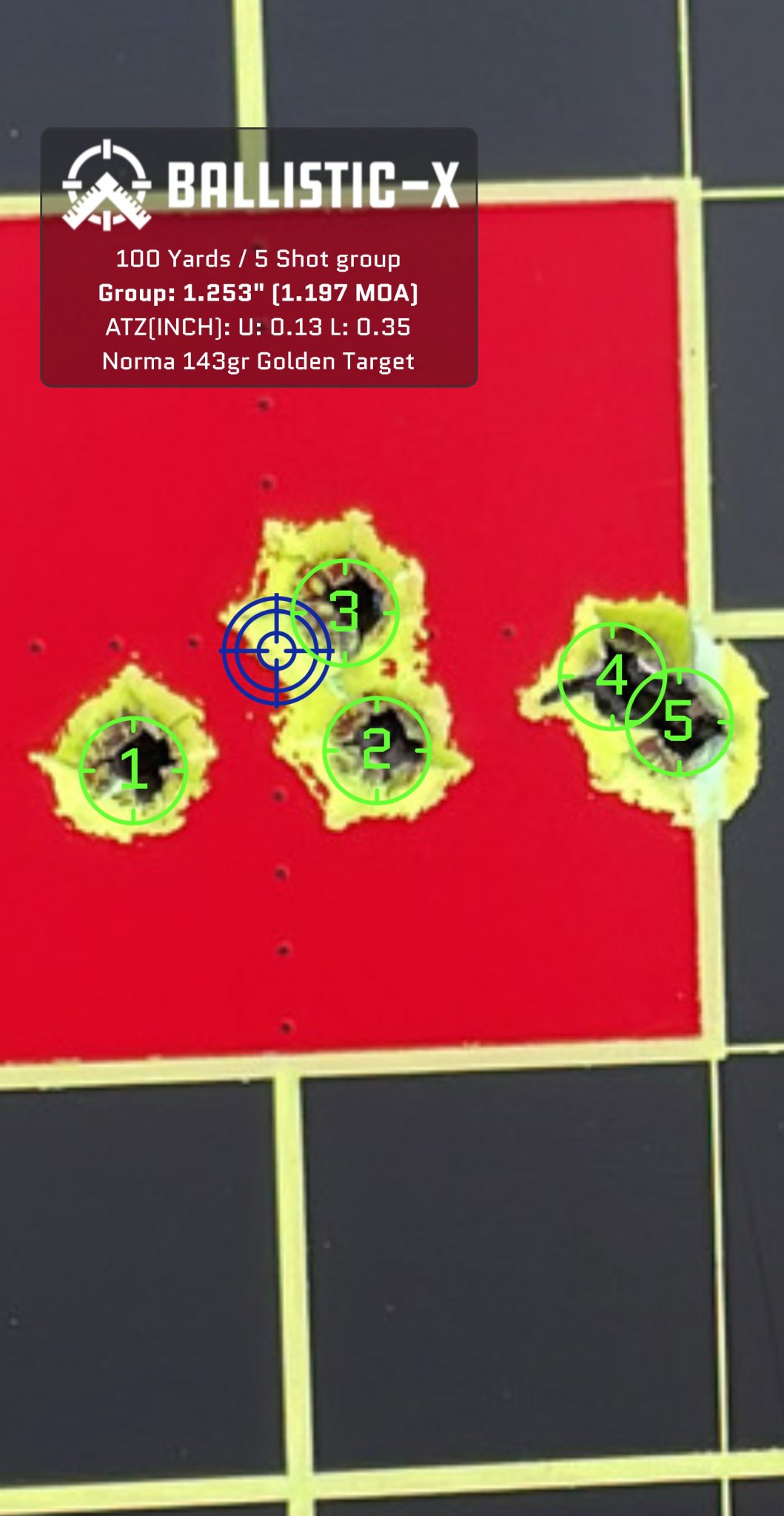

I shot one more group with the Norma 143gr GT and it performed about where it did yesterday.
Ballistic-X-Export-2022-04-30 11:21:02.415013.jpg
Ballistic-X-Export-2022-04-30 11:23:03.763043.jpg
Ballistic-X-Export-2022-04-30 11:22:05.667903.jpg
Although I don't know what's wrong with it yet, this gun should have never left the factory. Now the fun part—dealing with Springfield's customer service!
  • Ballistic-X-Export-2022-04-30 10:53:59.321583.jpg
  • Ballistic-X-Export-2022-04-30 10:56:09.684397.jpg
  • Ballistic-X-Export-2022-04-30 10:54:56.718636.PNG
View attachment 7859933View attachment 7859935View attachment 7859944
View attachment 7859940View attachment 7859941View attachment 7859942

They tested the rifle, and sure enough, it performed the same way it had when I was behind it. That is, not meeting their 3/4 MOA guarantee. They replaced the barrel on it, retested, and it met their standards. The rifle is shipping to me this week.
Glad I didn't follow some other members' advice on trying every ammo out there before blaming the rifle!

I had finally gotten the chance to shoot mine and the results are lack luster. I’ve tried hornady 130 elem, 143 eld x, 140 match and Sierra 130 game changers. I can’t seem to get below 1 moa. This is also using h4350 and varget in combination with hornady and lapua brass. I’m about 80ish rounds in and it just hasn’t found a happy place. I already did one warranty for the stock and I’m thinking now I’ll have to do another for the barrel or sell the rifle and cut my losses. So if anyone has experience with a barrel replacement, please share your experience.
Don't let SA off the hook- hold them accountable. After they fix it is the time to dump it.
