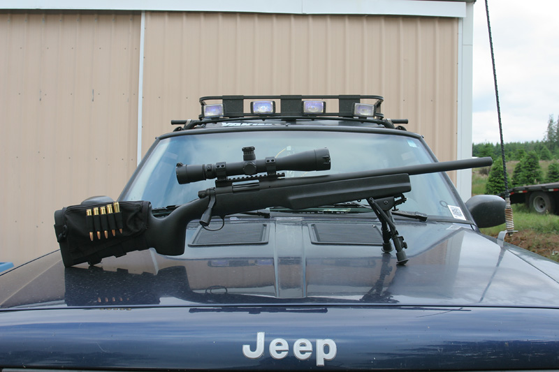

I have a SPS Tactical and so far i have added a Mc A5 stock + NXS.
