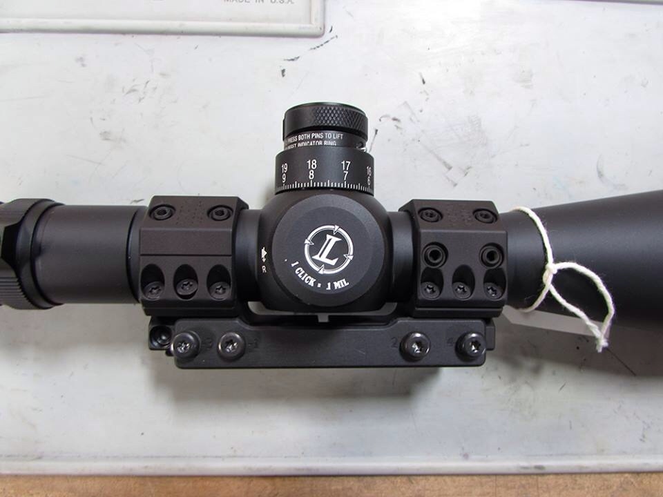

Searched through the forums and Google and couldn't find anything on witch mount works for this scope. Through trial and error with Mile High I have found the SP-5001, and SP-5006 won't work. Anybody have one in a Spuhr mount? Spacing needs to short like a S&B but 35mm tube.
Contact Hakan Spuhr directly, he posts all the time here on the 'Hide and is great with getting you the info that you need.
From beginning all 35mm mounts was longer (about 5,47") due to fit US Optics scopes. But as us Optics discontinued their 35mm scopes and Leupold started we changed length on all 35mm models to 4.96".
So all our recent manufaktured 35mm mounts fits Leupold mk8 3.5-25
Yup. My 5006 fits my MK8. It's the 4.96" version. Beef curtain, if you want to grab one I do have an extra one. I snagged two a few months ago with some plans in mind that didn't pan out. I've got one extra brand new sitting in the safe. PM me if interested...
