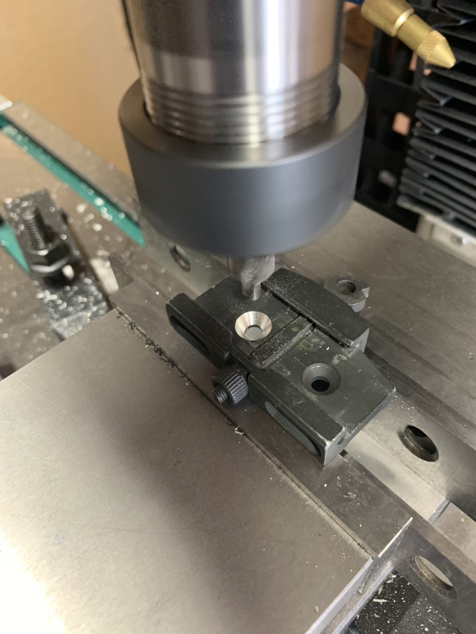

I was the cnc guy at a gun company for a long time - so my building of it was less impulse than it was practical.
I actually built this sucker lol. Reminds me I need to tune its axis a bit tighter. i have a bit of backlash
