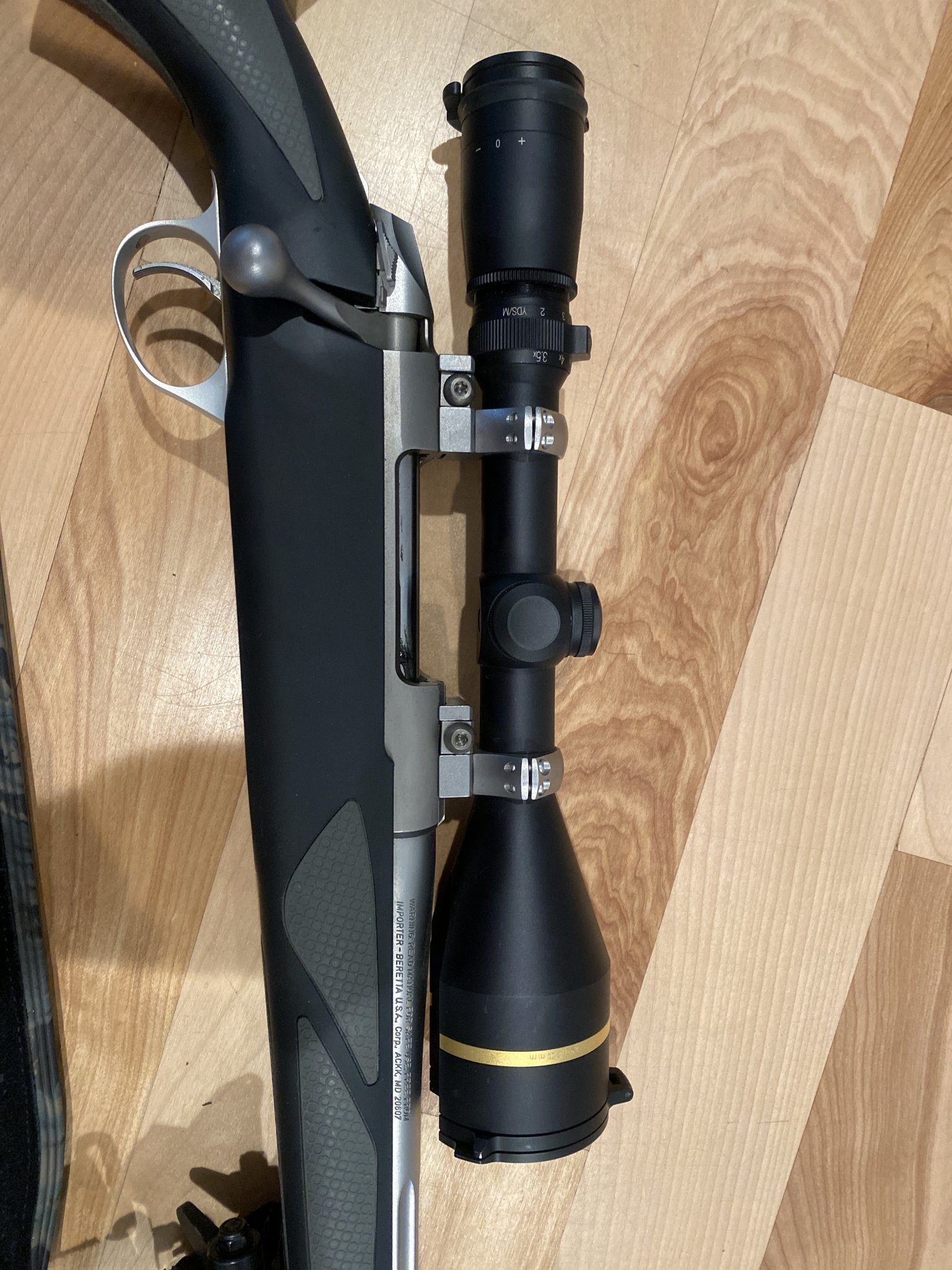

Anybody used their Hunting series of rings? I am trying to help my father get a Leupold Mark 5 3-18 mounted on his rifle. It is a Sako 85 action with a fluted lightweight barrel. I see that spuhr makes 35mm rings for the sako/tikka action but they are so low looking not sure the scope will fit.
Anybody that can help me getting rings for this combo I would appreciate it.
Do you have the Optilok bases already? I believe that's the only mounting option for 35mm in the Hunting line. It should clear the 44mm OBJ no problem once you account for the height of the Sako bases.

Are those blocks the bases? So these mounts will fit right on top of those? Again do mostly mounts on picatinny rails, don’t know as much about the base system.
Yep, the Spuhr rings replace the Sako factory rings. Should work fine.
