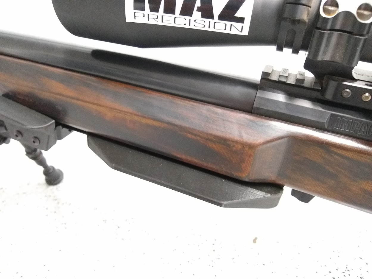

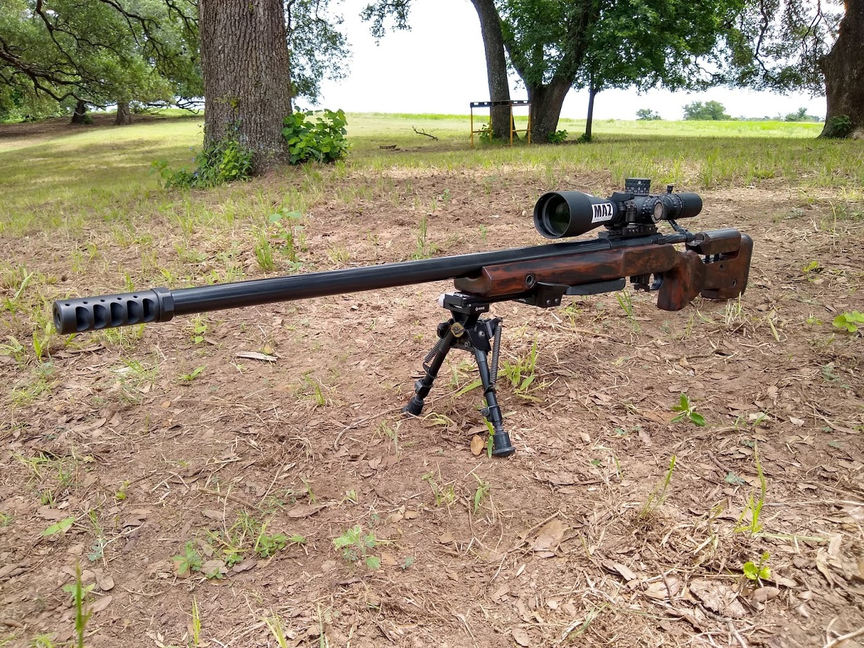

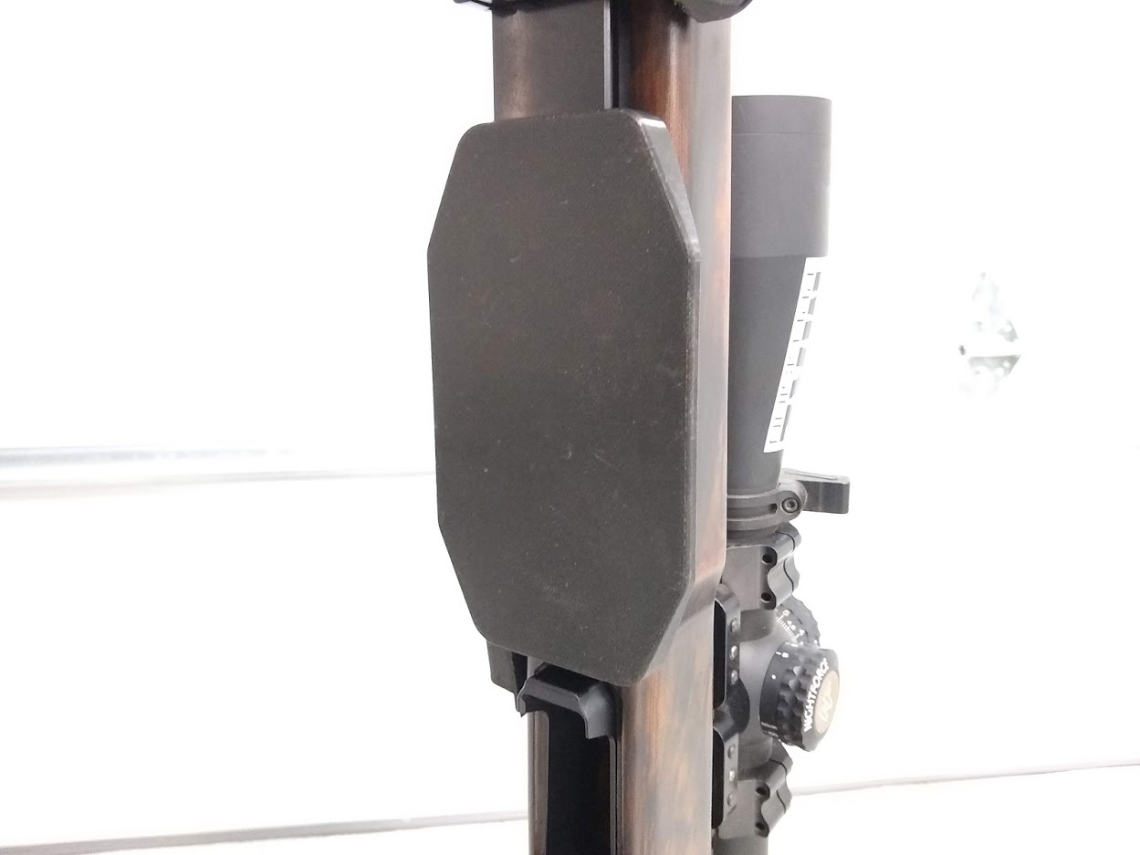

You just 3D printed a gamer plate. What he was talking about is more like the competition side rails that MPA sells. That way you widen the forearm but don't lose any arca real estate.
That's exactly right. I was talking about widening the actual forearm of the chassis, like the effect of the side rails:
But what you can see is that then you have problems with some Arca attachments. What would work better for a wide forearm would be something like the Anschutz rail system, but there's not the same level of support for that.
Thats the problem with an arca rail and a wide forend. You will have to increase the height of the arca rail to make clearance for arca accessories but then you lose the purpose of the wide forend for stability.
