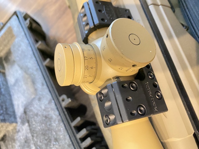

    Cracked mounting plates
    Causes some scopes to lock up the magnification ring.
    Rare reports of cracked ring top halves.
    Buy a set of NightForce. More durable and almost as many Mount options for rails red dots etc. and cheaper.
    The one thing I'll say in favor of Sphur is that they offer a nice variety of built-in angle. The 3 MIL version ended up being perfect for maximizing the available travel of a 7-35x ATACR on an AXMC without getting stupidly-close to the bottom.
    Otherwise, yeah, I really like the NF and Badger options.
    Never owned one, but they’re the only mount that I know of that recommends rosin for the ring/scope interface, and oil for the mount/rail interface.

    The praise for Spuhr is a little surprising considering the amount and nature of failures that I’ve seen.

    Bought one Spuhr for a rifle that I needed additional scope cant on, and now I have several Spuhrs... and see both good and bad aspects to their design. I don't consider them to be the best mounts out there, but they do offer a lot of cant choices and versatility for adding extras to them if you need it.
    My main reason for liking the Spuhrs is the wide variety of cant angles available to tailor the available elevation left in the scope after zeroing. Some of my rifles have integral rails or there aren't many cant choices in the available rails for them so you're limited in choosing total cant if you’re shooting something you want to max out your usable elevation on. Sure, the Burris Signature Zee rings work and give you several cant options based on combination of inserts, but those inserts can be quite fiddly. They do work though. Never tried an ERA-Tac or any other adjustable mounts.
    I do like unimounts... if they're machined properly, they have a better chance of keeping the scope mounting surfaces concentric than separate rings and rails. Also, with a unimount any rail to mount interface mismatch will be isolated in that interface and not transferred into the scope tube-- although quality rings and rails very rarely have issues unless you buy dirt cheap crap quality ones or get a defective piece. Unimounts also make it a bit easier to jump a scope to a different rifle if needed without having to slightly relocate one scope ring-- I've had to do that in the past when slot spacing was just slightly different between rails on different rifles and the recoil lugs on the rings wouldn't quite drop in until I slightly moved one ring.
    While I like the look and design of the Spuhrs overall, I do think Hakan got a little crazy in his solid modelling program and filleted, chamfered, and trimmed some areas down way too thin in the name of weight savings and probably cosmetics. IMO a bit of extra material in a few spots would greatly increase strength margins and not increase weight all that much. My hunch must have some merit as later production version Spuhrs have more material in certain areas along with revised bolt spacing leaving more material in the areas I thought were questionable on the earlier versions (notable changes: outboard ring screws have been moved inwards slightly leaving increased wall thickness at the outboard screw counterbores on the ring caps, and the clamp bars now have extra material under and around the clamp screws.)
    All but one of my Sphurs have been problem free. However, one of them cracked the clamp bar twice when mounted on the same rifle. Ended up selling that rifle and moved the mount to another rifle and the clamp bar hasn't cracked since, so it was probably an out of spec rail putting excessive stress / bending load on the clamp bar. However, the clamp bar likely would not have cracked if more material was left around the clamp bolts-- the newest version clamp bars do have additional material thickness and edge margin around the screw holes compared to the 2x earlier version clamp bars that cracked on me. Both were replaced under warranty for no charge both times, but IMO something as simple as a clamp bar shouldn't have failed in the first place. If it had cracked at a match or on a hunt it would have been game over. Those cracked clamp bars did make me consider selling and upgrading my earlier version Sphur mounts to the latest versions with additional material, or switching back to standard rings-- probably NF, ARC, or Seekins.

    What happens when your S&B slips in a spuhr mount? Well you ad rosin after the fact, but it still leaves you unhappy. Cause now you have a little gouge.

    I'm kind of wondering how much of the problem is also user error.
    The instructions that come with the Spuhr mounts don't seem to be the best. I had to learn a few things by emailing and asking them.
    One thing they recommend is using wet torque on the ring halves - either with loctite or the factory wax that is put on the screws.
