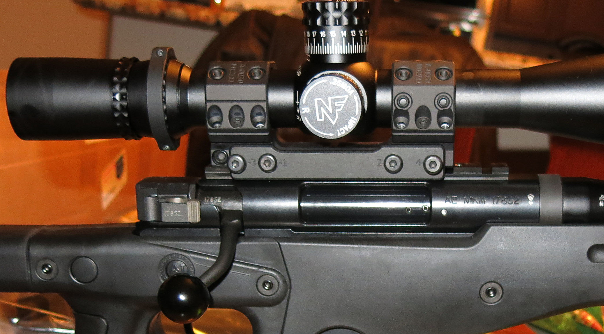

I couldn't find the answer I was looking for on this and wound up spending $200 more than I needed to for a Murphy titanium rail. I need a bit more height due to my size of my watermelon head and went with the SP-3006 (1.38"). I was told by MHSA when I ordered the SPUHR that I needed a full pic rail to make it work. Not so...the 1.38" and the 1.5" have a single rail which fit fine on the stock AIAE rail. Murphy's was great to deal with so I hate to send the new bone back but it really isn't needed unless you use the 1.16" mount. This is my setup on the AIAE MKIII.

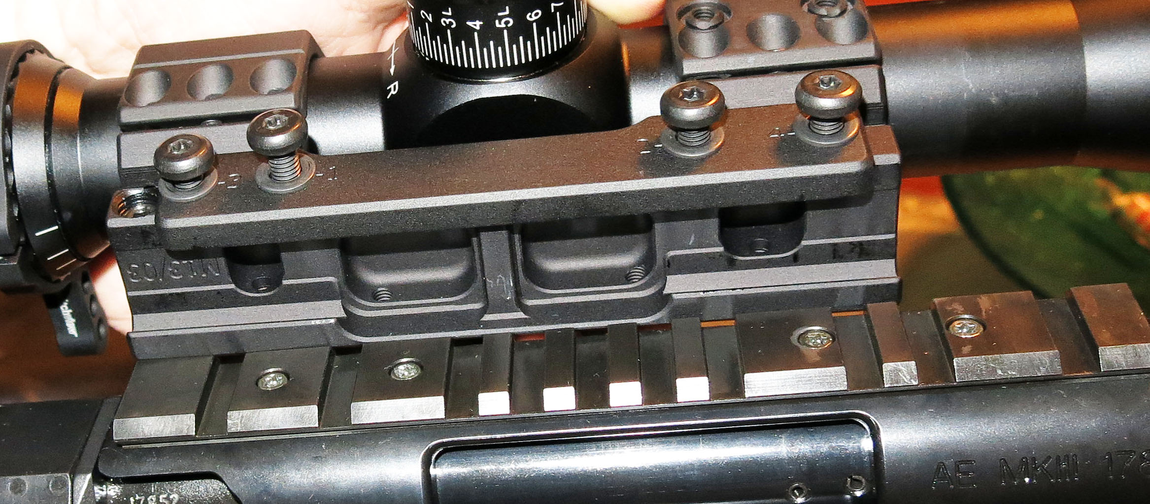

I did buy a murphy pic rail with my SRUHR mount, but you can run it with the AI rail if you put it all the way forward or all the backward. You have to turn the rail around to achieve one or the other.
Yes, here is mine with a factory base.
