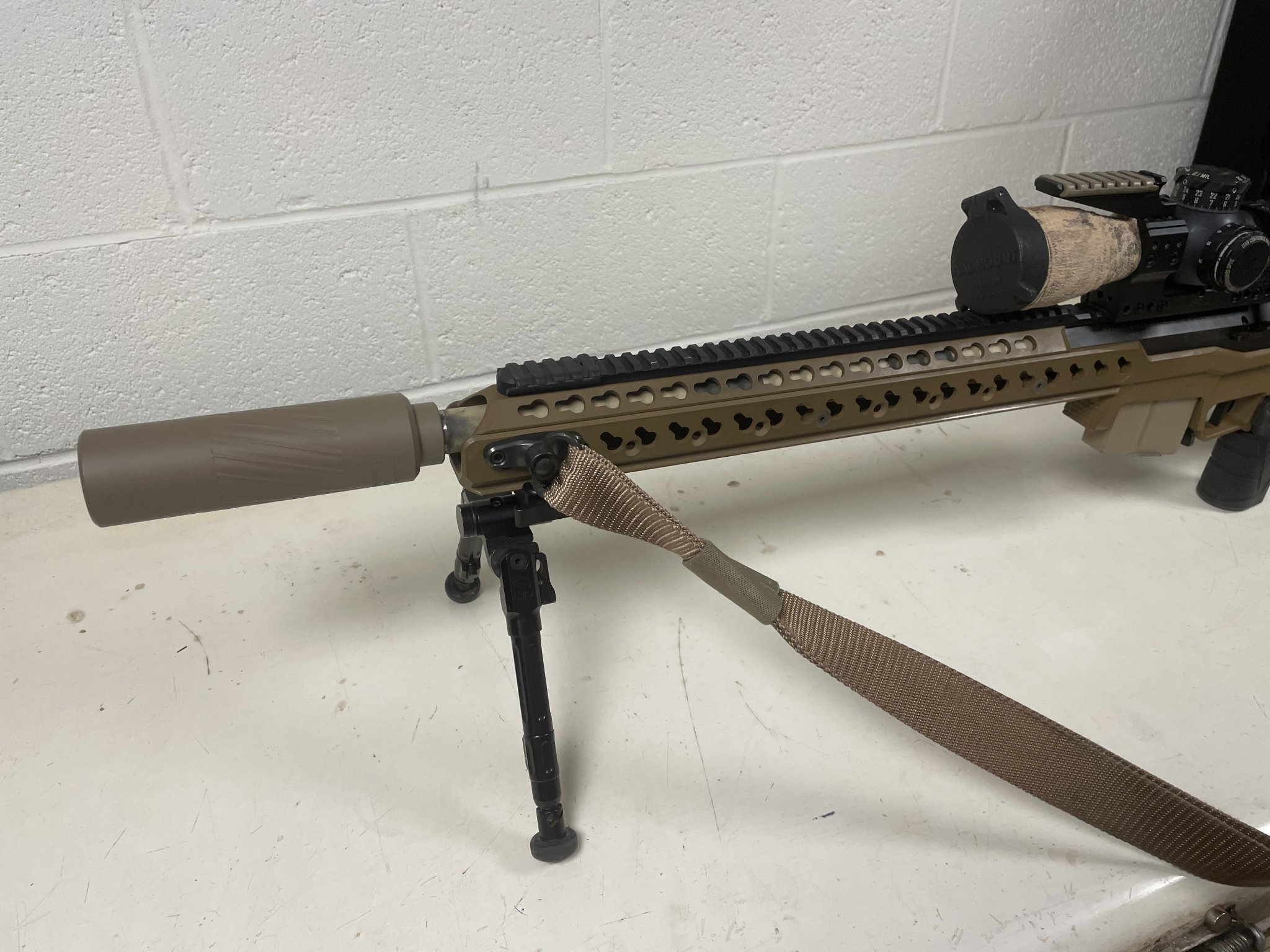

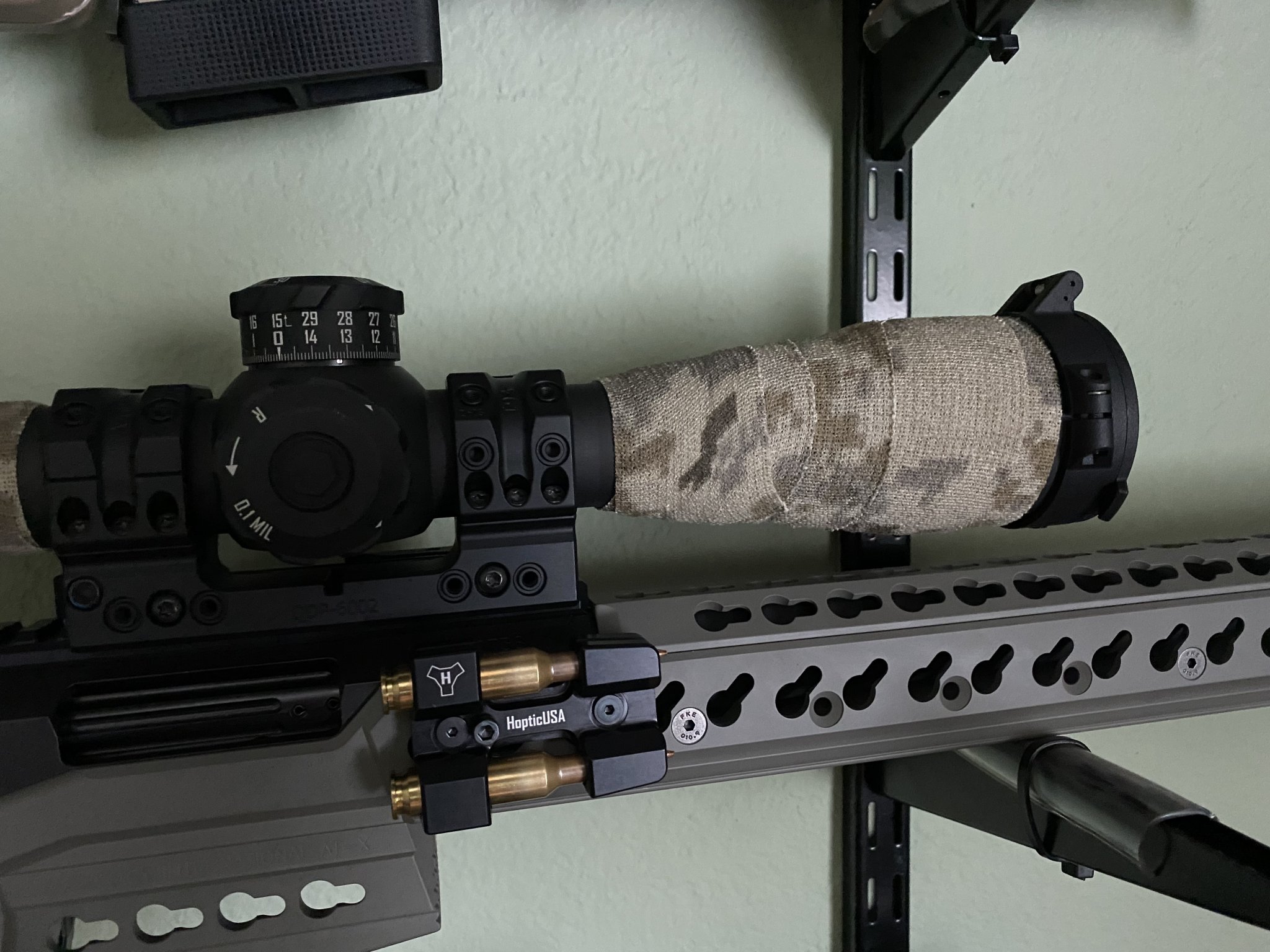

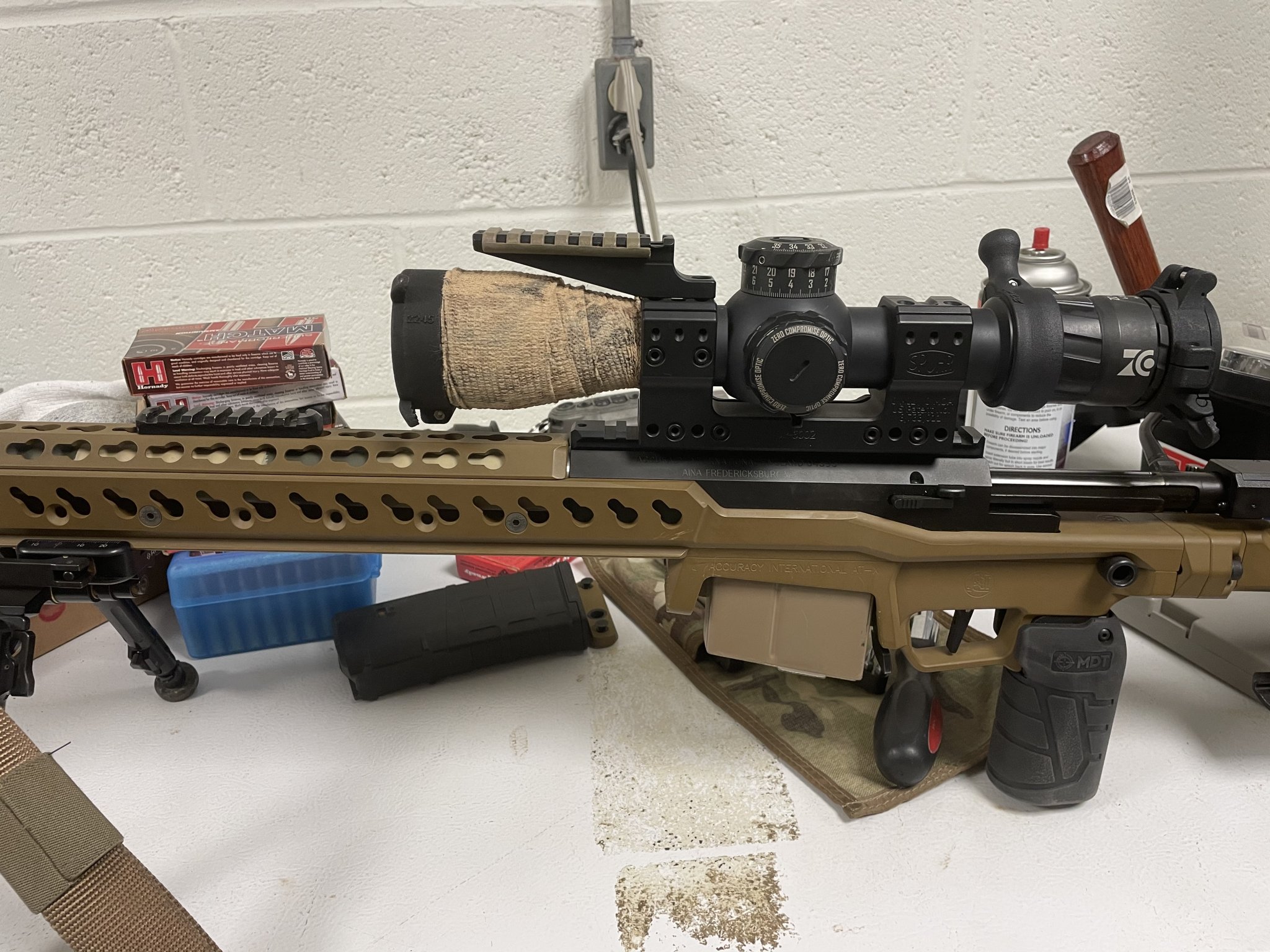

1.5 would be my suggestion. I'm running a ZCO 5-27, and it leaves about 1/4"-3/8" clearance with the full length bridge.

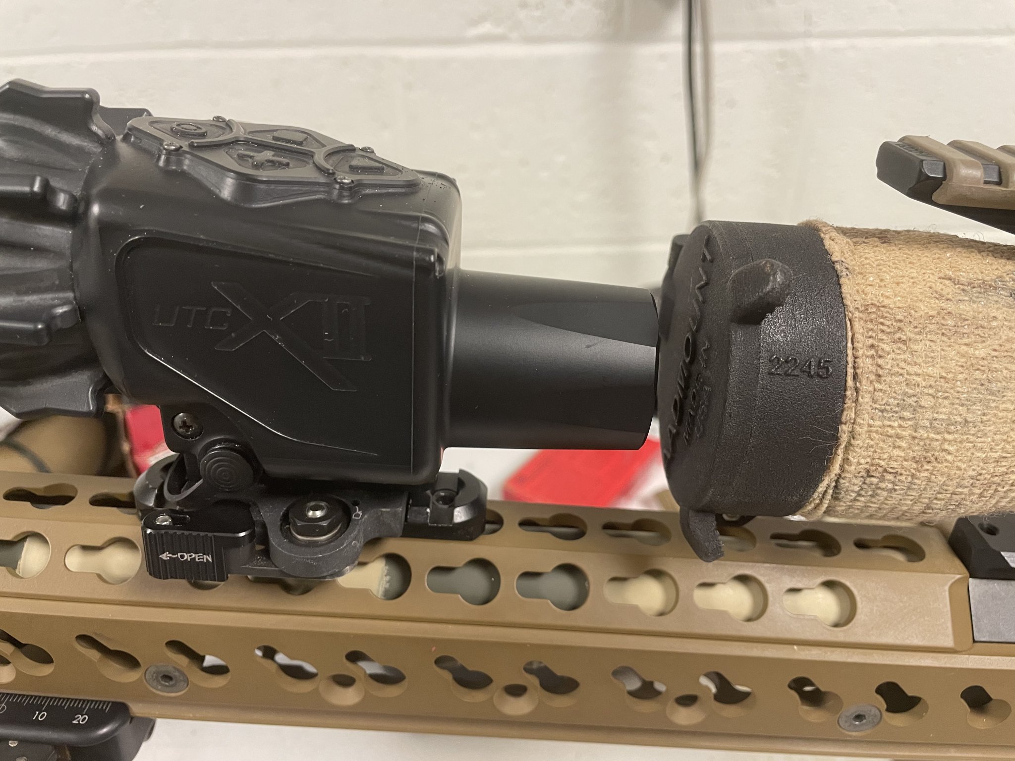

Depends...are you getting the correct colinear action rail to be on plane with the NV rail?
@deersniper what mount were you getting away with the short action rail?

1.5” Spuhr with the stock (low?) pic rail.

Running a 0 moa spuhr. I recommend the same if OP is running clip ons.

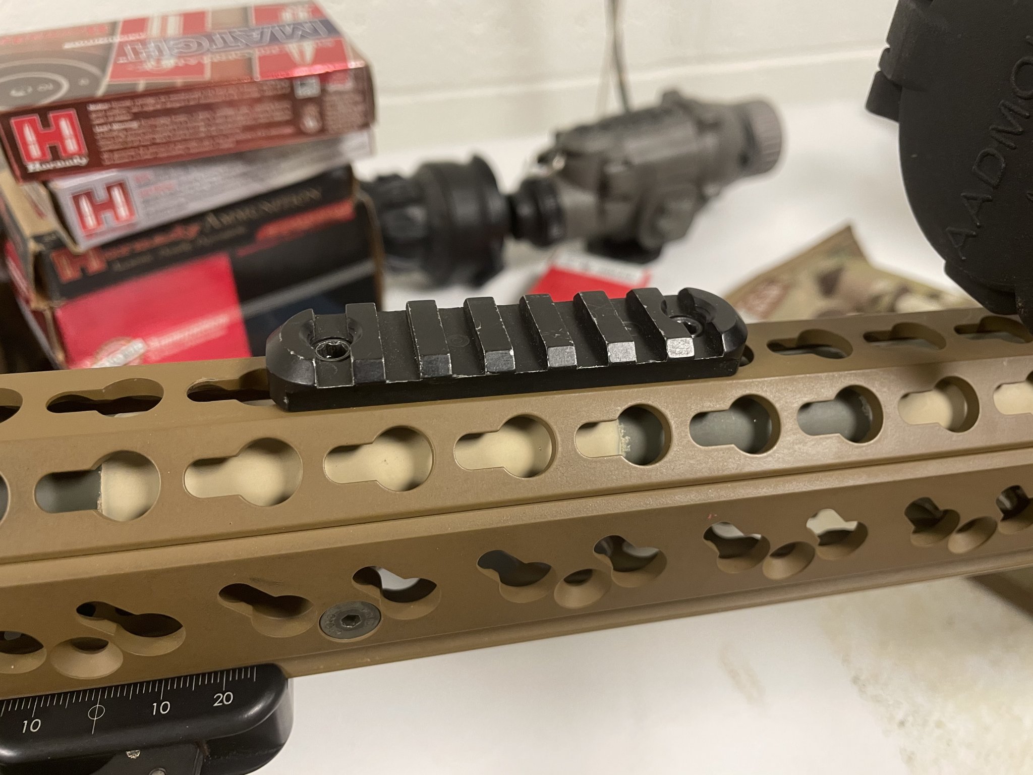

I’m just using a short section till AI gets the canted shorts in.
1.5 Spuhr lines up well with 1.3” centerline clip on. Using factory action rail.
Running 420x50 Zcomp with room to spare FYI
