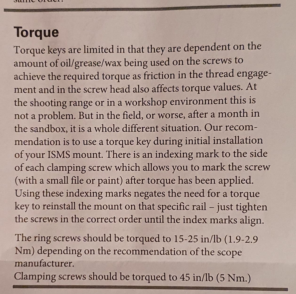

    I decided to make this for anybody looking for information about torque for Spuhr QD scope mounts.
    Spuhr recommends 5Nm / 44inlb for the rail mounting screws.
    I have a Hazet 0.6 to 9Nm adjustable torque wrench and I have few times tried torquing it higher than what I am using it now.
    So yesterday I thought to experiment it and tested how high can I go. I started from 5Nm and could not even move either one. Dropped to 4Nm and it started to seem possible..
    The result was 3Nm / 27inlb front and 2.8Nm / 25inlb back, this is probaly result of the mount attaching to the hand guard rail in the front. But these torques are tight and also make it possible to install the mount like it should be, easy and fast!
    Having changed torque values, I went to range and was ready to spot the impacts in the snow behind the target.. And noticed the zero was unchanged. So I guess the torque is not that important, as long as it is tight enough.
    So there, Spuhr QD certainly is quite well made. Not only could it take being taken off and back on without impact on zero, it did not mind me retorquing the screws tighter.
    Did you get the 5Nm/44inlb from a spec sheet or an email to them? I looked through the spec sheets and didn't see this listed, but I might have missed it. I you have it, could you share it?

    Good questions. I googled and I think the instructions that came with it also mentioned it.
    But nowhere is mentioned how much the QD needs.
    I do not think installing the clamp with screws is possible, the basic mount uses 4 screws whereas the QD has 2 QD levers / screws.
    Even though the the clamp could be removed and the basic one installed, I suspect that the holes would not align.
    Edit:
    Added the image of the instructions that came with the mount, citing torques to be used.
    Reactions: M8541Reaper

    Thanks for the picture. Seems they just haven't updated the spec sheet they have on their product page.
    EDIT:
    Spuhr confirmed that mounting methods cannot be swapped between.
    FYI: Their CS team is on point. Had a response, with a comparison picture of the two models, within 3 minutes.
