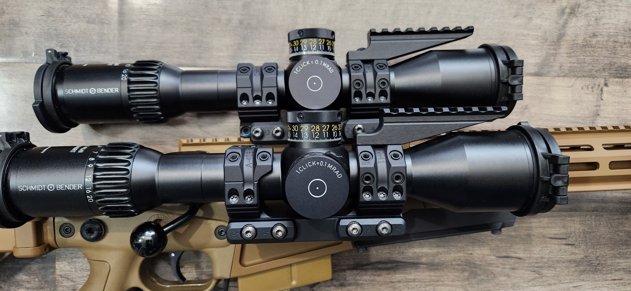

Been running the C versions on a few guns for a while. Don't notice a difference. I turn the smaller cap around so it doesn't extend back on the scope. Just purely a looks thing but these new mounts work just as well.
Reactions: SpeedDrop

Yes mine had a hairline Crack across the bar from a 300 norma magnum. Ran fine with everything else.
