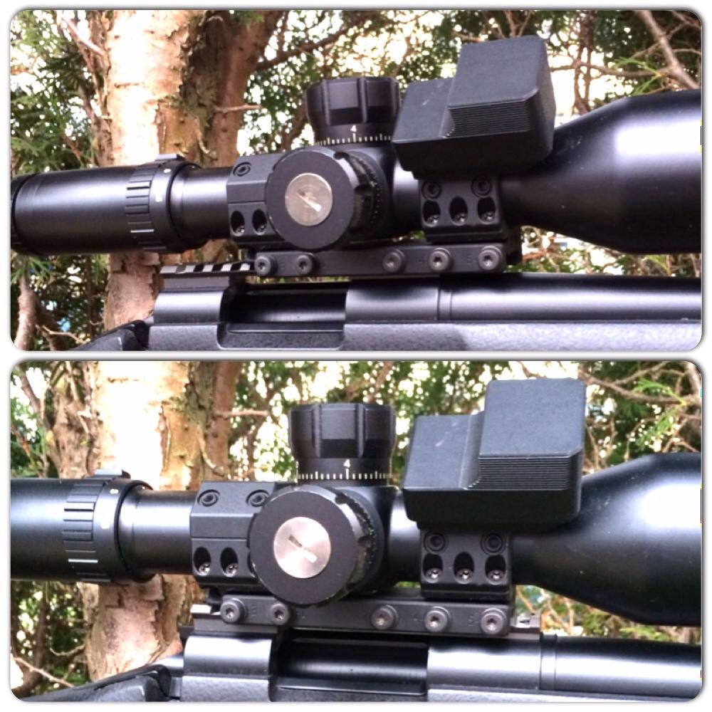

The SP4011 that is kind Of a specialmount specified by GA Precision to be mainly used on riflebuilds on short remington 700 style actions like defience and Surgeon with long eyerelief scopes like bushnell.
The mount is 34mm and 1.1" High.
Its both a straight and a cantilever mount and can be mounted Either way.
Due to low height this will not work with SB 5-25 or 3-20 as their adjustmenthousing builds down to much.
But works fine with SB 3-12, 4-16 and bushnell HDMR.
It's made to work well with The overhang.
Here is same mount on my long action AR10.
Yep 1.1" High on AR10 gives a wonderfull cheekweld.

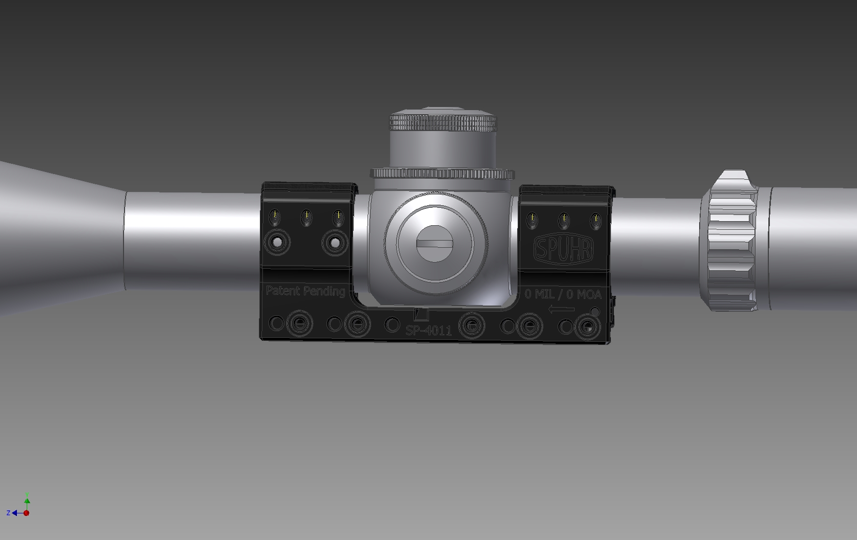

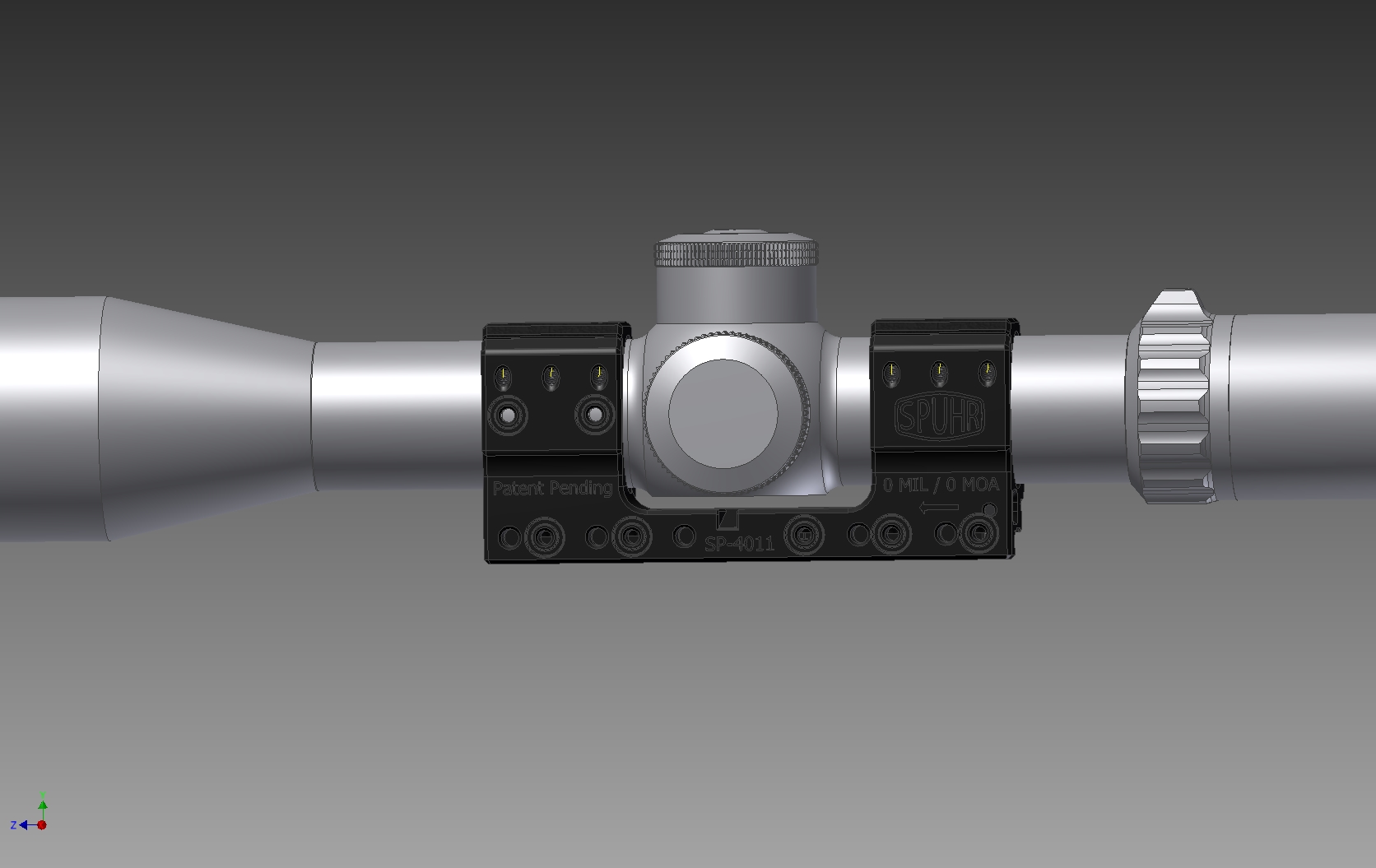

Yep, both the Kahles K312 and K614 will work.
Here is a few pics out of the CAD.
