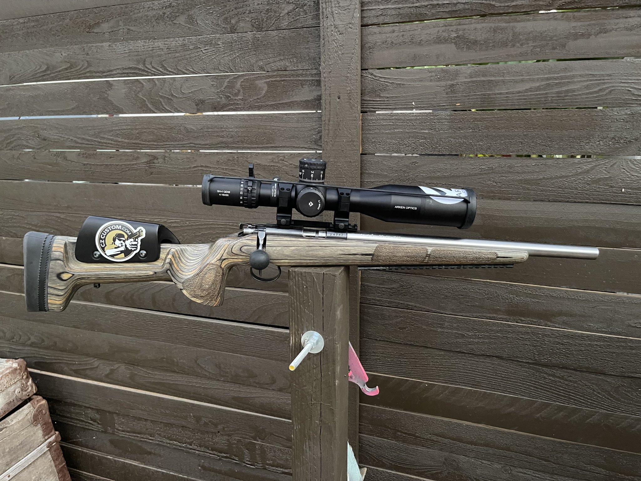

I built a rifle on a CPC swager barrel. 17/22 swager with 1:8 PacNor barrel. It is a very fun gun to shoot. It is not an alternative to 17HMR. It is a different animal than a 17m2. But it is plenty accurate for squirrel hunting and will make headshots out to 75 yards, and stay in the vital zone past 100 yards. I built it in 2000, then a couple years ago kind of rebuilt it by shortening the barrel and having it bedded into a new stock as seen here. Action is BRNO. I have never seen any additional velocity. I have captured fired bullets and they do grow. Remington Yellowjacket 33gr. bullets stretch to .500 long. This does noticeable improve downrange velocities. Also, the rotational velocity of the bullets is very high from the 1:8 barrel (some people built guns with 1:7 twists) so bullet upset is very explosive on hydrostatic targets. Like I said, it is a fun gun. Mine wont' stabilize bullets heaver than 36grs. and is happier at 31-33grs. Federal 724 a 31gr. shoots very well in mine.

Yes, I have posted it here. you can search for all my posts.
If I understand your question, the accuracy potential is ammunition limited like most 22lr guns. You will still have flyers. This is why it is a hunting setup and not a PRS or benchrest setup. The swaging does not eliminate flyers. Whether it reduces the severity of flyers I have no way to test.

When you shortened what was the change? I'm a fan of shorter barrels and I have a 22" now and would like it if I could expect same results from a 16.5. I also plan to thread it and run a suppressor
The barrel was originally 24 inches. I had to spray moly the bullets to prevent leading in the last few inches of barrel because the wax lube was inadequate to lubricate that much bore. I built special gigs for this task.
Now, at 17 inches, I do no have to moly spray the bullets and I do not get leading in the bore.
That very interesting. Do you think shortening made it loose any velocity or accurate consistency?
Shortening did not impact velocities in any meaningful way. Perhaps a slight increase in speed. Accuracy improved because the gun no longer throws wild flyers due to a bullet streaking lead in the bore. Also a handier rig now. It was a significant improvement.
Sir, you mentioned lead streaking near the muzzle. Was this with those same plated/copper washed hyper velocity rounds 28-33gr rounds or pure lead 38-40+gr ?
with the 24-inch barrel, I saw leading with all ammunition unless I coated the bullets with moly spray. At 17 inches, the barrel no longer shows leading and moly coating bullets is not needed. I plan to test the Federal Punch ammunition today. Should be interesting.

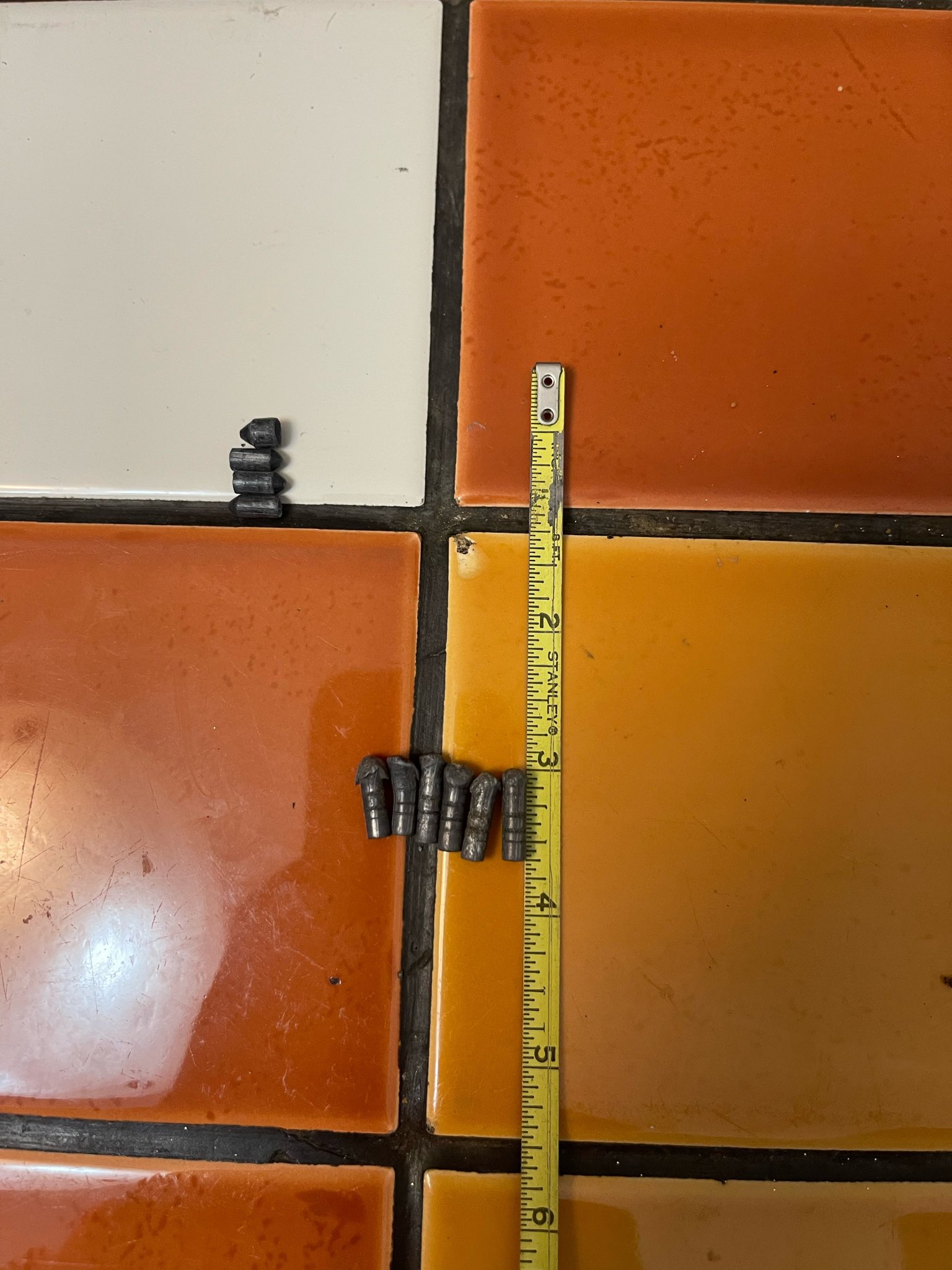

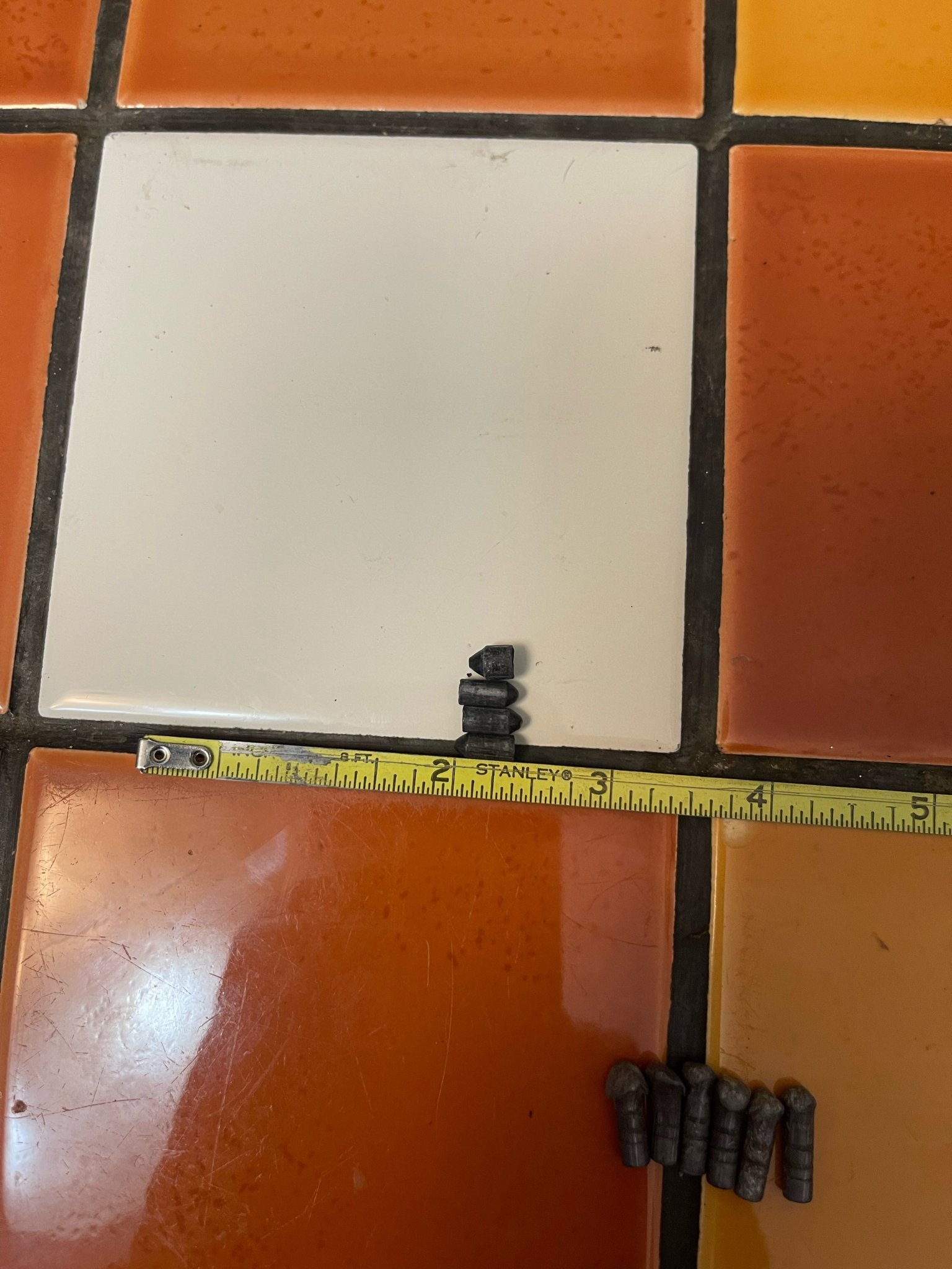

A bit more data for everyone. These are pictures of recovered bullets fired from my 17/22 Swager. The short bullets are 29-grain high velocity hollowpoints. You can see the three 17-caliber bullets fired from the swager are longer than the 22-caliber bullet fired from a standard 22lr barrel.
the longer bullets are 33-gr. Remington Yellowjackets fired from my Swager. None are pristine, but even slightly banged up, they are longer than .500 of an inch. I don't currently have a recovered or pulled 22lr bullet for comparison but I have measured them and they are significantly shorter than the swaged bullets. This proves the higher BC claims. The claims of greater rotational velocity are merely a matter of mathematics.

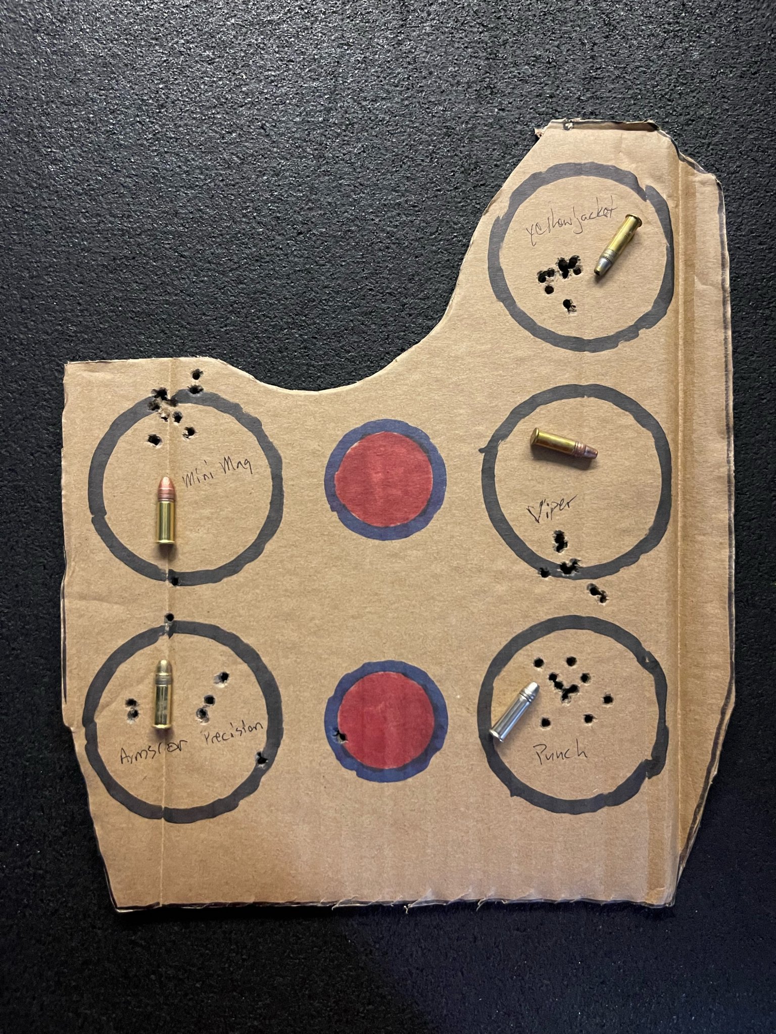

Lots you can take away from these numbers but let me give some visuals also. Just some groups so you can see what the rifle can do.
left row top Mini Mag. Left row bottom Armscor. Right row top Yellowjackets. Right row middle Vipers. Right row bottom Punch.
It is no match rifle, but it will put meat in the pot or varmints in the dirt. All groups are 10-shots at 50 yards from an improvised benchrest indoors. The benches are not designed properly for target shooting so there is no way to stabilize the buttstock on the bench. It is floating in the air with only your hand and shoulder as support. This definitely negatively impacts groups. Still, you get a good idea. Groups may be a little larger than they would be from a proper bench but not too far off.
Barrel = PacNor
Stock = KKC of Norway
Scope = USO TS 3-12x
Barrel = PacNor
Nice! Thanks for some real-time data. Looks to me like the vertical stringing is somewhat less than with standard 22 bore rifles. Maybe I’m imagining it, but compared to what others have posted on ammo testing there seems to be less.
Due to the small sample size and the poor stability of the setup I was using, I don't think you can draw that conclusion from these groups. Anecdotal and entertaining, and reference material is about all I can claim for those groups. I can go back out and do a more thorough test off a stable shooting bench at some point. Headed out of state tmw morning so that will have to wait.
