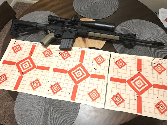

Finally got my SR-25 APR out this weekend and put some rounds through it. I've never owned a "precision" gas gun so I didn't know what to expect. Some pro's: Soft shooter, really well gassed, great ergos, well balanced, great flash hider/muzzle devise, trigger is solid. Con's: was hoping it would shoot a little tighter, KAC QC kinda stinks(will elaborate). I think the gun does a lot of good things and makes it an overall pretty solid package. I think the shining quality of the rifle is the gas system. The way KAC seals the gas system is perfect. There is 0 blow by on the gas block and the gas coming out of the bolt ports is minimal to none. I shot it indoors when I first got it and blasted a few rounds pretty quick and there wasn't any extra gas lingering around. In my experience with AR style rifles this isn't the case indoors. The gun shoots around .8 moa with 175gr FGMM and around 1ish moa with M118LR. This is pretty good don't get me wrong but if I'm being picky I wish I shot it a little better. I'm guessing with a little more practice I should be able to shoot a little tighter but my factory test target was still .75 moa. As far as the KAC QC. When I got the gun I noticed it had a dent in the rail and a few imperfections/dings in the lower receiver. I contacted KAC and they pretty much said it happens and it won't be pretty forever so shoot it. I'm not tripping too hard as the rail covers cover the ding and it will get plenty dirty in the field. It's just when you spend $4.5k on a rifle you want it to be pretty and perfect when you take it out of the box. Overall the gun is a good shooter and solid package. Groups are below, shot at 100yds, velocity was taken with a magneto.

You're not the first to mention the imperfections, I've seen that same complaint on multiple Forums. As for the accuracy .75 MOA is about the norm in capable hands. If you want better accuracy start handloading, if not FGMM and Black Hills are your friends.

Yeah I read that too. Really want to try some Black Hills, hear that stuff really good. Like I said I'm being picky with the group size, it should smack steel out to distance no problem and that's really what I want to do with it.

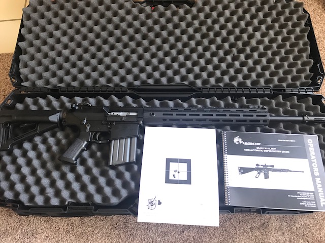

During the Afgan War I ordered a Lightweight Match (20”) directly from KAC.
SEAL package was $7K .
Did not order the package but just the rifle.
Waited about 6 months as they were sending them to the SEALS.
Mine has a 5R barrel and no flash hider, Vero Beach address.
Absolutely perfect when it arrived with the accessories and mags I ordered.
From where did you purchase your SR25?

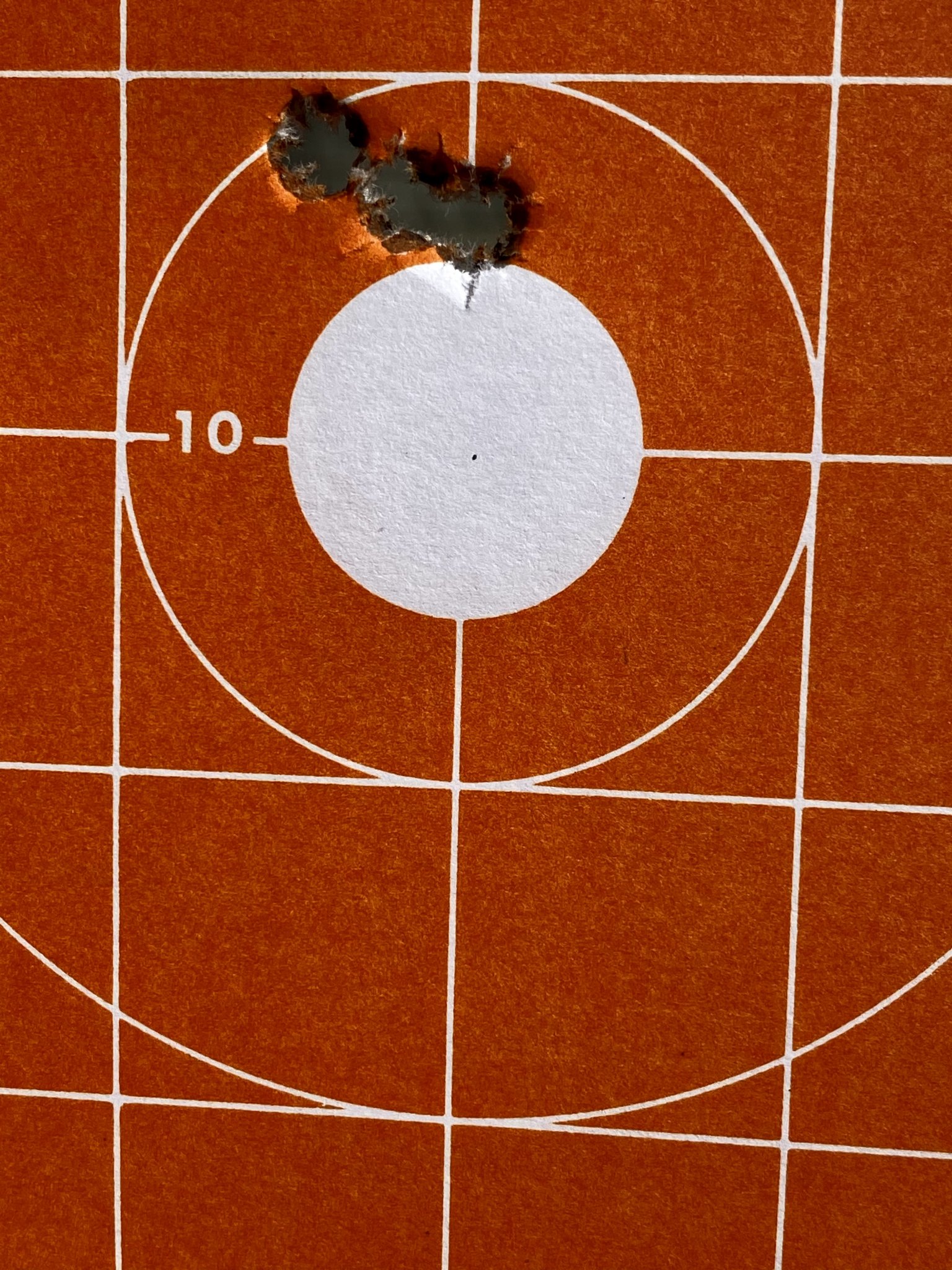

Best group with Rem Match and not best group shown from first range session.
100 yds
-Richard

Interesting groups.
I will be interested in the groups as the barrel ( and rifle ) breaks in more.

Same here (tracking group size trends with my own ACC also).
Jack L/KAC has mentioned a few times here and there that group sizes for these newer rifles tend to shrink by 1/8-1/4 MOA at 500-600 rounds. This pattern was something he stated KAC has observed across large populations of rifles over time.

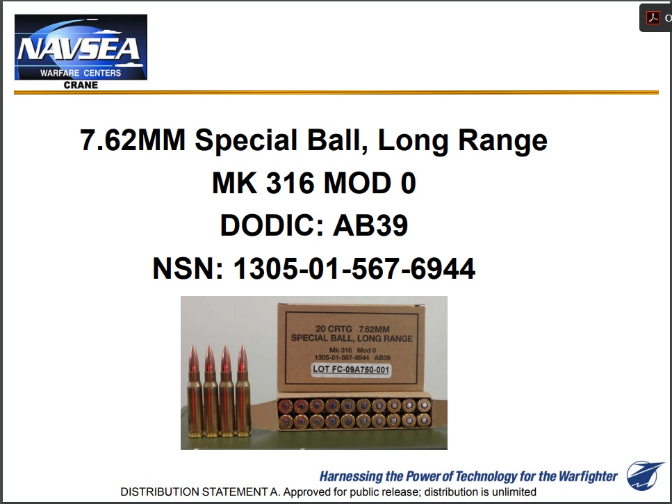

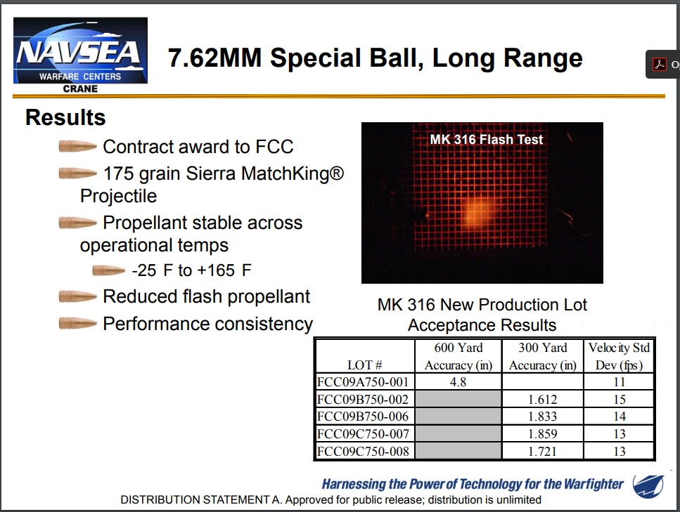

Just for trivia - reference's sake, if the government specifies the rifle must produce ten consecutive minute-of-angle groups with government-furnished M118 LR ammo, the government's side of the bargain is the M118 LR must be capable of producing sub-minute groups.
Declining M118 LR precision consistency is why USSOCOM specified Mark 316 7.62 (Federal Gold Medal Match 175s in military packaging).
