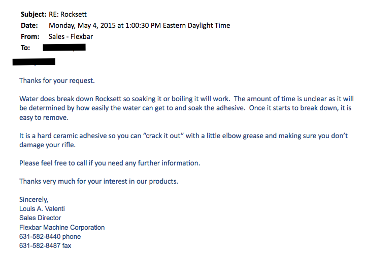

    They are sealed with Rocksett. You can crack the seal by using a dead blow hammer to the muzzle device. That will typically put micro cracks in the ceramic of the Rocksett and spin it off with a breaker bar.

    With rocksett it helps if the water is boiling and you can insert the muzzle end into the water for 15 min or so. They've always softened up for me that way.

    Micro cracks in the ceramic? Never heard that one before. Given the name, everyone assumes that it cures hard as a rock. In reality, Rocksett is no stronger than blue Loctite. It's just much more resistant to heat. Water helps soften but it doesn't even need to be boiling.
    It has been mentioned here a bunch of times. Or feel free to google hit rockset it with a hammer and you’ll see lots of results. I’ve never had luck with the water method.

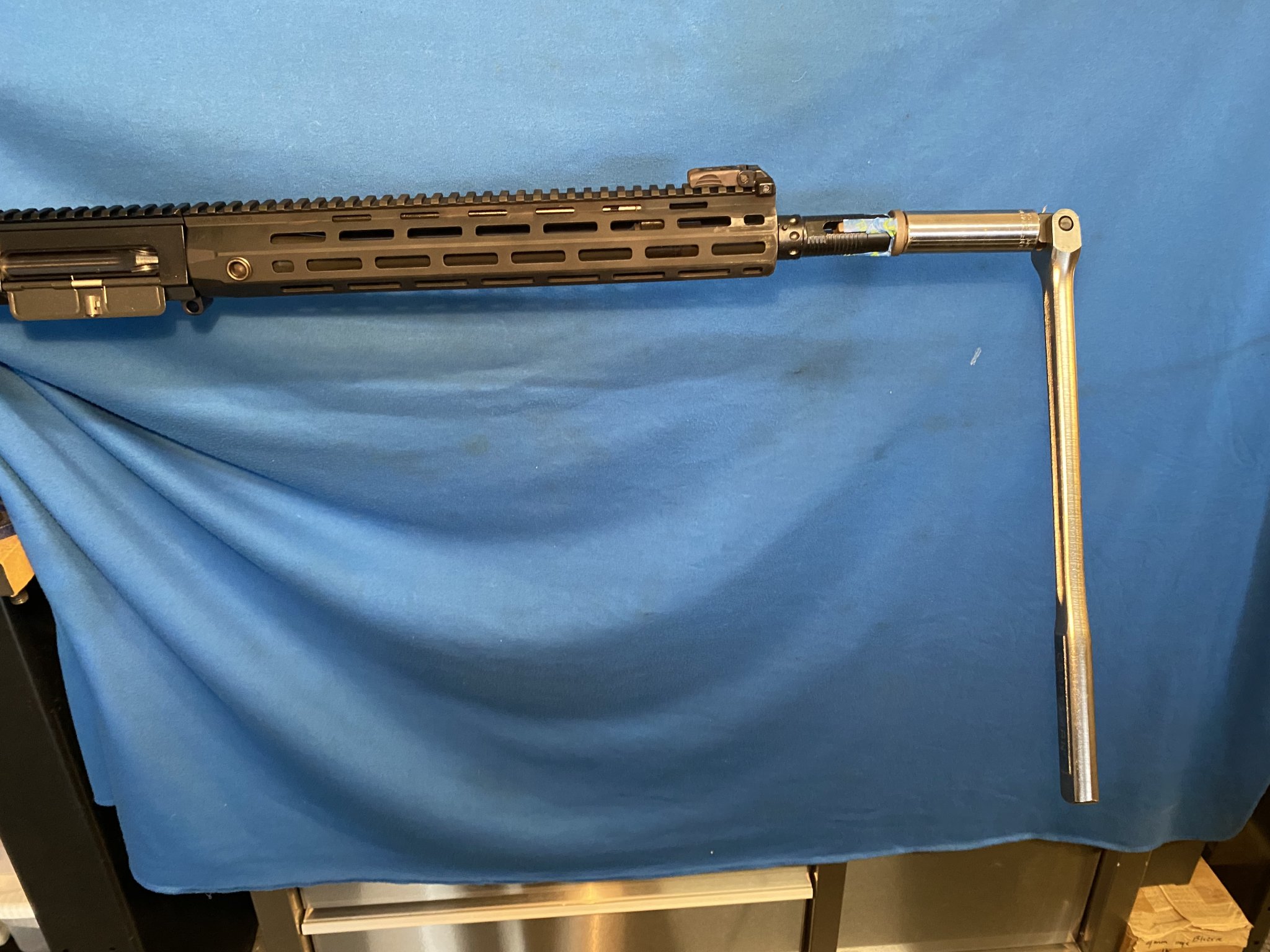

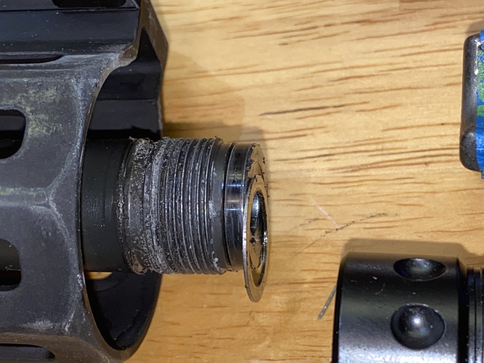

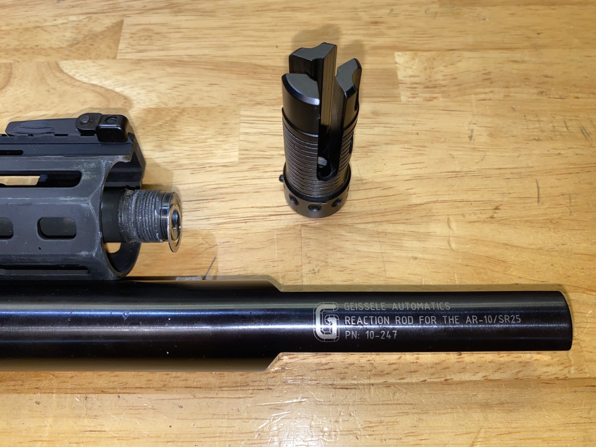

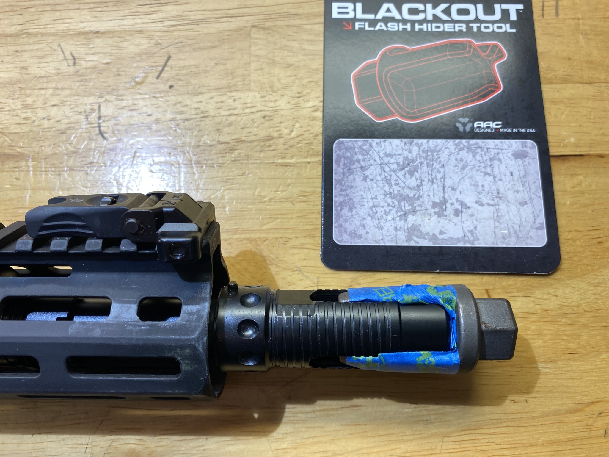

    heated soapy water in a ultrasonic cleaner for about 30 minutes. No magic, just holding the barrel, getting the Rocksett lose and cranking. You might ruin the MAMS. the standard flash hiders seem to grip to a flat wrench better.

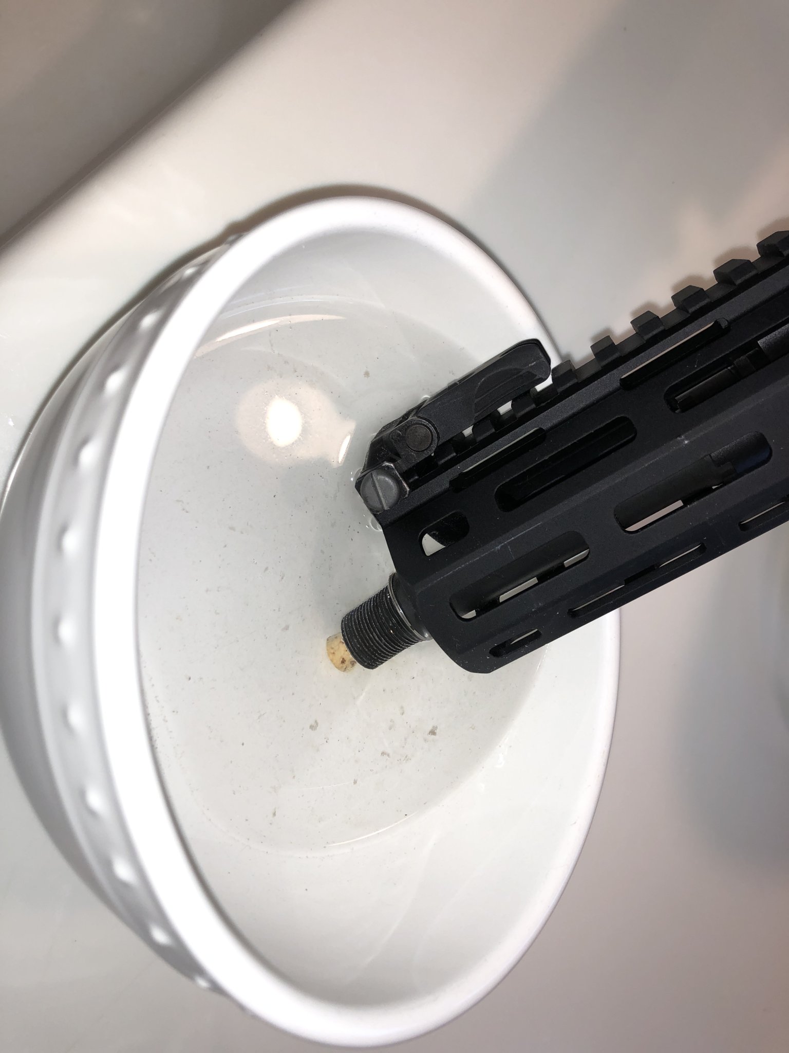

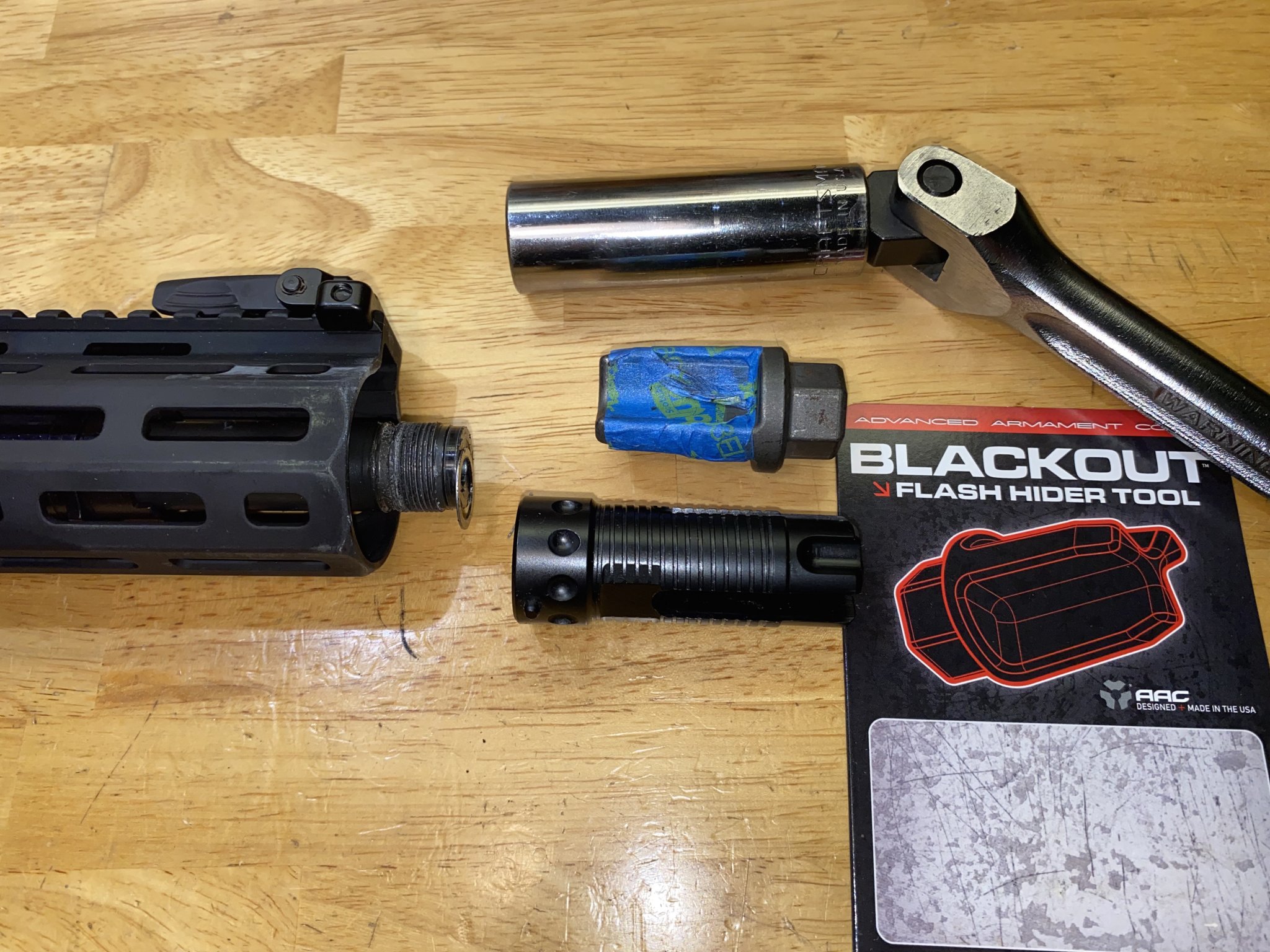

    I recently swapped the KAC device for a SureFire QD mount for a ACC SBR project. The Rocksett is a ceramic-based adhesive that dissolves with water (email from the Horse's mouth) ; I just warm a bowl of water in the microwave for 30 sec, submerge barrel with cork in the muzzle just because. The Blackout flash hider tool fits the SR25 device perfectly. Use a Geissele or KAC reaction rod. Simple.
