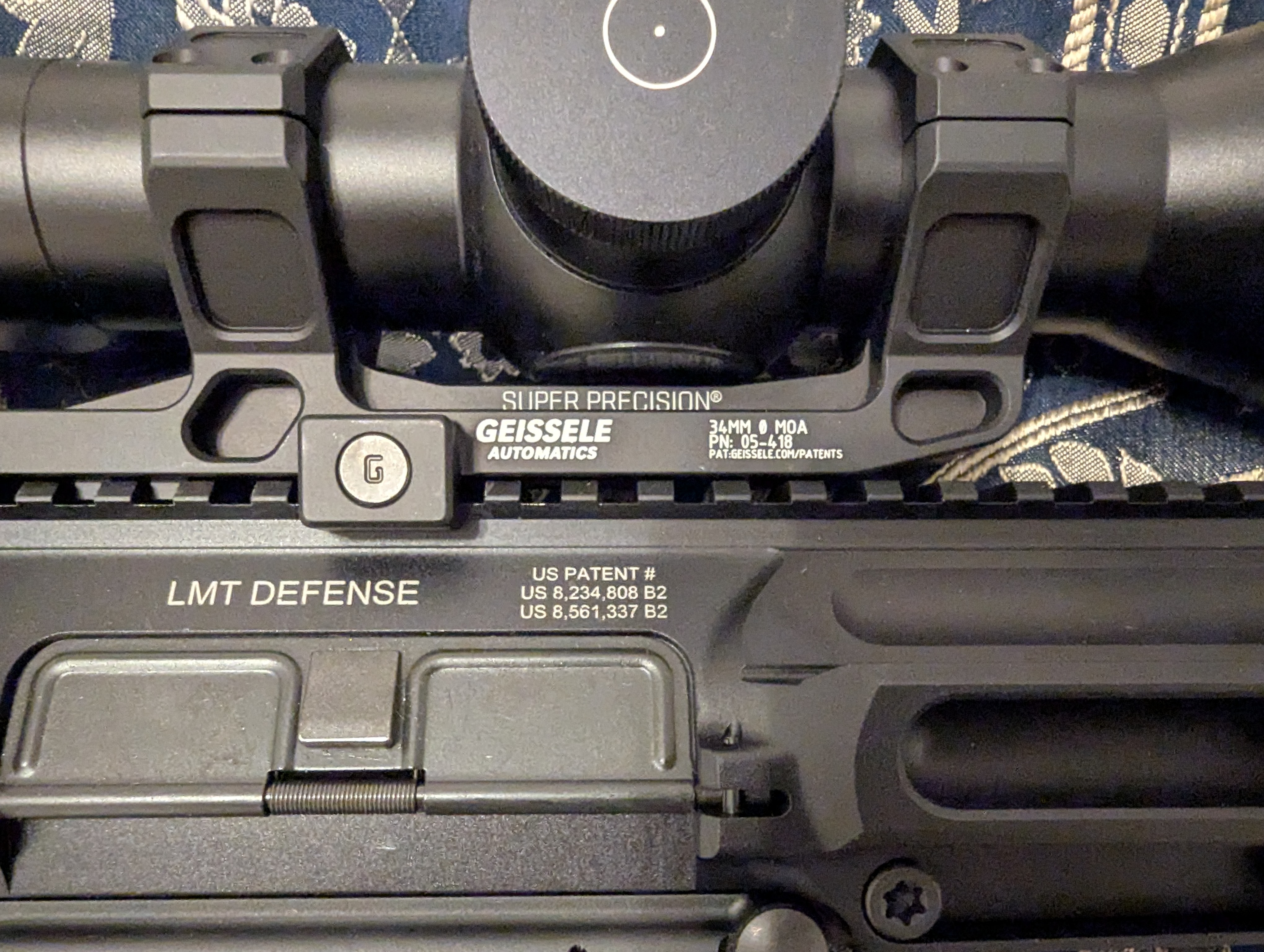

The S&B 3-20 I have fits fine in a Geissele Super Precision mount. Solid and often available on sale.

Thanks. I see they have several in 34mm tube size. Which one do you have?
It is the PN 05-418. A 34 mm, 0 MOA, hyper extended mount. It is on an LMT MWS as well, and could also use a less extended mount. This one allows use on a non-monolithic upper without bridging from the upper to the handguard.
