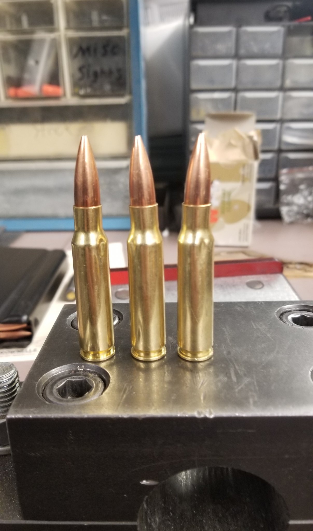

Hello everyone, I purchased an Knights SR-25 acc 16" from gunbroker about a couple months ago. Since then I've shot it at the range three separate occasions and have had horrible results.
Each range time has gotten worse as I've have ftf, bcg override the round, double feed, bend necks, etc. I'm using the factory mag, Lancer l7 mags, pmags and nothing seems to change it. I haven't used reloads as I can't even get factory to function correctly.
At this point my other ar10 is more reliable and I'm contemplating on selling it, but I'm disappointed as I've always wanted one since I left the corps. There's not enough crayons in the world to ease my pain!
Anyone have any ideas or suggestions, I've always found great advice here ?

What ammo is that?

@HornDog87 The picture in your post...what's it supposed to signify? That factory ammo looks all kinds of wrong to my naked eye. Two of the three rounds don't look like they're seated properly, they appear to be canted.

Texasfrog the rounds in the picture are from my Sr25 malfunctionimg and what it has done to those factory federal rounds. Figured I'd show a picture of what the rifle is doing ?
Dms416 that is 168 fgmm that was recommended by Kac in the book they include with the factory grouping sheet. Unfortunately I only have the one factory mag that came with the rifle and all my other ar10 rifle's mags.

The pics of the rounds are ones you chambered and ejected out?

The 'marks' on your rounds are from the round being slammed into either another round during extraction or from a bad angle being caused at the time it is being fed into the chamber/ramps.
