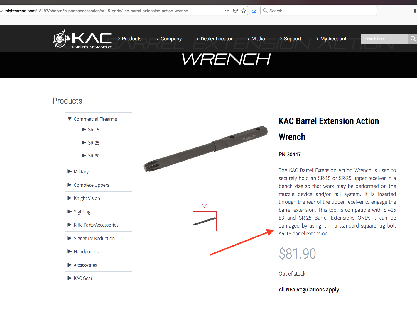

The KAC Barrel Extension Action Wrench (AKA the "Knight Stick") is a KAC-specific tool similar to the Geissele Reaction Rod. This allows solid indexing which then enables you to apply the bonkers force needed to get it off.

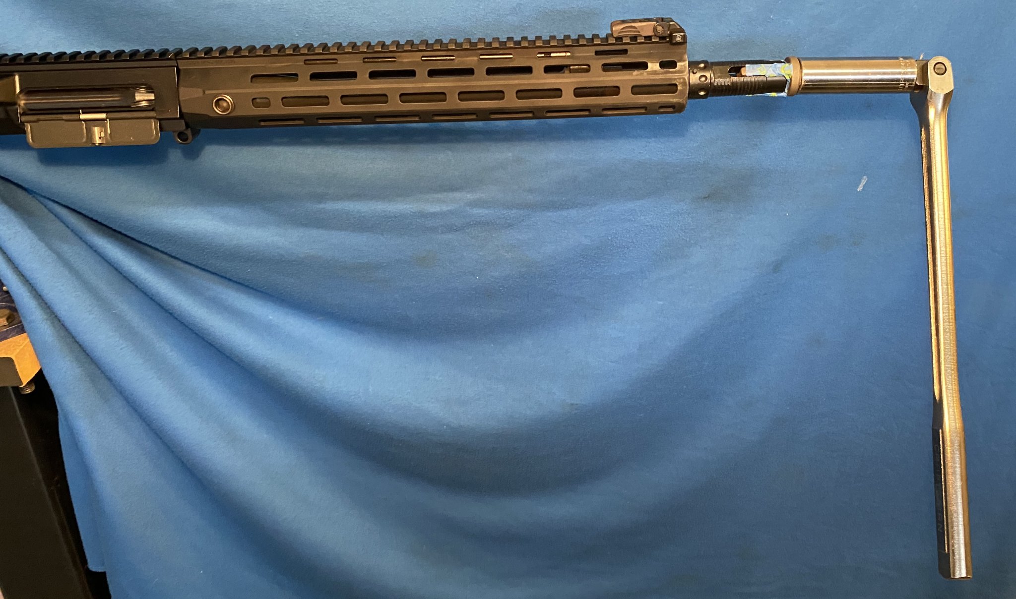

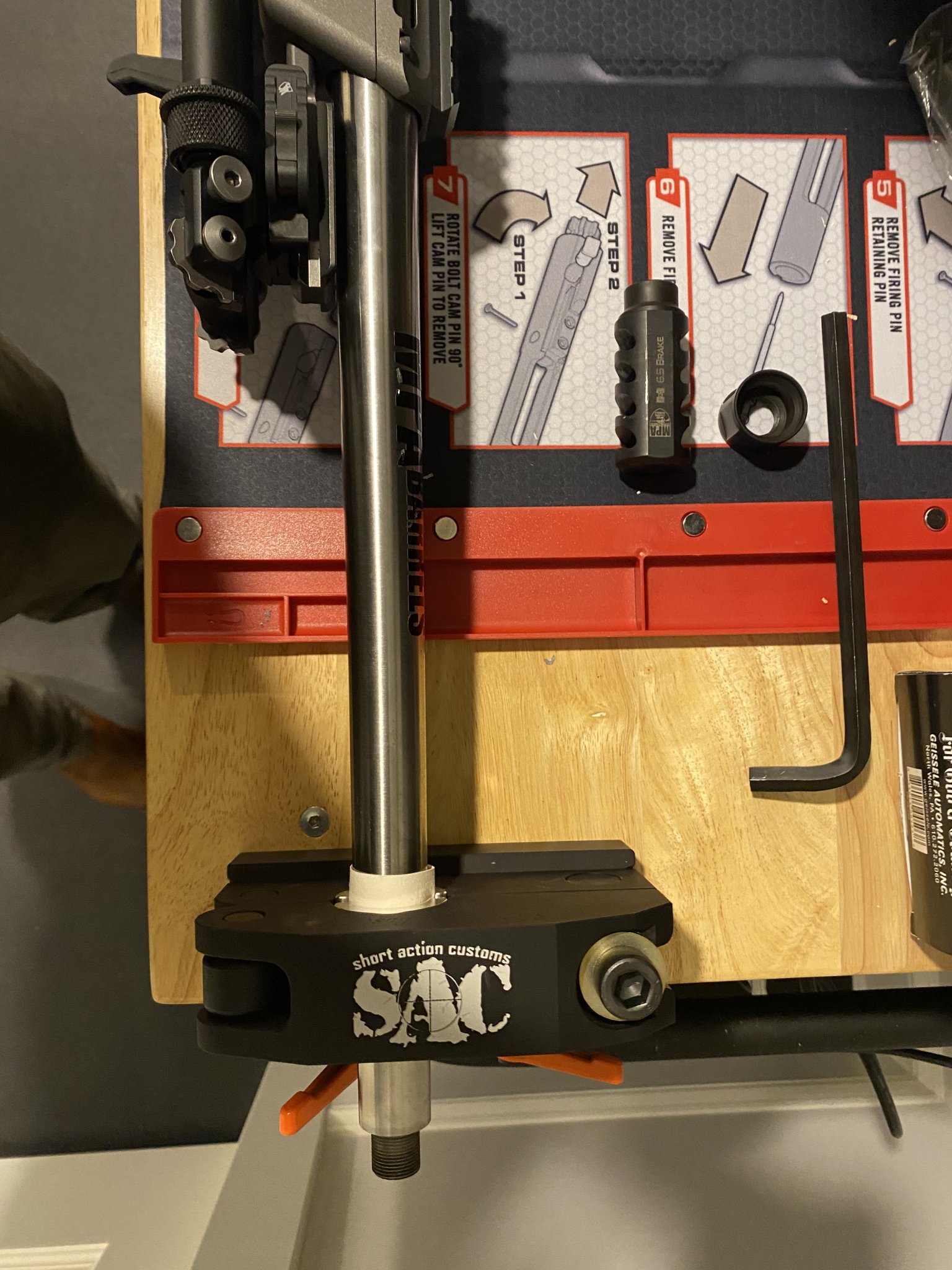

I used a Midwest industries upper receiver rod in a vise, a long ass breaker bar w/ crows foot and a year off my life due to the anxiety about torquing the heck out of such an!expensive piece of kit. But it worked.
Did you put the brake in a vice?
I went downstairs and took a picture of the equipment

The MI URR definitely worked. But since then I got a SAC barrel vise that worked even better.

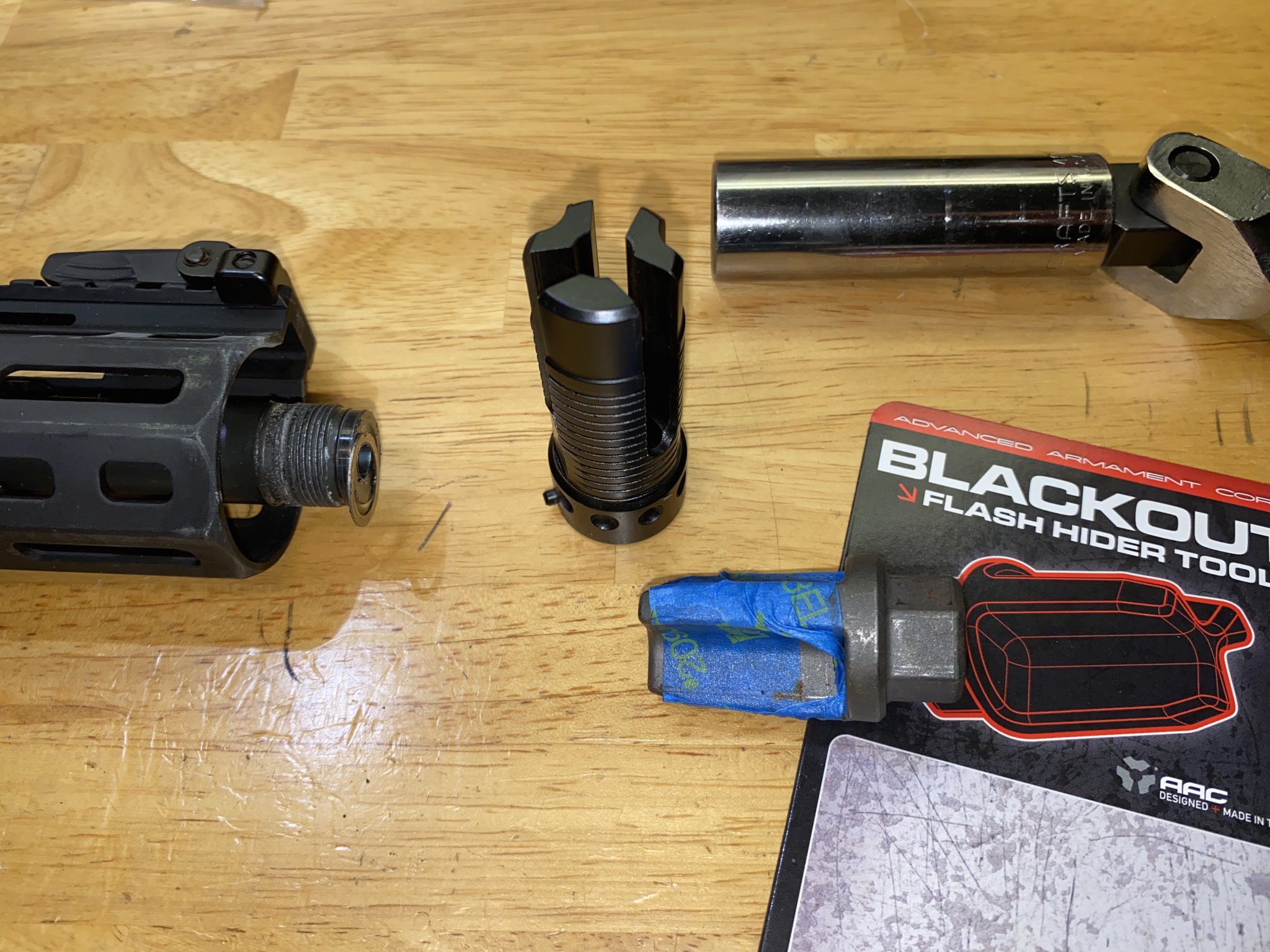

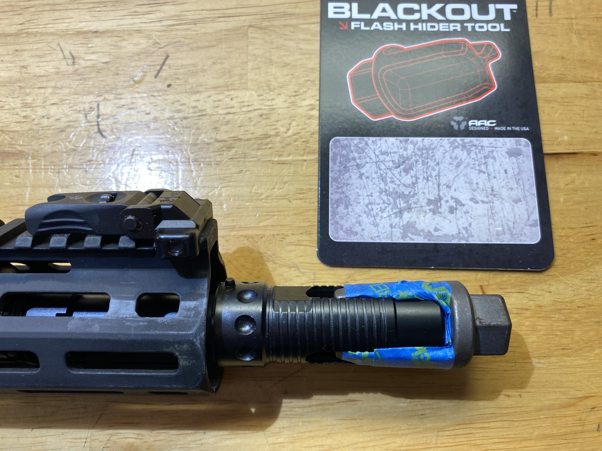

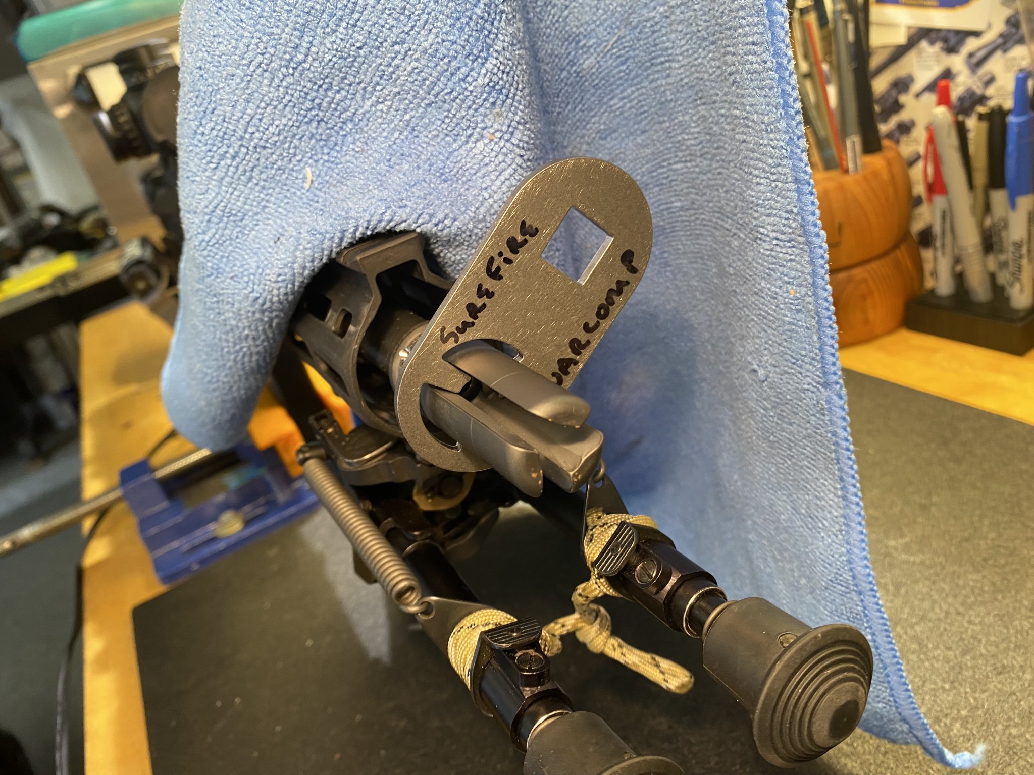

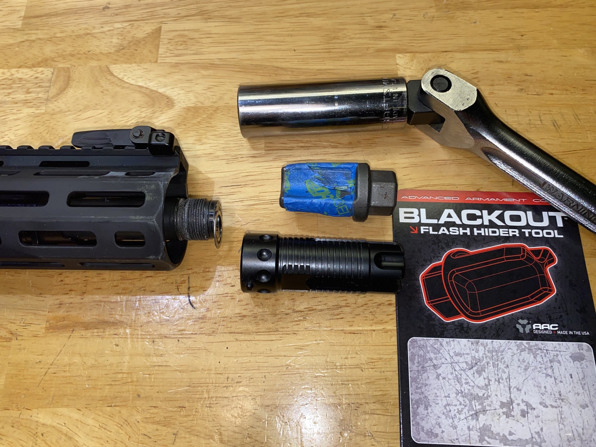

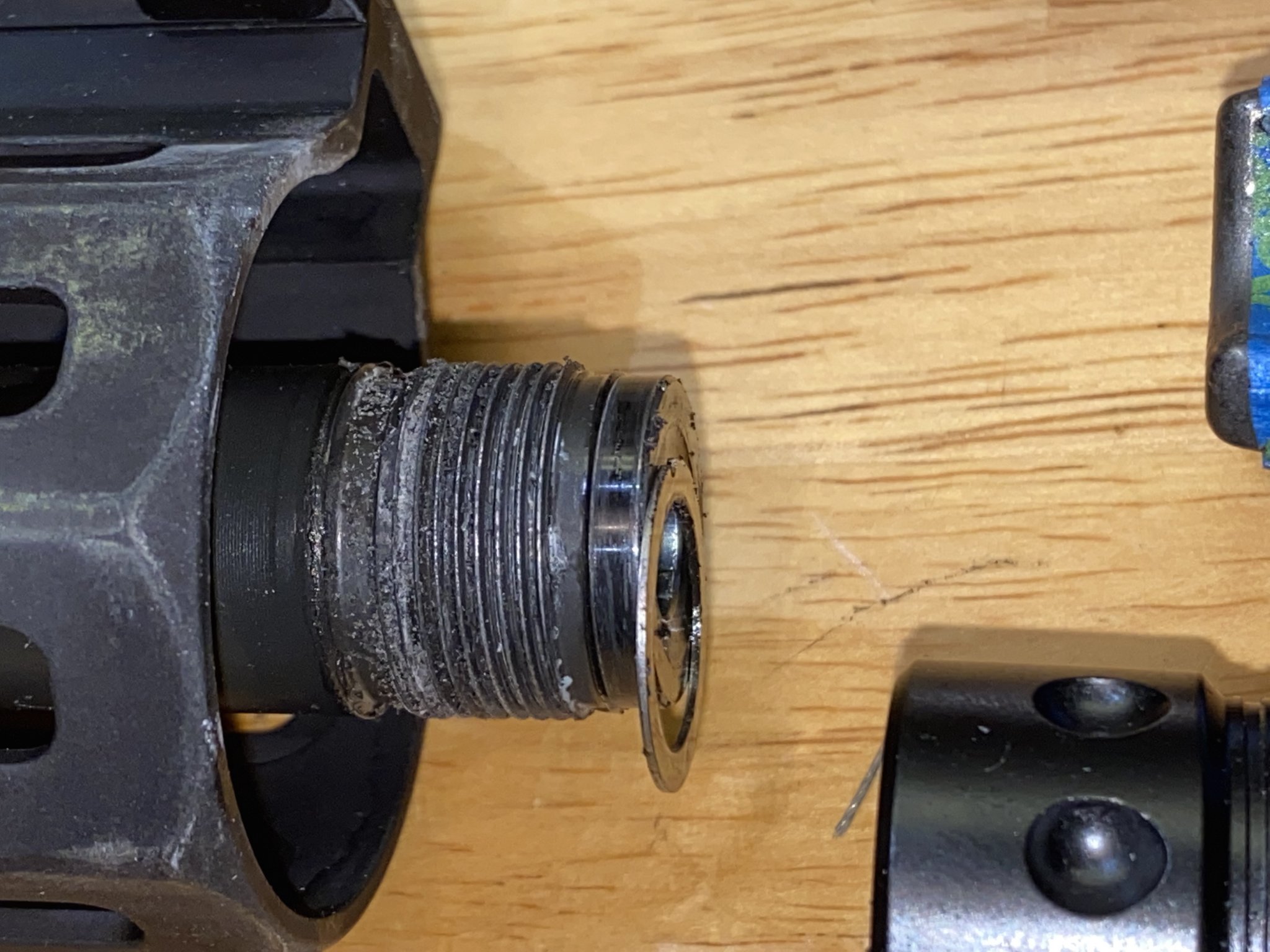

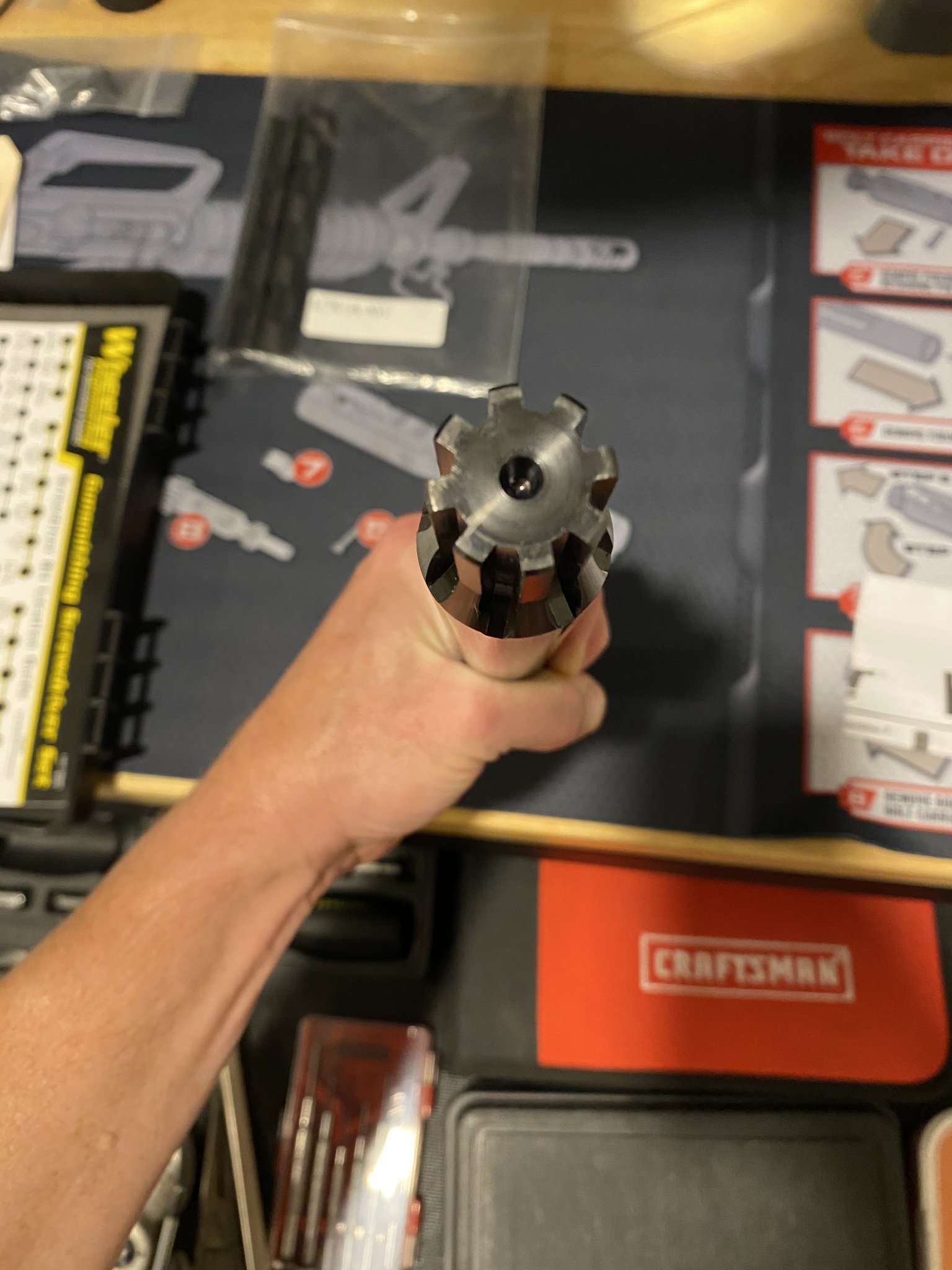

Recently removed the flash hider off of a new KAC SR-25 14.5" upper.
Used proper tools and it was easy; very little Rocksett on the threads, because a small amount is all that is necessary.
You cannot use a standard reaction rod for the SR-25, it literally is putting square lugs of the tool into radiused lugs of the
barrel extension, one or both will be ruined. Use proper tool to install the SF flash device.

IMG_9794KAC SR-25 SureFire Flash Hider Tool Geissele Alignment Rod 07.04.21 copy.jpg

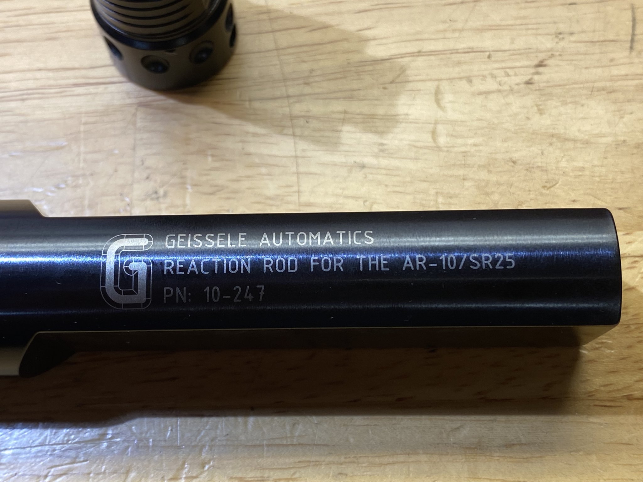

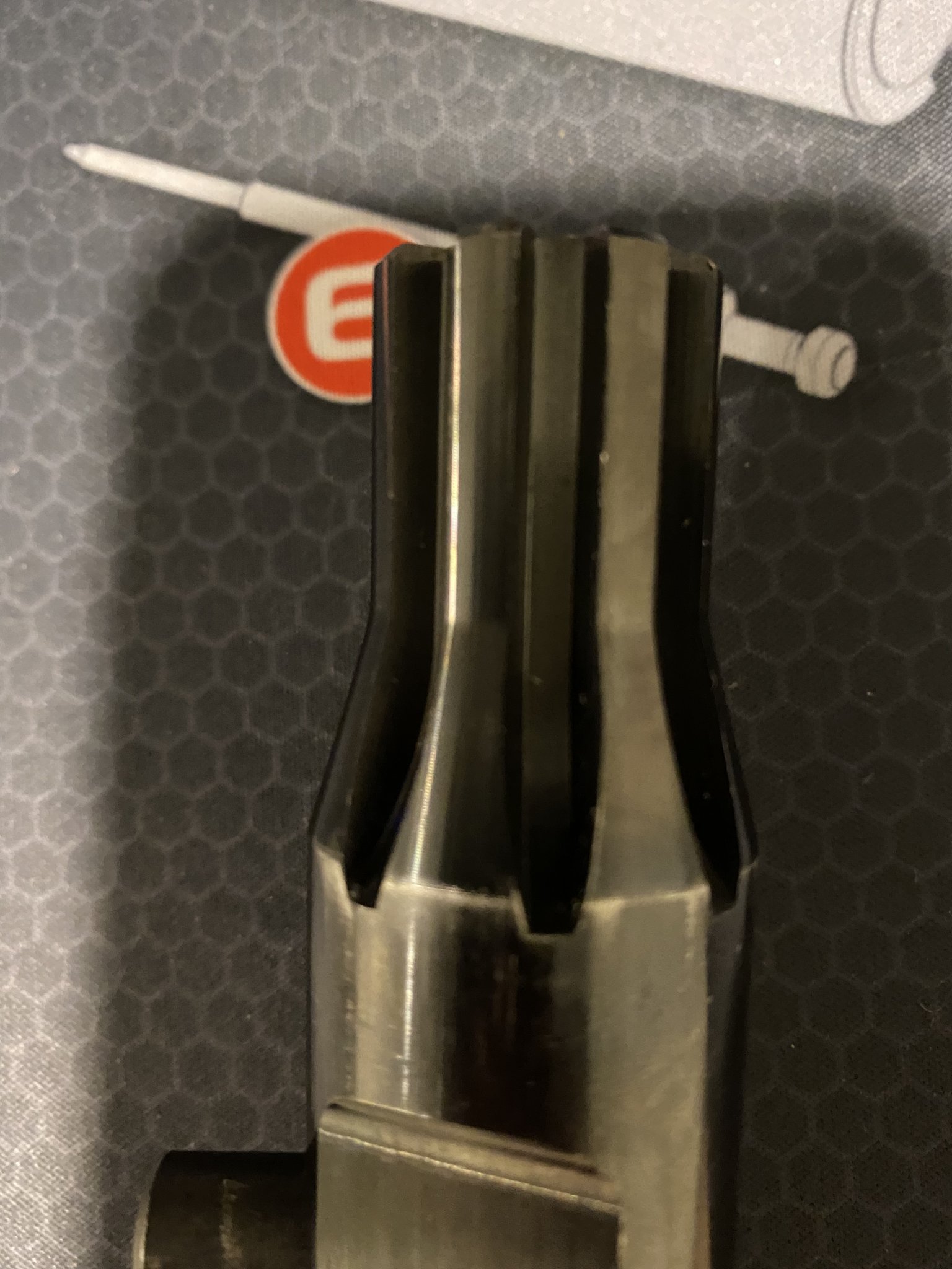

StrikeEagle seems to know what he is talking about. My rifle wasn’t ruined when I used the mi urr but maybe I was lucky
@strikeeagle1 you took a picture of a geissele AR-10/ sr25 reaction rod. That's the one that I bought. So I guess it's good to go.
barrel extension, one or both will be ruined. Use proper tool to install the SF flash device.View attachment 7680671View attachment 7680672View attachment 7680673View attachment 7680674View attachment 7680675View attachment 7680676View attachment 7680677View attachment 7680678.
So no to the Midwest industry rod? I have that tool for the aac 3 prong, will that work?

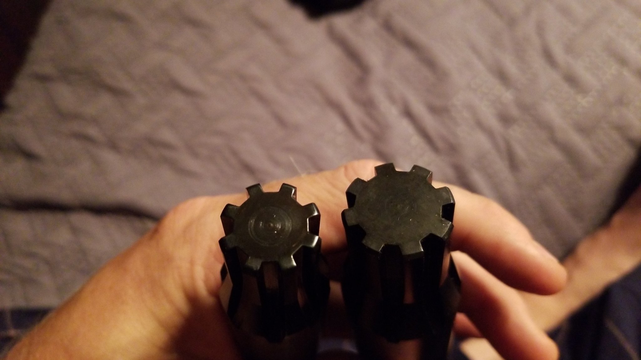

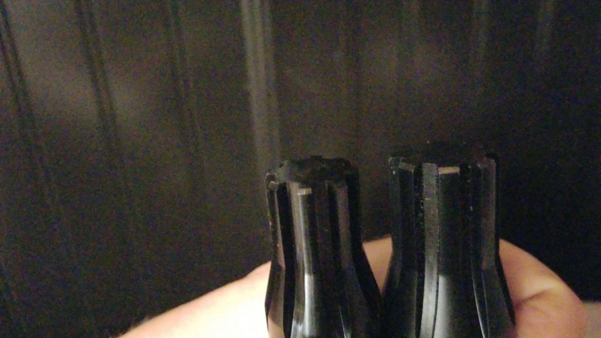

Can you post a picture of the face of the spline on the MI rod? I’d like to see how they did it

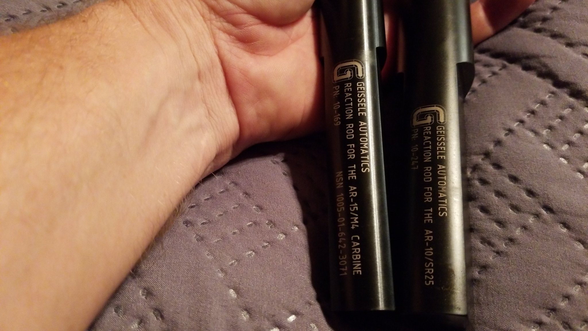

They don’t look that sharp. From what I’m understanding, it shouldn’t require too much to back it off. That looks well engineered, how’d it work for you? No issues on the teeth in the chamber? @jbonnie
Tbh I had thought it was the same thing basically as the Geissele reaction rod. I have one of those in the AR15 size but for this one got the MI URR because it cost a little less. If it was the wrong tool like strikeeagle says I guess I was lucky. I don’t have the sr25 here to check the fit against.
Did you look at the chamber to check for mars?
For comparison sake. I would surely like some more confidence that the GEISSELE AR10 rod will keep the SR25 start chamber safe.
The disclaimer in the Knightstick copy about square lugs is for the SR/AR-15, not the SR-25. Lots of misinformation here.
