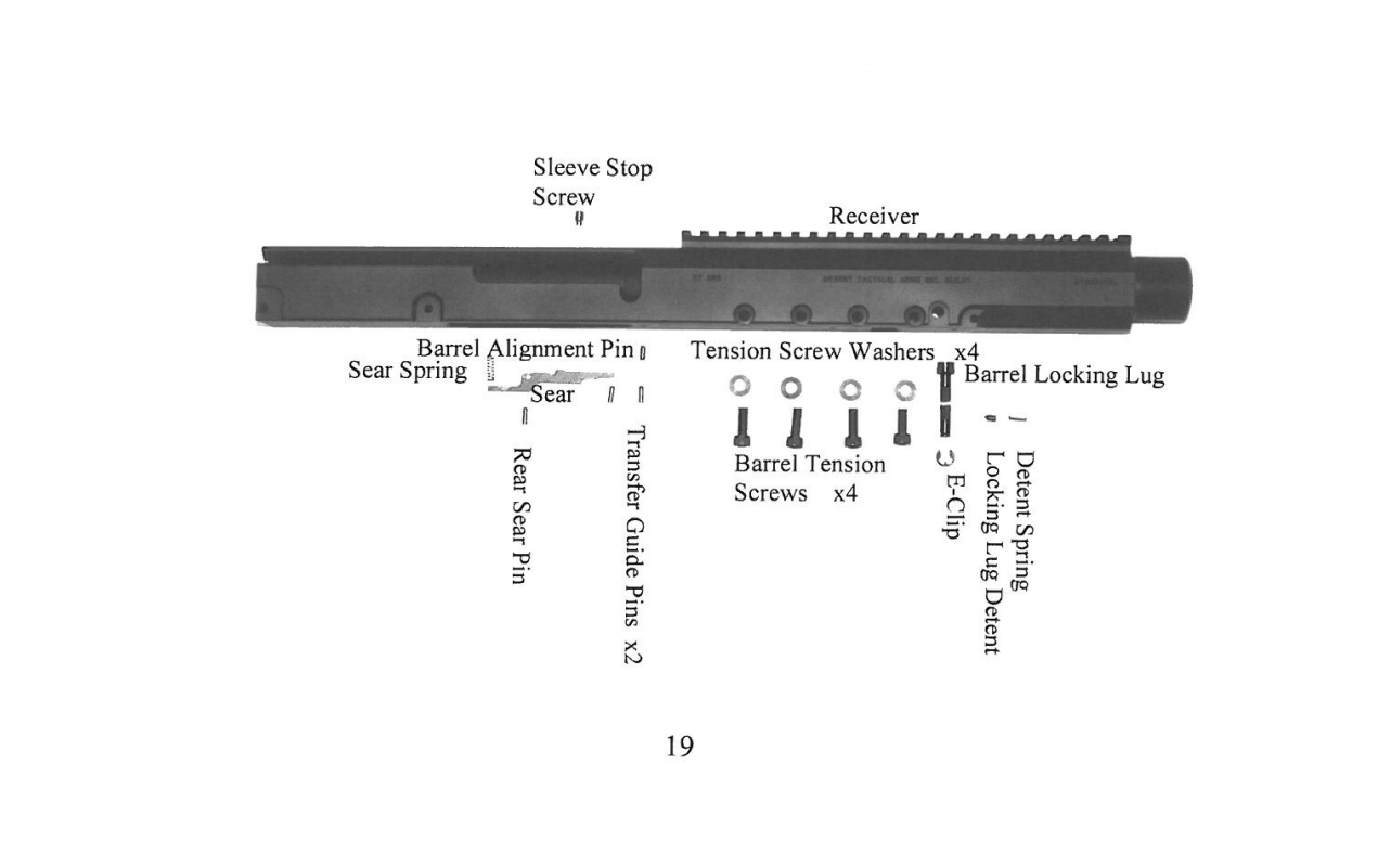

Then the bolt stopped cocking unless I slammed it forward which is not something I want to be doing. I contacted Desert Tech this week and they suggested a half hour in a ultrasonic cleaner for the bolt which Ive done but that made no difference. The only thing that may have caused the problem is loose powder in the action. During the various lock downs we had here i too some time to clean all my dies but I must have knocked out my 6.5x47 seating die just enough that the first round that wouldnt go off, when i ejected it the bullet caught, was pulled from the case and some powder was spilled. I cant help but wonder if a grain of powder got under the transfer bar. I did try to knock out the roll pins holding it in place but the seem to be in too tight, I cant knock them in from the outside and I cant access them from the inside to knock out.

Make sure you don't have an excessive amount of grease or oil on cocking cam, striker, firing pin, spring. With bolt out, press trigger to rear and press down on the sear. If you're unable to depress the sear into the sear cavity, disassemble and clear channel. If you CAN depress the sear into the sear cavity, check your headspace. Excessive shoulder setback can also cause light primer strikes.
