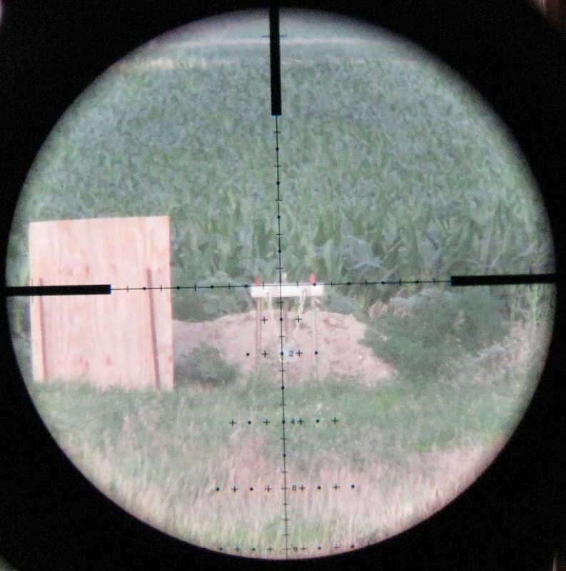

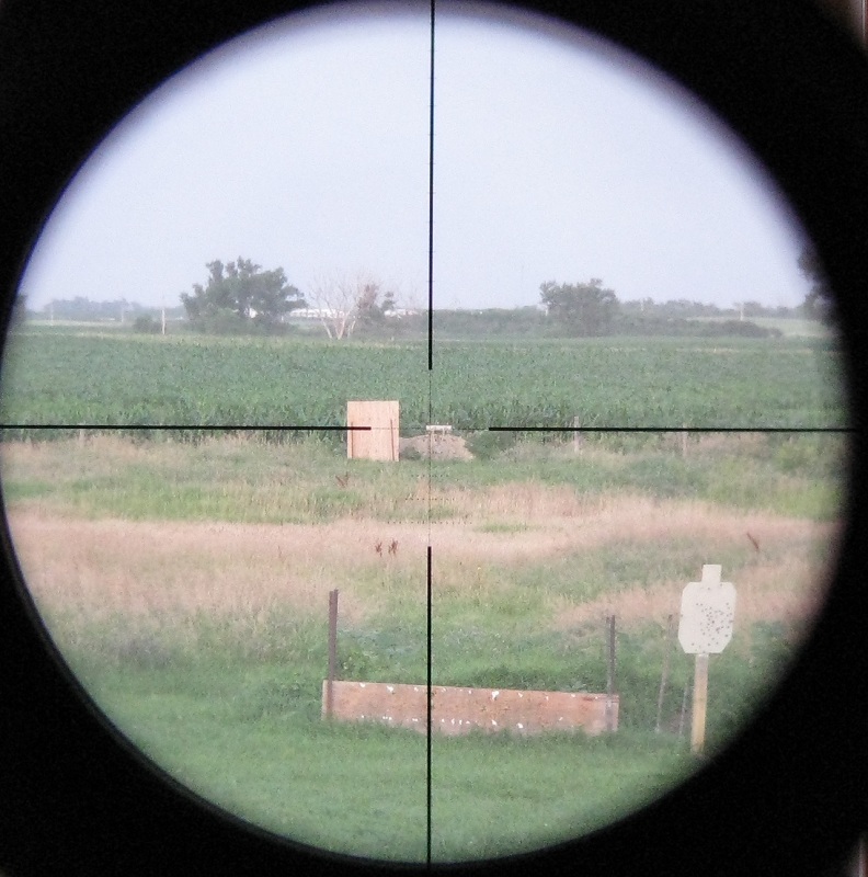

I did some shooting with the OPs scope today.
Eyebox/Eye relief
His concerns about the eyebox are valid. Above 15x it is somewhat narrow. Much more so than my 5.5-22 NXSs. My upgraded ocular Razor was on hand today. The SSs eyebox @ 20x is pretty much in the middle of an new ocular Razor and an old ocular Razor. At 15x and below its a non issue. No complaints about eye relief.
Glass.
IMO, and all the fellows shooting today, thought the SS was better that that of the Razor. We had a resolution chart on hand @ 100yrds. At 15x I was able to resolve the -2 column / line 5 with it. It had a bright, clear picture that was pleasing to the eye.
Reticle.
Awesome. Love it.
Turrets and click feel.
Decent. Not great, but not bad. Ill admit, the more I use 10mil + per rev turrets the less I like them. Ill trade all that ele in one rev for the positive click feel and space of the 5mil turrets.
Tracking/repeatability.
I did not do a tracking test, but the OP did. It passed without a problem.
Egros.
The power ring sucks. The parralax adjustment sucks, and the ill ret adjustment sucks. Not that they dont work, but the way it is set up.
Overall, I liked the scope and wouldnt mind having one. With that said, if they get the eyebox issues and egro issues squared away, Id plop my money down in a heartbeat.

How thin is thin enough.
I see guys posting the reticle is to thick on the 5-20 yet I can easliy see and shoot at single 30cal holes at 100. Anything 1/4 moa can be seen...

I was shooting steel yesterday from 500-1250 yds. I could just barely quarter a painted 3" orange dot at 500 yds. By 750 we had to paint 6" dots to see them clearly behind the reticle. This is actually one of my biggest issues with the trend in FFP scopes right now. For what I'm using this rifle for, I'll probably end up with a NF NPR1.

Personally, I'd like to be able to easily quarter a clay pigeon at 1000 yds.

That's SFP reticle territory. A FFP reticle that thin would be invisible at lower magnifications.

Yes and no. You're not going to use an FFP reticle at 5x to shoot an egg at 1000 yards. You're only concerned with center mass fire.
The PR GenII XR reticle is about perfect for my tastes:
But I'm not going to spend $3K for a FFP scope with a reticle I like. Not sure why someone hasn't added a thin crosshair inside the 1/2 mil mark to one of these fat reticles to make everybody happy.
I'll use SFP on this rifle, until someone decides that fat reticles in FFP are not necessary.
