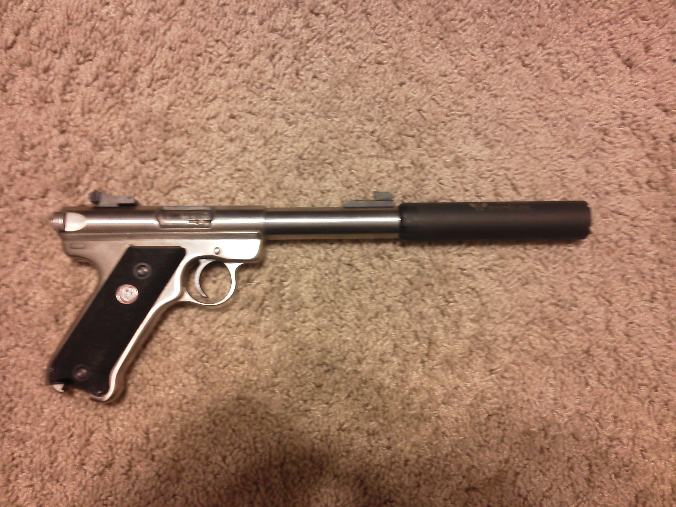

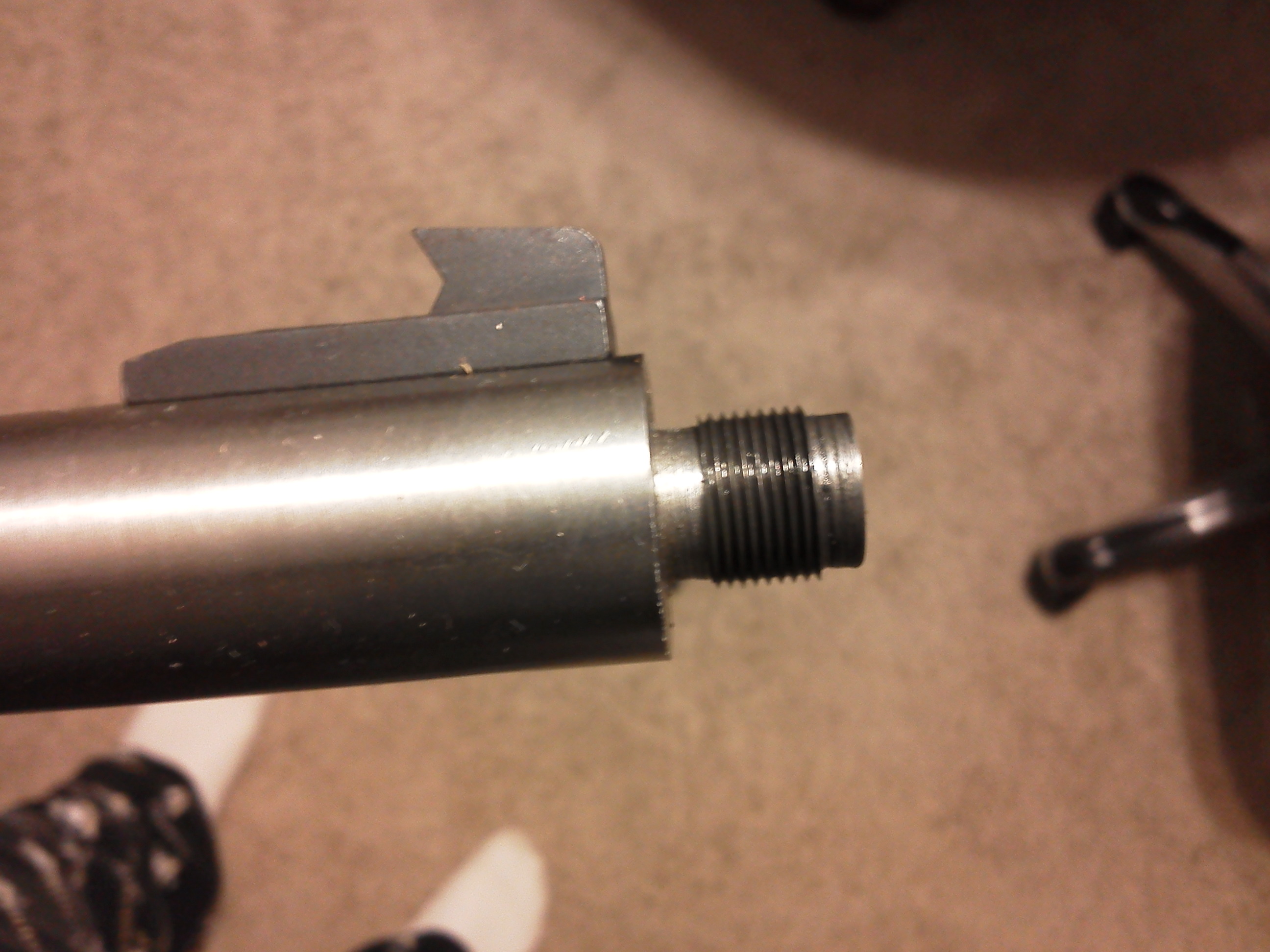

i had my stock barrel threaded to the sparrows thread specs and the front sight moved back.
EDIT:
it's a MKII as well. i have a MKIII, and it sucks compared to my 2.

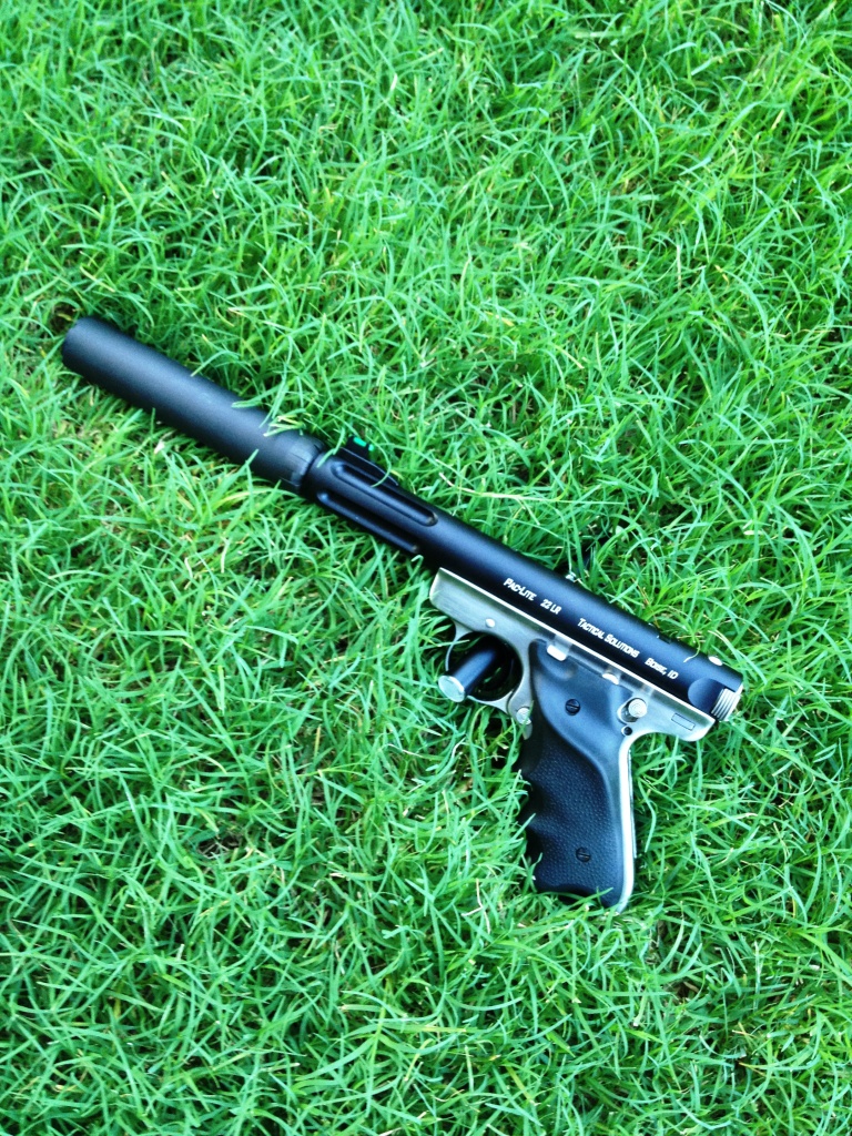

Seeing as how you have a Ruger you like, I would just change out the barrel with a Tac Sol barrel. Its quick and easy and give you a second barrel. I have a Mark III Hunter and I do switch the barrels back and forth as needed. I like the heavy feel but I enjoy shooting suppressed. The Sparrow is a sweet set up. You will love it.

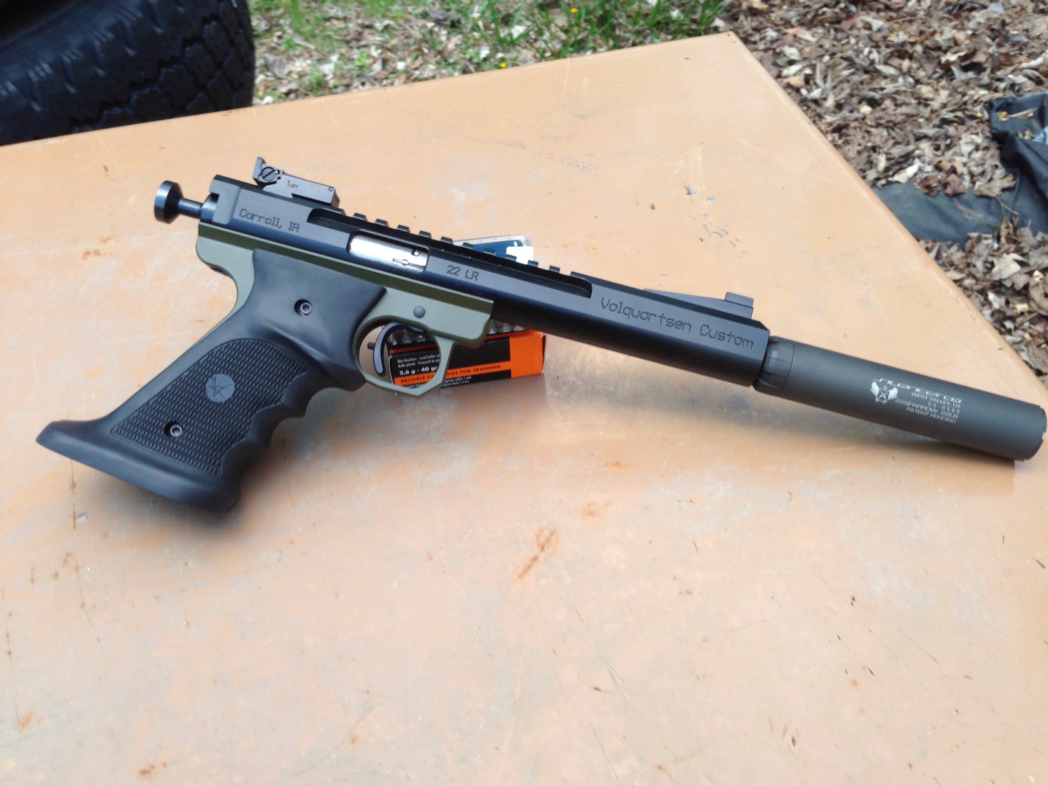

My lite talo edition is probably the gun my friends most enjoy shooting. Added a bam bushing, volquartsen accurizing kit, fiber optic front sight, a set of Hogue wrap around grips and of course the muzzle device :D
The wrap around grips really help with the weight of the can hanging off the end. So much fun to shoot and great for kids to learn how to shoot pistol on since its cheap, accurate and quiet. Ive got a warlock coming that's half the weight of the spectre and sparrow just for this pistol to help with the nose heaviness.
