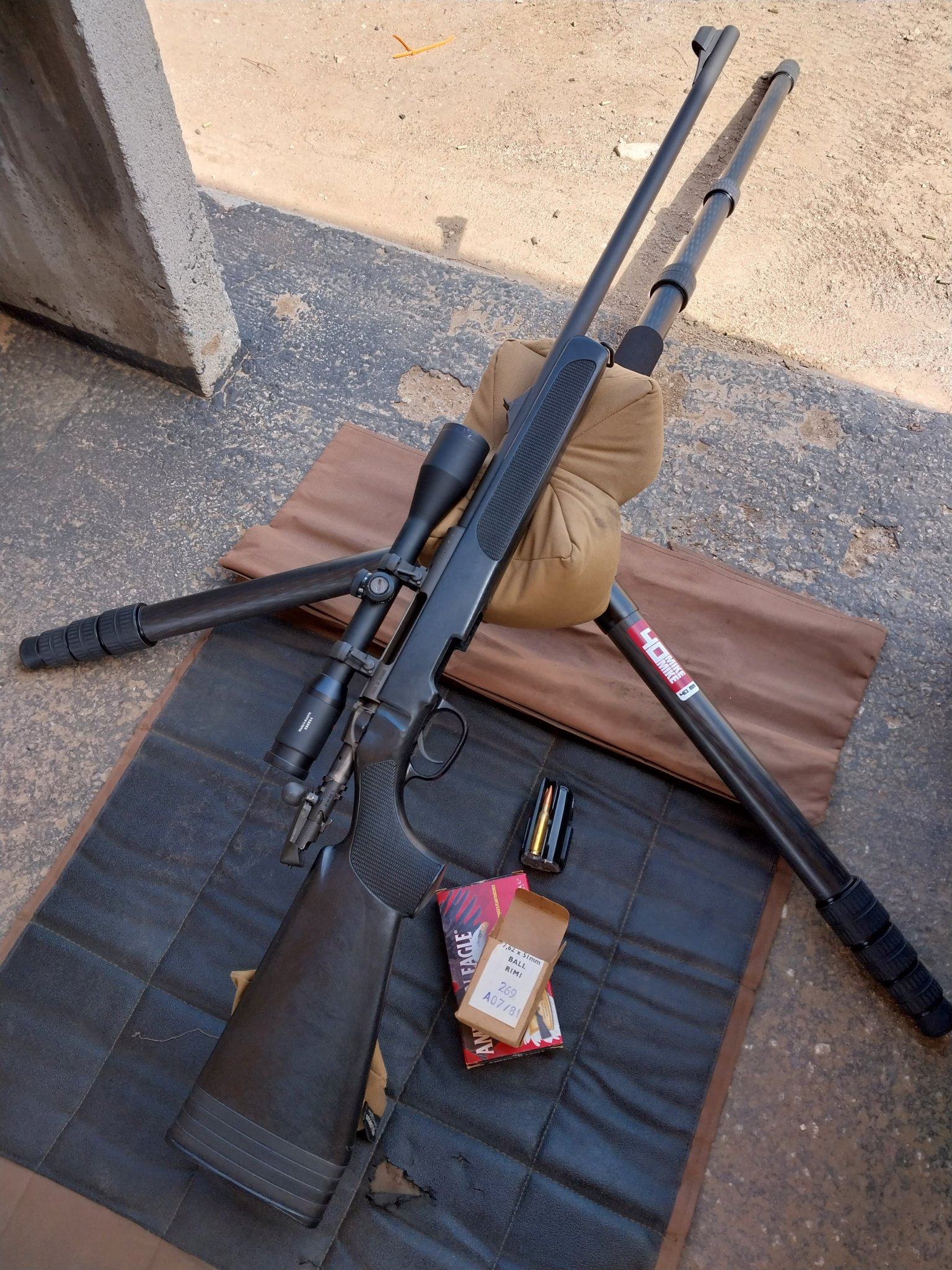

I have a Steyr SSG69 P1 with a black stock. Fantastic rifle, had it out to the range today and was slaying steel out to 600yd (max distance at my local range).
The stock has no provision for mounting a bipod. Many SSGs I've seen have an Anschutz rail in the forearm, but mine doesn't. I'm hesitant to drill into the stock to mount a swivel stud or pic rail as it's my understanding that the material is more fragile than modern fiberglass. I was thinking that I may be able to cannibalize the Anschutz rail from my TRG forend, and have the SSG stock inlet for that, but again I am hesitant due to the material of the stock.
Any thoughts would be much appreciated.

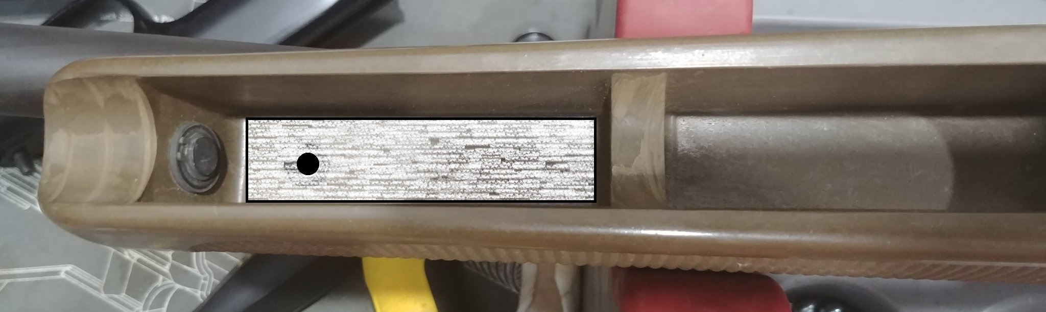

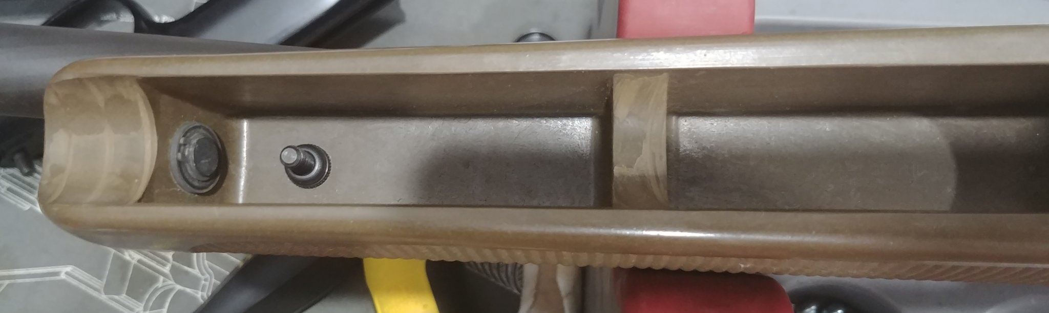

I think prudence is the best course of action. That said, there is one option I'll throw out in case you really want a bipod stud in that stock - use a largish steel mounting plate with a threaded hole. This picture shows a custom bipod install in a standard SSG69 stock - but to me this set-up is asking for trouble. Too much pressure on the bipod and that stud might crack the stock given all the forces are localized to the nut's small surface area at the hole....
....what I would have done instead is make a 3/8" thick steel plate that fits into that ENTIRE front cavity in the stock. From there I would drill and thread a hole for the bipod stud (making sure it was long enough), and for added measure, I would probably epoxy the steel plate to the stock once the hole(s) are drilled. Theoretically, this set-up will distribute the forces of the bipod across a much larger surface area - and hopefully reduce the chances of cracking the stock from forces generated from the bipod. Not a prefect design and obviously two studs/bolts spread an inch or so apart would make it stronger. (Obviously it is critical that the tip of the protruding bipod stud doesn't impact the bottom of the barrel, so some grinding might be required.)
I mention this method, as the US military used it on some M14 rifles, where a strong steel mounting plate was threaded for three holes, two for the front sling swivel and one for the bipod stud itself. While this part is less critical with strong McMillan Fiberglass stocks, its necessary on wooden stocks - as otherwise they can crack at the mounting hole and ruin the stock if the bipod exerts too much pressure from weight and rough handling. My 2cts.

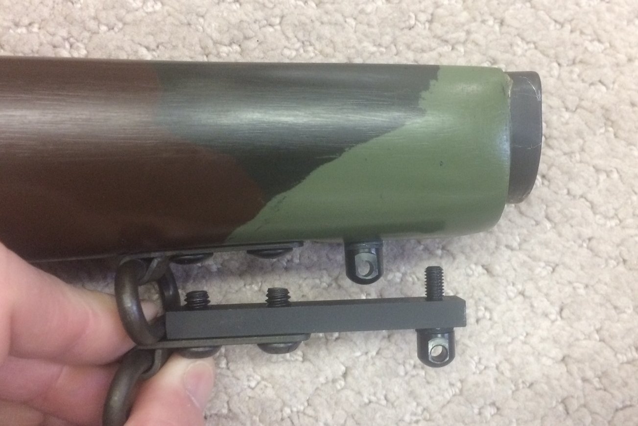

Have you considered mounting a Parker-Hale spigot where the front stud is located? I have an Anschutz rail and use a handstop/spigot with an original Parker-Hale on my SSG69. It is definitely a hefty and dated setup, but it works.
