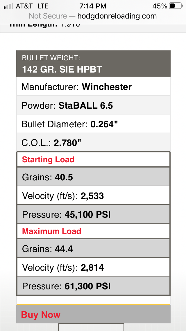

What's the verdict on Sta-Ball? The Hodgdon reloading center has that stuff as the shit across a few different calibers. It's the clear velocity winner for 6.5 CM compared to H4350, if only by a little. Over 2800 fps with 140/142s (like 100 fps above H4350), and almost as fast as SuperFormance and Hybrid100V for the 147s. What really surprised me, though, is the data for .30-06 - namely, pushing the 208 ELD-M @ 2660 fps w/ 54.2 grains. Hodgdon also lists it as faster than Enduron 4955 and SuperFormance with 180s (and H4350).
Hodgdon says the stuff is "tits" (as the kids say). If it runs consistent and clean it's like I could replace my H4350 and Superformance with Sta-Ball and not look back.

I have defaulted to just texting the hodgdon website to anyone that asks me for data. People are too damn cheap to buy a book or to lazy to search.
I had no issue finding data for the 147's, but I found my best node below book max and never found pressure signs as far as I pushed above it. It did seem to just go dead as it got much above book max.
Super accurate where I'm at, so I saw no reason to keep pushing hotter.
