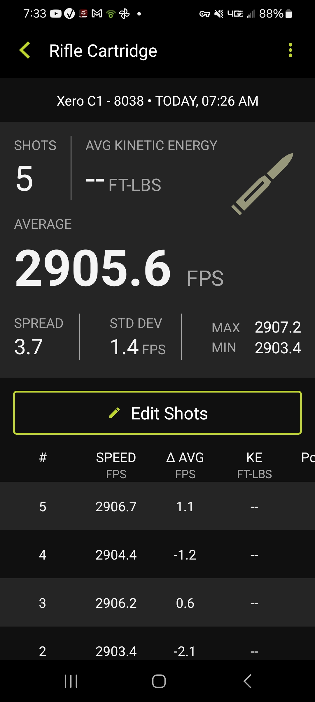

And that was the load you posted the chrono for?
Yes. That was the lowest sd it's ever given me. I shot two groups after that and they were 5 and 6 sd. As long as I get single digits I'm happy.
