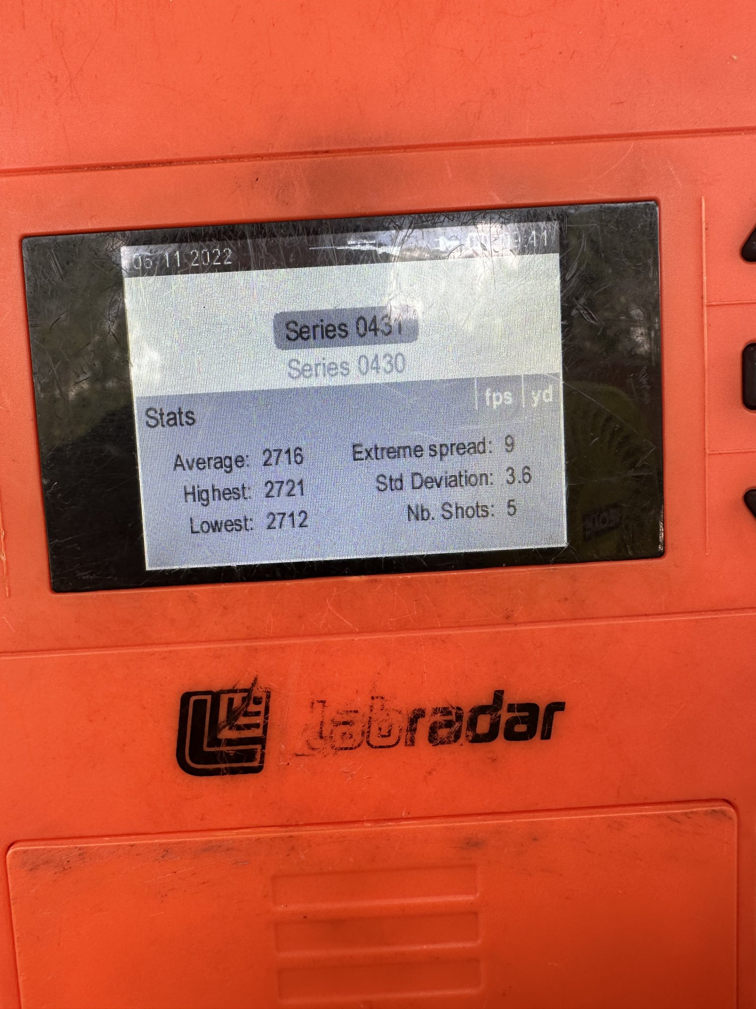

I also powder dropped a bunch loading on my Dillon 750XL and was quite happy. The first 5 over the Lab Radar
2716 9/3.1

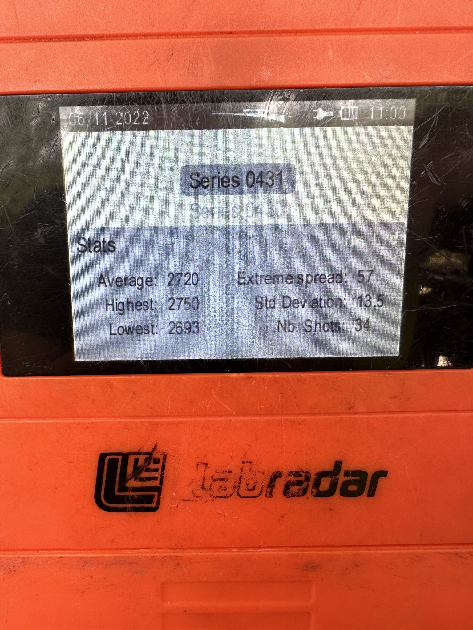

34 shots across the lab radar wasn’t quite as good with
2720 57/13.5
