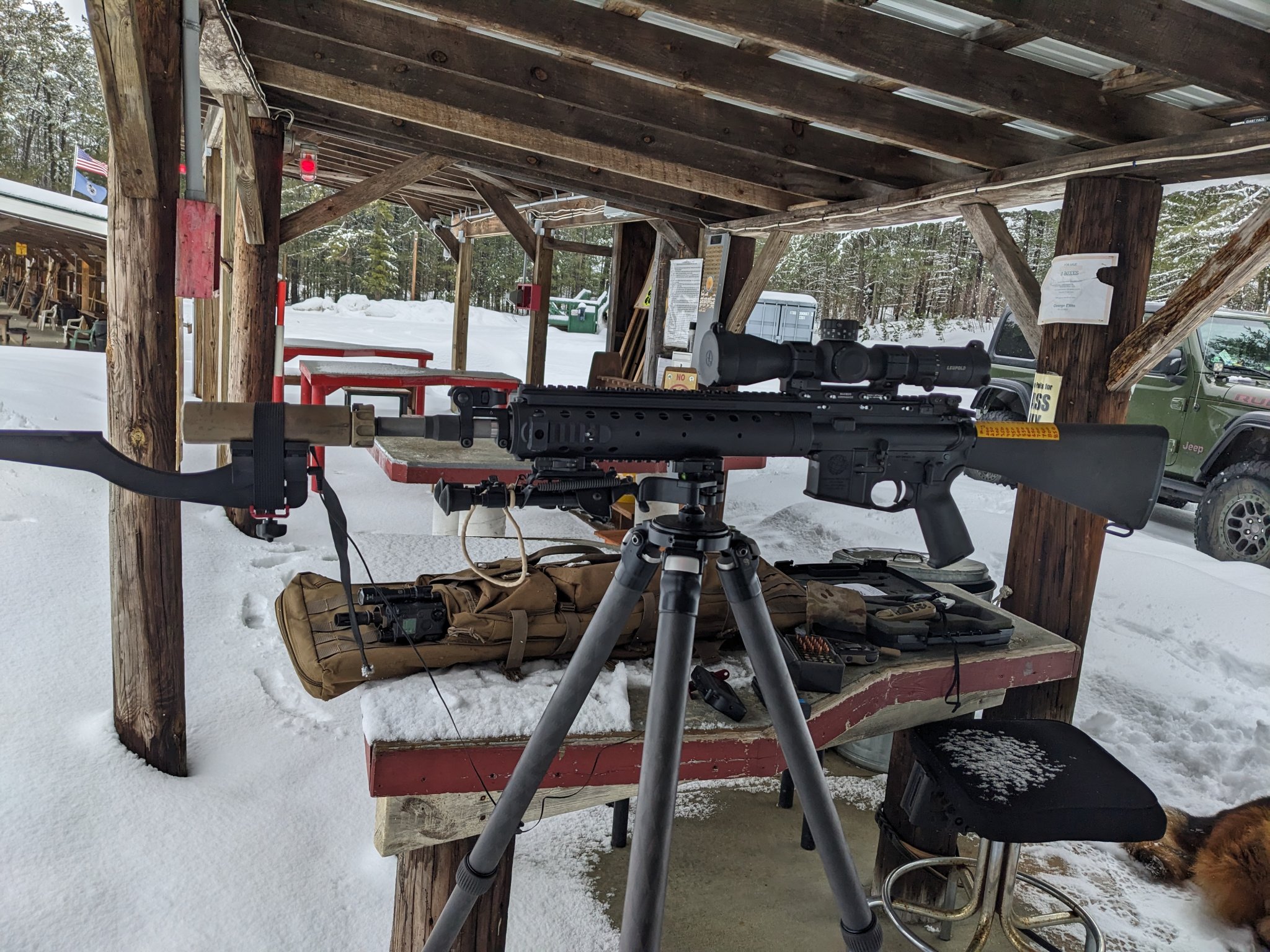

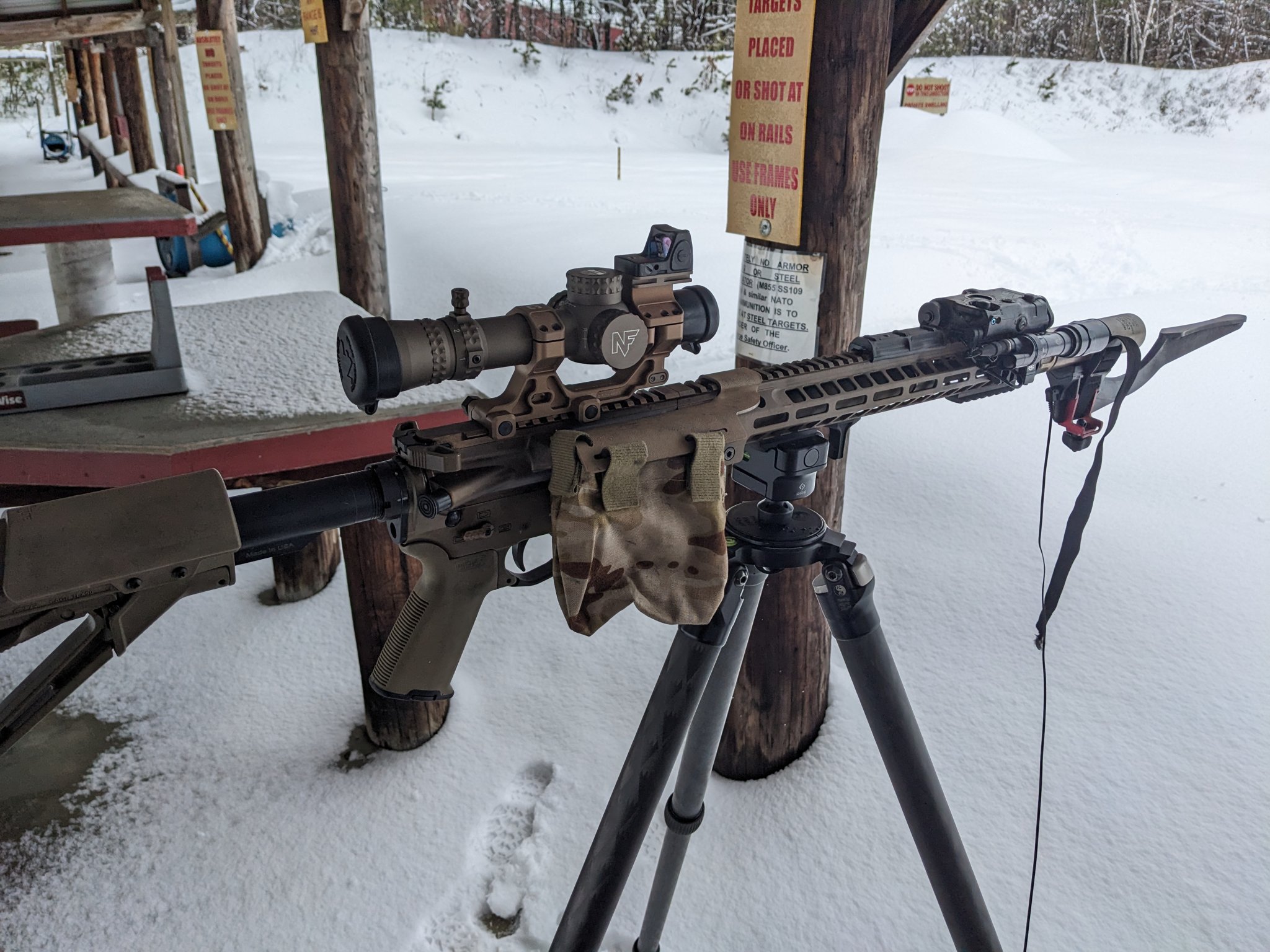

    The two guns being used for the test have the following barrels and recoil systems:
    1. PRI Douglas 16" Mk12 Mod H, mid-length gas system, Geiselle 42 carbine buffer spring, and H3 buffer.
    2. CLE Bartlein 18" Mk12 Mod O, rifle-length gas system, Sprinco green rifle spring, and Noveske A2 buffer.
    Both guns are shot and chronographed suppressed with a Surefire RC2, with data captured on Magneto Speed V2.

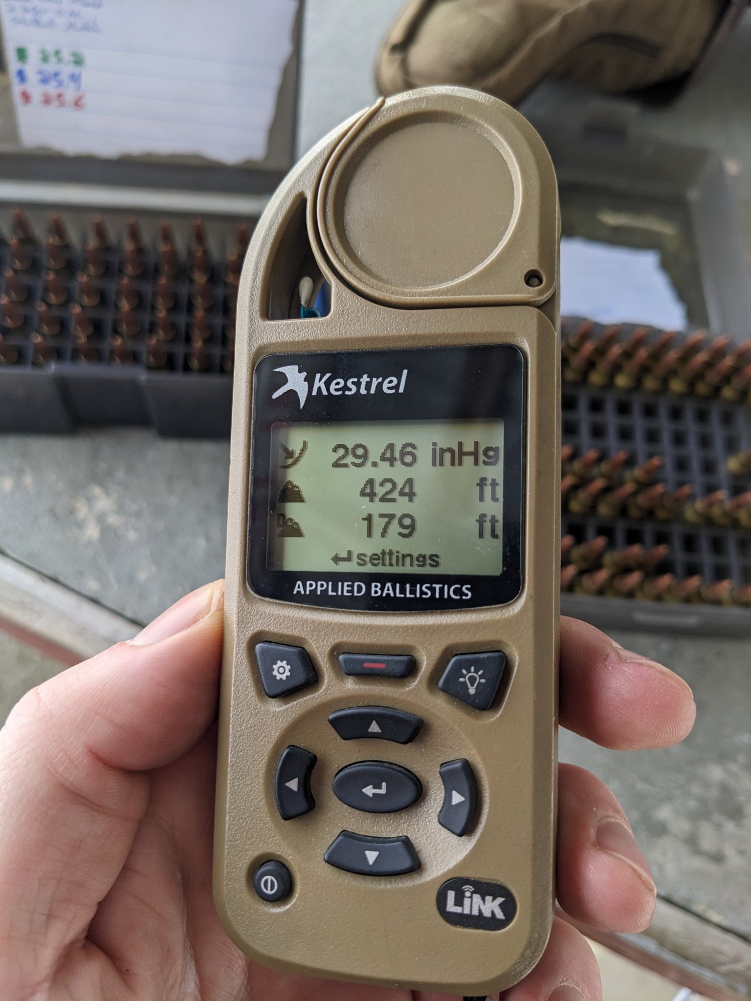

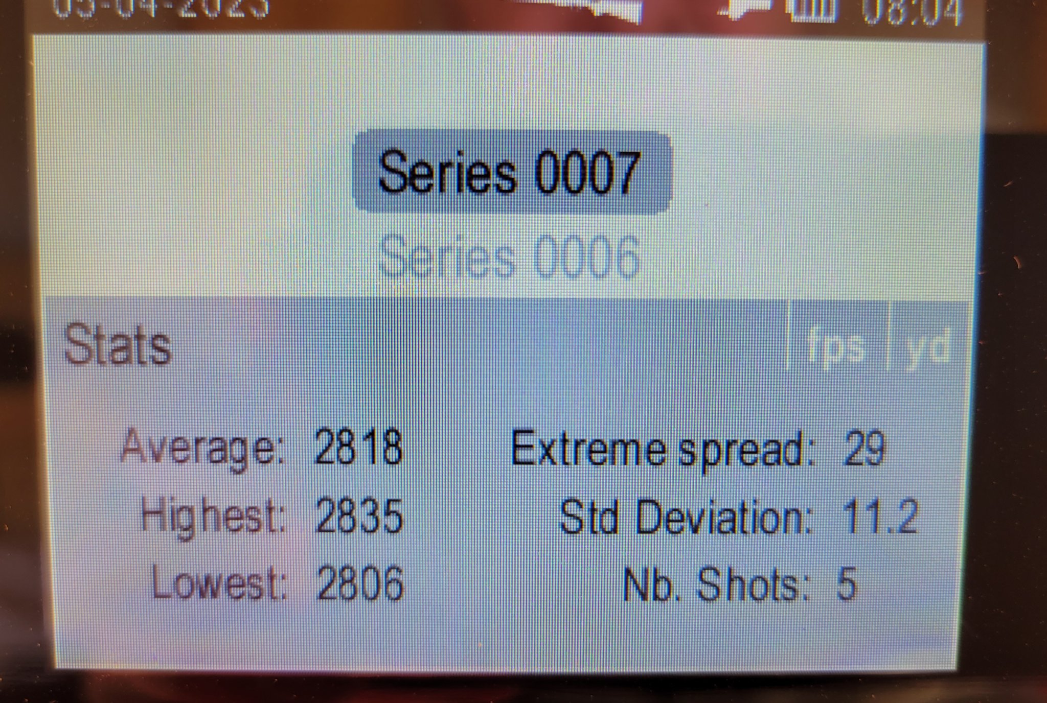

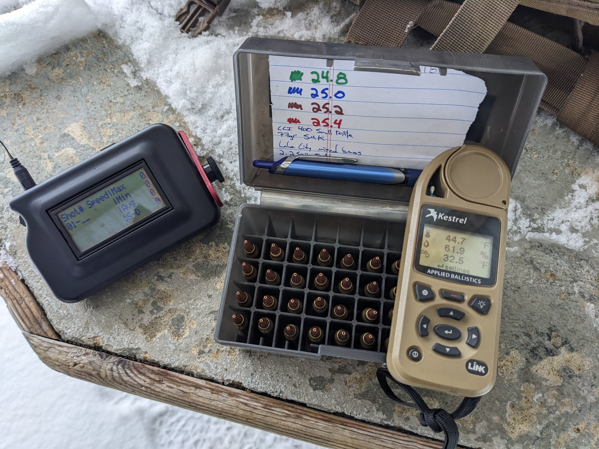

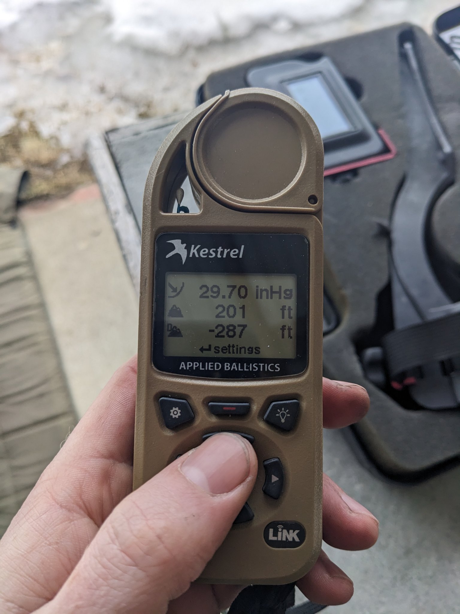

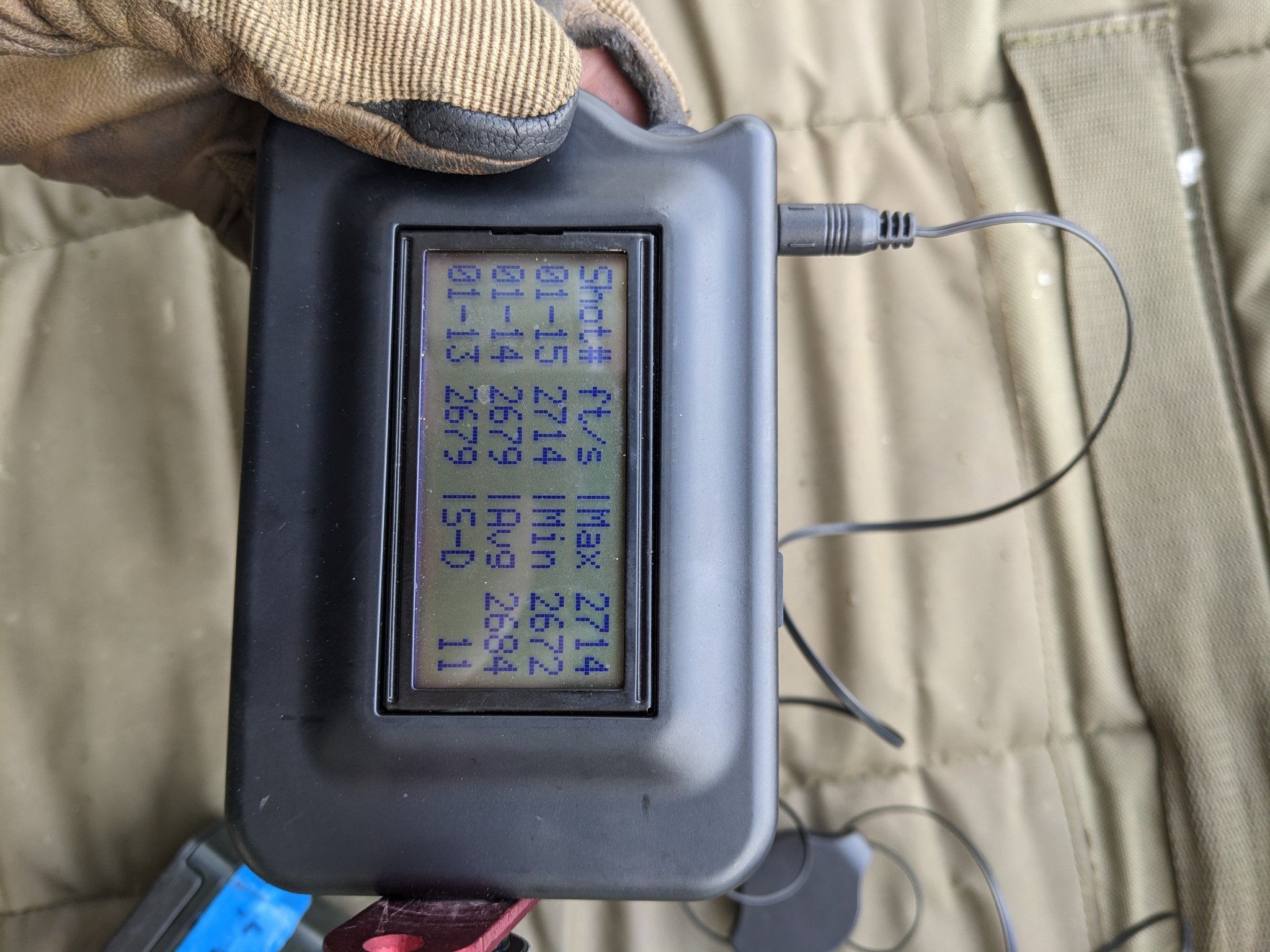

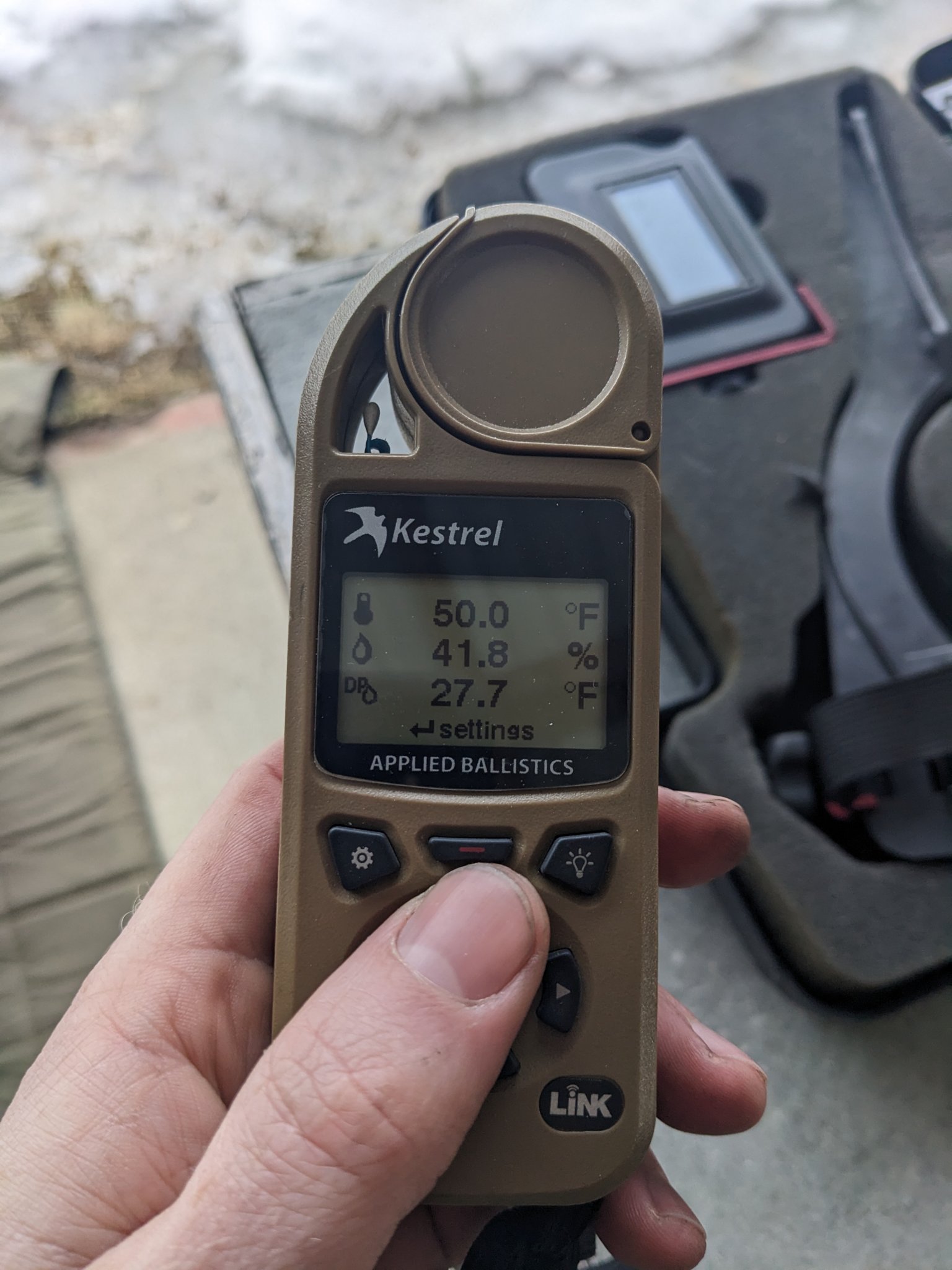

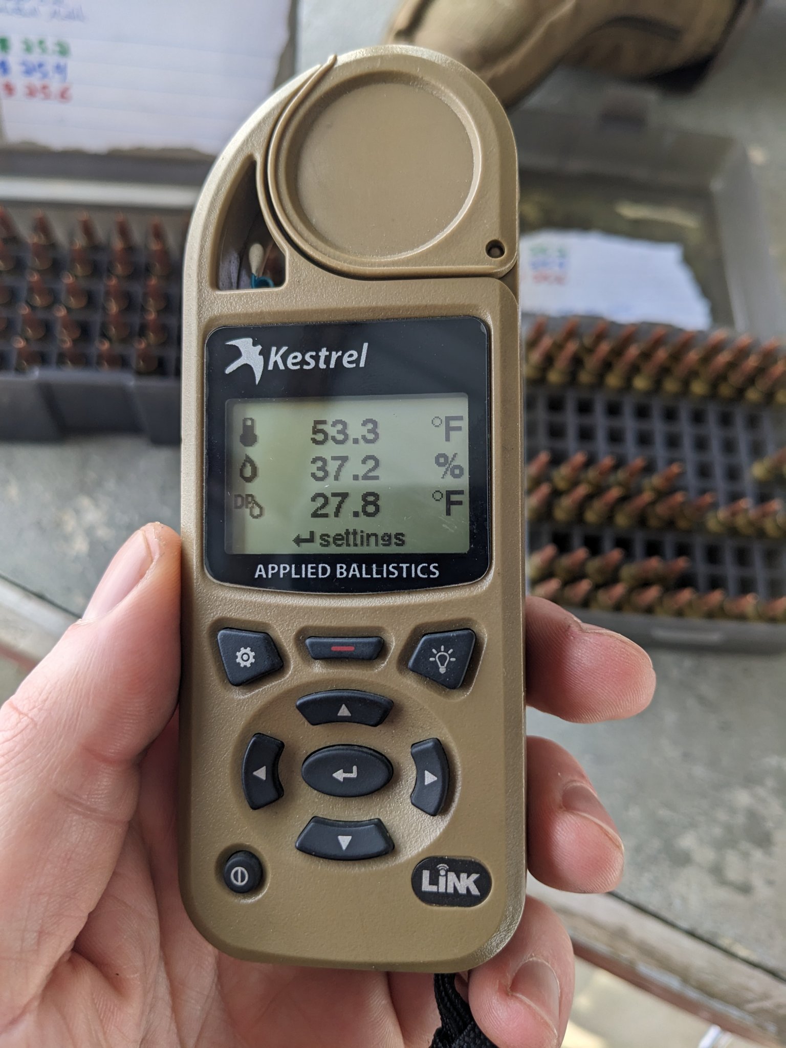

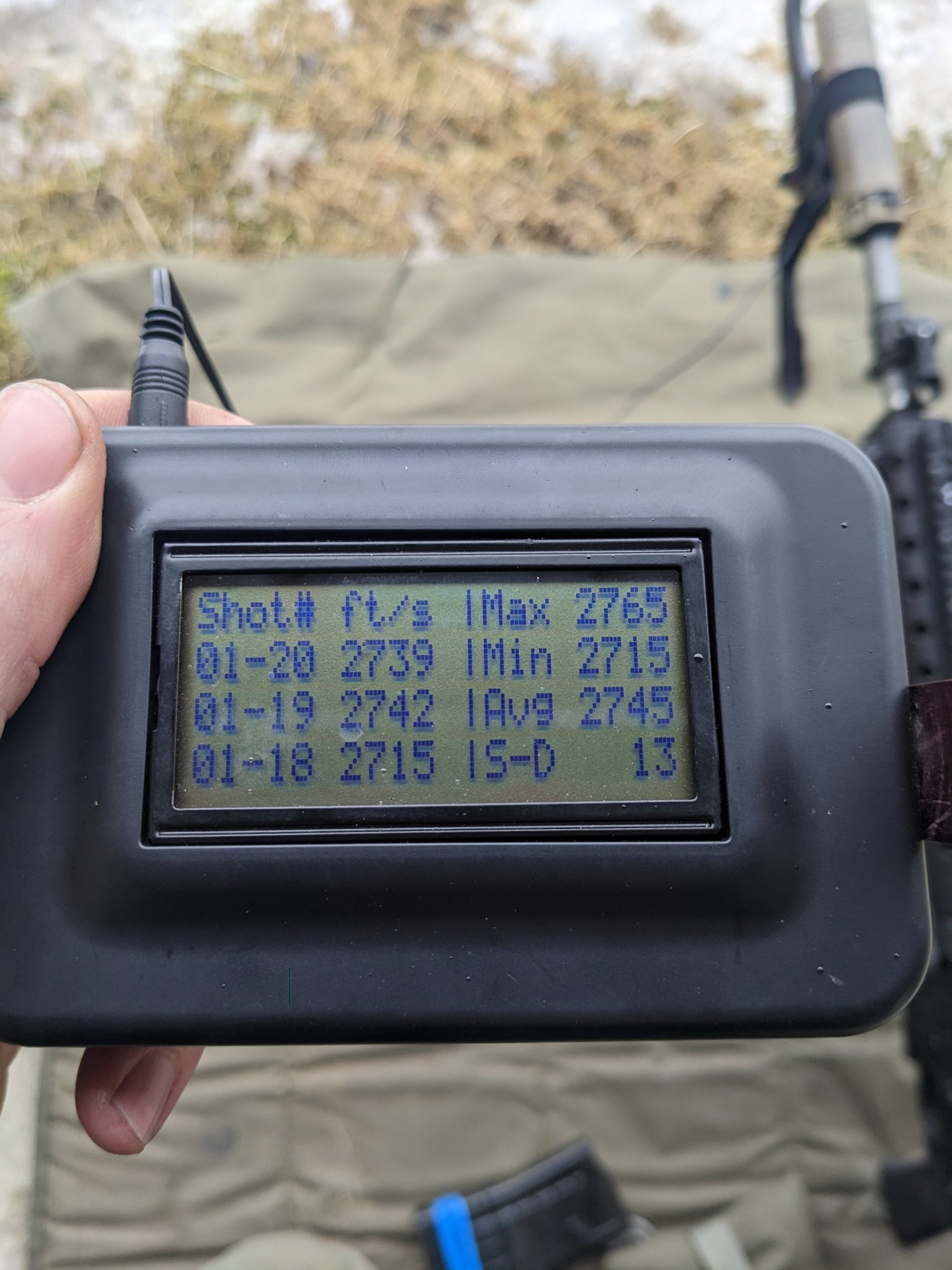

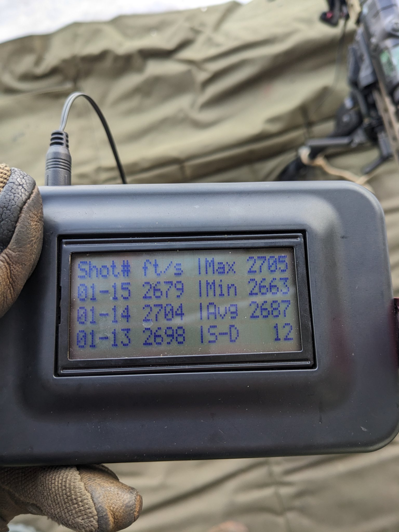

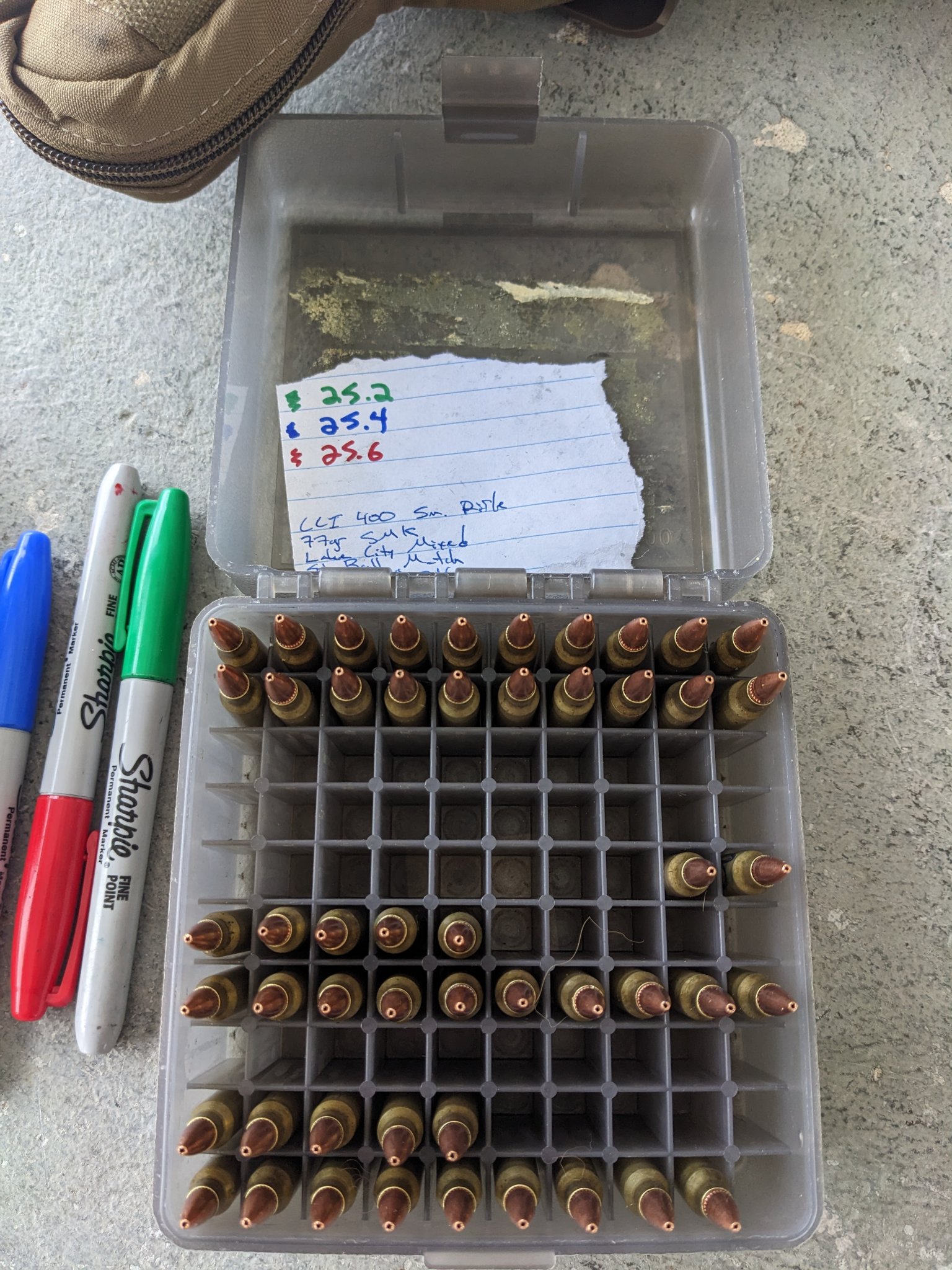

    Day 1 - 3/4/23, Initial Pressure Test
    The first day of testing on was designed to identify maximum pressure for varying powder loads before investing resources into development.

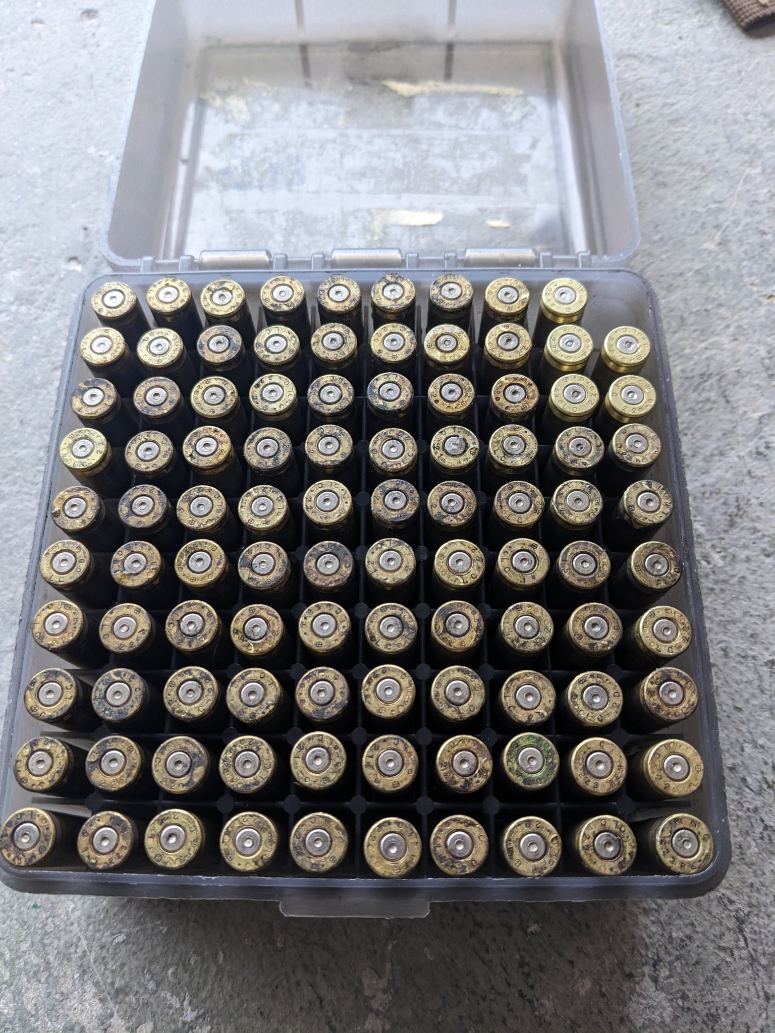

    I loaded 10 rounds, 5 for each gun, of the following powder charges with the StaBall Match: 24.8, 25.0, 25.2, 25.4.
    Loads we're done in mixed (uniformed) Lake City Brass with CCI 400 small rifle primers, using Sierra 77gr SMK bullets with the OAL matched to Black Hills Mk262 (2.250").
    The kestrel data and velocity is below. Good news, there were NO pressure signs in my guns up to 25.4gr and SD looked good (given it was 5 rounds per test). First 5 rounds left to right were the 16" gun.
    Next step will be to load 15 rounds for each gun at 25.2, 25.4, and 25.6 to shoot groups and check for velocity again.

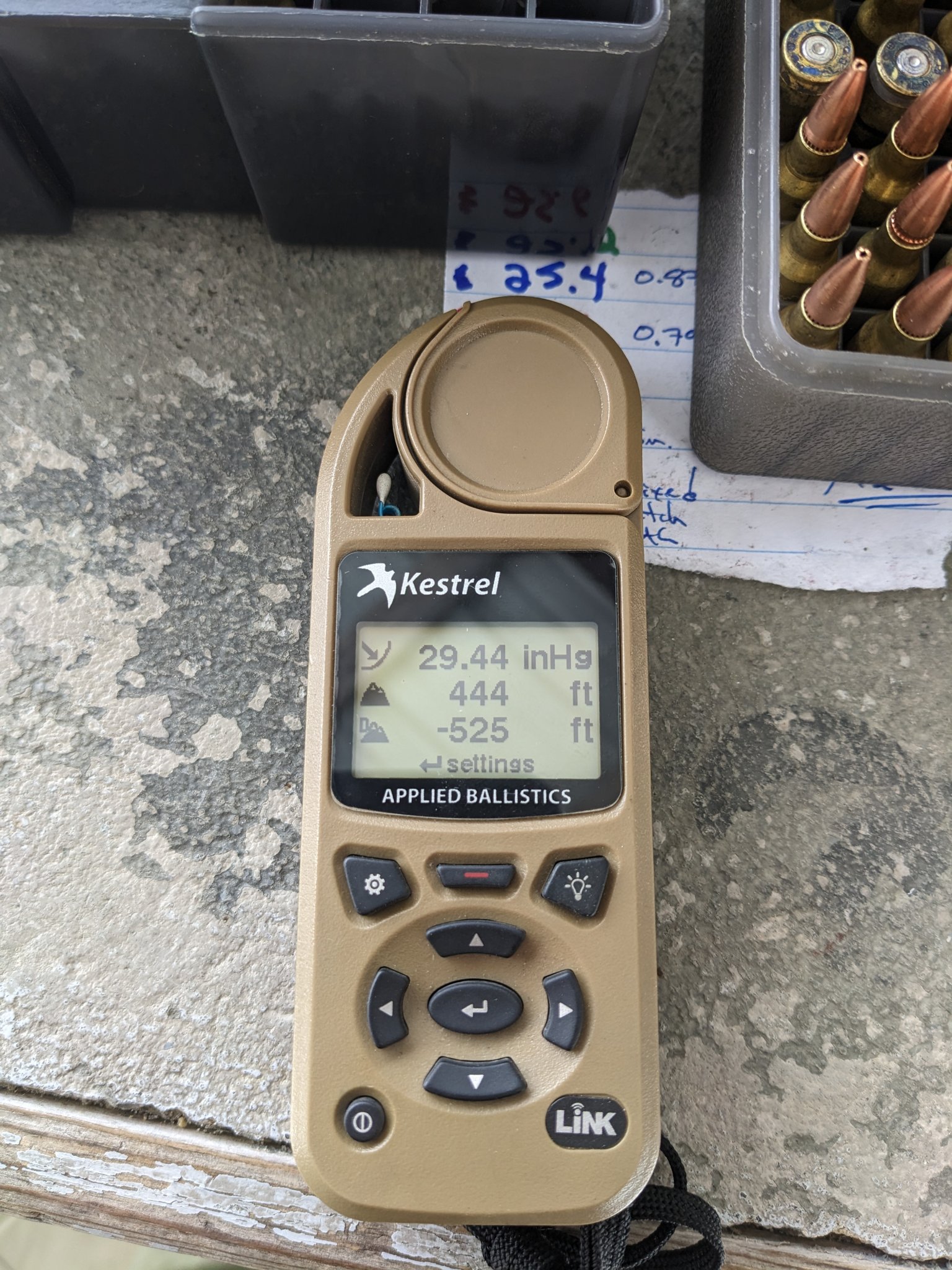

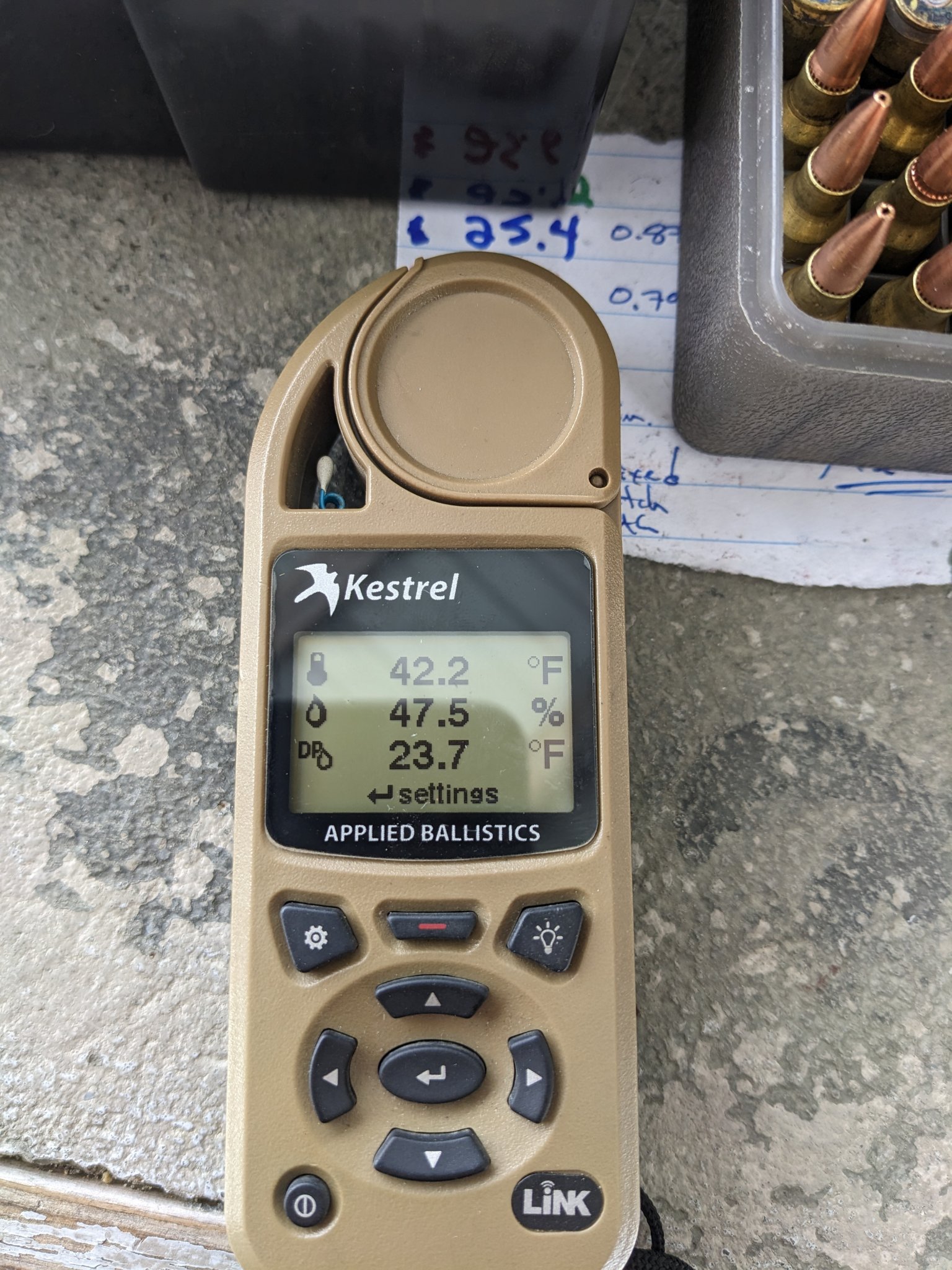

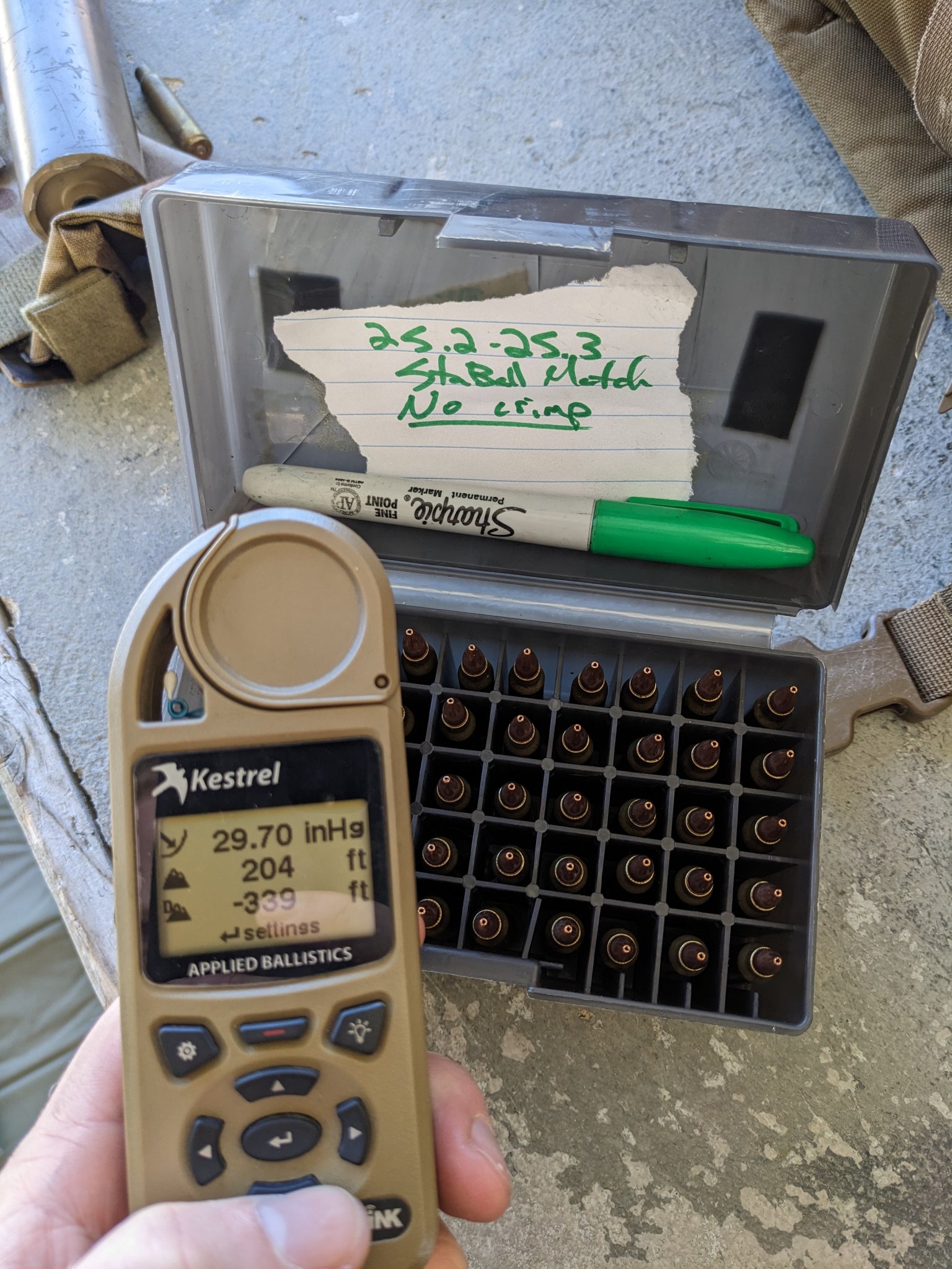

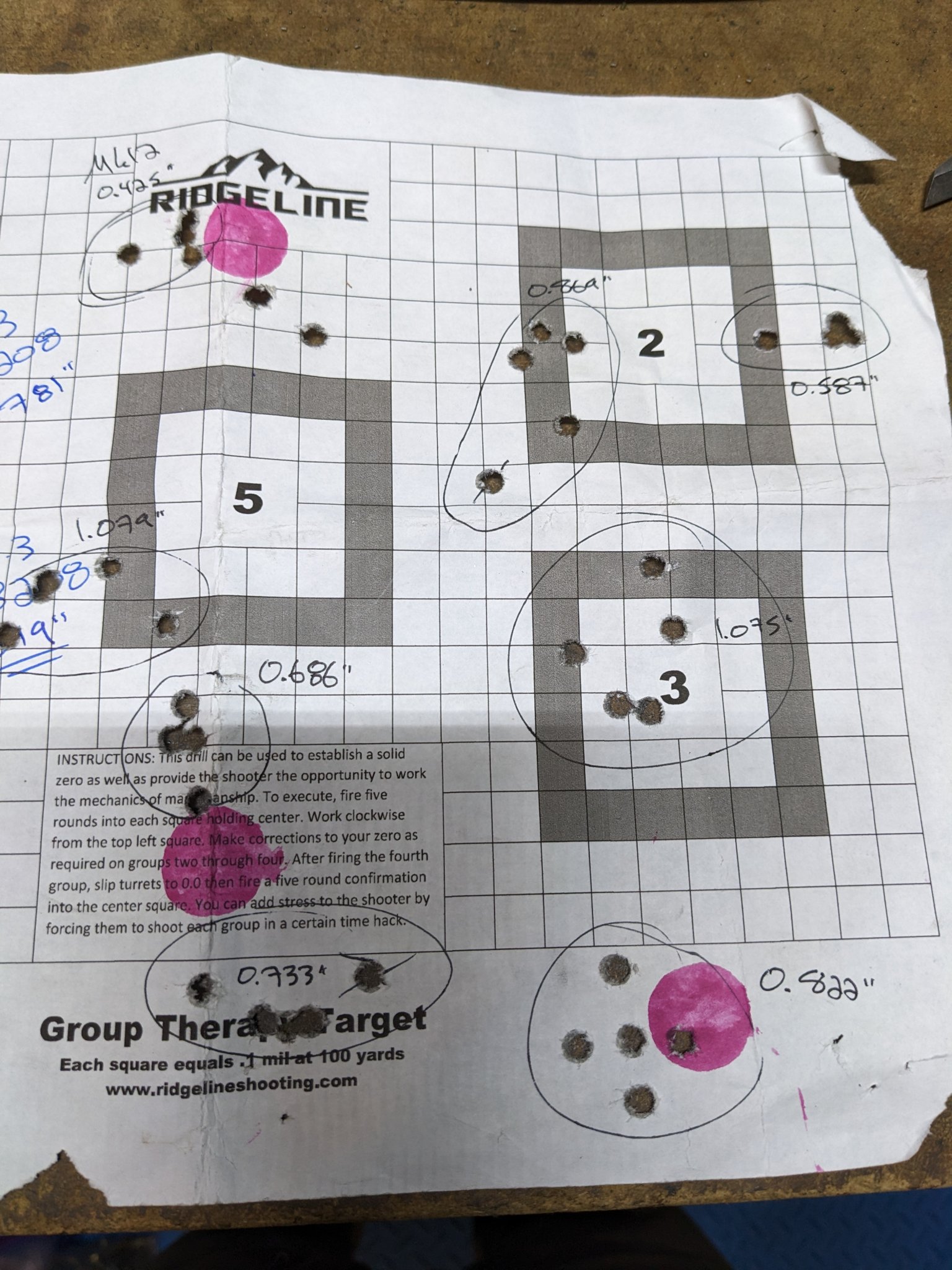

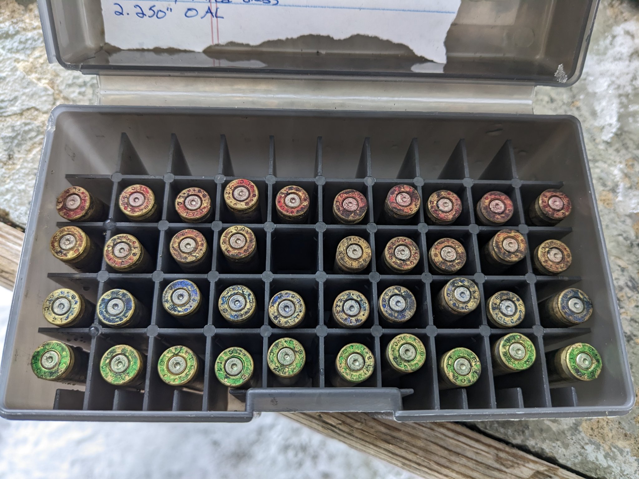

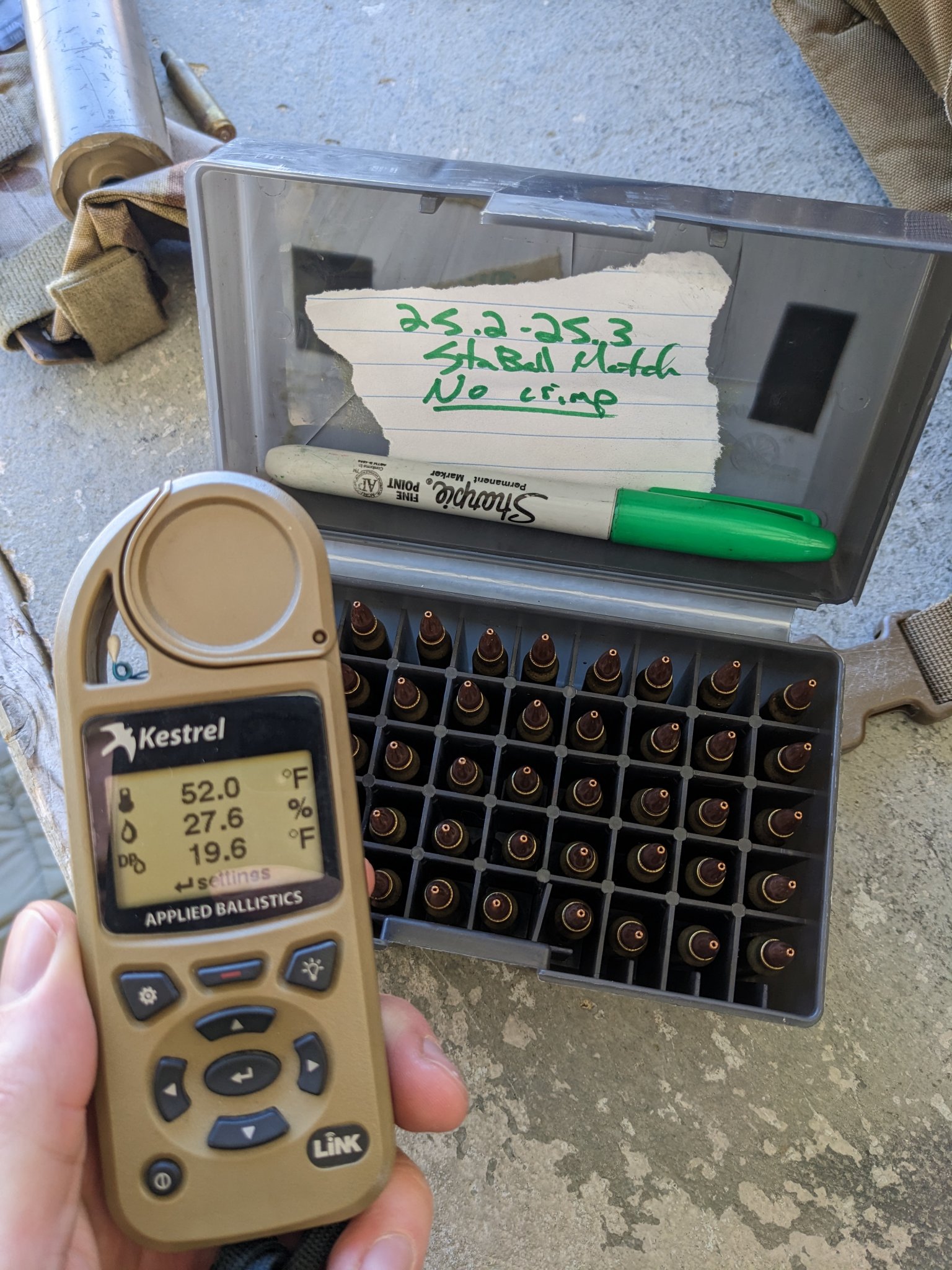

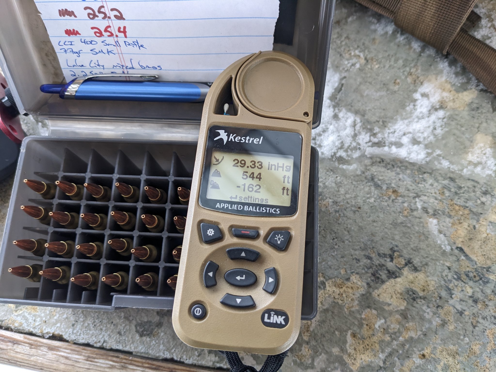

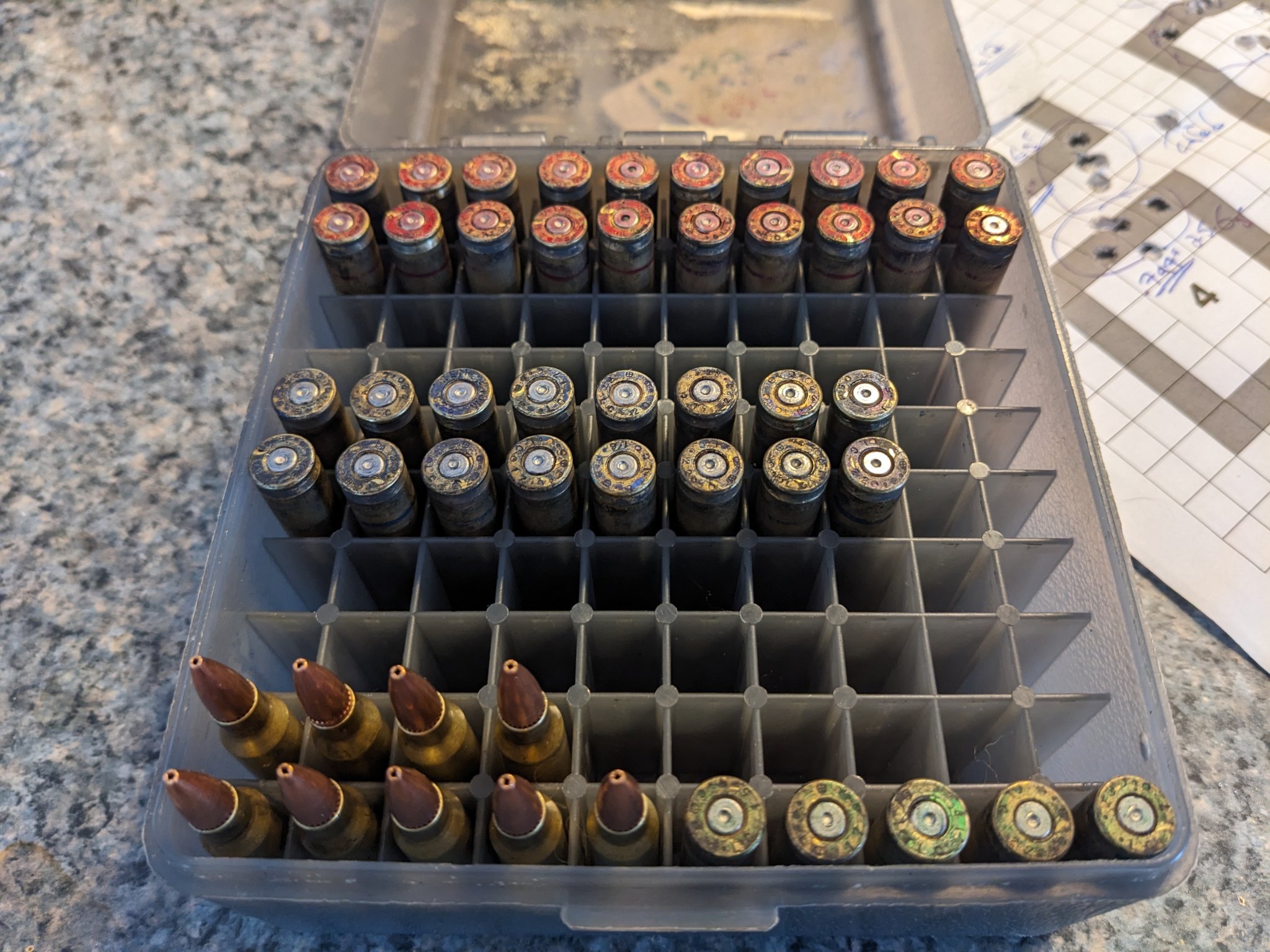

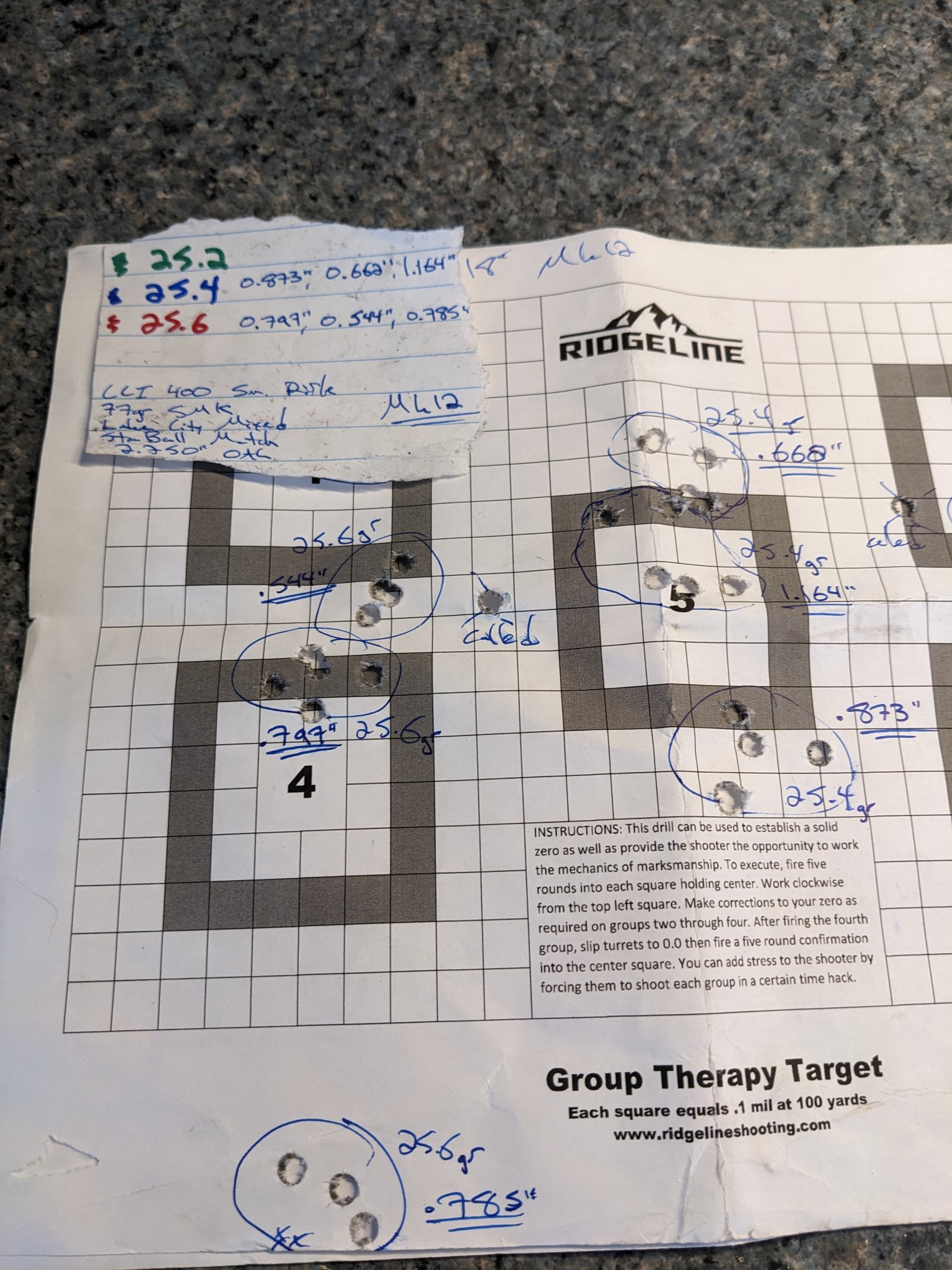

    Day 2 - 3/10/23d, Additional Pressure & Initial Accuracy Tests
    Loaded up x15 rounds for each of the two guns (30x total) of 25.2gr, 25.4gr, and 25.6gr of the StaBall Match. Unfortunately, I left my chronograph at home and was interrupted by work calls, so I was only able to shoot the 25.6gr and 25.4gr strings through the Mk12. Also, being pressed for time I didn't have a chance to shovel out a trench to shoot prone and had to shoot from a bench, which I am much less comfortable doing.
    The same brass, primer, and OAL was used, along with Sierra 77gr SMK bullets. Weather was warmer, see the Kestrel data in the photos.
    Good and bad news. The 25.6gr load shot really well, but 2/3 of the brass had serious ejector marks and a few had nearly pierced primers. It looks like 25.6gr is the MAX charge in my Mk12. As a reminder, I had only previously tested up to 25.4gr, with little to no pressure signs in both the Mk12 and SPR. Given the pressure signs at 25.6gr, and in colder weather, I am going to shoot a few of the remaining 15 rounds through the SPR but will likely burn them in the Mk12 and forego that charge.
    The 25.4gr charge seemed to shoot well. I had a group open up on me as mirage really set in, which was about 35 rounds in over 15 minutes of shooting. Downside of suppressors.
    Group sizes were as follows.
    25.6gr StaBall Match:
    0.797", 0.544", 0.785"
    25.4gr StaBall Match:
    0.873", 0.662", 1.164"
    Tonight, I will load up another 15-20 rounds at that charge so that I can reshoot it for velocity data tomorrow out of the Mk12 and also get initial accuracy testing/velocity data with the SPR at both the 25.4gr and 25.2gr charges. Weather will be a bit cooler but warmer than Day 1.

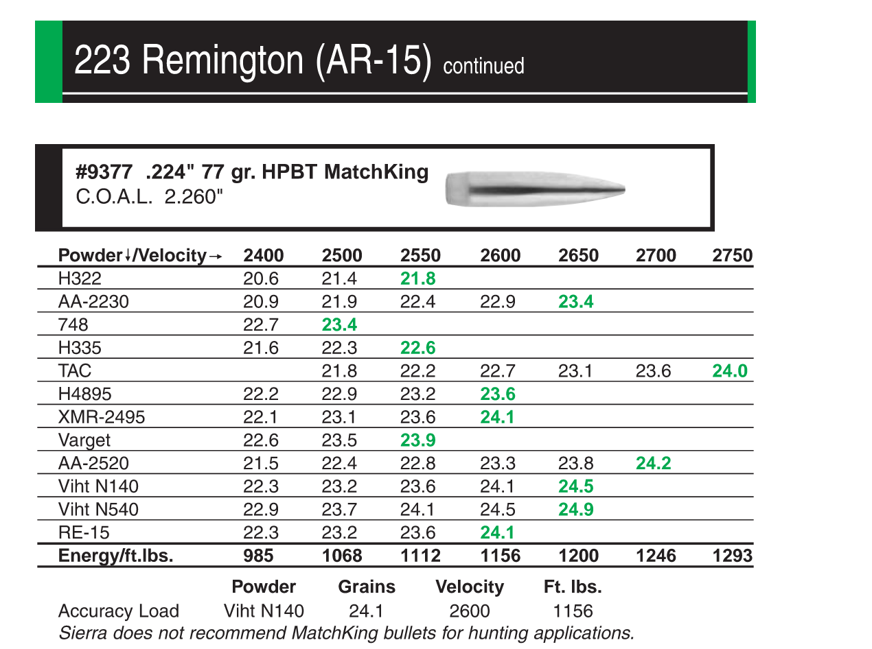

    I think StaBALL Match is not as accurate or high velocity as Accurate 2520, which I believe is superior accuracy, however not temp stable. Pretty much, I would say the brass looked similar on the StaBALL with about .2 grains LESS than the AA2520. I was able to achieve much higher velocity on the Accurate Ball Powder with acceptable brass. I was very careful in prep to make sure all the brass, primer, prep, etc was nearly identical with all the loads. I was sad, because I did PULL 1 shot, with the 25.2 grains StaBALL group with SMK's, but that was the only pull of all the shots on the sheet. That being said, I think a very fine and good groups can be had with acceptable brass around the 25.2 grains area, playing with seating depth. I feel good about that, and I would be totally happy if StaBALL was all I had. That powder, and 2520, are WIDELY available, and not super expensive.
    2520 vs StaBALL Match vs SW Match Rifle
    Reactions: nn8734 and simonp
    I have a few pounds of 2520 to play with, however, the temp sensitivity for me is a non starter. I don't want to deal with 100-150fps swings over the year.
    I would love to have a load that shot 1/2 MOA consistently. The only load that I found that easily with was Varget. And it is just too slow to push 700+ yards, especially if shooting at night where impact spotting is really hard.
    If it shoots 3/4 MOA consistently, I am very happy. That is a 4.5" group at 600 yards and a 6" group at 800 yards, assuming wind is called correctly.
    AA2520 is the way.
    My load is 77smk, 25g, R7-1/2 primer LC case 1x fired. Shoots clovers out of my mod 1 (2800-2820 fps) and is good to 700m+. @NHPiper concern is temp sensitivity but would be curious to see that, assuming hr tries it, how temp sensitive it really is in his area (i dont notice much of a difference at all but im in Vegas and almost never shoot in mid summer during the day).

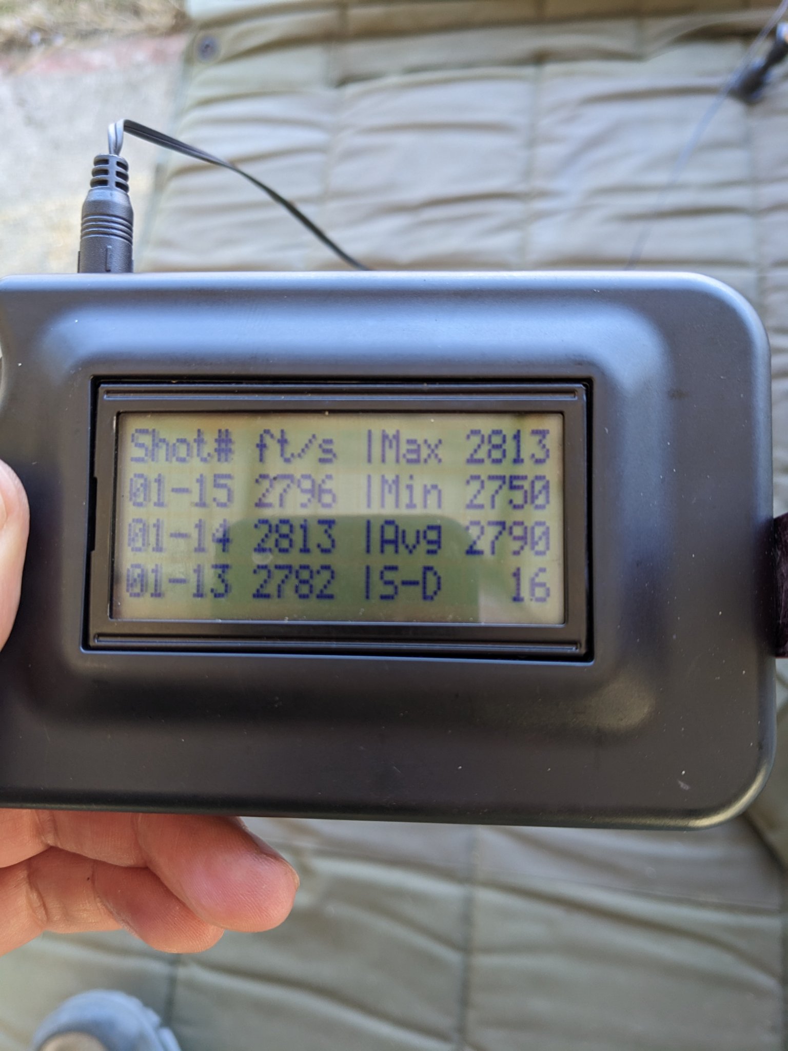

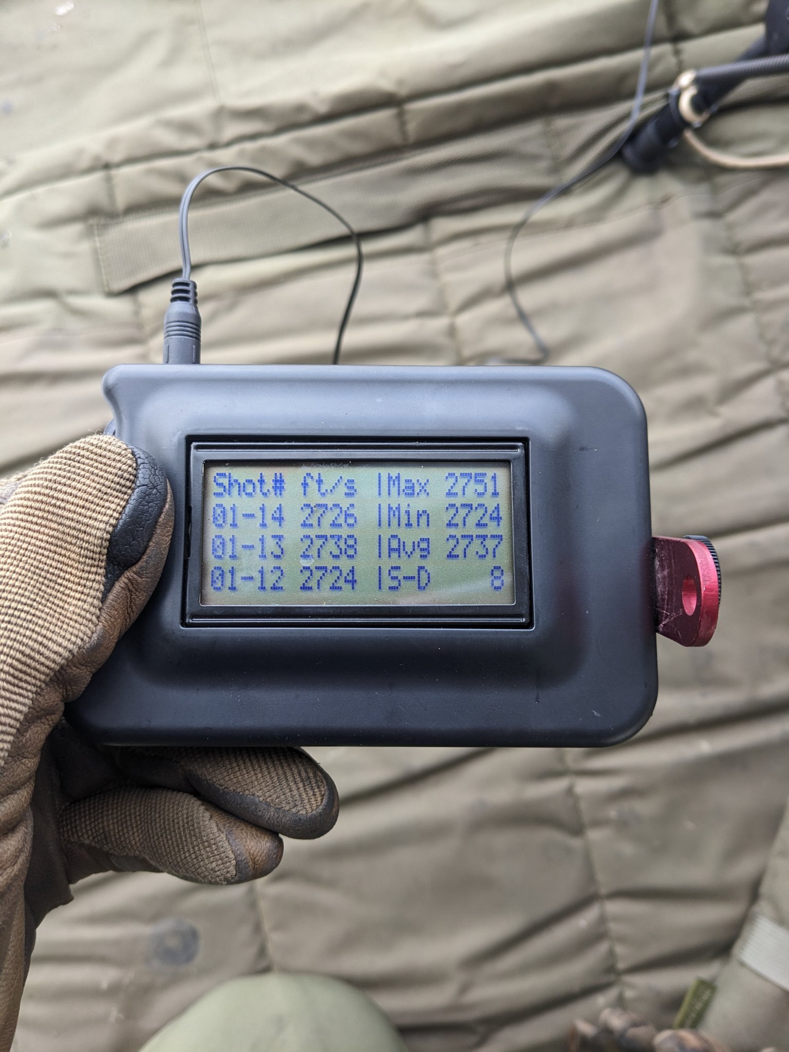

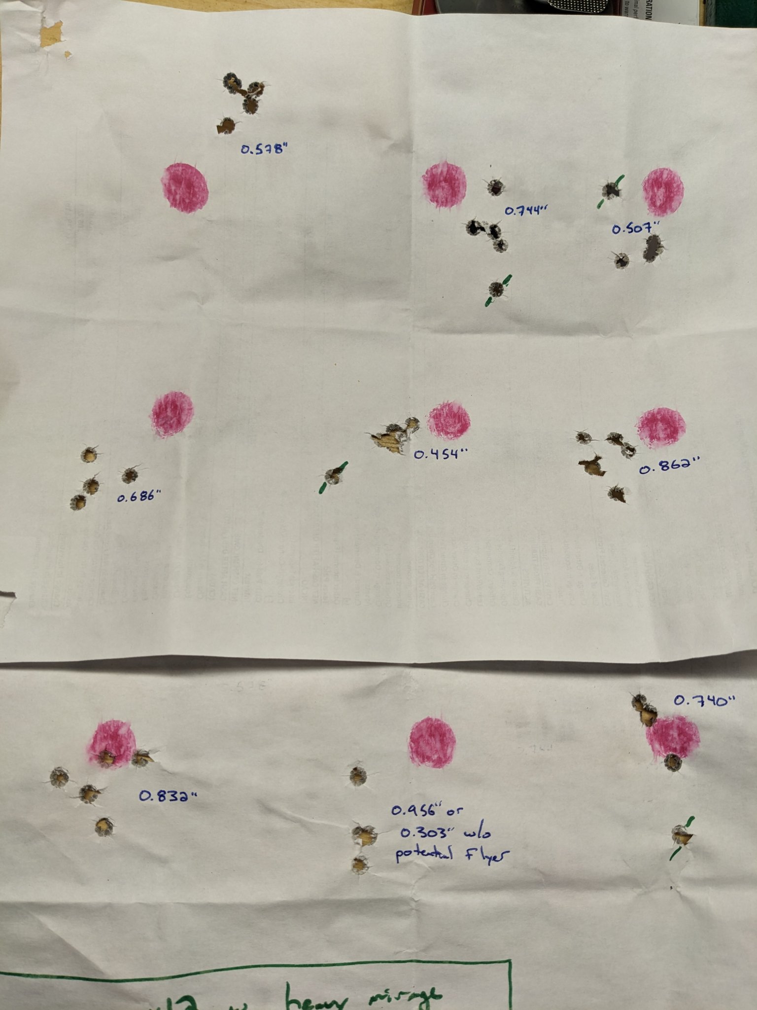

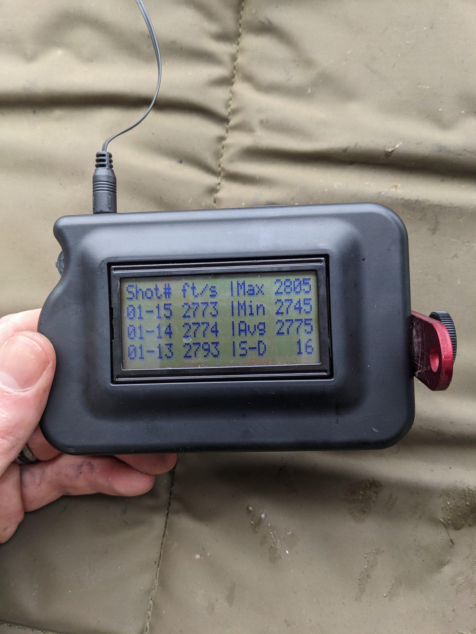

    Day 3 - 3/11/23, Velocity and Accuracy Continues
    Warmer today, See Kestrel. Saw really good velocity signs. Both guns seem to like the 25.2gr load although 25.4gr shoots well. Surprisingly, the 25.6gr I had left ran fine without pressure signs in the SPR compared to the solid ejector marks I was getting in the Mk12. 25.2gr seemed to shoot better in the Mk12 whereas 25.4gr had a slight edge in the SPR.
    I also brought out some 23.3gr of 8208 XBR to see how velocity and group size compared to the StaBall.
    15 round strings, 3x five round groups (25.2gr in the Mk12 was a 20 rounder)
    Mk12 DATA:
    Ave Velocity of 2775, SD of 16
    Groups: 1.038", 1.041", 0.421"
    Ave Group: 0.833" (but got lucky on the last group)
    25.2gr StaBall Match
    Ave Velocity 2747fps, SD of 18
    Groups: 0.624", 0.808", 1.256"
    Ave Group: 0.896"
    23.3gr 8208 XBR
    Ave Velocity 2737fps, SD of 8
    Groups: 0.781", 0.849", 1.149"
    Ave Group: 0.926"
    SPR DATA:
    Ave Velocity: 2687fps, SD of 12
    Groups: 0.902", 0.873", 0.966"
    Ave Group: 0.913"
    Ave Velocity: 2684, SD of 11
    Groups: 0.924", 1.175", 0.975"
    Ave Group: 1.024"
    Overall thoughts:
    Really liking the velocity and SD, wishing this was a 1/2 MOA load. Maybe with some fine tuning it would get there. I am also a better shot with large frame gas guns, not sure how.
    Next step will be to do some more accuracy testing with 25.2gr. I plan to run it out of the powder flow of a Dillon 650 to see if I can ditch the Chargemasters to speed up the time.

    Weather was warmer today, around 50' with a slight headwind. Removing the crimp made a big difference.
    GOOD NEWS
    I shot ⁸ five-round groups and accuracy is clearly better. I have been traveling for 2 weeks and I watched my group size shrink from 1 MOA to an easy 3/4 MOA or less as I shot. The paper is cluttered, but the black pem has the Center to Center from today.
    Groups averaged 0.784" even with my early warmup groups at 1 MOA. Pulling the first 3 groups out, group size shrank to 0.650" with a low of 0.425".
    Velocity was spicy at 2790 with an SD of 16 based off a test of 15 rounds at the end of the firing string.
    BAD NEWS
    20 of the 50 rounds had bad enough ejector swipes that I wouldn't reuse the brass and 1 of them had a nearly pierced primers. I am attributing this to the lack of consistency with the DPP.
    Next Steps:
    I loaded another 20 rounds on the DPP but backed the charge throw off to 25.1gr, although I found this really means that there are a few in there closer to 25.3gr. I bumped the OAL from 2.252" to 2.257" to see if seating the bullet out farther from the powder to avoid compression would help with the pressure spikes.
    I also loaded up 28 rounds of 25.2gr using the Chargemasters to throw the powder and kept the initial OAL at 2.252".
    We will see how these run. I am hoping to make it back to the range later today to check. It would be ideal if I could load just on the DPP as it is a out twice as fast as running to Chargemasters side by side.

    Day 4 - 3/29/23
    Today I ran 50 rounds of the 25.2gr StaBall Match charge through the Mk12 and fed all powder from the Dillon 650 Powder Drop (DPP). I set the DPP to the intended weight, but found that I got a handful of throws when I checked every 3-4 rounds of up to 25.4gr.
    I also removed the crimp from the bullets in the last stage.
    GOOD NEWS
    BAD NEWS
    Next Steps:

    Looking back through my notes on Staball Match and the 77 SMK shot out of my AR with a 20" 4-groove Bartlein 1:7.7 twist with a CLE chamber:
    LC match prepped brass + Rem 7.5 @ COL = 2.260"
    23.6 = 2619 fps -SD 13
    23.9 = 2630 fps -SD 25
    24.1 = 2675 fps -SD 16
    24.3 = 2684 fps -SD 4
    24.5 = 2718 fps -SD 12
    24.7 = 2740 fps -SD 12
    24.9 = 2762 fps -SD 13
    25.2 = 2795 fps -SD 9
    25.4 = 2814 fps -SD 10
    25.6 = 2839 fps -SD 12
    25.4 and above were a little too hot and brass was getting beat up. There was no shift in impact in the 24.1 through the 24.7 grain groups. Groups shifted a little upwards at 24.9 and moved up a full MOA at 25.2, then came back down at 25.4 and 25.6.
    I have more tests set for 24.3, 24.6 and 24.7 grain groups doing seating depths at each of 2.250", 2.255" & 2.260".
    I think this barrel prefers the 77 SMK at 2.255" COL, as other seating depth work had better groups and smaller SD's at that COL, so moving forward, most of my testing will be there.

    Day 5 - 3/31/23 Final Testing
    I did the Dillon powder measure upgrades recommended by @towerofpower93 and polished the drum, raceways, and lubed with some car wax. End result was throws with +/- 0.1gr. I set the powder throw to 25.1gr and loaded 100 rounds.
    Velocity was 2746fps with an SD of 13 and ES of 50fps at about 50' outside. That will work for me, and based on the Kestrel is the difference in elevation of about 0.1mils at 650 yards, which works for me.
    I shot 9x five-round groups. I had 4 called flyers that I botched the second I pulled the trigger. Average group size was 0.706" which was fantastic, with a few groups about 0.5" or less. I was messing with my zero and so was dancing around the bull.
    I am still getting some flattened primers on my loads and a few ejector marks of the hundred I shot, so I will monitor closely during summer months.
    But for now, this is my load. I had no issues hitting 3" plates at 300 yards using a 1mil holdover and hitting clay pigeons at 500 yards with a 3mil holdover.
    Attached are the pics documenting the trip. Appreciate @MK20 doing a ton of work on this as well including temp testing!
    And already ordered an 8lbs tub. I have a .223AI coming shortly that runs great on Varget and I am looking forward to switching it over to this powder.

    I took my Mk12 with this load out to 1120 yards yesterday! I started at 870 and after 2 rounds to get the wind call right, I had repeating hits on target all day. Load is good to go.
    Mt Washington in the background behind the range in the second photo.

    Trying for a MK262 style load I worked up to this yesterday with my Aero Precision 16".
    Don't have 77s so I used 75gr RMR, LC 2021 OFB, Rem 7 1/2 and 25.8 of Tac.
    I have 8208XBR but haven't tested it yet.
    No optics on the Aero so no way to get groups at a meaningful distance.
    I did work up to this same load in my 26" Wilson WOA Varmint and it easily does 1" @ 200 yards, velocity averaged 3041. Lower charges were more accurate.
    Labradar results with Aero 16".
    Western Powders published load data claims 62,145.
    Used the softer 7 1/2 instead of mag primers to watch for any signs of pressure during work up but none in two different barrels.
    The Labradar stats were read at the muzzle...my other chronographs set @ 15 feet would reduce the velocity somewhat. I'll dip into the memory card and see what the loads did @ 15 feet.
