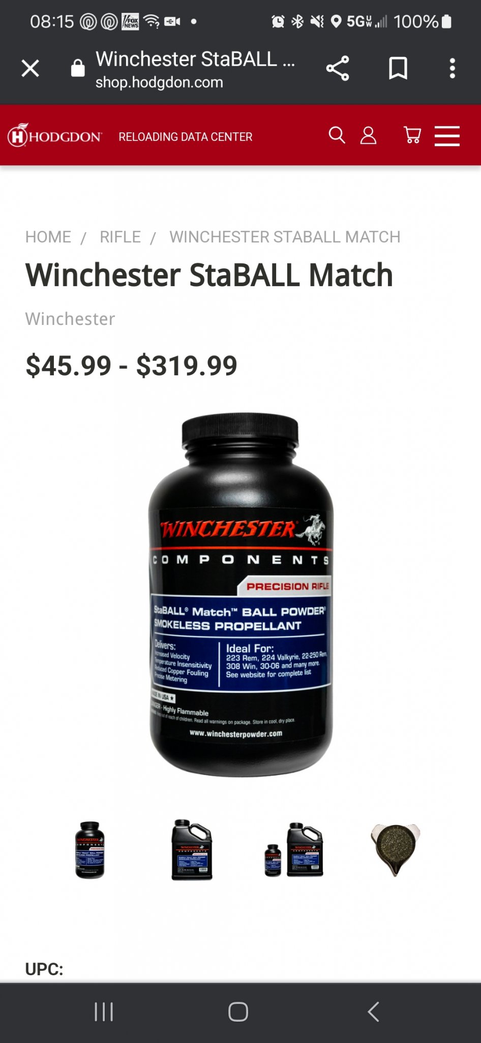

I have been messing around with Staball Match as a replacement for Varget in my 6BR so I can drop powder on my 750.
I have been finding it seems very dirty and carbon is building up FAST in my chamber. Groups start out good - at least 0.5moa and great SDs of around 8 on a clean barrel.
After about 150rds, brass gets hard to eject. Not heavy bolt lift, but hard to pull bolt back. I noticed that i get a carbon ring building up on the outside of my brass necks.
I stuck my bore scope in the dirty barrel/chamber and the carbon in the chamber seems crazy.
I never see stuff like this with Varget, even after long cleaning cycles of up to 500rds. I knew this stuff would be a little bit dirtier but this surprised me.
Load data:
Lapua 6br SRP
Cci 450
109 lrht
31.5gr Staball Match
MV 2815fps

I read it. You called it match HD.
Staball 6.5, green label.
Staball match, blue label.
Staball HD, reddish orange label.
You're using the the blue label correct ?
Uhh....re-read pls. Its staball match in title and post
There doesnt appear to be a powder called "Staball match HD". Just match, 6.5 and staball hd (magnums).
Post a pic of the powder bottle you're referring to.
Ok...Im the retard. My bad. Its Staball Match w blue label. Totally thought it was "Match HD".
I corrected post to avoid any confusion.
