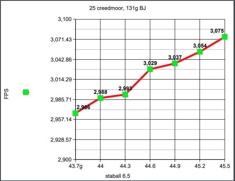

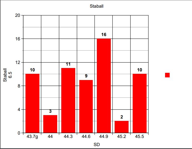

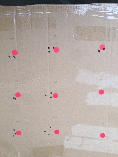

Winchester Staball 6.5 powder ladder test using BJ 131g ACE, peterson SRP brass, CCI 400 primers. At 44.9g there was an increase in recoil. At 45.2g there was pressure signs including increased bolt lift effort and the start of flattening primers. At 45.5g there was significant pressure and this load is unsafe.
Groups are 3 shots per charge weight. Bullets seated .035" OTL as my previous load favors this seating depth. 44g was stacked on top of each other. I'm tempted to play around between 44.6 and 44.9 to see what can be had.

Interesting new powder. Were you using 4350 before?
BTW, that 131 really likes that upper 2900s. Blackjack is always pushing the limit though. I'm comfortably stuck around 2940 on the wicked 25-06 overbore.

That 44.0gr looks great. Accurate, consistent, and pretty good velocity.
