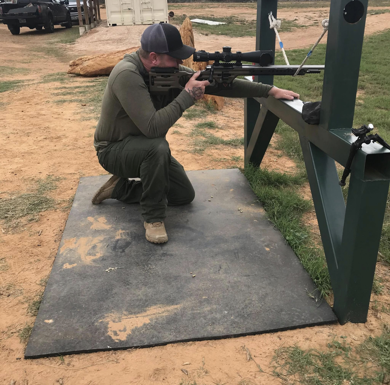

Treat being blown by wind the same as unsupported or unstable prop like a rope. Whatever is your point of aim (center reticle, or your wind hold), make sure your wobble has the same amount on both sides.
If your wobble is .5, make sure it’s .2 on either side of center. Then just breath and make a clean trigger press. You’ll find your rounds magically go there.
You can practice this very well with a rope. Something like pictured below:
Normally I'm at .2 wobble or less, but in the midwest we typically don't see winds like that. As I was trying to work my way through it, I did try centering my wobble and breaking a shot which did work and I was able to get impacts.. it was just hard :cautious: really had to work for those hits. This type of scenario definitely put inner Ricky Bobby in turmoil butI definitely have a few more things to work on. I'm going to try and install a rope or rubber hose on my personal barricade for my next practice session and work on that.
Tripod rear would've been an excellent solution for this as well. My local club typically doesn't allow tripods, but maybe they'll change that one of these days. When I make it out to national matches it's a good skill to have in the toolbox so I'll have to spend some time with that as well.
