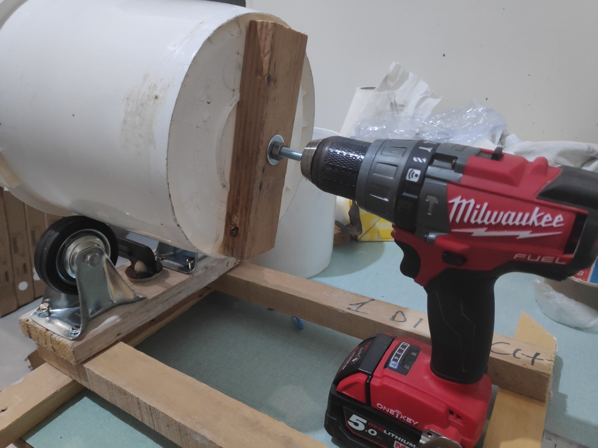

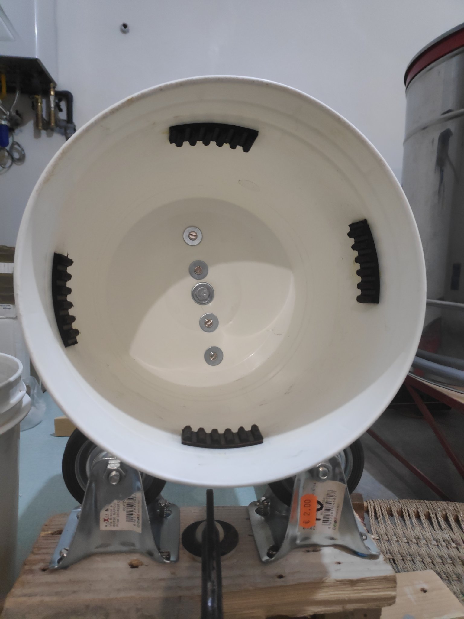

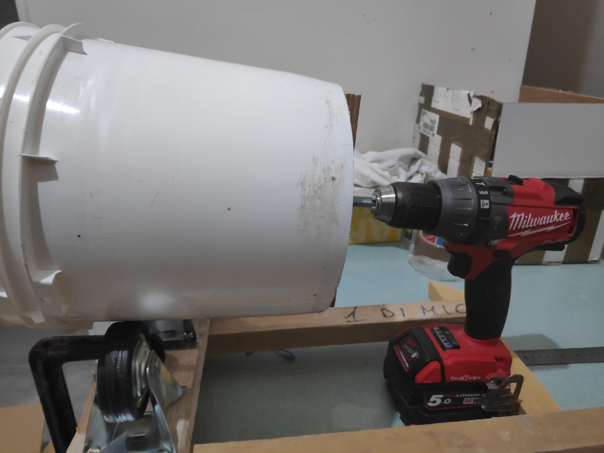

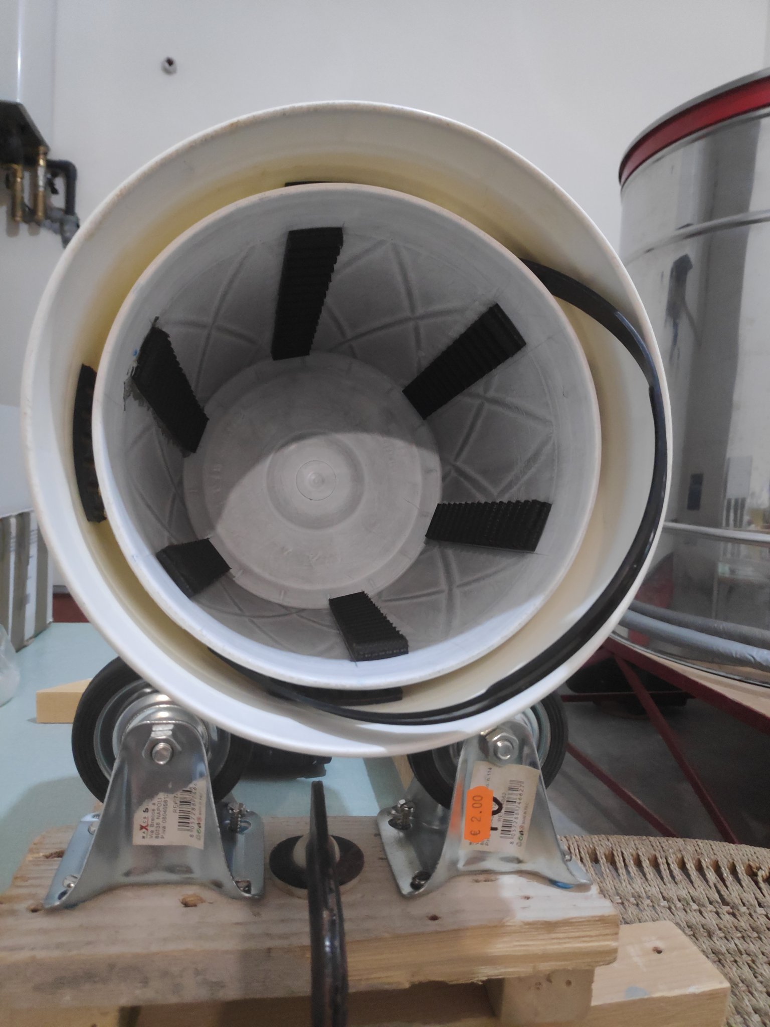

Hello,
this are the home made tumbler.
Two can, the first is made only for connect to the drill shaft, the second is the like the very tumbler, no holes no drain.
The black agitators are made with one old distribution belt, glued to the can.
