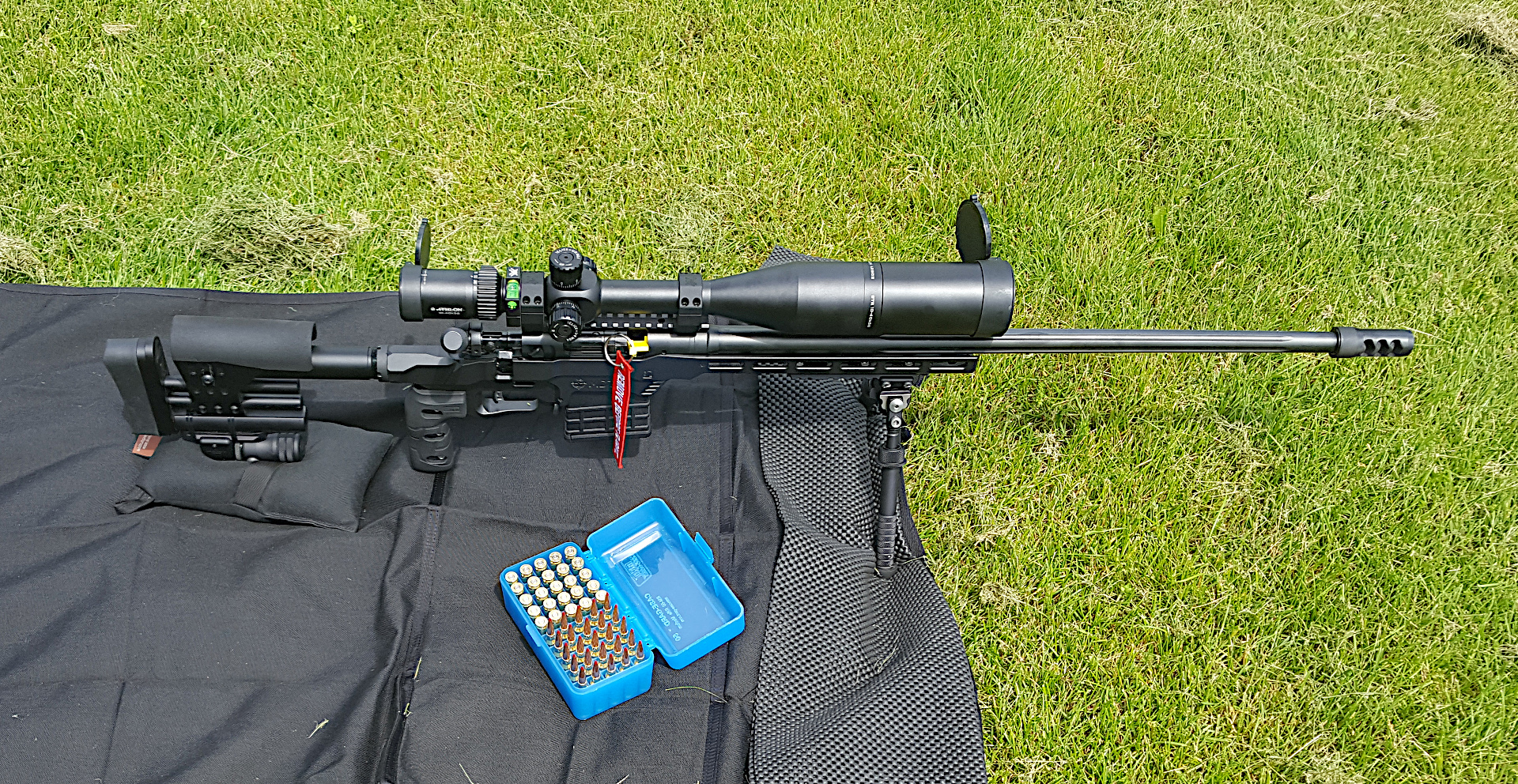

    I can hit what I'm shooing at from the prone position but it is just killing me....can't find the target, can't get comfortable, can't seem to align with proper alignment and get the scope eye box consistent and when I finally fitz and futz and and get a sight picture I'm shaking and feel like I'm bent up (in my neck) like a pretzel.
    I feel like I have to set my rifle/scope/cheek riser up from scratch to make it work from prone....is this normal? I'm shooting off a bipod with rear bag - is it seems more comfortable and consistent with the bipod up a little higher but I'm now doubting myself. I was shooting consistent 1/2 MOA off the bench and now I'm lucky to keep it under 2 MOA *but* I did manage to put 4 in a row through the same hole at 200 yards today prone but it felt like luck and almost killed me from the discomfort.
    What am I doing wrong? Besides stupid I mean...:oops:

    Put the bipod higher where you dont have to scrunch your neck down to look through the scope. The higher the rifle the more you can have your head straight up and not tilted forward strained and looking through your eyebrows. You may find that your cheek piece needs to be slightly different to deal with your faces different positioning and rotation. How different? That depends on your personal geometry.
    I hate to say this, but sometimes, some people need to work into a comfortable position over time; just like stretching. Sure higher can help, but some people hurt just laying face down even without a gun.

    Aside from being a stiff necked old guy, you sure sound like your describing what would happen if your scope is set to far back.
    length of pull off a bench with my AR's adjustable stock is 12.75, in prone that goes to 13.5"
    When you go prone your head pivots forward.
    Since you just started shooting prone, my money is on scope to close and having to scrunch your neck back.
    With a bolt gun you have to compromise unless it's got tool less length of pull adjustment.

    *BaM!* Kinda what I'm thinking. It's not tool less but I have huge play with cheek riser and length of pull.
    I think I might need to start turning screws...is higher or lower better on the bipod? All the way down (as low as she goes) seems better but is fucking killing me with sight pix and neck pretzel. I think maybe I need to lay down on the gun and just slide shit around until it ...jells.

    That setup looks way too low.
    Raise up the butt pad a bit as well

    And lower back. Prone bipod he may get away with the scope in that position. If he was to sling up it would have to be 3" further forward.
    F class would be more in line with the current setup, but there is no doubt he'll get there. I shoot with guys with multiple neck fusions and they an get a good enough position to shoot high 190s with a 308 Servie Rifle. Just have to put in the time and work at it.

    You may also have to set your rifle up a bit differently for prone. First, get used to getting into the prone position and up on your elbows without the gun. That way you aren’t contorting your body to the gun that may or may not be set up properly,
    Then move on to getting into the proper prone position and pulling the gun into you *without* the optic on it. If it doesn’t fit you in the proper position you built, adjust the rifle. Once it’s adjusted correctly, mount the optic with the ring height needed to get in in front of your eye properly.
    As an example of setup, my prs rig is setup up to fit me shooting off props and barricades. It’s slightly short in the LOP for prone. But 80% of my shooting is positional off props. I can either extend the LOP, or fudge it on a prone stage as it’s a heavy 6mm.

    Most of my problems were solved by getting the gun set up higher on it's legs. The rest of the problems were solved by mounting my rail with Red Loctite and new screws (properly sized for length to keep them from bottoming out!) and keeping it from shifting. Aside from prone discomfort, my group sizes at 200 yards had gone from .7 MOA to 3 MOA (and more!) and it took me a while to realize it wasn't me. My scope rail was moving enough to drive me nuts but it was not apparent until I ripped the scope off and found the screws had (again) backed out.

    I find the best way to determine supported height is to do it without the bipod. Not a requirement that it helps if you have a friend there with you with a measuring tape.
    With your eyes closed the entire time, lay down behind the rifle I'm simply move your support hand forward and backward as necessary and elbows in or out. This is going to raise or lower you and the weapon. Once you find that correct spot, stand up. Repeat the process until you're comfortable position is repeatable...eyes cloed.
    I'm sure somebody's asking why eyes closed... when we have our eyes open we're going to mount the rifle to align with what we see. You don't want that. That means you might not be in your true in NPA.
    So now that you have your repeatable position that's comfortable, get your friend to measure Barrel or forearm to the ground. Put your by pot on if that exact measurement. Repeat the mounting process again with your eyes closed. If it feels comfortable then open them up... Are you still online with your scope? If so great if not adjust your scope position or cheek piece or buttplate.
    So take it for what it's worth ... if you try this and it works great, if it doesn't work well I am the fuktard ring leader.
    A lot of guys are used to laying on top of the rifle. They set the rifle really low and on target and then basically mount up on it. So shooter is laying on top of the rifle with cheek weld/cheek pressure and the rifle is connected to the bench/ground through the bag, almost like trying to “ride” the rifle. Shooting prone like this you can end up with your neck being used to link your body to the rifle and support a portion of your body weight, typically at an awkward angle.
    Get your body connected to the ground(or bench in mod prone)first and then get the rifle connected to you via pulling into a relaxed shoulder. That connects the rifle to the ground/table through you rather than through the bag. That let’s you choose your exact position and then attach the rifle to you, rather than the other way around. It’s Important to learn to position yourself so you can see through the scope easily and be on target with a pull into your shoulder that’s straight down the line of the rifle. If you start square and in line with the rifle it will make it easy to get it right next to your face so you don’t need to bend your neck over to get behind the scope. This makes it easy to pull straight down the line of the rifle as well. Also you need to be high enough to be upright enough to see through the scope without tilting your head over but not so high that you need to be up on elbows.
    Picture what it feels like to walk up to a spotting scope or binoculars on a tripod. You are connected to the ground and you position yourself so the eyepiece lands in a comfortable place. Its the same concept but more complicated since you are attaching the rifle to you and not standing upright. But the root problem for most IMO is they are trying to ride on top of the rifle rather than build a base to connect the rifle to. How to build the base is a whole other rabbit hole. Spend time at home finding your position and dryfiring with NO AMMO ANYWHERE NEARBY. You need to make sure you are deliberate and can repeat your position before even chambering a round. Until you can do that you are just wasting ammo and practicing bad habits. Years of dryfiring while testing bags taught me how important and helpful it is at making a solid/repeatable position.
