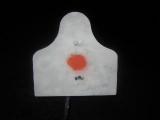

Just a standard .223 with 77 smk's.
Sometimes I whip it out and it does this from a cold bore:
730 yards
I just put it away after that and move on to something else.
600 yards
A number of people have seen this particular rifle shoot some amazing small groups, even well past transonic range, on many different occasions. It also happens to track very similarly to a .308 to about 850 yards.
