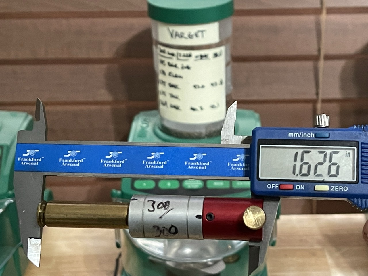

Do you know how much you’re bumping the shoulders when you FL resize?

Do you know the chamber length for EVERYTHING and how much your FL die is sizing the brass?

What you’re advocating though is going to lead to premature case failure. For all you know you’re bumping the shoulders .010” which will make the case fail within three reload cycles. That’s not sound reloading advice given good brass is hard to find nowadays.

A case gauge is not your chamber. Do you understand what you are doing when you’re FL sizing the case? You have two different tolerances: die/ shell holder/ press and your rifle manufacturer. If you don’t measure anything and just blindly size the case then your cases will fail. Measuring takes only a few seconds. It is peace of mind.

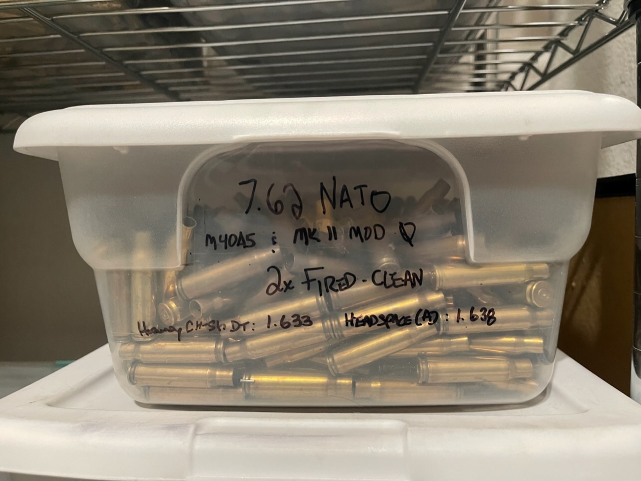

Not sure how you got the impression I don't measure anything. I know a LOT of reloaders that do full size every time, (that's why RCBS, Hornady, etc. sell them) so I failed to see the error of my ways for 50 years. Sorry I was having so much fun at your expense. I will now go find a bridge to jump off of because I am not worthy.

Are you familiar with the concept of tolerances? For example, in my 6.5cm if I were to FL size the cases without paying attention to shoulder bump I would be setting the shoulders back .010”
Do you think that’s good?

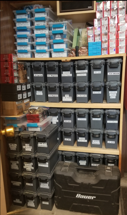

What I think is you're not listening. I spent several years with Texas Instruments and NASA, so, yes I understand tolerances.
My 6.5 is doing fine. My 22 Nosler is doing fine. My 2 Grendels are doing fine. My Valkyrie is doing fine. My 6mm ARC is doing fine. My M1 carbine is doing fine. My Winchester 94 is doing fine. My Lee Enfields are doing fine. My Mosin Nagants are doing fine. My Uzi is doing fine. My PPS 43 is doing fine. My Sten is doing fine. I built all three by welding up and converting to semi-auto - demilled kits. My Remington 700 in 30-06 is doing Fine. My Mauser is doing fine. My AK47s and AK74 (which I built from de-milled kits) are doing fine. My SKS is doing fine. My pistols are doing fine. My Remington Rolling Block (32 rimfire) is not doing fine because they don't make ammo any more and I don't reload rimfire, (nor to I want to.) My shotguns are doing fine, but I don't reload them.

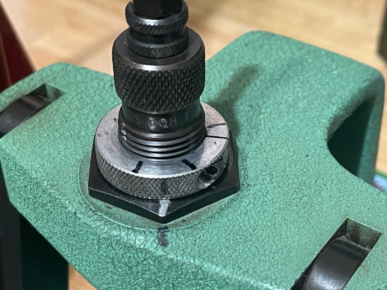

So in short,
Step 1: measure a fired case’s for its case head to shoulder length using a headspace comparator dial calipers. Write that number down (note - this number will not give you the actual headspace of the chamber but will serve as a reference number that you will use in the next step.
Step 2: screw your sizing die until it touches the shell holder when the ram is fully raised
Step 3: Size the piece of brass and measure the case head to shoulder and compare to your fired case.
If the sized case is .003 or more less than the fired case, back the die out and size additional cases one at a time until you get a measurement that’s .002 less than your fired case (go .004 under for gas guns). Then lock it in place and index the die and lock ring with a marker and that’s the die you use for that rifle.
Here’s me taking a CH-ShD measurement after sizing. My fired brass for that rifle measures on average 1.628” using that comparator and indicator. So I’m giving myself .002 clearance so brass stretch is very minimal. Prolongs brass life and mitigates risk.
Reactions: straightshooter1
THANK YOU! NOW I can start to understand what the fuss is about! Has anyone ever spoken to RCBS about this?

Once you get the gauge and comparator set, start segregating your fired brass by rifle and measure CH-ShD for each. If you’re lucky (and you very well could be) all your fired cases will measure the same so you can use the one die for all without having to adjust for the different rifles for that same cartridge. If not, you will need to adjust for each. Here’s how i index so can make adjustments easily (each black hash line equates to .002-.003 of shoulder bump in either direction.
Start keeping your fired brass stored in separate containers, labled with the rifle that fired the brass, CH-SD measurement reference value and the number of firings so you can keep track.
Here’s an example:
Hope this helps you get on track…
YW

Thanks! I've got about a dozen YouTube videos to watch!
I'm currently storing brass deprimed and cleaned, but not sized. Most bins are full.
